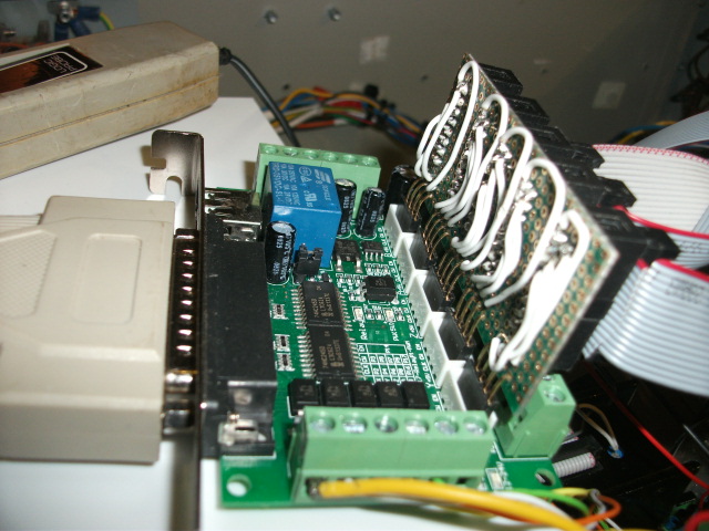

I have got a problem with a motor driver that only goes in one direction. I have swapped inputs, but the same result and I have swapped output connectors to verify that the problem stays with that particular driver.
The bad news is that it is a driver that is not available on aliexpress, so I can't get a direct replacement. The worse news is that it is a PD2064M :grief: from MD :grief::grief:.
I am running it at 48volts. There was no smell of magic smoke and nothing inside it looks amiss.
Any ideas, or do I just bite the bullet and get new drivers ?

It's a good idea Clive, but the input to the driver is on an IDC 2x4 pin connector and the documentation is in Chinglish. I have had to make an adapter to fit these drivers to a normal BoB, as the original BoB went up the Swanee a long time ago. I have got 3 Parker Digiplan drivers spare, so I might just wire one in place. An alternative is to get this kit and use the drivers. I have now opened up the driver and taken the circuit board out. It looks as though it was made in a shed, the soldering is poor and there is flux residue everywhere. I have cleaned it up, but hold out little hope. The optos look like 1L6704, at least that's the marking on IC's where optos ought to be.
I'll plug it back in and try it, just for fun.

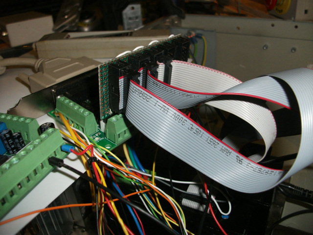

Attachment 16933Attachment 16934
This is the adapter I made. I think the way forward is to get the 3 m542h kit and wire it up properly (with real wire !)

Well, I have taken delivery of three new drivers and wired them in this afternoon. I had a bit of a problem determining the microstepping of the old drivers, so I started from first principles and all seems OK, the machine is cutting properly to dimensions.
Ther is one small glitch to sort out, Estop and Limits seem to randomly trigger. They are NC circuits, so I need to consider what resistance there is between the GND on the BoB and the input wire to the BoB terminals. I'll do that tomorrow afternoon.
I am just pleased to have taken out those ruddy Tonman PD2064M drivers.
