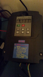

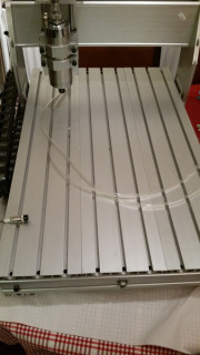

My first CNC machine finally turned up just before xmas and I've been anxiously trying to get the table/enclosure ready for it so I can start to use it finally!
Attachment 16977
The table is near enough finished so I now turn my attention on to the upgrades required to make the first cuts as painless as possible. (without breaking the bank too much)
Looking at what I have got..

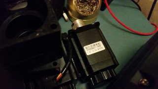

- 3 of 57HD5401-14S/8 Stepper Motor - 1.8 step angle. 3A N1508

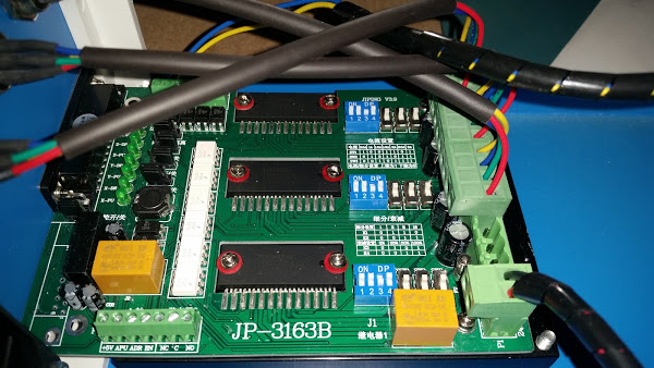

- A blue controller box with an all in one controller/driver board.. JP 3163B (Same as this one)
- A 24V 8.3A switching supply
- A 1.5kW VFD for the water cooled 800W spindle.
- This 35W 24V diaphragm pump
Attachment 16979 Attachment 16978
As I understand from a similar machine thread here, the PSU and drivers aren't up to the task of running the motors.. As such I'm considering going with three planet cnc driver boards - the 6A 50V capable one.. http://www.planet-cnc.com/files/MotorDriver60A-256.pdf

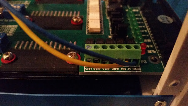

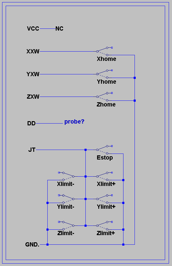

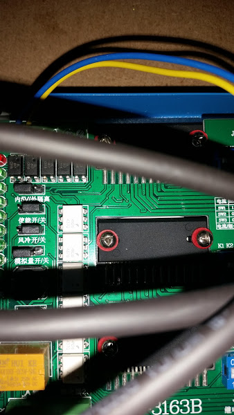

Hi, I'm looking into the possibility of adding home switches and limit switches currently, and am a little unsure on the best route to take with the standard electronics it came with..
There's a terminal block that appears to be for limits & it's where the emergency stop came connected at the moment.. as a normally open.. with a connection to ground when activated.
Am I right in thinking I can do the following? (Using simple micro switches as limits, and inductive switches as homing.)

Re: My first CNC finally arrived! (6040)
Hi d4cnc
Adding the limits to the e-stop circuit would work as drawn - however, it's a bit unusual for them to have configured it to be normally open. It's a bit safer to be normally closed when running in case a wire breaks etc. and it doesn't work when you press the e-stop.
Adding proximity sensors for the homes is fine but be aware they have 3 wires and run off 10-30V, so they wouldn't be drawn quite as you have drawn them. They also send out 10-30V as a signal so check the board can take this as an input as it could be 5V max.
Thanks for the advice.. yes always active would be safer but I'm not 100% sure about the controller board I have and how easy it is to wire as such.. I believe it's similar to the earlier version shown here. Although mine is a v3.9 with extra jumpers.. I was just following on from the way the E-stop is wired from the factory.. but I can of course change this.
http://i01.i.aliimg.com/img/pb/438/2...277438_868.jpg
Perhaps for the limit switches I could use a relay instead and wire the switches in series.. Would this be a better route to go down? Or am I better off using a FET to switch rather than a mechanical relay?
http://oi65.tinypic.com/ok5vg7.jpg
I've not looked into the proximity home switches yet.. but the ones I have are 6V-30V so I was hoping to use them..

I will get out a spare BoB and proximity switch and wire them up on a breadboard. Some prox switches do output the supply voltage, but I think this is just due to open collector leakage, and should not source any real current to damage the BoB, but I will check it out properly this weekend and post results. I use LJ12A3-4-Z/BX switches with a 12v supply without any problem.
