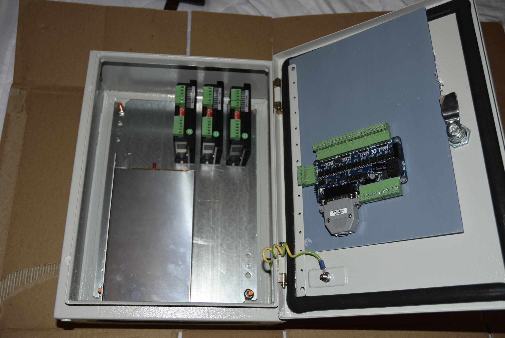

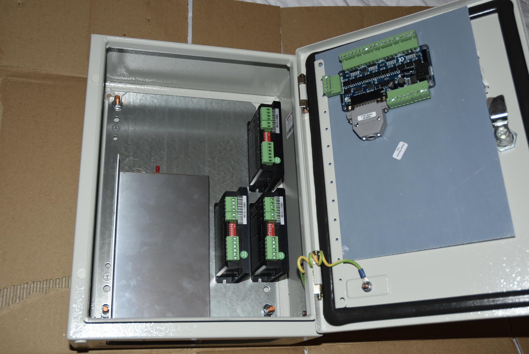

Any advice would be greatly appreciated. I have just purchased a little cnc router for PCB work.
I have been trying different layout options while I wait for cables and connectors to turn up
There are three options that I can see and wondered if there are any issues with these, like electrical interference, heat concerns/ventilation or anything I may have missed.
Options 1 and 3 involved mounting the BOB onto acrylic and attaching this to the door panel.
The external case dimensions are 400mm x 300mm x 150mm but the removable steal base panel is 350 x 250 which is what I want to keep all the electrics on for ease of removal. All the connetors wil be mounted on the access panel on the side
Option 1 - and preferred option for me
Attachment 17137
Attachment 17138

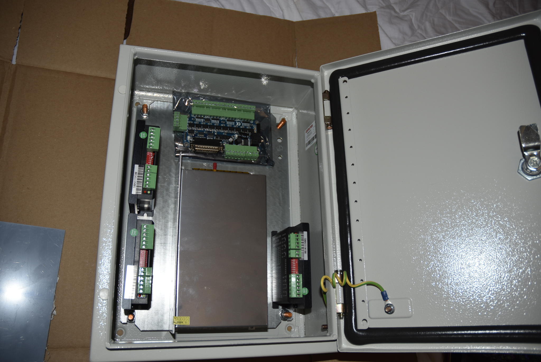

Option 2
Attachment 17135
Attachment 17136

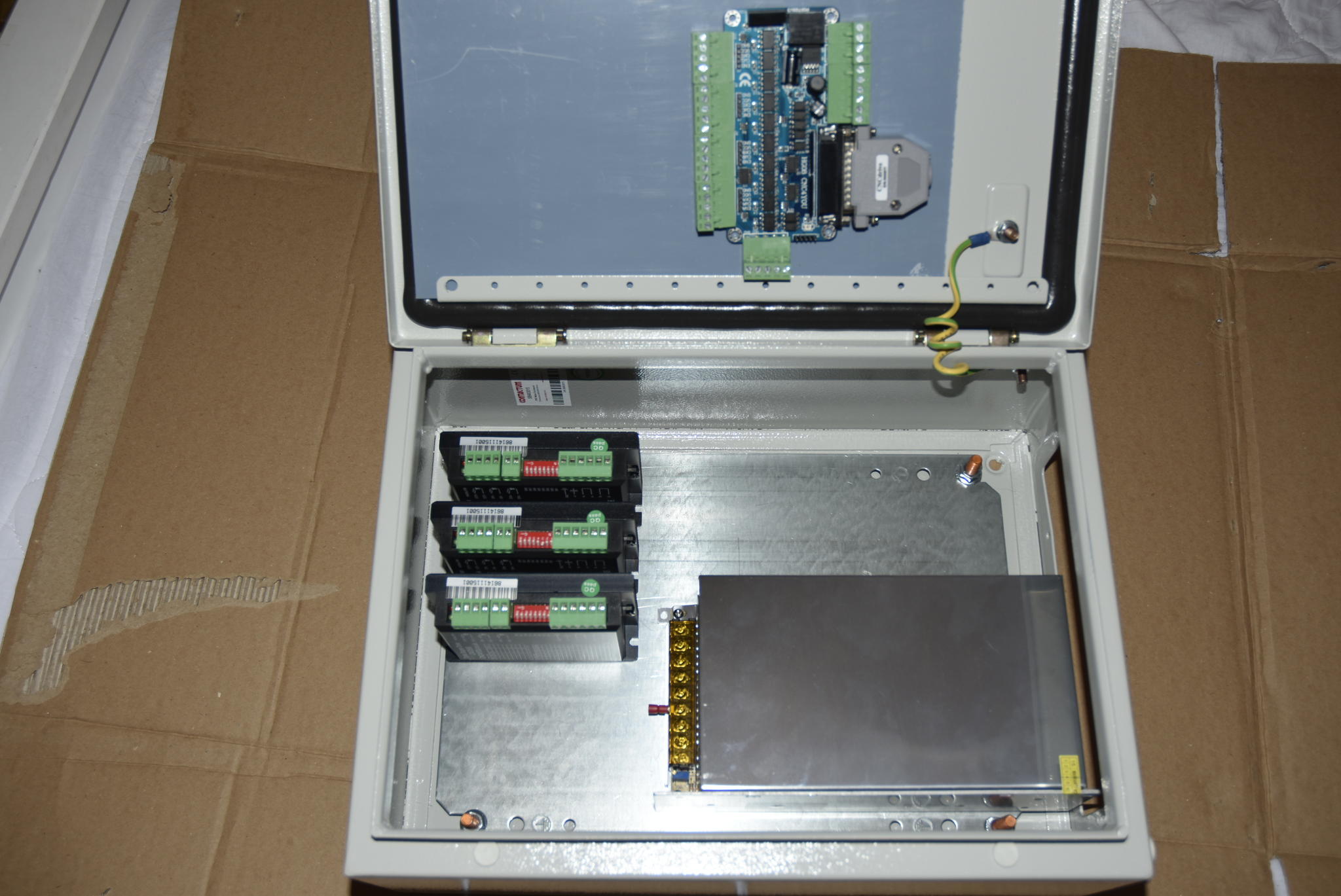

Option 3
Attachment 17139
Attachment 17140
Re: Advice needed for controller box layout
My preference would be to have all parts in the case and not mounted to the door - Is there enough room to mount the powers supply on its side? Might give more room/options?
http://literature.rockwellautomation...m001_-en-p.pdf
This document makes an interesting read if you want to focus on handling electrical noise in a system (thanks EddyCurrent!)
Jim
Hi Jim,
Thanks for the quick reply.
I did look at mounting the power supply veritally but the lock on the door hits the top of the PSU on one side and on the other there is a bar which sticks proud of the door panel visible in the second picture next to the gounding wire, which also hits the top of the PSU meaning I have to move the PSU more to the centre of the case.
Besides, being lazy I wanted it flat so I can easily access the screw terinals :redface:
Dave

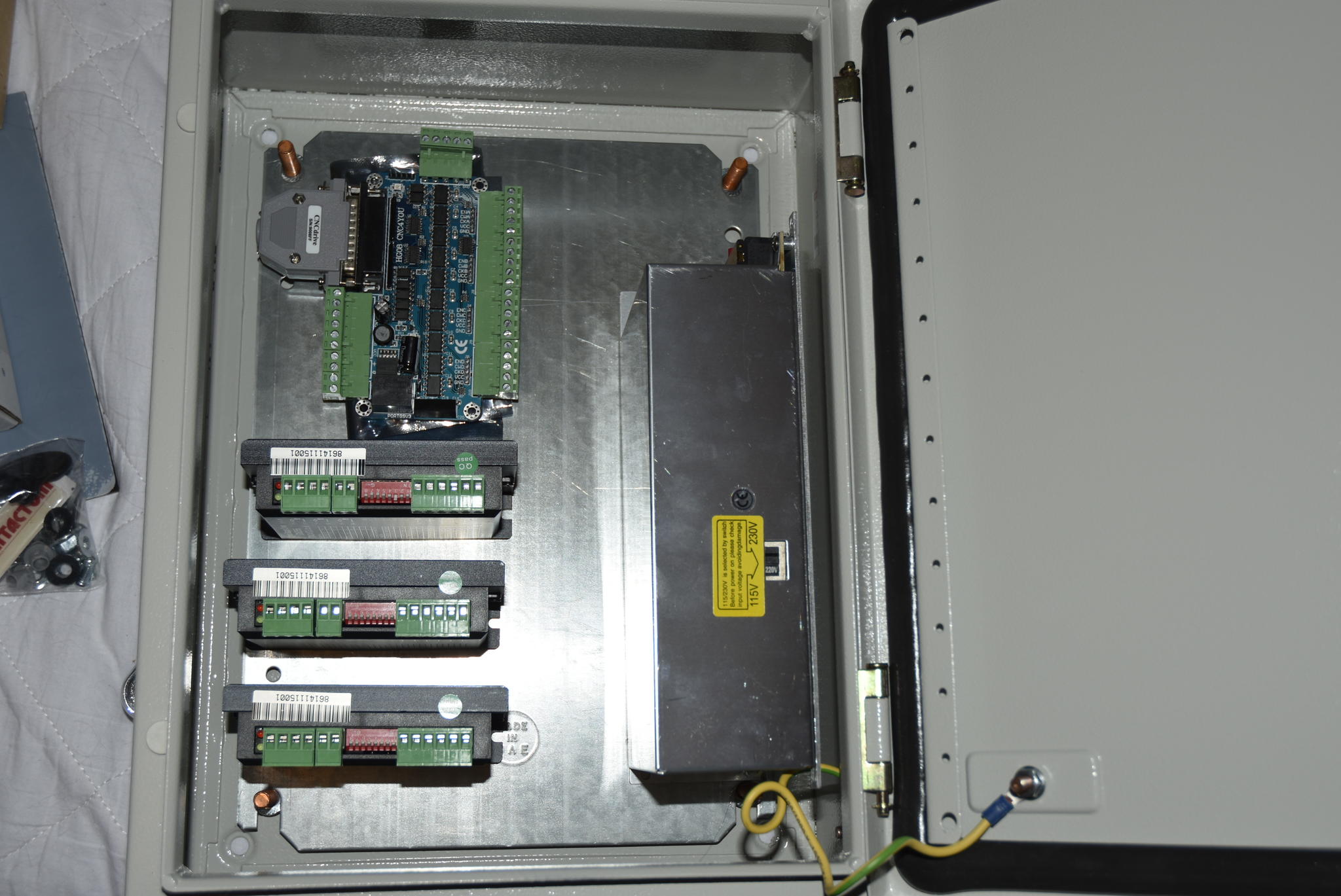

Thanks Jim,
I just remeasured and the lip on the door clears the PSU by 1mm.
Looks like your suggestion is the better one and it does give me a lot more space. I origanlly wanted to keep the PSU flat for ease of access to the screw terminal but I can live with it this way, how many times should I need to access these anyway, famous last words.
Attachment 17142
Dave.

Have you thought about safety relay, estop, fuses etc
Clive S
I bought a EMI Panel Mount IEC Filter 10A from cnc4you to plug the power lead into thinking it was fused, just checked and its not.
I have a red panic button and proximity sensors for the estops.
Not sure what you mean by safety relay

Safety relay, I get it now. I hadn't thought that deepely about it, I assumed the estop and circuit breaker would be good enough.
Hi Dave, looks good. I'm sure the extra space will soon get eaten up with wiring and other goodies like clive mentioned.
I would maybe swap the drives and the bob though and to try and keep the "clean" signal cables away from the "dirty" mains/drive power cables as much as possible?
I think most people would consider safety relays a step too far for smaller machines. They have features monitoring to detect if the contacts have welded shut but many don't worry about it. Really depend on your personal view of safety :)
I picked up a nice one for about £20 on ebay and it also has timed shutdown on one of the contacts which is nice. Can be quite large though and the ones I have seen are all din rail mounted.
Jim

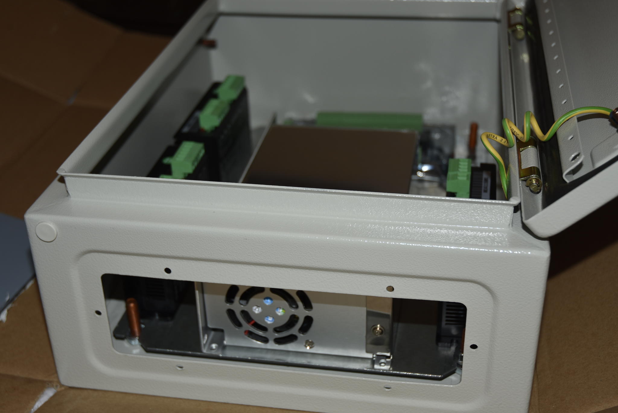

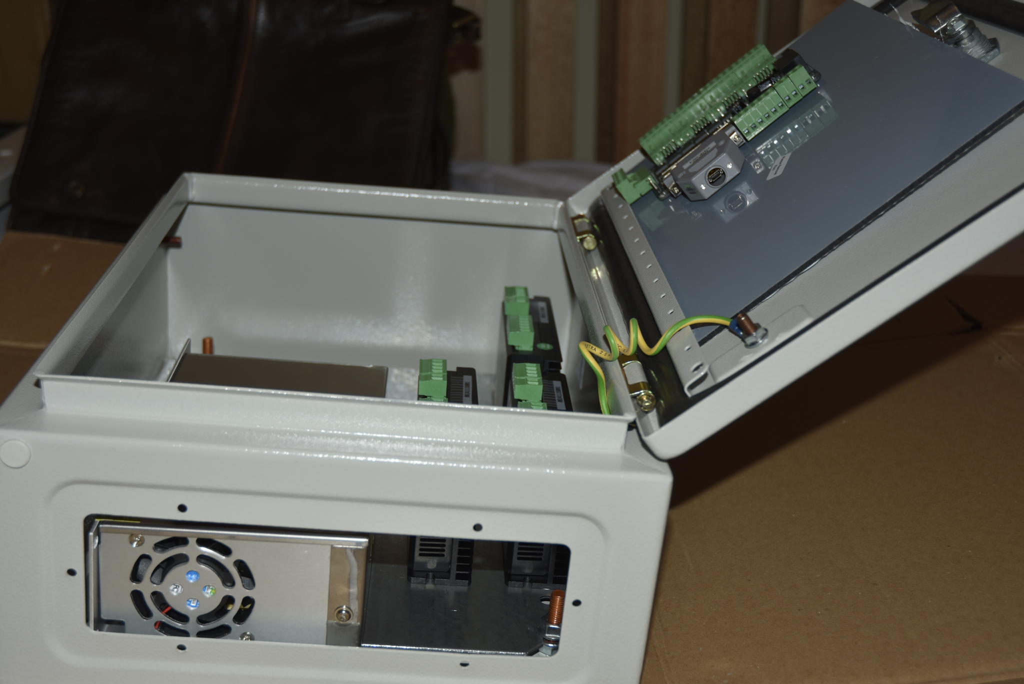

The parts, they produce most heat should be top. On the bottom side your box is open, you should close it with a dustfilter, similiar to the parts used in aquariums. And the heat must can flow out of the box, so you need another hole on the top or upper side of your box.

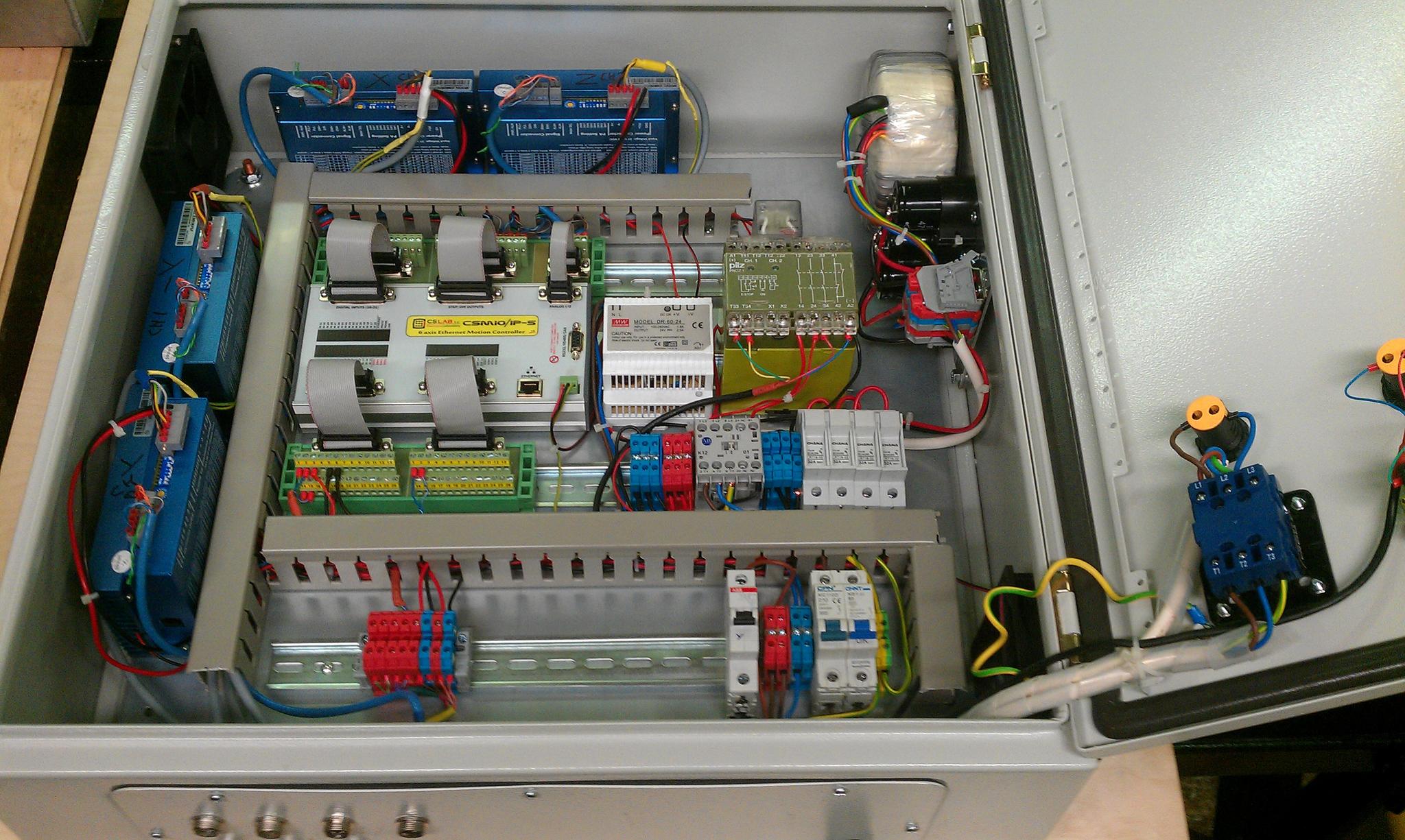

Like cncJim said the space will soon get eaten up. I was limited at the time by the cabinet size i could have so i had to work with that, although i managed to fit everything i wanted in. Dont forget space for the wire runs ect.
http://www.mycncuk.com/threads/8037-...k-Please/page7
There is a pic of my cab in there, your not putting the vfd in so that will help but it may give you an idea.

Cheers Jim,
I am going to mark up and drill the holes tomorrw, I will orientate the drivers so the power connectors are closer to the PSU and route the stepper cables in the other direction.
Im glad you said that about the safety relays, I can see the importance of them but that will only complicate my build at this stage.
Hi Uli12us,
The case comes with a blanking plate for the hole in the bottom, I was going to fit the stepper connectors and power socket into that.
Agreed, some more work does need to be done to provide ventilation

Really that case is little on the small side. You also need to think about heat and removing it with some fans.
Regards layout then first I wouldn't worry about trying to fit it all within in the confines of the plate because the reality is after it's wired you won't ever lift it out.
So I would put 2 drives up one side with one across top. The PSU like you have on it's side on the other side.
Then have the BOB Lower down because most of your wires connections will be coming in thru the bottom ie: Limits, E-stop, probes, etc
All Power and higher voltage wires or devices need to be kept far away from signal wires as possible and idealy run thru separate trunking crossing at a minimum. (See pic to get the idea of layout I mean)
You will need fuses for each drive and the main Psu. Regards Safety Relay then while you don't exactly need a Proper Safety relay with protected and monitored contacts you do need a Hardware driven safety system, which is what Clive S is refering too.
Relying just on Software E-stop is dangerous and shoudn't be used even on DIY router. Don't for one minute think this machine won't snap your arm like a carrot if get in the way, equaly neither will it think twice about ploughing it's cutter thru your hand just like it would a piece of Oak.!!
For this reason you need an E-stop safety system that uses a Relay to kill power to every thing that can hurt you. Then only after it's safe will it allow the system to Reset and Only with a Dedicated Momentery Reset button not just by releasing the E-stop button.
The extra cost is minimal so it's stupid to not do it.
Attachment 17144
Wow Trev,
That is one busy looking controller box. I noticed 3 safety relays in there. Your case looks to be the same as mine only bigger.
I do have a vfd for my mill but I had (its in storage at the moment) this mounted to the wall behind the mill.

Nope only 1 safety relay and one Icecube relay. Yes it's same but bigger and deeper.

Understood Jim, I thought the estop button was hard wired but now I think about it, its only configured as such in the software and can be over ridden. I will be sure to add this along with fuses.
I did consider getting the next case up from mine but just wanted to keep it compact and simple as its just for PCB work with a cutting area of 200x150
My head hurts now :smile: , think Im going to just put my feet up now and enjoy a beer and probably google the stuffing out of this.
I really appreciate all the comments so far.
Cheers Dave

Don't worry just take your time and it will come together. The estops circuit must work no matter what, it must work in a normally closed setup, so if for some reason the wiring fails on it, it will estops. Read other threads where they show schematics and you will see what they are doing, but if your not sure ask and people will help.
With mine I've made a pcb (for ease of wiring and space reasons) that handles the alarms from the drives, limits switches and controls the safety relay. The whole thing is wired very defensive, so if there is a faulty connection it estops for safety. The way to think is one day (hopefully not) you may need that estops button to work and you want to be 101% sure it's going to work when you really need it.
