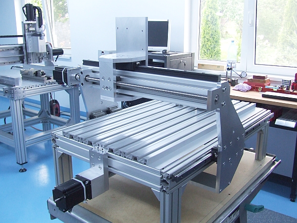

Hello everyone. I am here completely new, but thinking of building a cnc for a while. I had built small router from mdf sheet and drawer slides, so now i want to go for more accuracy.. :)
My aim is to build a machine with this working area: x1500 y1000 and z20 or 30. Not really sure about the Z. As I am now in a early designing stage all the advices are really apreciated. Main frame is going to be from 80/40 and 40/40 aluminium profiles. It will be used for wood cutting, plastic, mdf sheets and similar materials. Thinking about chinese 1605 ballscrews which I see are quite widely used, rails and blocks will be 15mm hiwin. Spindle is going to be water cooled 1.5kW or 2.2kW . Steppers nema 23.
My big question for now is from which width should be used two ballscrews on the longest axis instead of one ballscrew in the middle? I am worried about it can start to wiggle a bit, which off course will affect accuracy. All the sizes of ballscrews, rails steppers and spindle are still considered, it is not my final decision. I found on internet a cnc with the same structure as I am thinking to build, so now you have rough vision what I am speaking about :) Thank you very much!!
Attachment 17196Attachment 17195Attachment 17194Attachment 17197
Re: Aluminium profile cnc build
Hi and welcome to the forum!!
for the size of machine you're looking to build then twin ballscrews are a must, at 1000mm wide cutting (at least 1300mm wide gantry) you'll get racking when cutting off centre with just one central ballscrew. For a 1500mm cutting area you'll need to look at the size of ballscrew you need to use as at this length you're right on the edge of ballscrew whip when cutting fast with 1610 ballscrews (what most people use as they give you the speed you need for plastics and wood) so will probably need to go up to 2010 (20mm diameter) ballscrews which will most probably need Nema34 steppers to overcome the inertia of the ballscrew.
Have a look through the build logs in this section of the forum and inwardly digest all the information that's there, knock up a design and we'll all comment on it and help you :eagerness:

Welcome to the forum.

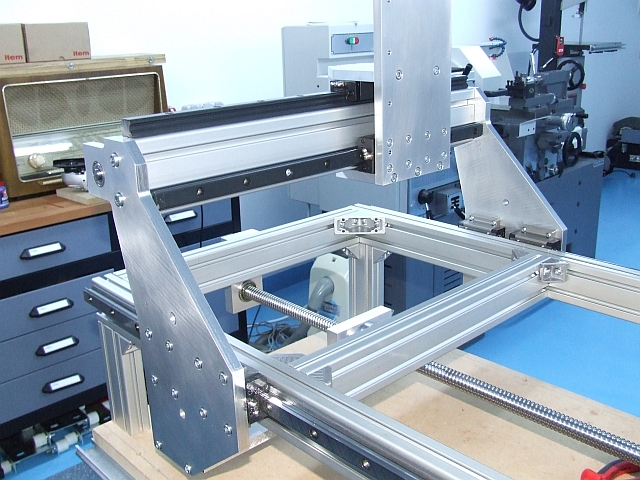

My experience is 600mm is the maximum width for single central ballscrew. Even then you have to be mindful of hard cuts at the ends of the travel, but in general it's fine. Above that it is double ballscrew all the way (or drive from each side anyway).
As Clive mentions single or double motors will work. Draw it out and take your pick. I like double motors as then you can buy lots of the same motor spec and driver and use them on every axis. Not a strong reason, but can make things simpler.

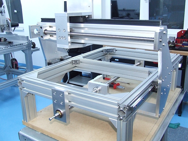

Something to point out is that in post #1 the last picture (5-8.jpg) shows a better machine in the top corner with double ballscrew drive. This will cut wood and plastic well, but you can go a step further than this and remove the gantry sides (weak point) and raise the X axis rails up to meet the gantry cross beam. Use a series of legs to support the raised X axis connected back down to the bed and for not much extra effort you will have a much better machine.
Good luck with the project . . .

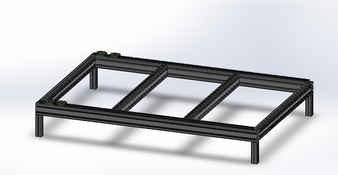

Hi again. After a I while now i am going to put my free time into designing as much as possible. For now i have just several main extrusions with rails and blocks on them. Now want to start to count what exact lenght I need of extrusions, where to place rails and ballscrews, which is quite confusing to start with. I am considering if it is worth to buy custom made rails and ballscrews lenght to my exact dimensions, or it is cheaper to have a bit smaller work area than I wrote in my first post and to go with standard lenght which is 1500mm and 1000mm? I mean how expensive it can be to have those lenghts of rails and ballscrews at those dimensions, which could let me have exact 1500x1000 work area.
Here is the picture how it looks at the moment.
Attachment 17508

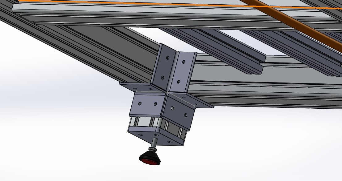

All the corners i am going to join with 90 degree L shape brackets. Do i Need the legs? If yes, then probably it would be nice idea to have a pair of legs in the middle yes?

Hi, sorry didn't see this thread pop up again! You'll definitely need legs in the middle and you'll need cross bracing. Depending on what your bed is going to be made of you'll probably need more cross bed supports...
Yes Sorry I didn't see this thread at all.!!
The machine design you are thinking to build is very similair to routers I build. I can tell you without doubt that you will need stronger than 80x45 to give the cutting area want at this length. 120 x 80 is what i'd use or at minimum 80 x 80.
With correct profile you won't need middle leg and infact you can't have middle legs with this design because of the cross brace between gantry.
The base will need at least one more support. Cross bracing isn't strictly required because the bed base forms part of the structure but it wouldn't hurt having some just to hold resonably square.

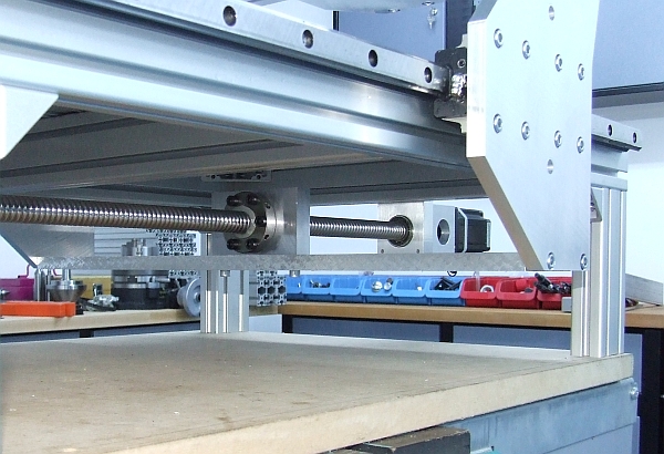

YES. But 2 screws will mean having them on the outside where they are unprotected from Debris. The Cross brace allows you to keep them under the table out the way.

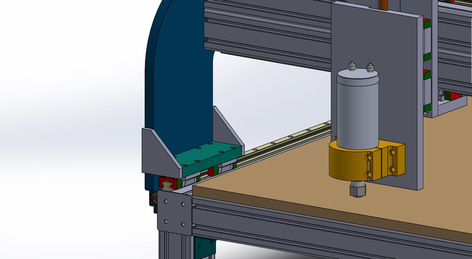

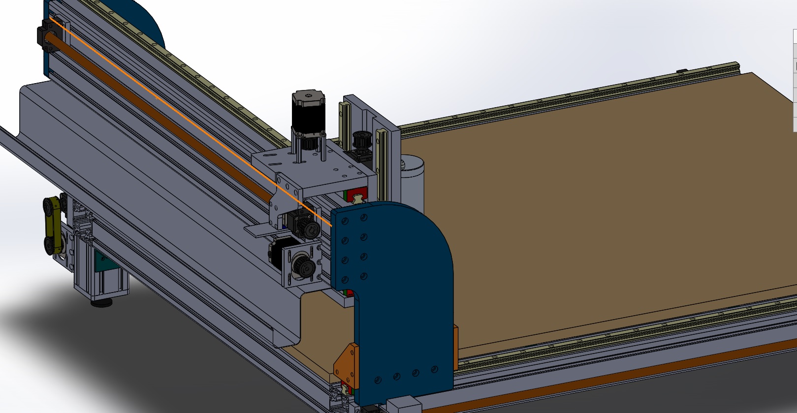

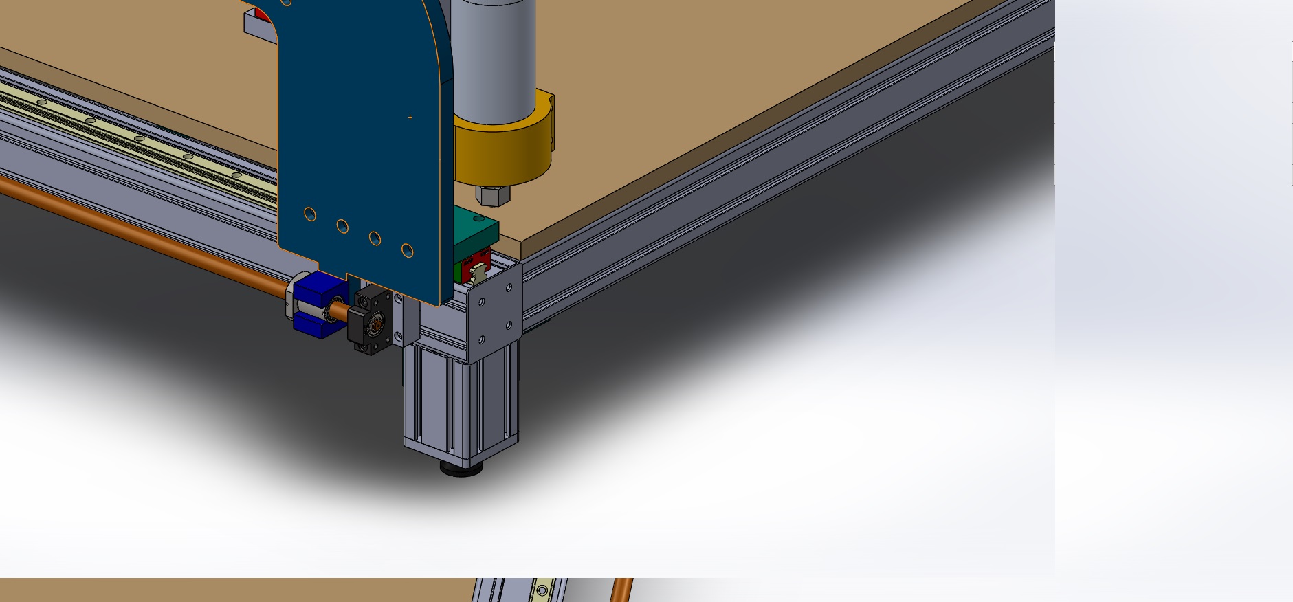

Yes, so today i changed a profile size, and added extrusions as cross braces and as a bed, on which should go plywood, and added adjustable legs. Not sure how it is better to do with middle legs, if i want keep ballscrews under the bed, it means i cant have them in the middle. On the other hand seen a lot designs with screws on the sides, what is better?
About taking screens in solidworks, i take them view>screen capture>image capture and then paste into paint and the quality of pictures when i upload them here doesnt seem as good as seen in other threads, thats the way it should be done or there are some other ways ? Cheers! :)Attachment 17573Attachment 17574
Much much better. Could drop one 40x40 from each section if wanted. Less drilling and material for not much loss of support.
The main difference with screws under bed is they are obviously more protected from debris. This may seem a little detail but in practise it does make big difference to life span of screws and to some smaller degree performance because they don't get clogged with debris.

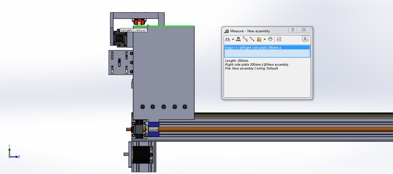

Thank you for you replies! :) Now i need to position rails and ballscrews on x (longest) axis. To do that i think is good to start from side plates then i see where to put rails and screws. Aswell thinking about thicknes of the plate, 20mm would be enough?
I am going to use wide bocks. Wondering what distance should be between them. The lenght of block is 61.4mm if i add 27.2mm between them it will be 150mm. So if am using 1500mm rails the usable travel distance will be 1350mm. Maybe i need bigger gap between the blocks or maybe even smaller? Attachment 17579

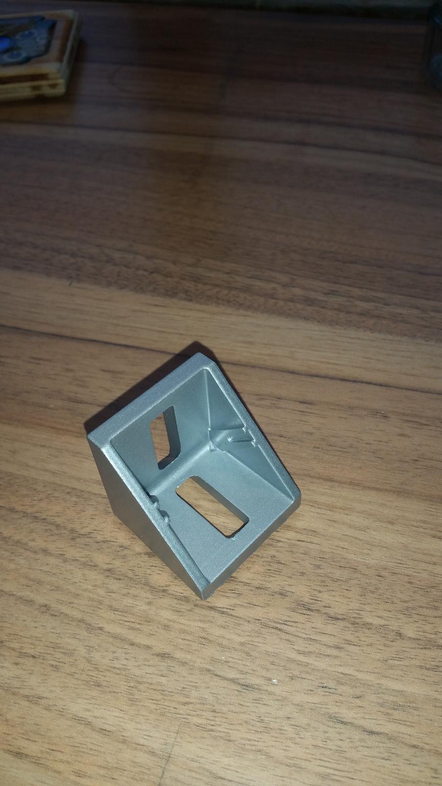

Here are my corners, should be allright? Attachment 17580
I could use anchors, like these Attachment 17581 or even combination of 90 degree angle and anchors under them? Lots of thoughts how to start everything and put together, so sorry if all those questions sound silly :)

Most on here use a distance of about 200mm for the carriages, not sure if there is any scientific reasoning but 200mm seems a good compromise between compactness and giving a sound footing for the gantry.
The other thing you need to bear in mind is not having your spindle dangling too far in front of the front bearing, keep it as close to the gantry as possible. In an ideal world you'd have it between the bearings but then you'd lose cutting area as the gantry would be wide....

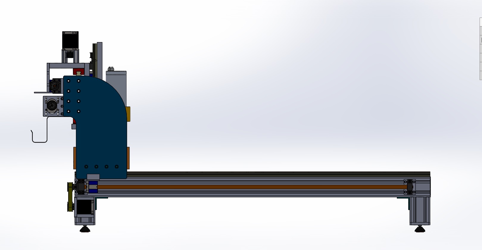

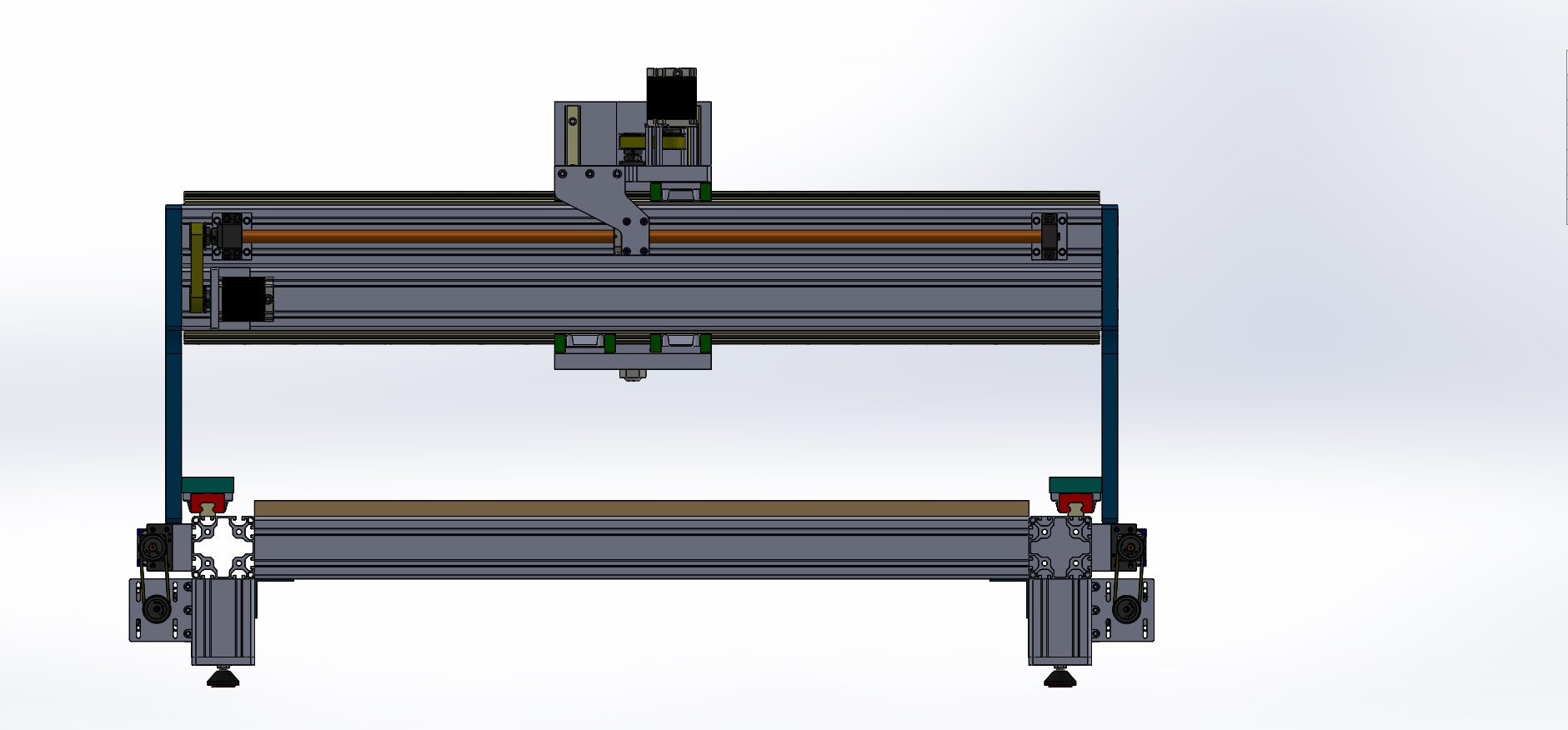

Hello again after a while. Had some interruptions, broken computer, but i am back again with in my opinion more or less final design. Mainly i am going to use it for woodworking, and hopefuly i will be able to machine aluminium at low speed. 2.2kW water cooled spindle should be capable doing that?
Lets start from main dimensions.
X(longer) axis. 1400mm lenght Hiwin 20mm rails with HGW20CC carriages. 200mm between carriages ends. It gives 1190mm of travel leaving unused 5mm of rail each end.
Y(shorter) axis. 1170mm lenght Hiwin 20mm rails with HGW20CC carriages. 200mm between cariages ends. It gives 970mm of travel leaving unused 5mm of rail each end.
Z axis. 330mm lenght Hiwin 20mm rails with HGH20CA carriages. 178mm between carriages ends. It gives 133mm of travel leaving unused 9mm rail each end.
The frame, legs, and gantry is from 80x80 extrusion. Frame cross bracing is 40x80 extrusion.
All the plates are 20mm thickness except Y axis ballnut housing connection plate (which is 10mm thickness) with Y and Z axis assembly.
For bed i iam going to use 20mm plywood sheet.
Have 4 adjustable feets in all corners. Do i need in the middle aswell?
Attachment 18889Attachment 18890Attachment 18891Attachment 18892Attachment 18893
All extrussions will be clamped with 50x50x3 steel brackets:
Attachment 18894

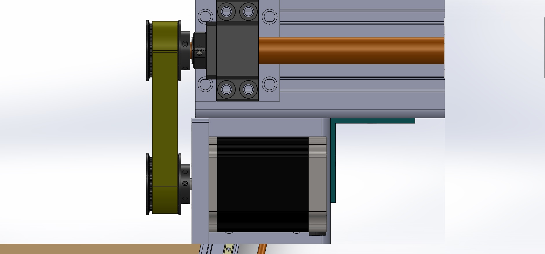

I am using 1610 ballscrews for X and Y axis, and 1605 for Z axis. Pulleys on all screws are htd 15mm wide 5mm pitch. Have 20mm slots for belt tensioning, and for ability to go for different gear ratios. I see that these pulleys are most comonly used. Are they the best option for me?
Attachment 18895Attachment 18896Attachment 18897

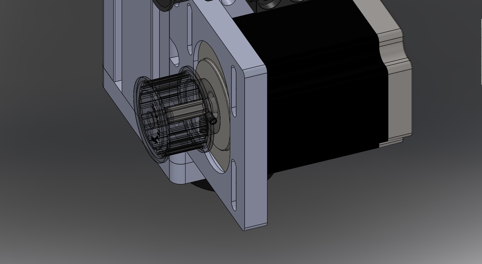

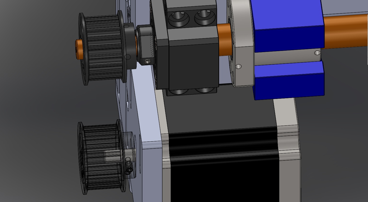

The question if it is enough of shaft inside the pulleys? With standard ballscrew end machining it doesnt go trough all the pulleys bore. I left 1mm gap between pulley and BK block. The same with motor, 1mm gap pulley and motors bracket.
Attachment 18898Attachment 18899

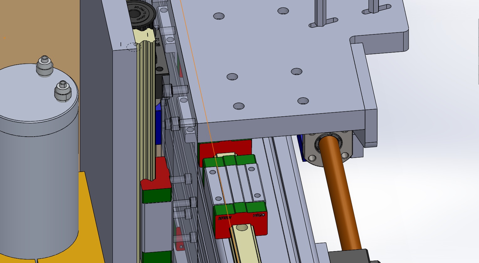

And about Z axis. I have sandwitched ballscrew and mounting blocks between the plates so I have 9mm cutout in the front plate.
Attachment 18901
Z axis motor is angled because with sraight slots motor spacer was in belts way. So now the belt is going right between the spacers.
Attachment 18902Attachment 18903

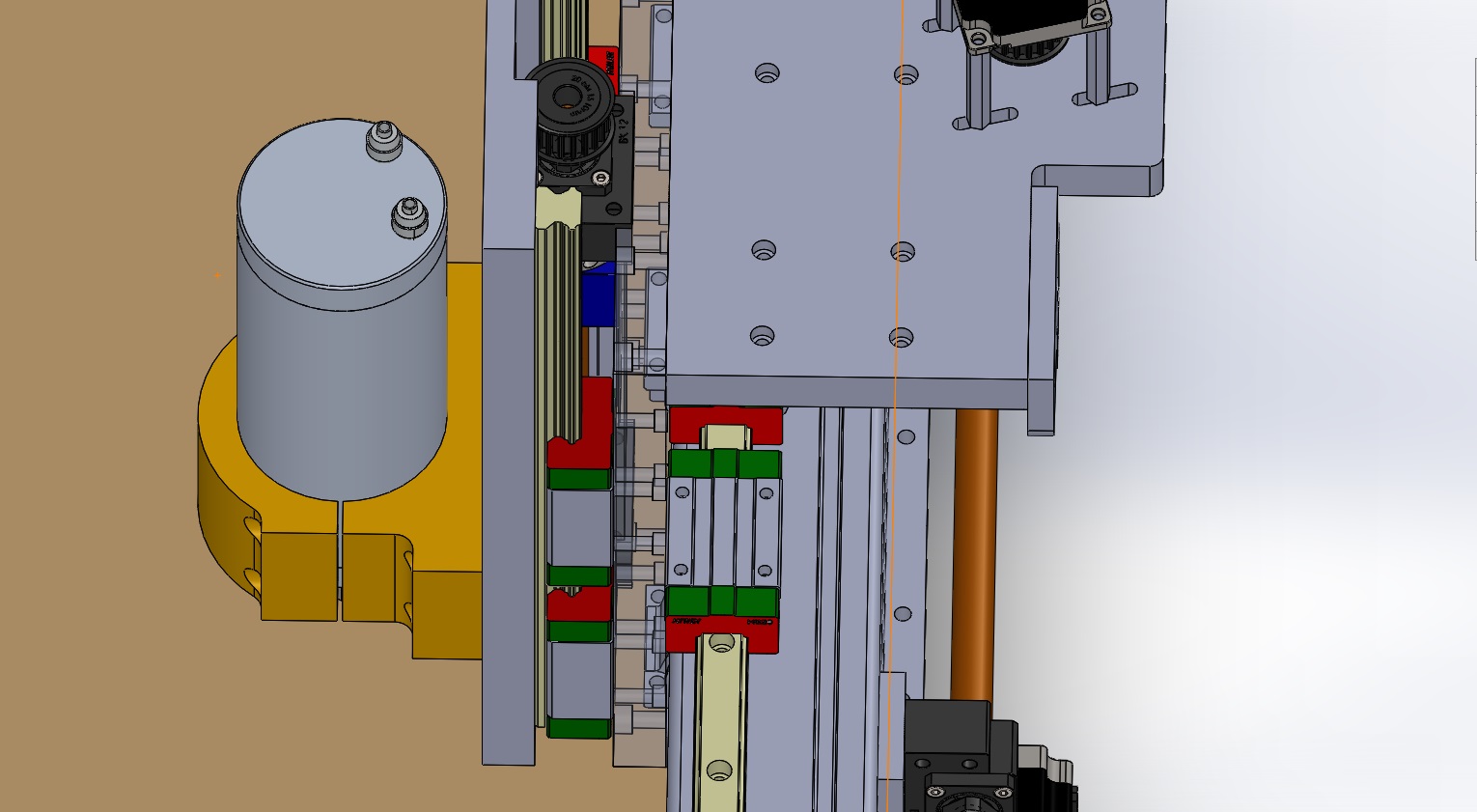

Another question is what spindles positioning is the best? Here Z axis is all the way up:
Attachment 18904
And all the way down:
Attachment 18905

Before ordering all the mechanical parts would like to get some comments from all you. Maybe there are some weak points, or something. There is always something can be done better, so others can see it better.
I Dont have any parts bought yet, except i have high indtuctance stepper motor from my previous build and tb6550 drivers with BOB which i am not sure if to use them.
Thanks!
You would cripple the machine if you used them. Have a look for AM882 drives and nema 23 motors from Zapp or CNC4you.
Re the screws you will probably requite the F dimension to be about 30mm it doesn't cost much more to do it right.

I changed ballscrews shaft to 30mm in it is sticking out a bit. And I saw quite a lot people are making it from 15mm to 30mm. It is not a standard? They can do any dimension i like or not?
And how about motor shaft? I could cut out a bit depper in the bracket but it will start to loose its strenght, isnt it? At the moment i am using 10mm plate and motor is 5mm in it. Do i need to go deeper?
How deep it is:
Attachment 18910

The conventional way is like this Attachment 18911so the the motor will stick through. The motor shafts are normally OK. 2-3mm is OK
I opened the bracket the same like you showed me, but i still have 8mm left. I checked motors dimensions and pulleys dimensions all seems ok. Where that difference could come from? Maybe you are using different pulley?
Attachment 18921
valdis034
Attachment 18921
The shaft on a nema 23 from Cnc4you is about 22.5mm long.
The one in my drawing is 20.6 mm and it is exactly the same like in any drawing you could find on internet with nema 23 dimdnsions. Double standard?

Is your measurement just to the end of the key in the shaft?
http://cnc4you.co.uk/resources/Stepp...1B%203.1Nm.pdf
My motor shafts don't go all the way through the pulley and have been running fine for years.
If it is more than half way into the pulley and the grub screws have a good lock onto the shaft I don't see any major problems.
Just looked at my Z axis and it looks a little like this.....
http://uploads.tapatalk-cdn.com/2016...717ca50bda.jpg
Shaft is 3/4 the way in the pulley and held on with 2 off M3 grub screws @ 90° to each other...
http://uploads.tapatalk-cdn.com/2016...bf67805a6d.jpg
Plate thickness is 3mm so 17mm pocket machined out the plate.
So do we actually need that thickness of a plate if anyway we are machining almost all the through the thickness?
Išsiųsta naudojantis SM-G900F Tapatalk 4 Lt
It has to have some inherent stiffness to stop any bending forces from the belt, I had it 20mm thick as it came out the same sheet as the rest and I needed the thickness to put the M8 bolts into....
So in my case i have it 10mm and attaching it to the other plate with M6 screws. Is that allright?

In which point you would need more details? Just let me know. I tried to give screenshots of every important point, but if there is something you would like to see i can put them in here.
How about the whole frame structure, z axis and things like that?
What is the other plate.?

My "other" plate is the one on which is going motors mounting plate and both of them are making 90 degree angle. And whole this assemble is mounted onto the leg.
About the shafts in my model they are the round ones whitout key. So i will go for the key shaft for longer shaft and better grip for grub screws.

Valdis in Reply to your PM then can't see any major issues with the design. Couple of small suggestions but other than these nothing seriously wrong.
#1 I would brace the connection between bearing plate and gantry side.
#2 Would bring the rails on the Gantry to front slot to lessen the lever affect.

JAZZCNC
#1 If I move rails to the front slot i will have bigger gap between gantry and Z axis back plate (at the moment it is 3mm) if I am using wide carriages. Maybe i could use the narrow ones the same like on Z axis?
#2 How i could brace that connection? I have some of these so i could use them.
Attachment 18930
They are 40x40 and 6mm thickness.
OR this version?
Attachment 18931
valdis034
I was going from your pics which looked like wide gap between z rear plate and gantry profile. Without seeing better view then can't comment further.
valdis034
No wouldn't use those and would go with something like your second option.
2 Attachment(s)
Here it is. Between narrow carriage and gantry profile side is only 2mm gap, and the same dimension for wide one is 11.5mm. So the question is if I benefit a lot from wide carriages?

Some small update from me :)
During last days as i been advised moved Y axis rails to the front slot, then made a bit smaller plate on which going Z axis motor so saved some unnecesary weight. Now trying to find out the cable routes..
For the cables and water pipes on the gantry I done a channel from 1mm sheet metal just to see how it looks. Not sure if it will be strong enough to hold the chain.. Any suggestions on that?
Attachment 18979Attachment 18980
