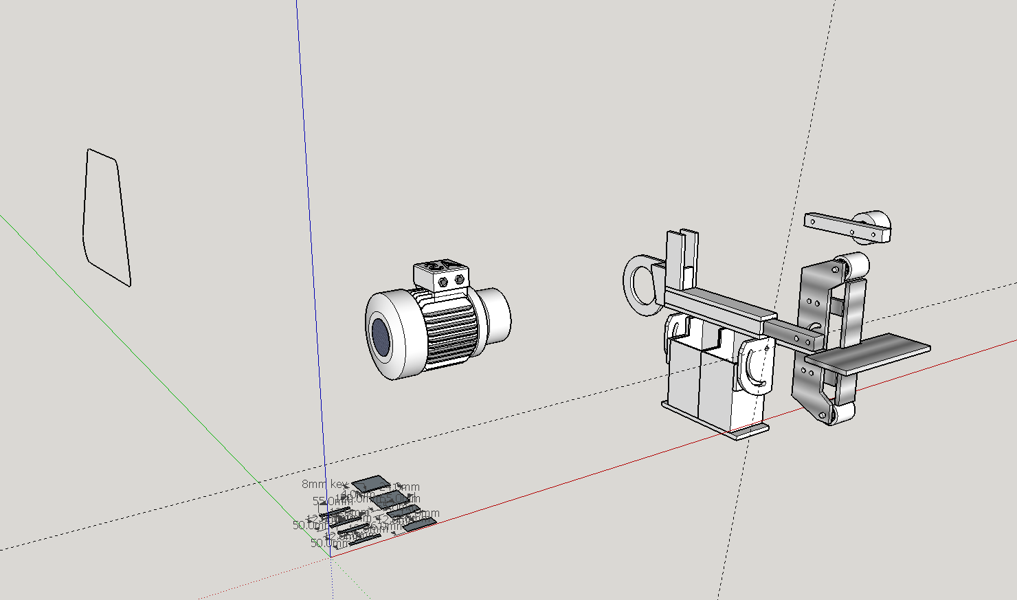

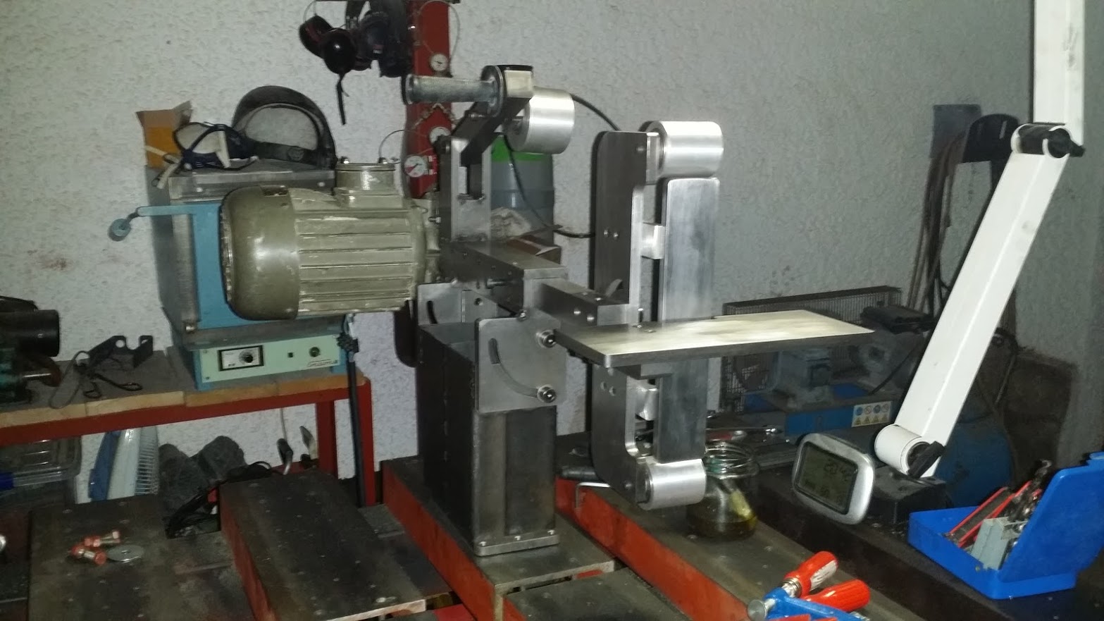

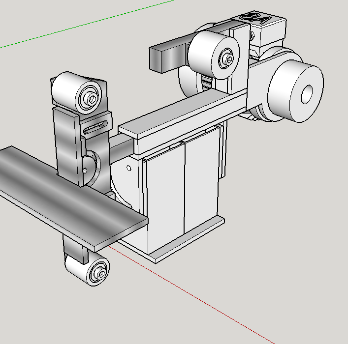

Hi guys,
Now, whats that with the metal these days? Still have not finished my CNC as i have no free time, but already designing and making my metal belt grinder:joker:
I must be in my "heavy metal" period again, which i thought was long gone.

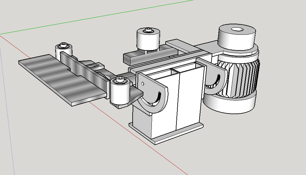

So after analyzing all on the market and most of the DIY plans, i decided to designe it from scratch but based on the successful designs.
-First decision was that it will accept standard metric and imperial belts at the same time - 2x75" and 50x2000mm. No need for wider belts.
-It will be overbuild. I hate vibrations from machines. if you know me you will be no surpised that it will be OTT. Come on, only 20 kilos more but a lot better. That 20-30 euro more in a project that will make me spend 400euro, so yeah..
-It will be a precision grinder. No surprise here also. All from calibrated cold drawn steel bars and plates / as they are the same price as the normal /, massive arms and steel shoulder screws for tightening the bearings and wheels.
- tilting 90 degrees. Thats a detail. Not that i intend tilting it but spending so much money i decided it should do all.
At a later time will start updating the build with pictures and more details. For now some snips of the design.

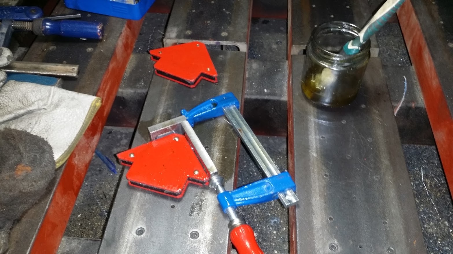

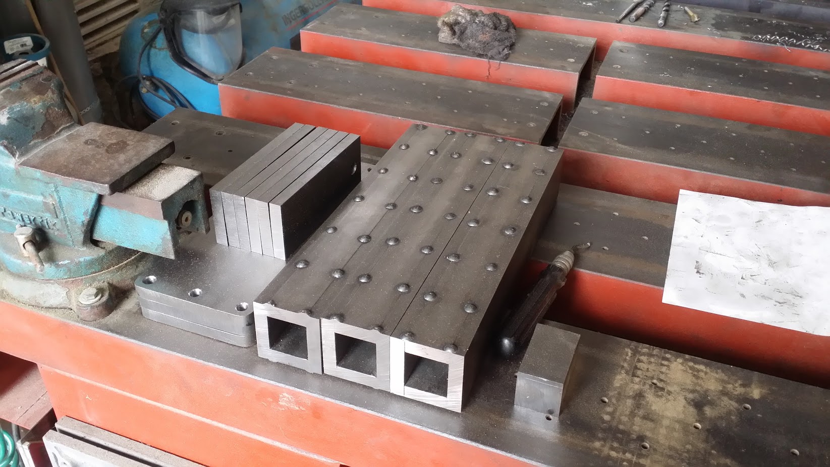

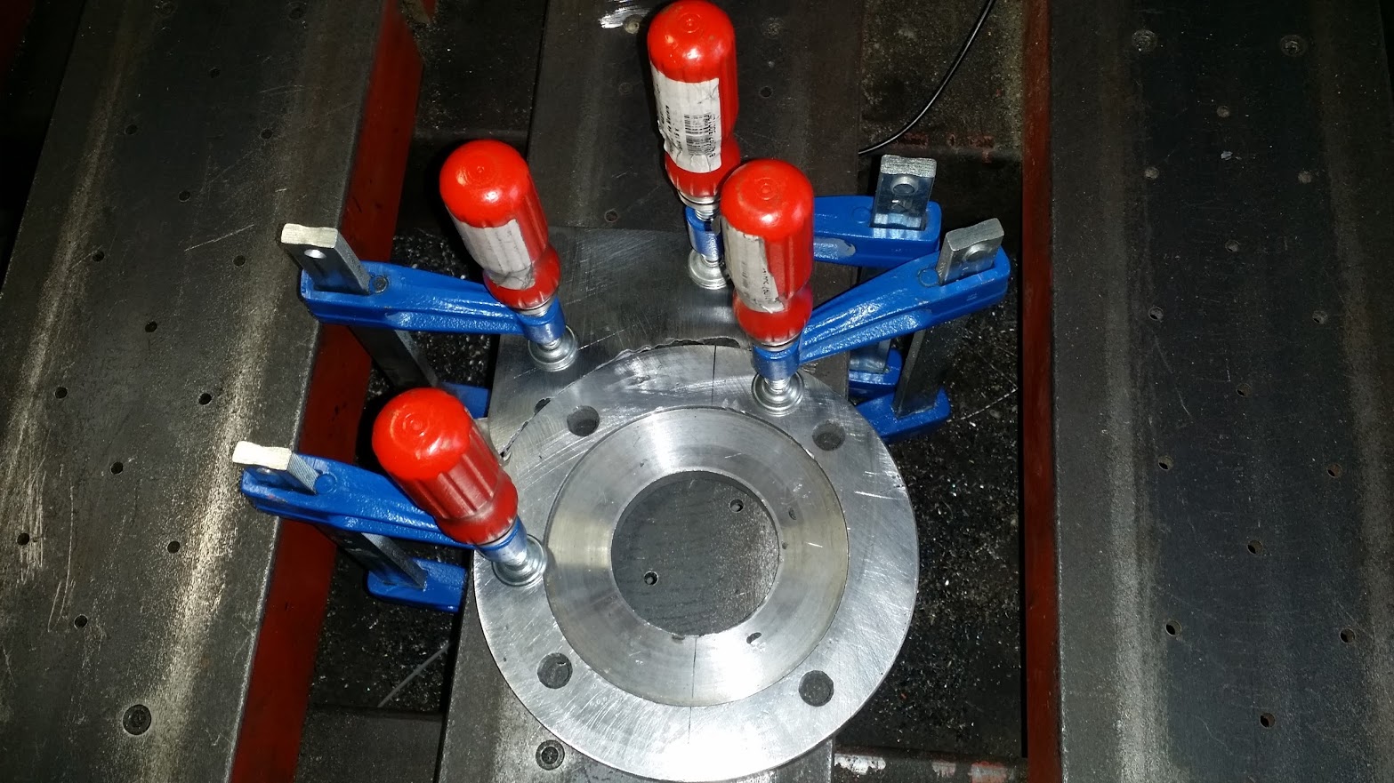

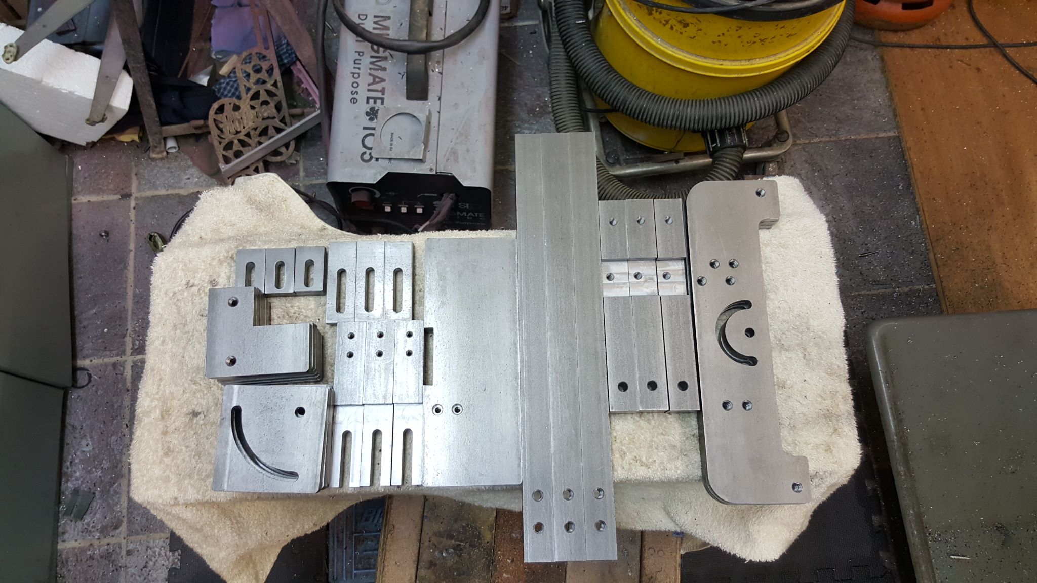

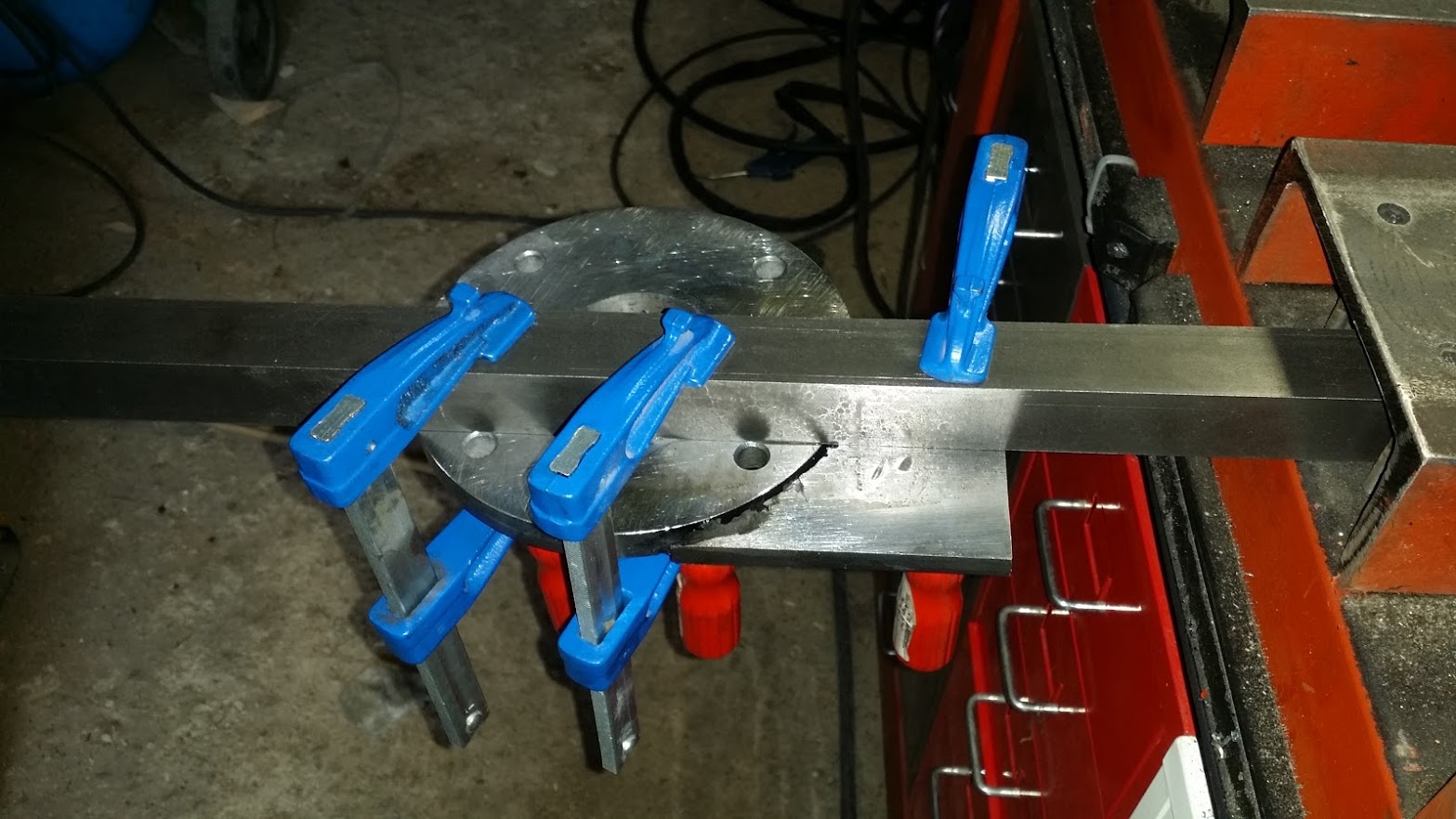

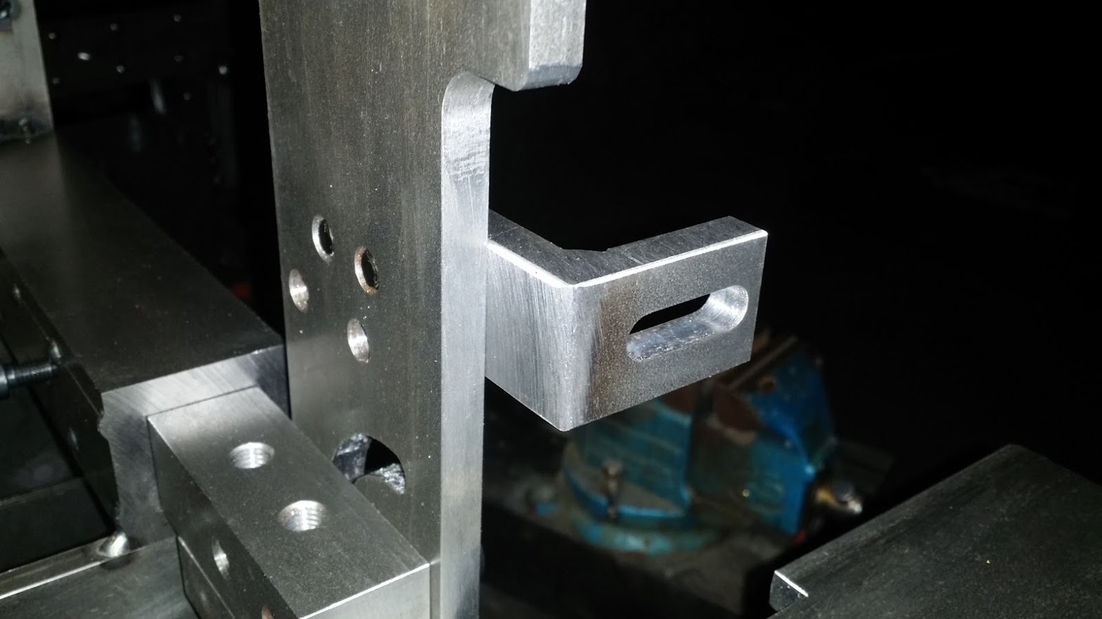

Some update with pictures. I am actually making 3 machines, one for me, one for Jeff/ fellow forum member and friend, that lives around/ and one for sale. I think of that as prototyping :-)
Cut the steel and made some pieces:
Attachment 17433
Jeff cut the main pieces ,that had to be precise, on the mill. In future all will be plasma cut on my machine but as i still have not finished it...
Attachment 17434

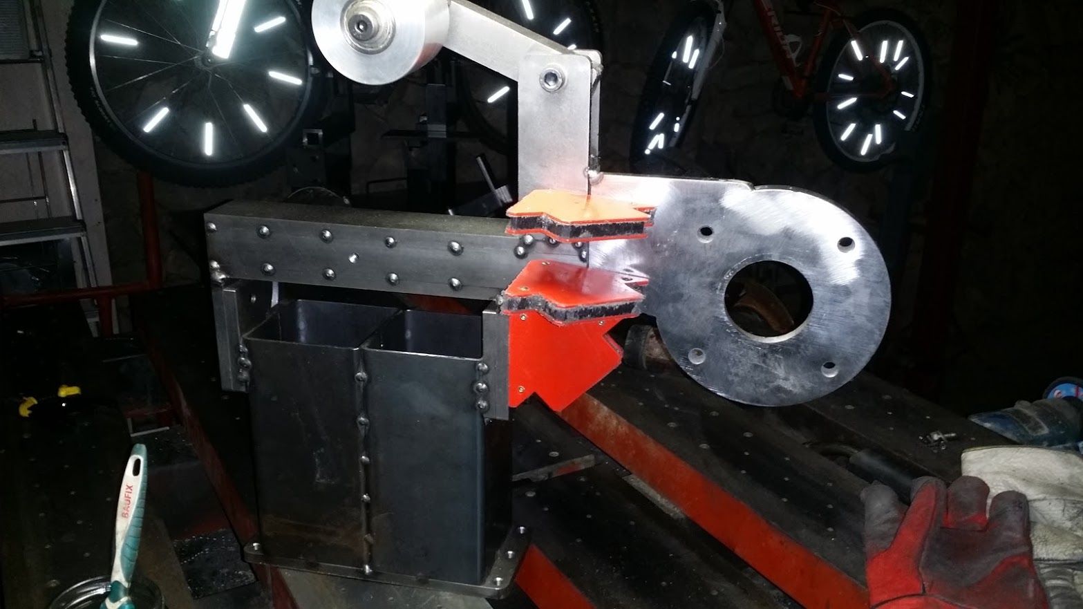

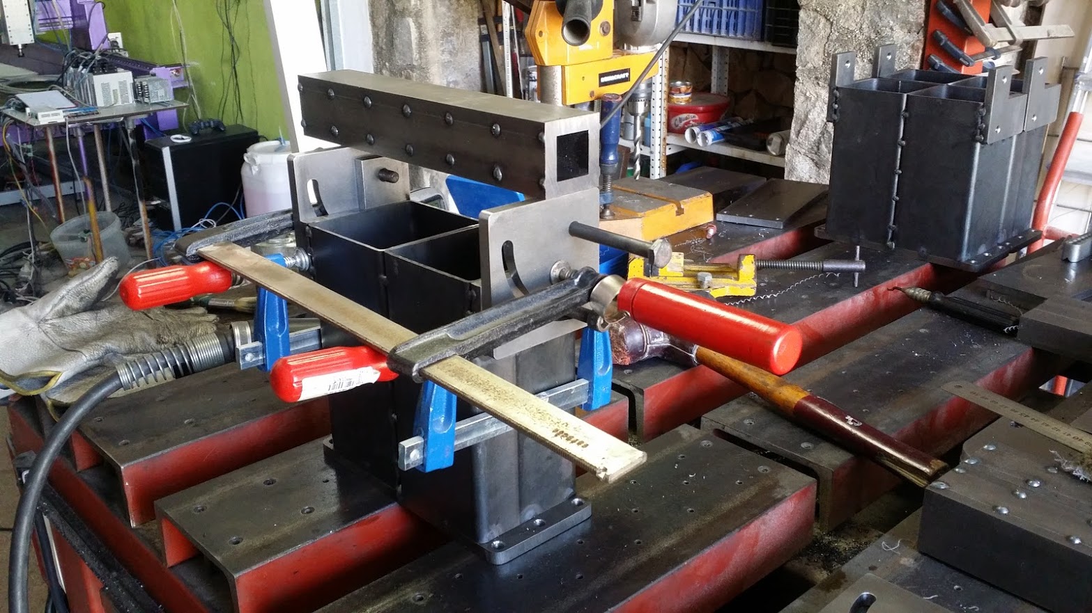

So i started assembling this and that, welding , sanding and squaring:
Attachment 17435
Attachment 17436
people go at restaurant Saturday night , instead 22.00h i was still welding brackets yesterday. Yeah, i was using olive oil for protection of surfaces when welding, drilling and threading, so it smelled like in restaurant around here
Attachment 17437

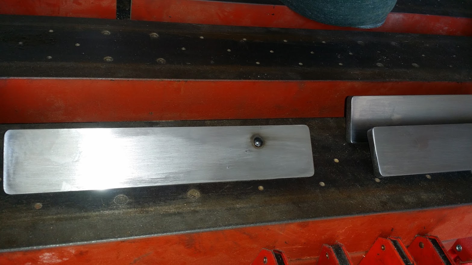

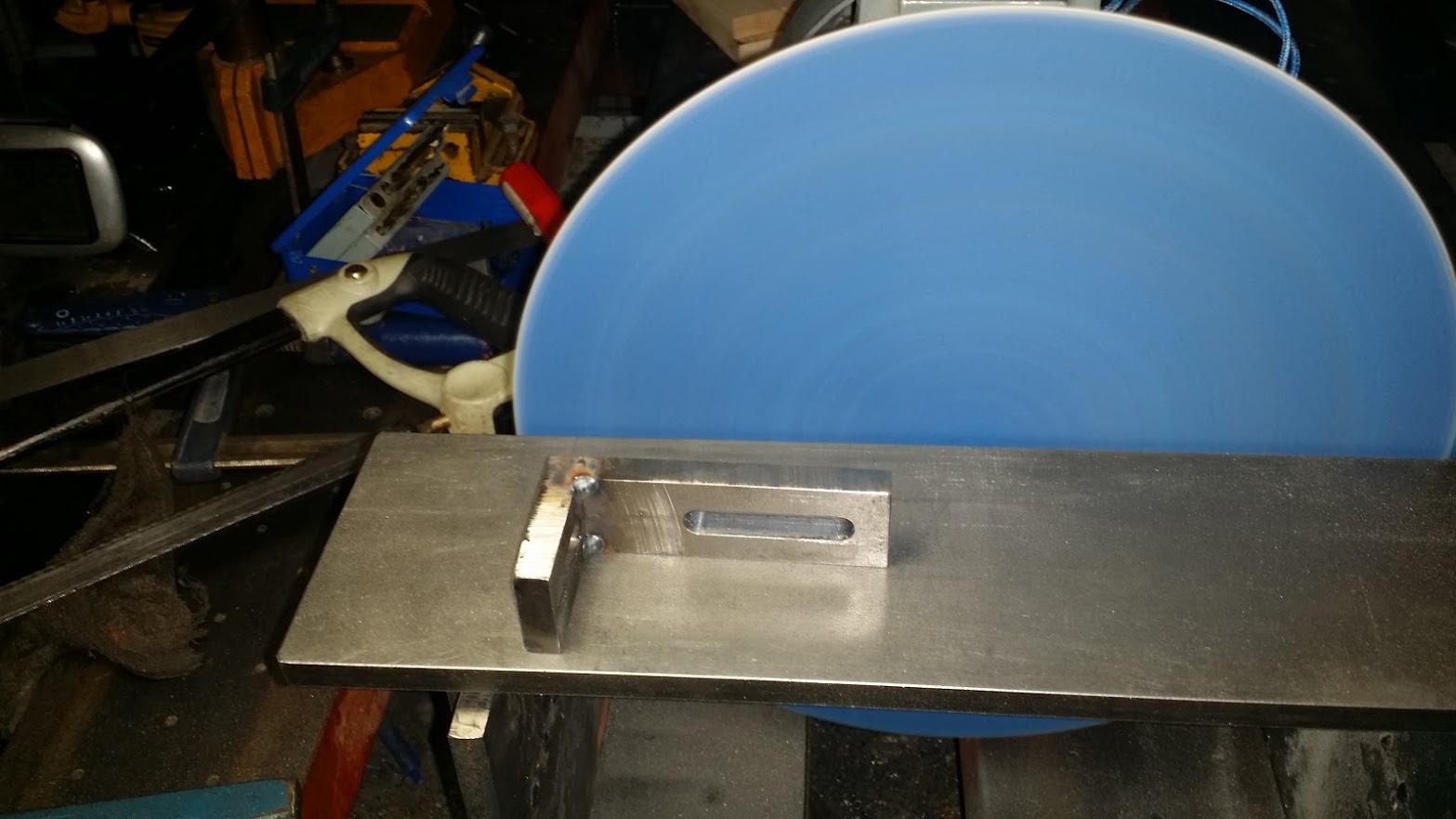

sanding the bracket on my diy 12" disc sander made from 12" diamond disc welded to the pulley and 0.75kw motor.
Attachment 17438
brackets ready
Attachment 17439
the plate that goes on the bracket has 2 screws each, one side only, at the other side i sanded the weld and welded again until pits disappeared. not to speak of that even threaded the hole before welding, as i want all to be very precise
Attachment 17440

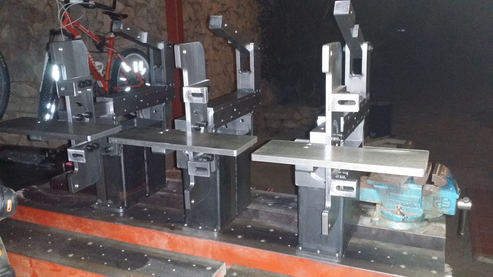

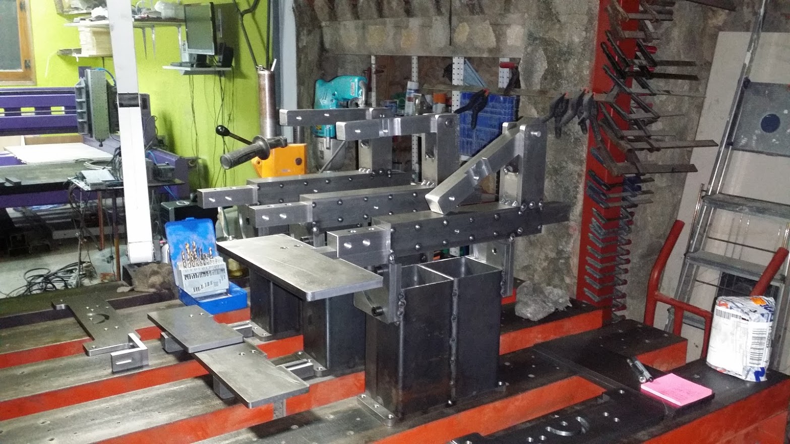

The machines without the face plates and the pulleys. tomorrow jeff wil bring me the pulleys, bearings and so, so only thing left is motor mounts . Both motors are 3 phase with VFD.
Attachment 17441
I think that will be one of the most used machines in my workshop, hence the idea to make it as good as possible. What do you guys think? You like them?

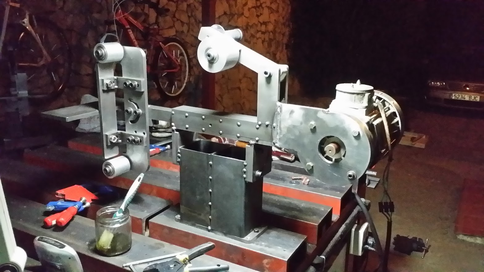

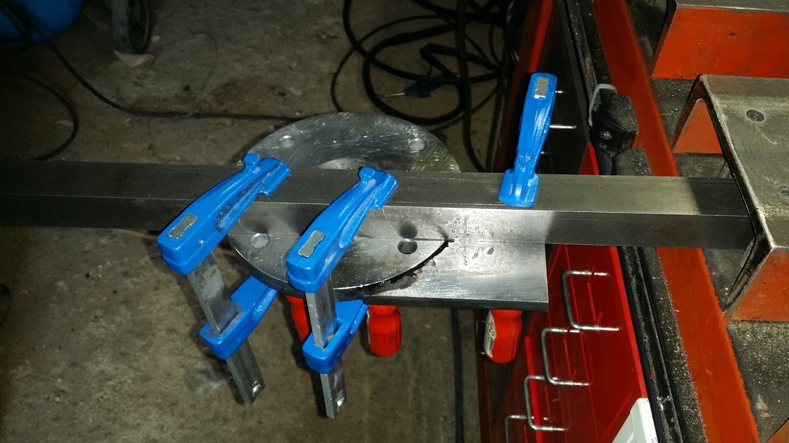

OK, some more:
Welding the motor mount bracket that i cut from the original machine, as i savaged the motor from the junk yard. Clamped both pieces to the table first and then to a bar, then welded very carefully so not to distort the piece, as all wheels must be on one surface flat, otherwise belt will want to go left or right.
This is or ideally must be a very precise machine. First to be functional at all, then to be quiet and free of vibrations.
Attachment 17529 Attachment 17530 Attachment 17531
The belt grinder is meant to be used with using minimum 1.5kw 3 phase 4 pole motor and VFD. Now i had 3kw motor and in the same size and frame,plus Siemens 3kw VFD, so can you guess what happened :-)
Attachment 17532 Attachment 17533
Now as i dont have physical grinder to see in real life, judge or copy from, some things are not clear, so instead of finishing all 3 machines i will leave it here and start trying this one to see how it works.
For example:
-welding the bracket made so that the tooling arm could not pass through further from the end of the square cage, and according to my calcs there is no need to. The motor bracket and motor are there as i put them there for the reason of when 1.5kw motor its easy to flip machine to horizontal. It could be made more compact but then it must be much higher, so some decisions have to be made for future ones.
The paint. Probably industrial epoxy as its the best i could do here. The color is clear though as Jeff like that color, so i decided i would not insist on strange colors. It would be the aquamarine of Myfords and Bridgeport. Does any body know the exact color name or code?
Asking cause on all pictures they look to have different color/ poor white balance on camera/ . The second one seems right to me on my color calibrated monitor.
So any hint on the color?
Attachment 17534 Attachment 17535

Erm I'd say the error was the spot welding.! . . . Doesn't look good or strong. Great for proto typing but not for real thing. It needs proper welds to give it credabilty as industrial strength tool.!
Re: Belt Grinder 2x72" and 50x2000 mm
JAZZCNC
I feel that too. Nothing will go out from here that could be broken by hand and a hammer. And you are absolutely right, now i could take the hammer and certain pieces could be broken apart for seconds. When all belts are spinning and i see everything is working correctly there would be proper welds where necessary. The other thing i will do is blacken all bare steel heating it with the gas torch to 315C.

Well next time do your self a favor and grind Chamfers on the edges will give stronger nicer welds. Created your self lot of grinding now or ugly proud welds.
JAZZCNC
Where was important and i was sure that will not need to break it apart its done like you say. The machine is still not finished.

Have almost finished the 3 grinders. There were some details that slowed the process, now more or less everything is clear.
Welding the motor mounts, trying to keep things on one same plane:
Attachment 17875Attachment 17876Attachment 17877Attachment 17878
Grinding away the spot welds, drilling holes, making stronger weld...only on one of them. Too much works and then i had to make it flat. So i decided to stop there and the other 2 only were reinforced where necessary.
Next time as i know now which weld first where and how, i will just do all pproperly.
Attachment 17879
Then some painting:
Attachment 17880Attachment 17881Attachment 17882
Too much paint mixed at once? No problem some but not all that was upgraded at home:
Attachment 17887
Now the blackening, heating the steel at around 300C. Then brushed in olive oil when cooled down. The oil made them even darker after some time. Very happy with the result, last 2 pictures.
Attachment 17883Attachment 17884Attachment 17885Attachment 17886
Now why its called prototype, and why as Dean said it is good to be done one by one. I knew it could happen and was sure that i have avoided it but...as i have not designed the future 2 attachments, it happens that belt would interfere with one of them
Attachment 17888
This is what took me most time. Deciding on the spring, finding the proper spring, tension, length and how to fit it on the machine correctly so it willnot mess with the belt and the future attachments. Main problem being is- this is the shortest spring i was able to find at that rating.
I finally was happy with the result, so version .01 was born On right picture is Jeffs grinder, we left his motor as he does not need it for making knifes so no future attachments.
Attachment 17889 Attachment 17890
Finally mounted the handle, at the end it happens upper side of the arm is best and easiest. Then the VFD and motor. Cut some scrap belt and started the machine to program the VFD. Boom. The fuse goes down at home. Again, and again. Half day later after some research i went to the conclusion -"leak current" from input capacitor filter. Bloody hell, so i started reading the manual. Good old Toshiba. have made a switch on the VFD that can deal with that changing the capacitance. clicked the switch and all is working.
No vibrations. Super quiet. Not so when i mounted the old belt which is quite bumpy, the connection where is spliced. The belt tracked easily though but makes some noise.But as machine is heavy even that introduces no vibrations.
I am quite happy. Worked from first time. Tracking is perfect, speed is right. I dont see that machine without speed control though, i can not stress enough on that. Did some test grinding today and is super important to control exact speed at every moment.
The other important detail is that the 2 rollers at the front are fixed by spacers and shoulder bolts. So these 2 holes were drilled on the mill and hand tapped. That could not be. The must be machine tapped. hand tapping M10 is you could make it straight or not. Had to redo them a couple of times. As i have no M10 machine tap i bought yesterday. Next time will make tapping fixture similar to drilling holder, where shaft passes through a bearing and use driver to spin the shaft, so its clutch does the job of releasing when too much resistance.Though if needed, may be its the time for tapping head.
The video is a bit shaky but you could get idea what happens
