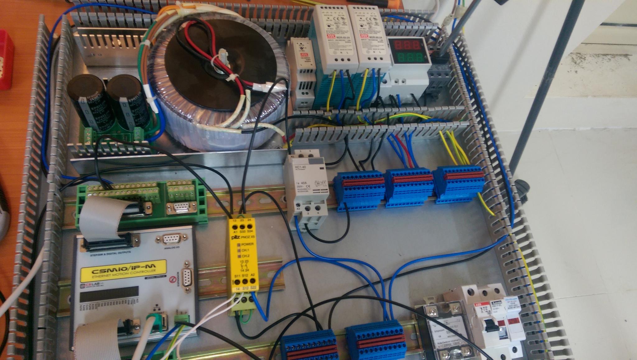

Hi guys,
first just a photo of the new enclosure in progress:
Attachment 17258
Sorry I haven't prepared a diagram of my setup but just a quick explanation: main power comes through to disconnect switch and then a simple volt amp meter, then to single pole circuit breaker and then to distribution terminal (black wire is live, blue is neutral and yellow/green is ground)
from there connects are made to two 24v power supplies and again 2 more distribution blocks for the 24v lines, and the other power supply only for CSMIO main power.
after that output 0 of CSMIO connects to the PNOZ safety relay which activates the AC contactor to turn on the big power supply at the top left.
it all works fine except I'm noticing the contactor gets hot quickly and not sure if that is ok or not.
its pole voltage is rated 24VAC, and I'm turning it on by 24VDC, I assumed its ok based on some quick reading but now I dont know.
last read temperature of contactor reached 50C . if it is not suitable or because its cheap quality can you please recommend a good one? to turn on by 24VDC and drive to contactors (one for motors drivers and one for spindle VFD)
this is the one I purchased http://www.amazon.com/gp/product/B00...ilpage_o09_s00
although I'm confident in what I'm doing I'd love some tips and guidance on anything related.
thank you!

You have diagnosed this yourself the contactor will get hot if you run the coil on DC as it is has an AC coil in it. The DC coil will have a higher resistance. So you will have to change it.
Looking good though. Not sure you need two 24V power supplies.
It would be nice to have different colour cables for the DC side of things than the 240V AC stuff.
Re: Need assistance with electric enclosure please (CSMIO/AC Contactor issue)
Simple Change the Contactor to DC type.

Clive the way the Cslabs units works to keep complete isolation the manual advises using separate power supply for I/O. SO that's probably why.?

Ok well you can only have one or the other control the Contactor other wise you defeat the point of HVEnable. The point of HV is speed so no point having the Safety relay tell Controller E-stop happened then HV shut down contactor because it's actually longer.
So the Answer is you control Both directly with E-stop using two contacts on the E-stop.
One Contact controls the Master safety Relay which you then use for System Reset and any other things you want to Kill power to like, Vacuum, Coolant etc etc.
Then have the other contact control the E-stop INPUT which then Controls HV OUTPUT and Contactor which turns on Main Drives PSU.
This way you still have Safety Relay in charge of Reset system but with the faster HV in charge of the Drives power. The HV will only turn them ON when Mach is Reset. The system Reset will only turn on Safety Relay when E-stop is clear so the System will re-set and at same time E-stop Input on controller is clear so HV is safe to turn On when Mach is Reset.
Hope this makes sense.!!
Edit: If you want double safety run the HV Output wire thru the Safety relay Contact before going to Contactor. This way if Safety relay fails the PSU will lose power.
