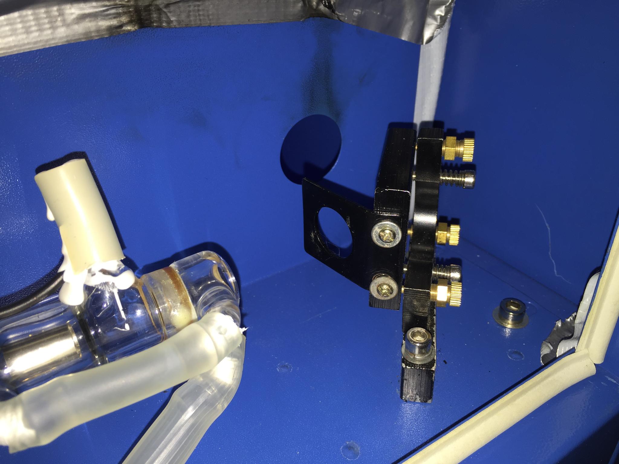

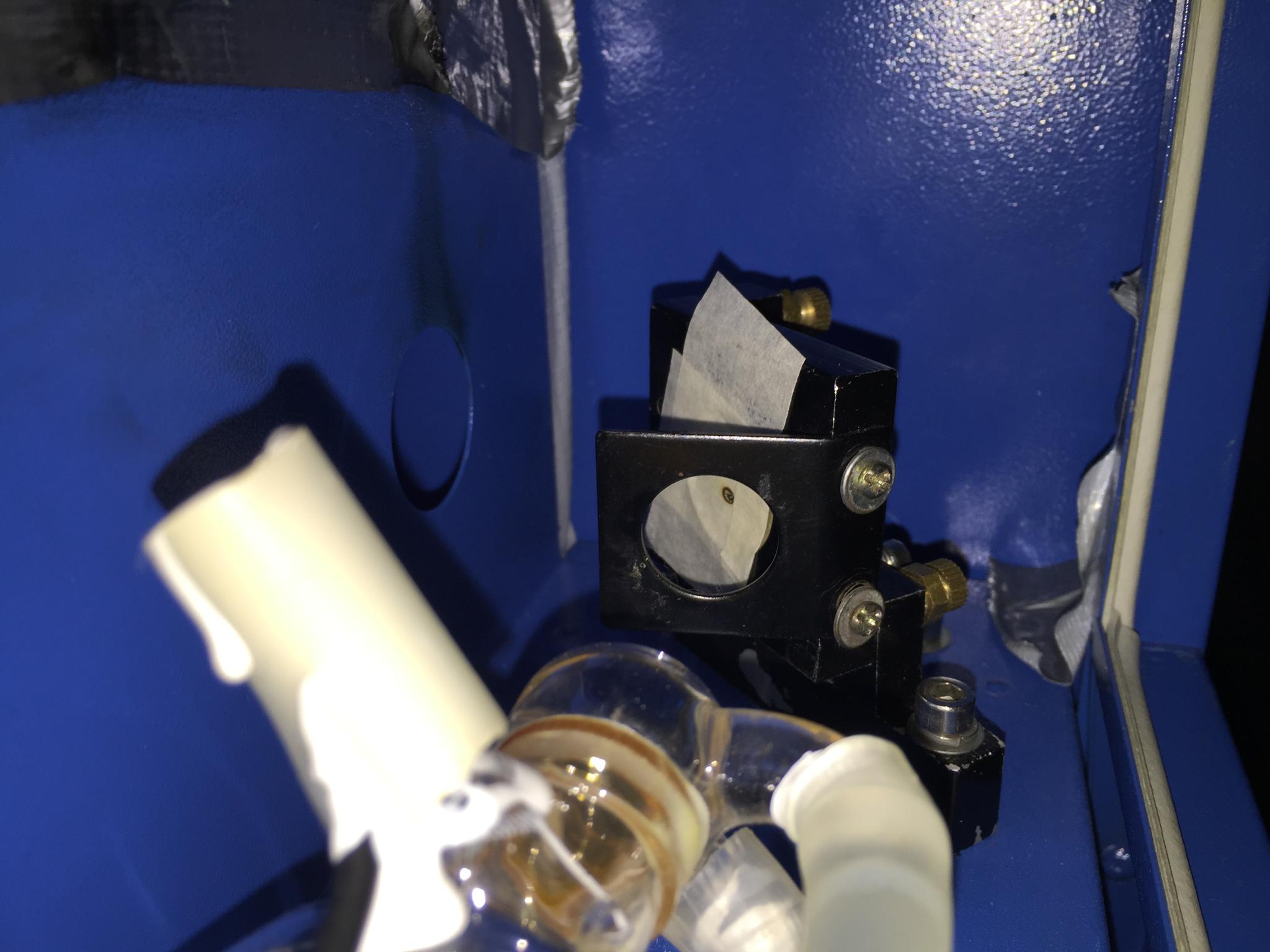

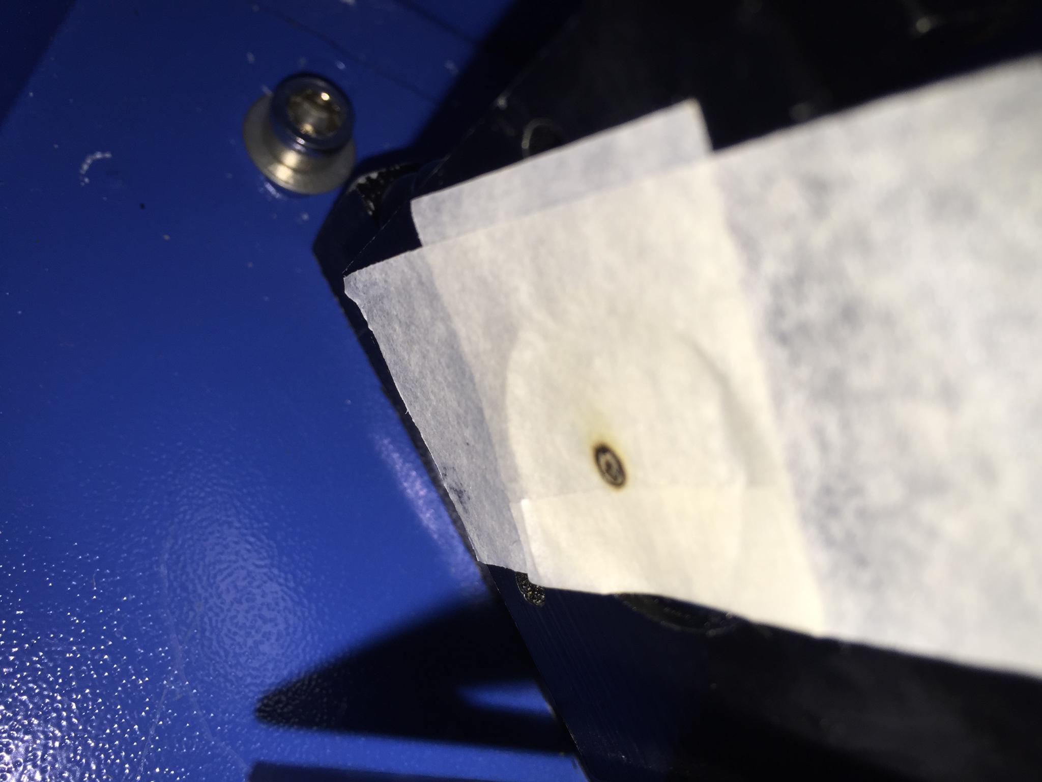

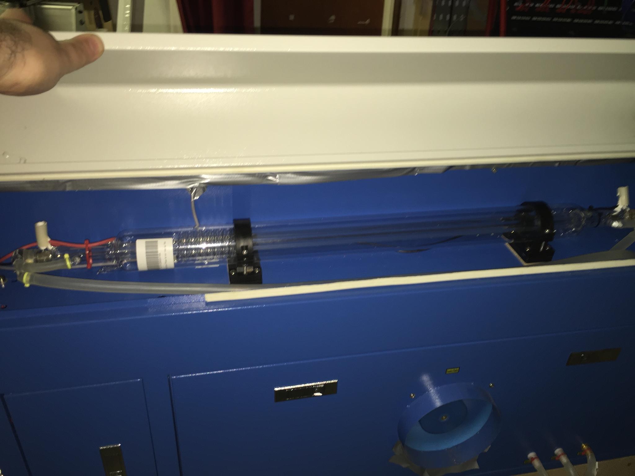

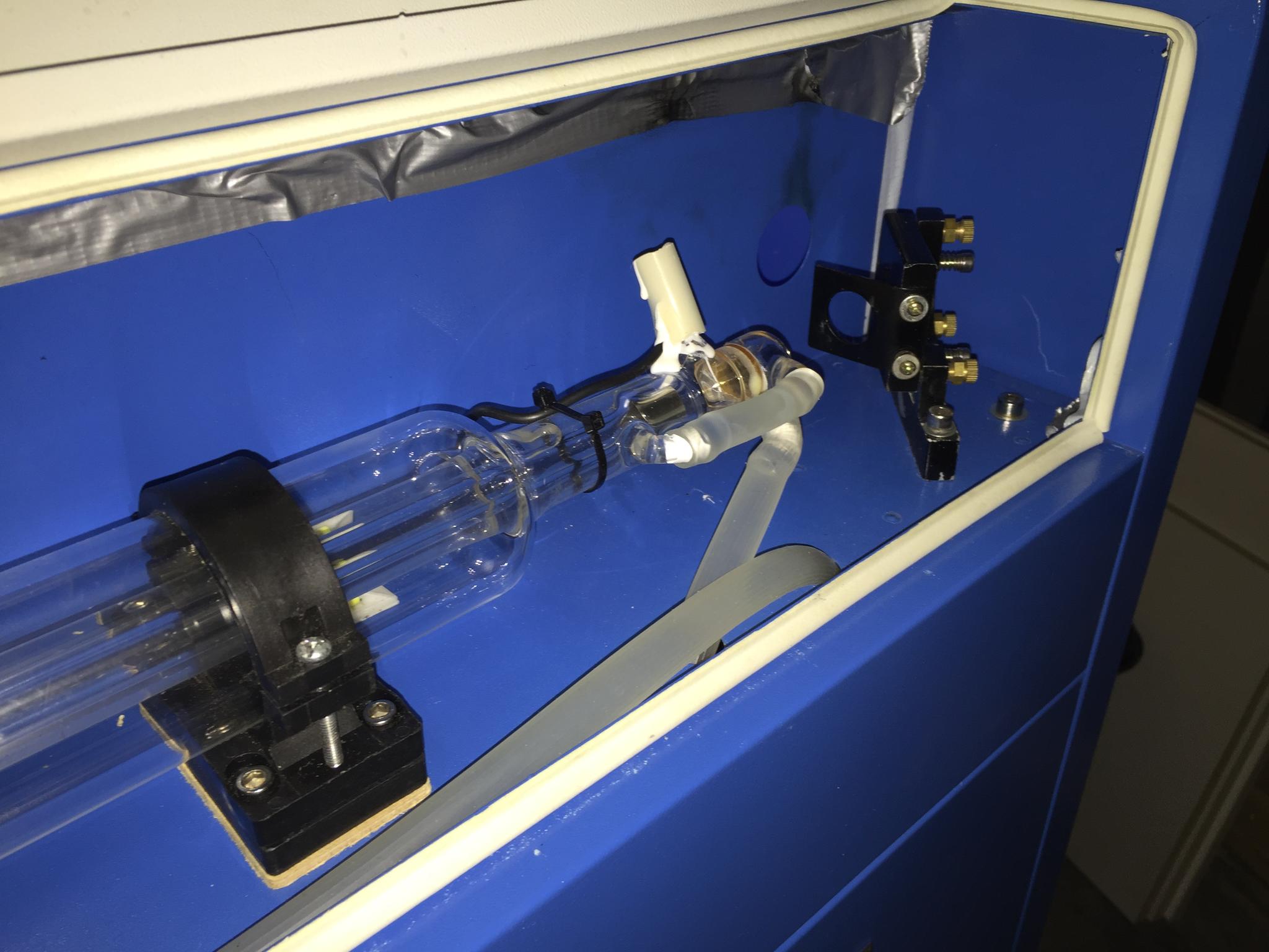

Sorry for the delay, I've been having some work done to the house which took over my garage (aka workshop).

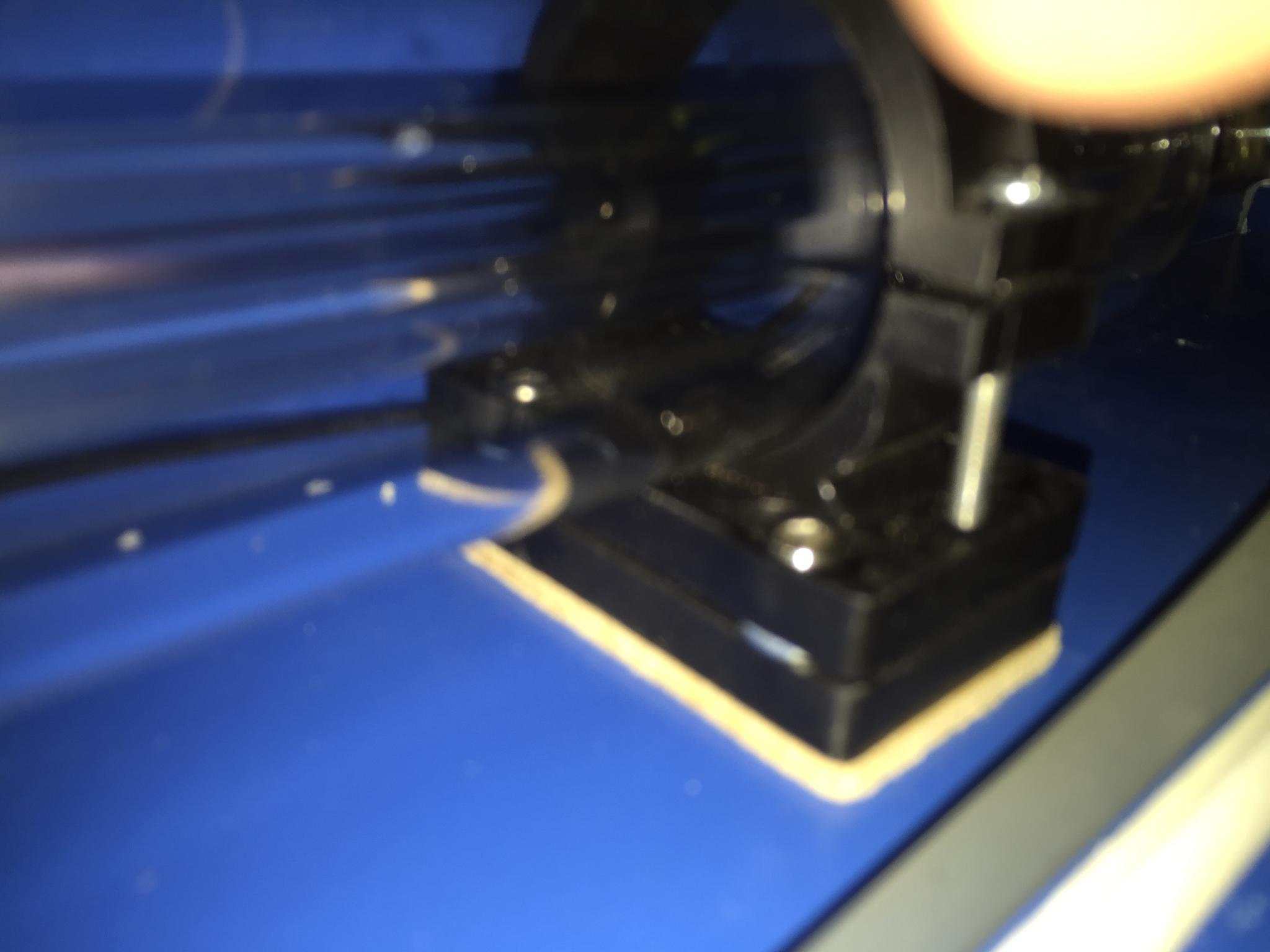

I spent another 4 hours or so trying to nail the alignment but to no avail. I have make some mdf laser tube mounts to get the laser tube better centred on the first mirror but still have a lot of movement as the laser travels. I have uploaded a video to youtube and attached pictures.
I must be doing something fundamentally wrong. I've not been able to use the laser for weeks now. :(
Link to video https://youtu.be/1ngpmipR4YM
Attachment 18046Attachment 18047Attachment 18048Attachment 18049Attachment 18050Attachment 18051

Tilt the first mirror up.
I had to print some new mounts for my laser tube, the originals were crap. I can probably find the .stl files but the only dry 3D printing plastic I have right now is marigold. Probably won't go with your Royal blue.

The beam angle is wrong, you are having to angle the laser to centre it on the mirror, this gives an alignment error which is proportional to the distance moved from the point where it is centred.
Rather than thinking of getting the laser pointing at a target think getting the laser running parallel to the movement of the target, it should be relatively simple geometry to work out,

what I don't understand is, what are you trying to align the beam coming out of the tube with?also don't use any form of plastic printed mirror mounts, you may as well make them from bluetac

You align it with the travel of the X and Y axes.

andy_con
Provided the operating temperature adjacent to printed mounts is within limits they should be OK, what's wrong with ABS mounts?
Re: SH-350 Mirror alignment
magicniner
cos they aren't stable, ask anyone who works with lasers.
...and cheap Chinese mirror supports are? :hysterical:
I think it's a case of "horses for courses", you wouldn't use plastic mounts in most laboratory experiments or in most applications in industry but you'd likely have access to a machine shop and/or an enviable project budget ;-)
It's very easy to be sniffy about things that actually work but are to a lower engineering standard than you'd like if you've never had to work without the financial and technical means you are used to.
Why not make a set of mounts in good old fashioned Meccano?
Now there's a serious engineering material ;-)
- Nick
