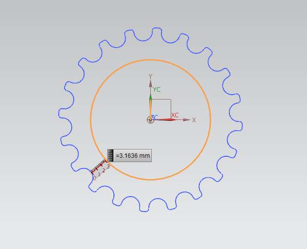

So then you are stuck with min size pulley HTD 5m 20 teeth having in mind 20mm bore:
Attachment 17543

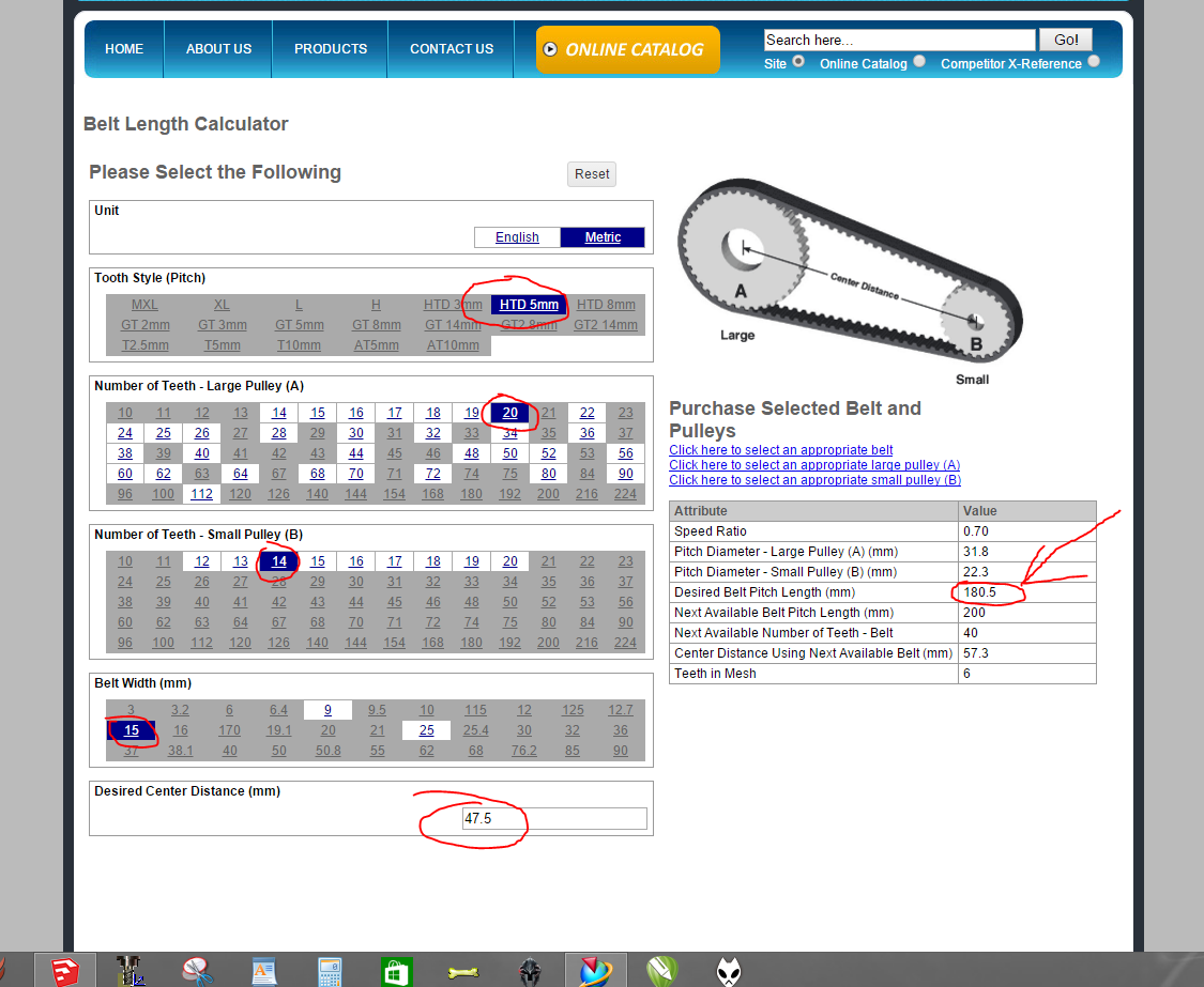

Then we go to the belt calculator, play a little with it and find that voilaa, if i am not wrong you have a hit.
Attachment 17544

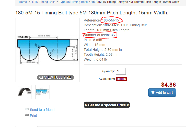

we search the web for the 180mm HTD 5m belt and find that indeed there is one existing in this size:
Attachment 17545
So more or less problem solved. Pulleys from belting online, contact them if they have the belt if not search and buy. its a good idea to pay them to bore the pulley as they do it well and wall thickness will be alright at 3mm as per drawing above.
