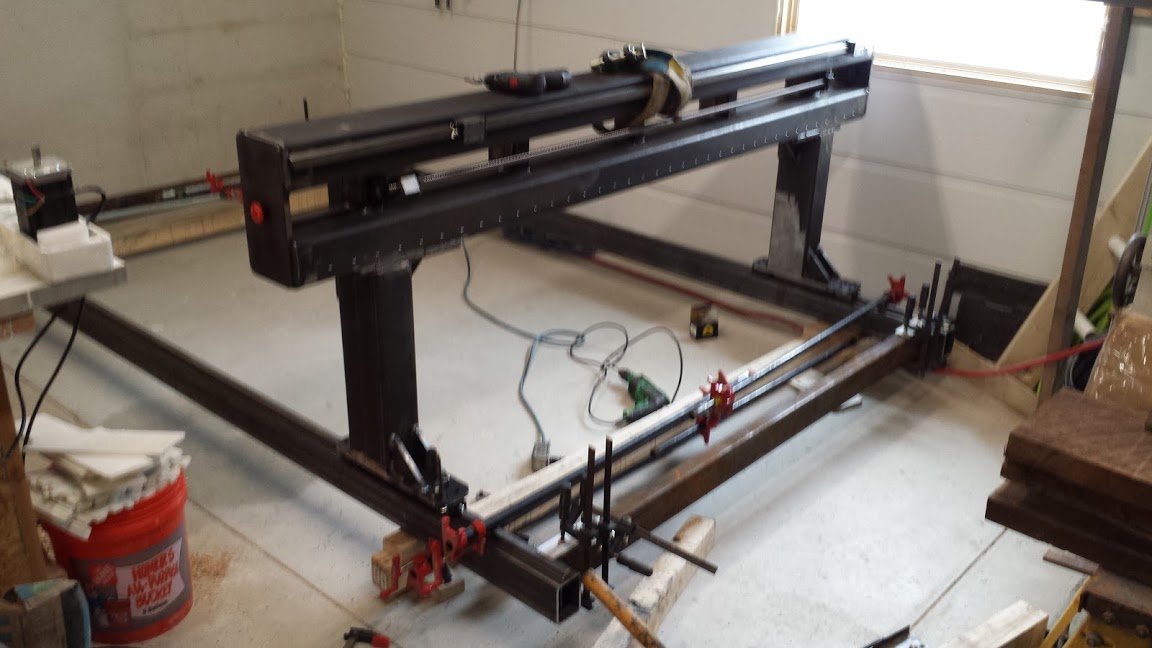

First Build 5 x 12 Steel Frame CNC router
First I would like to say the information here is amazing and has greatly helped my design and learning for this CNC router build.
Objectives,
5 foot by at least 10 ft of machining area
Z height high enough for paddleboard foam blanks ~ need roughly 12 inches under the tool
ability to machine wood, aluminum, foam
good accuracy/precision (still trying to figure out where I want/need to be)
Vacuum hold down

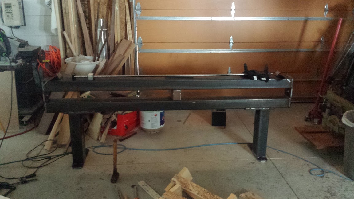

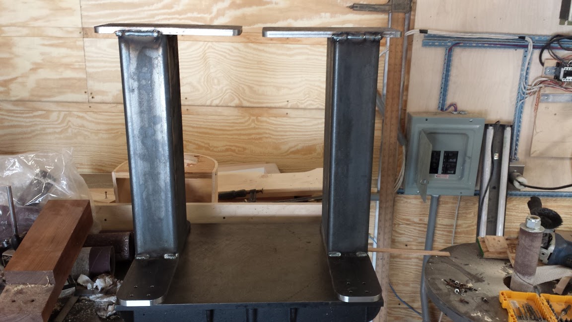

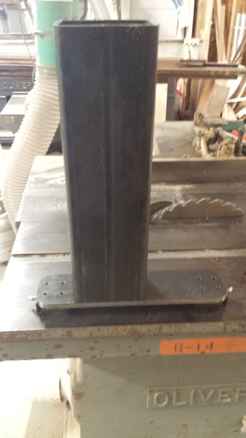

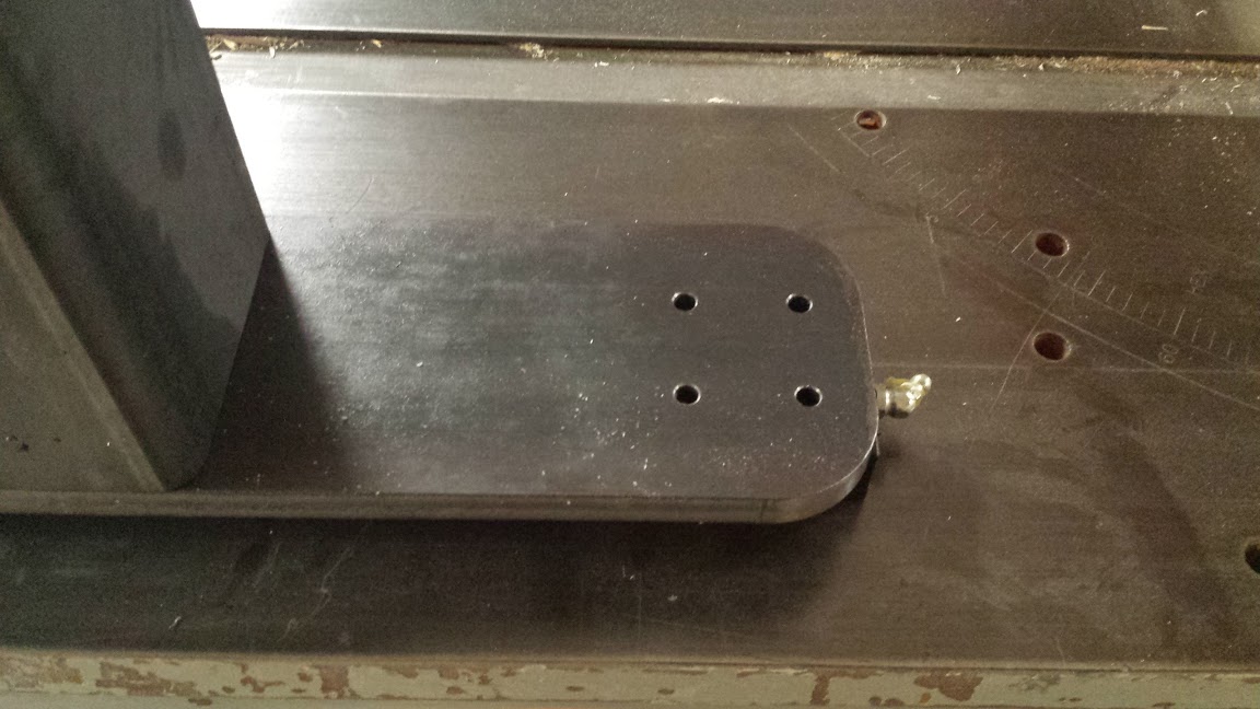

The gantry legs mock-up 4 x6 x 1/4wall box tubing, 1/2 inch plate for the feet.
Attachment 17792
Attachment 17793
Attachment 17794

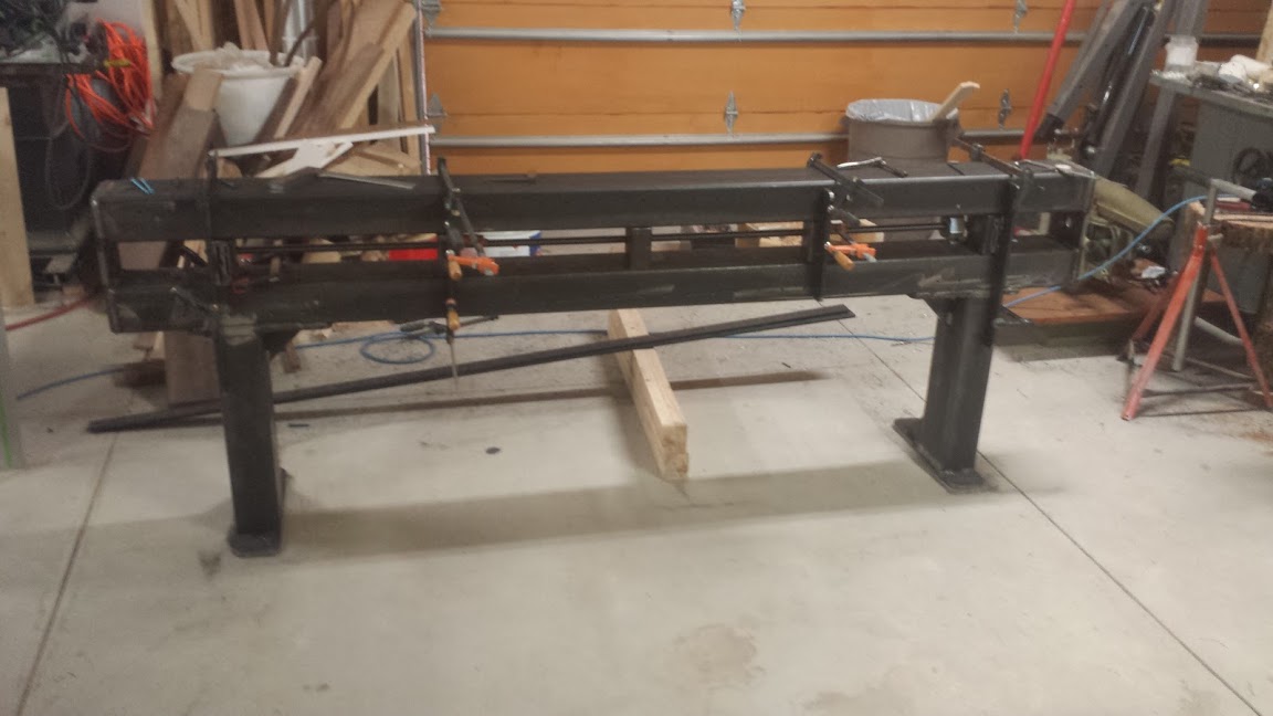

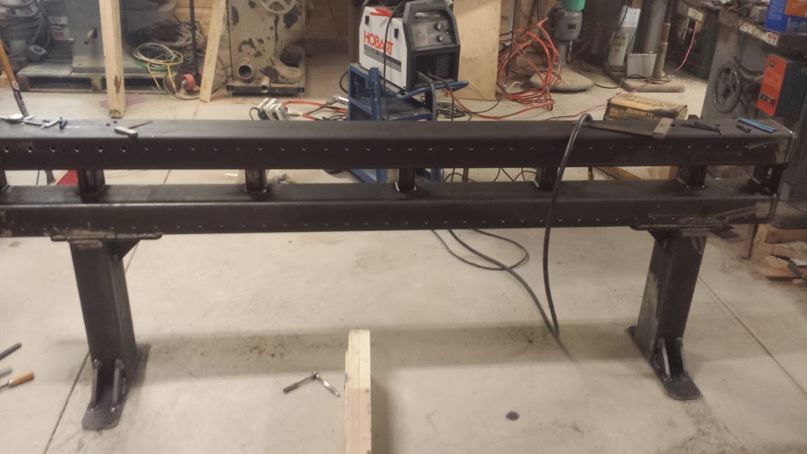

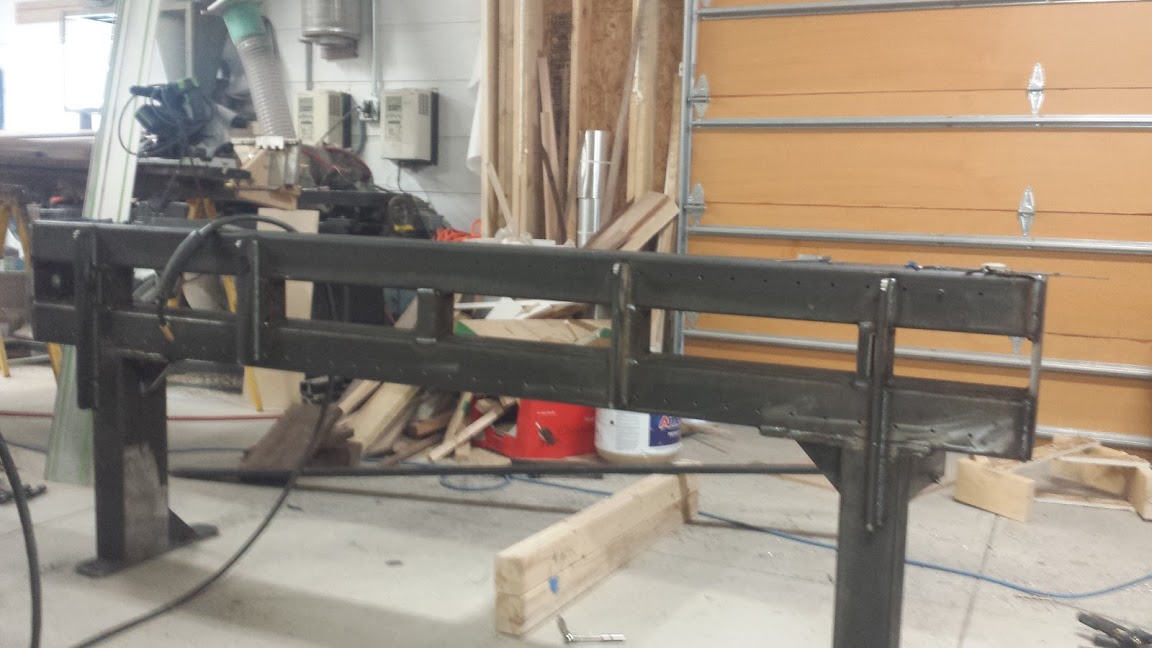

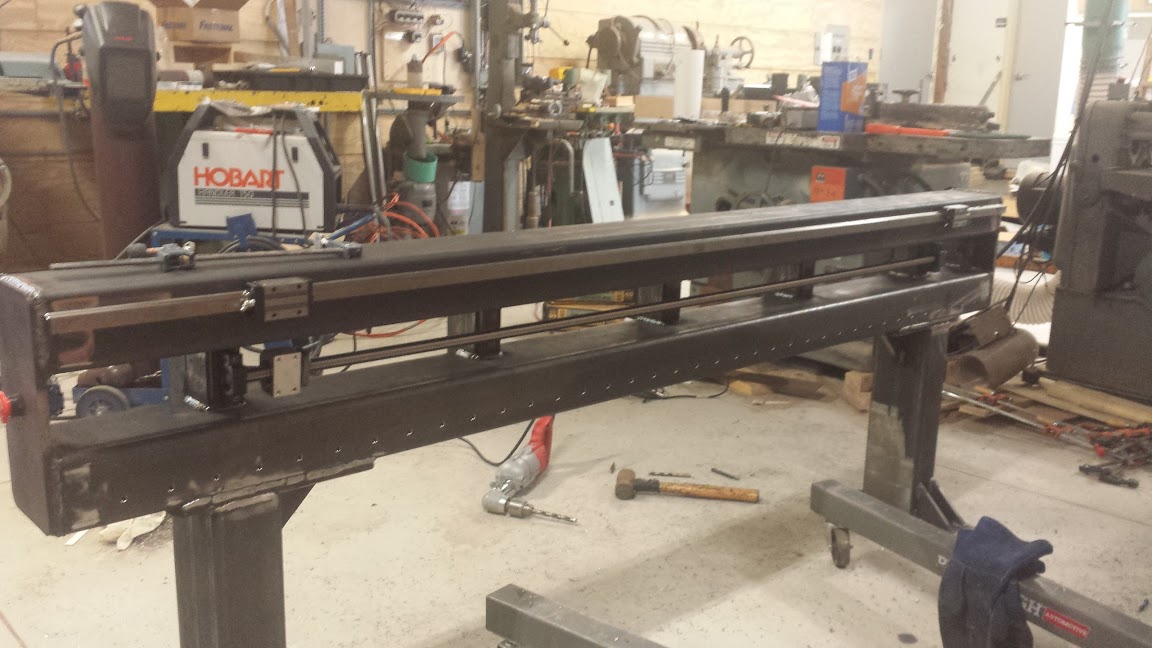

Gantry partially welded up, Gantry is built from 4in x 6in x 1/4in wall box tubing and will get blocking in between the 2 tubing with some vertical bracing on the back. I machined the ends of the gantry before welding them up so I can put an e-stop on each end. The ballscrew is laying ontop of the gantry and will live between the 2 box tubing when complete.
Attachment 17795

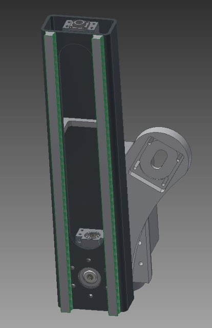

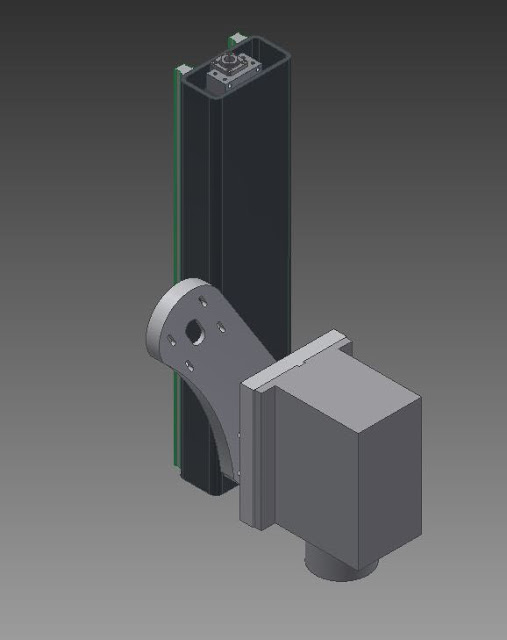

Here is the plan for the Z axis, made from 3in x 6in x 1/4wall box as a starting point. I plan to make an A axis and have mounted the motor up and off to the side. Although this could still get in the way. Should I put the motor for the A axis above the spindle motor? This will make the HTD belt 20 inches center to center. If I did that would I be looking for trouble as far as belt stretch is concerned?
Attachment 17796
Attachment 17797
Heres what I was thinking for A axis

A few questions,
Gantry and Z axis is going to be ~550lbs (~250kg), am I shooting myself in the foot using steppers for this weight? I would like to get decent speed out of the thing without the risk of missing steps. When I purchased the steppers I was trying to balance cost but now im worried I will have trouble with it when im done.
What pitch should I shoot for on the Z axis screw? I was planning on using the stepper motor with a ~4:1 reduction. Total travel as it stands right now will be 16 inches. Weight of Z with Spindle will be around 100lbs should I add spring assist to this? or air springs etc?

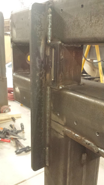

10 Attachment(s)
Re: First Build 5 x 12 Steel Frame CNC router

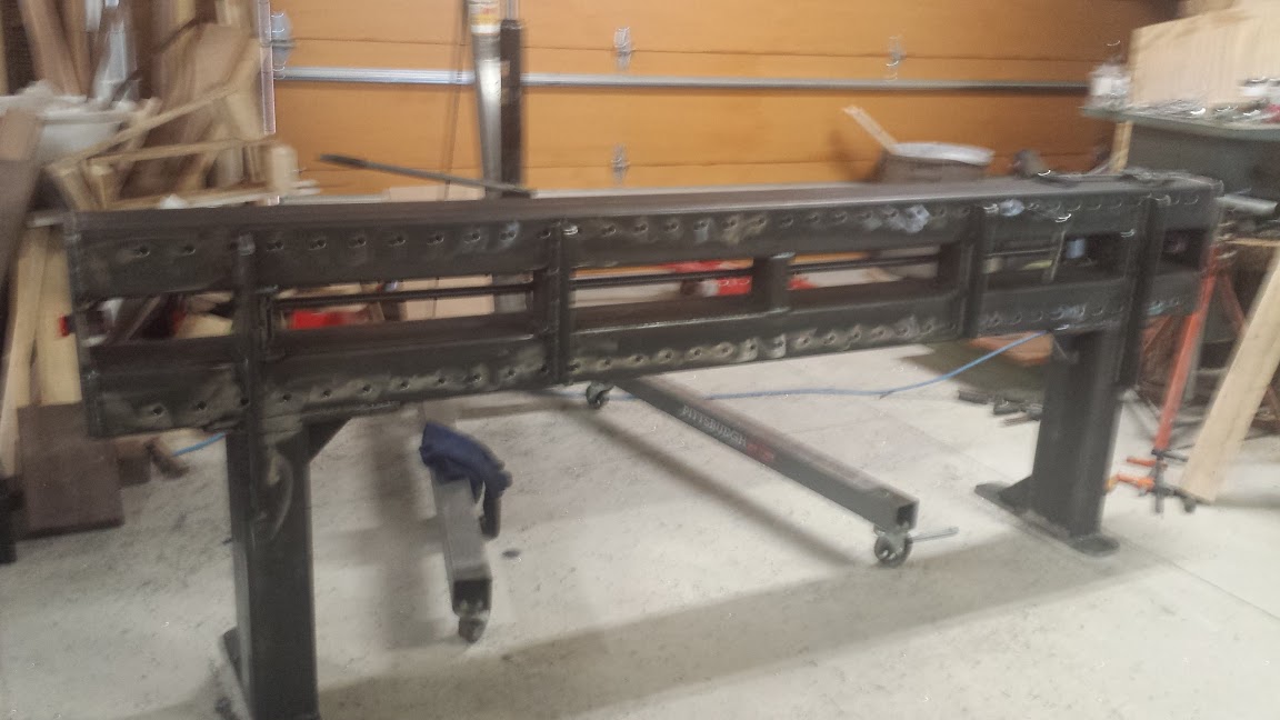

Some updates on the gantry

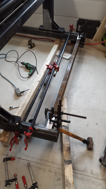

All of the bracing clamped in place ready for spot welding. The ballscrew is in place to set the distance between mounts.
Attachment 17802
Attachment 17803

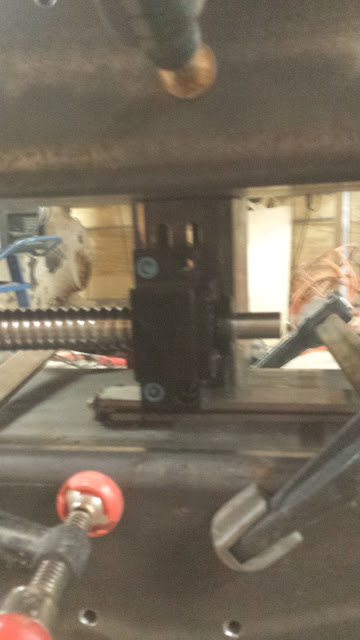

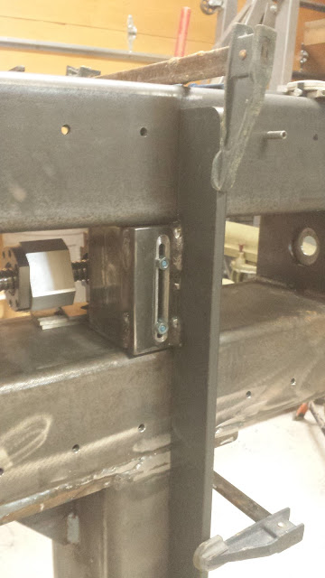

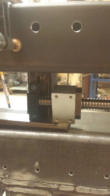

Here is one of ballscrew mounts
Attachment 17804
Attachment 17805
Attachment 17806

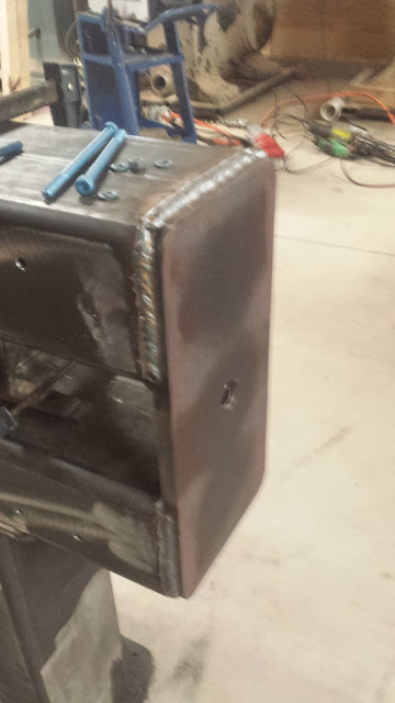

this is the end of the gantry showing the space for the estop
Attachment 17807

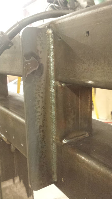

This is one of the longer braces that connect to the ballscrew mount block
Attachment 17809
Attachment 17808

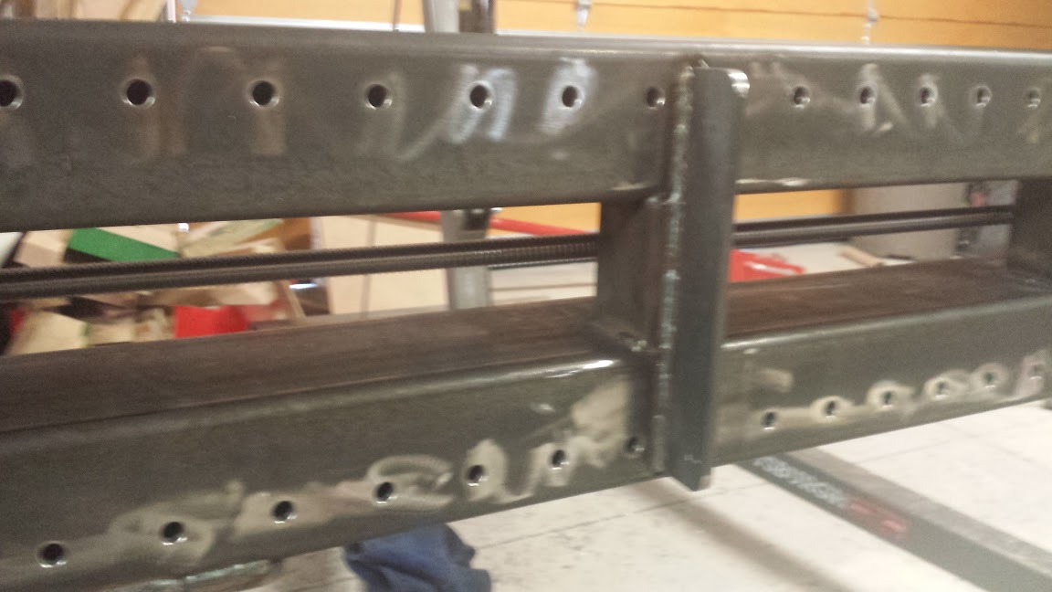

Here is the backside with all the bracing welded up
Attachment 17810

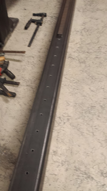

And the front side, notice I drilled some 1/2 in holes on the wrong side. My linear rails are threaded from the backside so I have to through drill from the back. The good news is I am welding on 3/8 plate (I drilled the holes to the correct spacing on the mill first and used the 3/8 plates as templates) on the front side where the linear rails are going to mount.
Attachment 17811

Very impressed, with a lot of things. Very excited about your A-axis, sometimes one should just go to ahead and build it instead of pondering if it will work or not :D I have not attempted to build it yet, as I dont even have an idea of how I would use it. I really have no clue how one would incorporate 4 axis programming.
I would probably fit the widest possible belt there, if I were to use belt, you want the spindle to be rigid enough. What kind of bearings, if that is how you are pivoting the A-axis? Got any detailed view of it?

sinnsvak

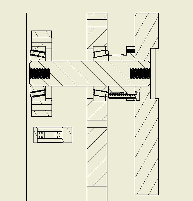

Nice work so far.
Thanks for the comments

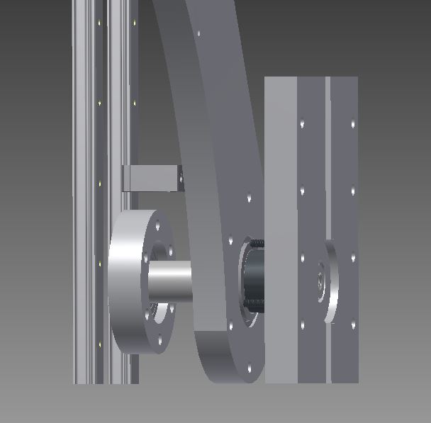

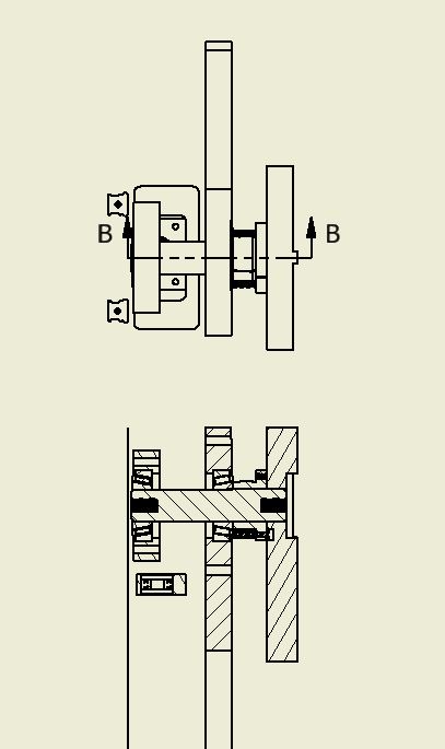

Heres a view of the bottom of the Z axis and a section cut into it.
Attachment 17814
Attachment 17815
**sorry the drawings are upside down**
Attachment 17816
Here is the box tubing removed
The bearings are roller bearings that I can get from McMaster Carr easily. 1 1/4 diameter shaft. Bearings are designed to be held into aluminum housings bolted into the 3 x6 steel tubing. The shaft is a 6 inch threaded on both ends. Again something I can just order from McMaster. The bolts into the shaft allow me to put preload into the bearings. I was thinking of bolting the pulley hub (pulley is not pictured) to the spindle mount.
Open to thoughts on this design. I think it will work....

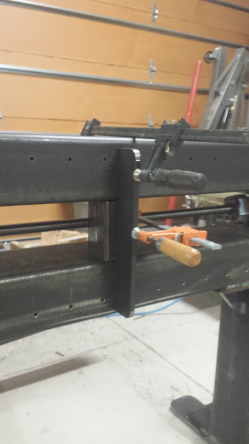

A couple more updates sorry for the bad pictures
Drilled backside holes out to 1/2 inch to allow bolt and ratchet to be put through from the back. Im thinking I will just order a bunch of plastic plugs to put into these holes once I am done.
Attachment 17818
Attachment 17819

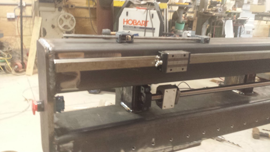

I threw a couple bolts into one of the linear rails just to see how things were coming together.
Attachment 17820
Attachment 17821
So far I am pretty happy with how the build is coming together. Time will tell if I have some precision/accuracy when im done...

Very ambitious for a first build.
Some thoughts:
-the gantry legs dont seem adequate for the rest of the parts you will use on your machine
-the A may work for foam but i dont see it serious for anything more than wood
-the stepper motors , ok- the huge stepper motors, what drives will power them? 230VAC?
-that bracing may be was totally unnecessary. I dont see how that will strengthen anything. It could even make things worse, strengthening one point too much and not allowing the forces to spread uniformly and creating pressure points. So later all rings.
What will you be using this machine for? Remember- the weakest point is the criteria for how strong your machine would be. Again-the gantry legs.
PS:
That gantry legs will greatly benefit from bolting or welding on them 10mm steel plates in both directions, 2 per leg in total
Hi Scott,
This is how I see couple of not so little things.
Steppers:
Really Cannot comment if they will be good enough because you haven't said anything about what your using for linear motion on the X axis. I assume Rack n pinion but what ratio etc.? . . . But let me put it this way 550lbs or put anohter way 1/4 Ton is lot of Mass to Accel and stop so better get this correct or you'll seriously regret using steppers.
A Axis: You need to think again on this I'm afraid NO WAY will Stepper with such small ratio hold that Big spindle at angle without moving or vibrating.
Remember the Z axis is the MOST important area on machine so weaken this and all that OTT work you have done on the frame is pointless.

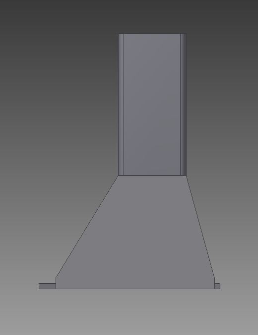

I think you are talking something along these lines for the sides of the gantry legs? I was wanting to do FEA on these legs but never got around to it, I did however do calculations (free body diagram) to try to calculate total deflection based on 1000lb force at the bit and keeping the total deflection ~3 thou at full load.
I could go higher with the bracing as well this is just a quick drawing.
Attachment 17835
The thinking behind the bracing was to connect the upper and lower gantry beams. I used box tubing between the beams. Now the rear bracing, the thought there was to reduce the twist in the gantry. Hopefully it doesnt cause issues...
So the A axis, this is exactly what I am worried about, holding it in place when at angle and also moving it. The A axis would really only be used when machining foam blanks for paddle boards. However since I want to be able to machine wood, and aluminum as well then I really need to make sure this thing is right.
Couple things I am thinking thoughts are greatly appreciated.
- Eliminate A Axis...
- greatly increase the belt ratio
- keep A Axis but have an air operated taper pin that holds it at 0 when machining wood/alum
- look into a harmonic drive rather than belt drive

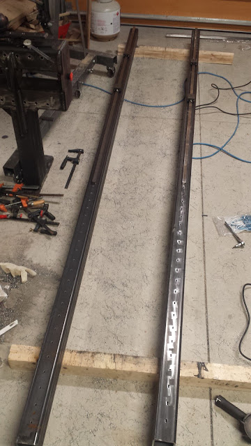

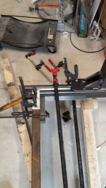

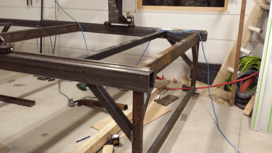

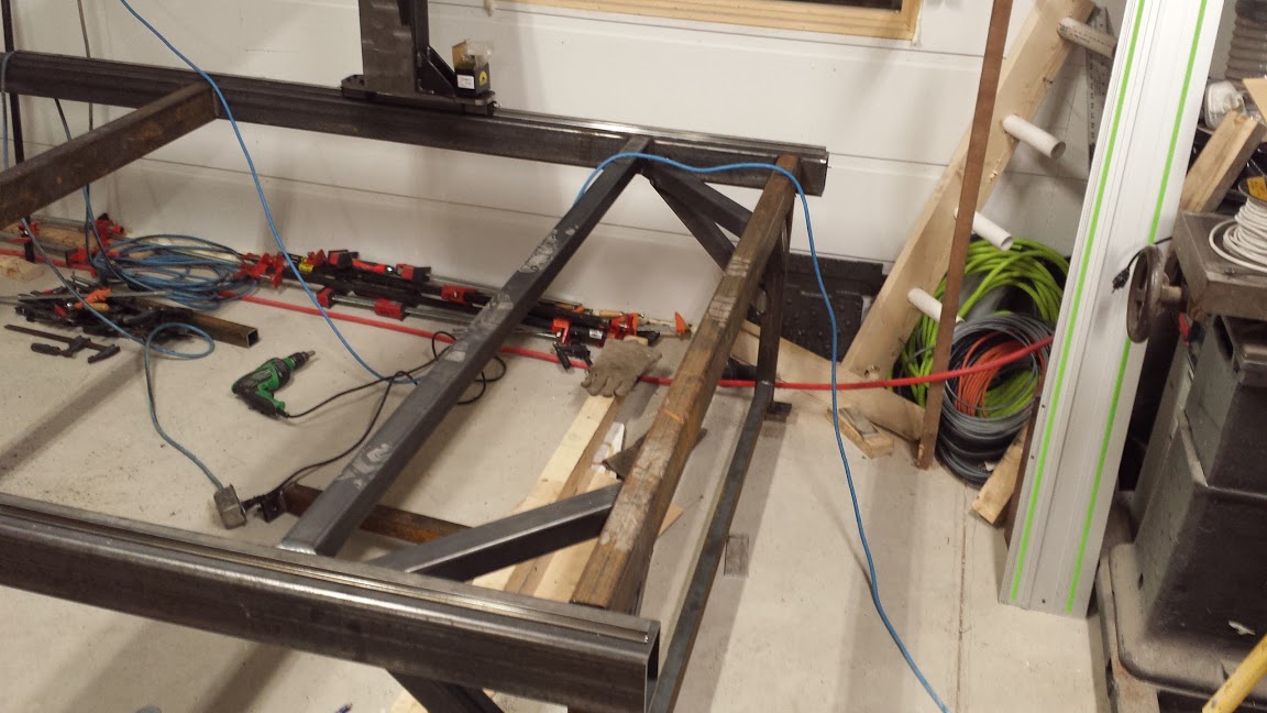

Got the X axis steel drilled these needed to be through drilled as well since the linear rails are bolted from the back. 244 holes!!!!
Attachment 17836
Attachment 17837
Any help with servos for this size of gantry is greatly appreciated.

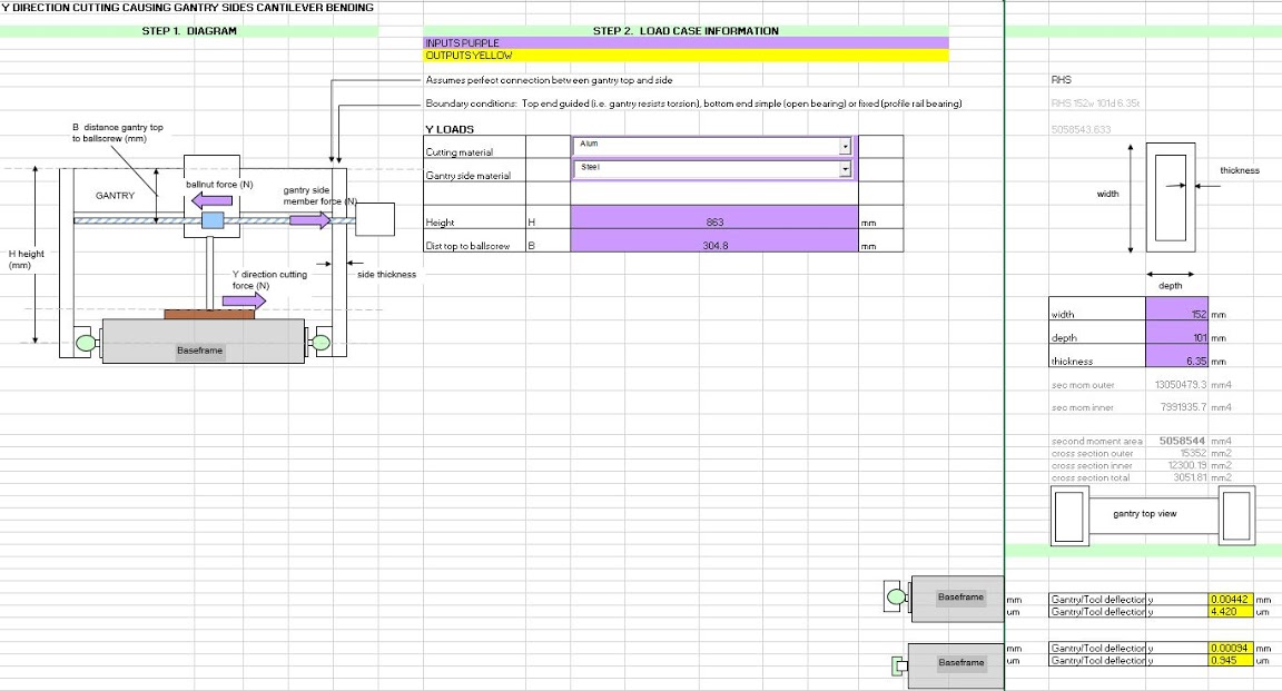

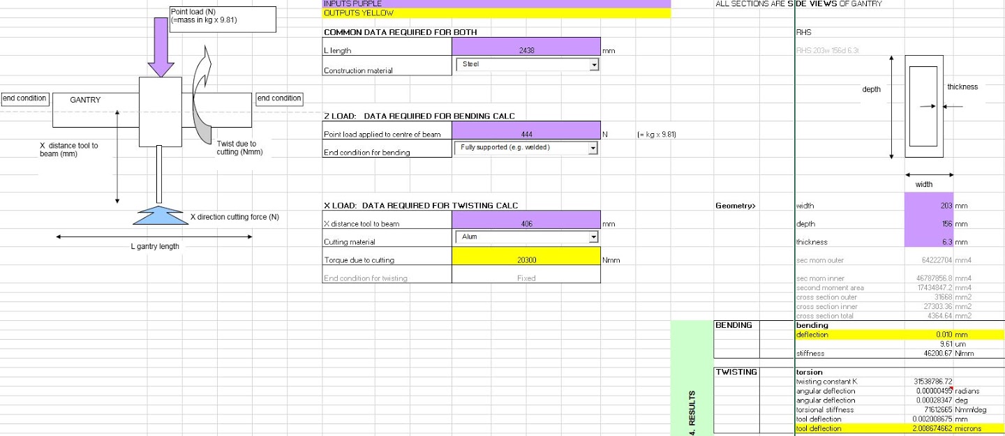

Ok, lets start from the beginning. I will try to resume some things, you just need to further research the topics:
1. You should absolutely know what weight your gantry is with all things mounted. Knowing the mass of the gantry will be decisive on what motors, what size ball screw, rotating nut, Rack and pinion, etc..
2. Be realistic about the feeds and speeds. And what you really need the machine for. All in one would be usually a disaster in some area.
3. Motor sizing. People drive 3nm nema 23 motors at 70VDC. And we are talking low inductance motors. Expected reliable performance from such motors coupled with xx10 ball screws is 10000mm/min. The motors you have are high inductance motors. I am not a specialist here but there are a lot of knowledgeable people here that will tell you at what voltage, but i am sure that it must be more than 110VDC. Do your research and find at what voltage these motors perform well. And if these drives will be ok.
4.Without knowing the total weight of the gantry... but i see you start ambitious, so yes, you will need servos to drive the gantry reliably fast if you aim at 25000mm/min. And you will need rotating ball nut or rack and pinion
5. There is a very well made calculator at the forum here, search for it, and i am sure that the gantry legs deflection will not be as you say...but may be i am wrong
I dont want to discourage you, but i am having the feeling that if you continue without thinking it too much, there will be disappointments on the way. WHY JUST DONT YOU SLOW A BIT AND READ MORE BUILD LOGS. All the info is there.
And by the way it seems the american thing is to desire rapids of 1000ipm. And make rack and pinion machines. We here in EU prefer precise ball screw machines and rotating ball nuts for big machines and heavy gantries.

Hi Scott,
Just to scale point #3 from Boyan - 3Nm Nema 23 at 70VDC could be used up to gantry weight of 50-70kg tops. As yours is 5 times this weight the stepper / driver combo needs careful thought.
I can sort of see the machine you are trying to make by piecing all the photo together - and it looks like a commercial wood router with raised gantry.
If you want to cut aluminium as well I would suggest you chop the legs off the gantry, and go for a raised X axis instead. Lift the X axis members up on supports away from the bed until they meet the bottom of the gantry. This makes a much stiffer machine for little effort. Your span is quite wide so you will need all the help you can get for aluminium.
Can you post up a picture of the overall machine design?

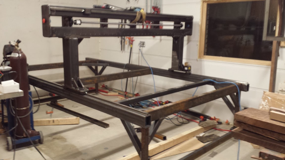

3 Attachment(s)
Boyan Silyavski
The gantry will weight around 550lbs, this number comes from the 3d drawing which worked out to 494 (this included the Z axis and the spindle) and I added 50 lbs for cables and cable routing. This was my bassis for sizing the motors. Sorry I thought I had been clear on it earlier in my thread about the weight.
Feeds I am happy to be realistic and dont care much about super fast rapids but I want to be able to drive the machine at proper cutting speeds.
Im sorry I came across as I jumped into this without any research when the opposite is true, I have done lots and lots of research both on forums and by inspecting commercial machines. I would not have been able to get to the point I am without lots of learning from all sources. I find there a very different views on most subjects associated with the gantry style cnc router so its hard to nail down whats the best design. And thats where some of my questions came from. The stepper route was more of a cost thing and I should have done more research on servos before going down that road.
I will find the calculator you speak of and give it a try. I just started out by doing the math, the hard part was actually finding out how much force would be applied at the tool so I could back calculate the flex at the gantry.
**I want to say machining Aluminum is a bonus for this machine as it will mainly be used for wood**

Here is the Frame starting, I have blocked up the frame to level and used the gantry to set the exact distance.
Attachment 17845
Initially checking square with a precision square, final squaring will need to be done once its all welded up and before pour epoxy.
Attachment 17846
Attachment 17847

Alright so I ran the numbers through the excel spreadsheet.
Heres what I got
Attachment 17848
0.010mm deflection
0.00028 deg delfection
deflection at tool 0.002mm
Attachment 17849
0.00094mm deflection
Maybe I am entering the numbers wrong I will run through the numbers again but these look better than what I got when I just did the free body diagram. Thoughts on these?
These seem acceptable but im not sure what I should be shoot for as far as max deflection?
Thanks for any help. Want to make sure this is right before I get too far that I cant make changes.
Hi Scott,
I wrote that spreadsheet some time ago to compare simple shapes. For the numbers you have entered it looks like it is giving the correct answers.
Things to note:
It assumes everything else (e.g. spindle, tool, bearings, bedplate, joints . . . .) is infinitely stiff - so it is best case
Have you entered just one of the two gantry beams? If so the real stiffness will be higher as you have 2
Or have you given the overall gantry dimensions as a single beam? If so the real stiffness will be lower
It makes no prediction for deflection due to cutting vibration and machine resonance
It terms of max deflection it is personal choice but I would say wood <0.05mm and alum <0.01mm as a starting point. Others opinions welcome!
I get the point about raised gantry vs raised X axis (in the US this can be Y axis) for material loading, so as long as you've thought about the options and made a choice that's fine. Didn't know what you knew.
In summary you have a very stiff machine that is stiff enough for wood, but that gantry is heavy (hence our concern over stepper/driver/voltage - if you know these are OK then that's good), and resonance is unknown (the sheet can't show this).

A few updates, I dont love the look of the legs they look out of proportion to the rest of the machine but its steel that I already had on hand from other projects and its plenty strong with bracing. It gets a 3rd leg just havent gotten that far yet. Lots of bracing. I am trying to keep the one end open so I can use some of the space under the machine for rough sawn lumber storage...
Attachment 17870
Attachment 17871
Attachment 17872
