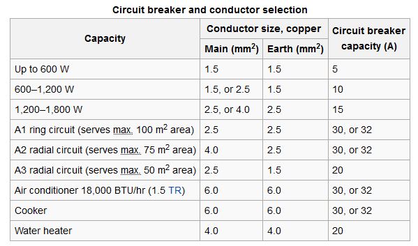

Re: Which thickness CY cable do I need for 1.5kW spindle?
Lee, what works is not the same as what is safe and what is recommended.
https://en.wikipedia.org/wiki/Electr...United_Kingdom
Attachment 18513
That is a more realistic and better data, even if you step down one size, 1.5mm2 is what should be used. 0.75mm2 is for small desk lamps, not for motors. Then again, I know most people never really use their spindles at maximum load, so it is never really going to be a problem and in many cases even 0.5mm2 might be OK, but I think 1.5mm2 is the minimum if you want to play it safe. My 1.5kW is rated 8A and I am pretty convinced that saving on cable costs is not a good decision. Also, if you ever decide to use a vector controlled spindle you will notice that it pulls more current as well, so what is the point of under dimensioning the cable?

Yes, I know many people use that, but 0.75mm2 is lamp wire, not for motors, at least not for motors of the sizes we are discussing. Yes, handling a 1.5mm2 is not as easy as 0.75mm2, but still, not that difficult if you know how to solder and connect. Also, when you crimp the VFD end (which I guess you do) it is considerably safer to use 1.5mm2 than the lamp wire. 0.75mm2 or 0.5mm2 is for control wires in this area, not power.
Then again, this is just my opinion. I know many people will disagree and many people use far too thin cables for convenience, price and for lack of better knowledge and that "it works", also because they read these forums and go for the "majority rule" principle.

To me, the common sense is NOT to use such thin wires for this purpose. It works, but it is AGAINST common sense.
I personally work to the formula: "Nothing Built Strong, Ever Broke"
Following that seems to have worked for me all these years so I know what your saying :-).
.Me
Not replying to any single post here:
Considering only resistance (okay, a motor is largely inductive - it makes the maths slightly trickier, but there is a significant resistive element to the motor and the basic premise remains)
Simply, given the same conductor type, 0.75mm2 cable has a higher resistance per unit length than 1.5mm2. Similarly, 1.5mm2 has a higher resistance per unit length than 2.5mm2. That fact is irrefutable.
The power dissipated in the cable run is proportional to the resistance.
Also, the voltage drop across a cable run is proportional to the resistance. The higher the resistance, the greater the voltage drop across the cable run.
The voltage drop across the cable run is proportional to the square of the current drawn. So, under load, with greater current draw, the voltage drop across the cable run increases at the square-law of the current, and implicitly, the load.
The voltage at the spindle is the terminal voltage of the VFD, minus the voltage drop across the cable run.
The mechanical power provided by the spindle is proportional to the terminal voltage of the VFD.
So, the lower the CSA of the cable run, the lower the voltage at the spindle. This drop increases as the load increases. This impacts directly the available power of the spindle. Cable CSA is related to performance.
Of course, the standard cable ratings easily found on the interweb don't consider the performance of the spindle, only the safe operating mode of the cable under domestic and industrial applications - given the heating effect of the dissipated energy on the cable, and - importantly - the longevity and integrity of the insulation. You might find that a particular cable works, but that the insulation fails after prolonged use.
The spindle manufacturer will provide a design specification for the spindle. This /should/ (I have to provide that caveat for our illustrious Chinese manufacturers who are not unknown to put anything that sounds good in the manual without reference to reality) allow the spindle to operate as designed. It is not unreasonable to expect then, that if you compromise that design, you'll compromise the performance of the spindle.
Finally (I need to get back to the bottle of wine), don't design a system assuming any strands on a multistranded cable will fracture - at that point the mechanical design of the system has already failed and catastrophic failure of the cable will occur in short time.
An analogy. If an architect specified a 152x89 RSJ. Would you chose to replace this with a 127x76 RSJ that you had lying around? It might well work, the building would probably stay upright after you've finished it. Hey!, the architect is clearly a fool.
