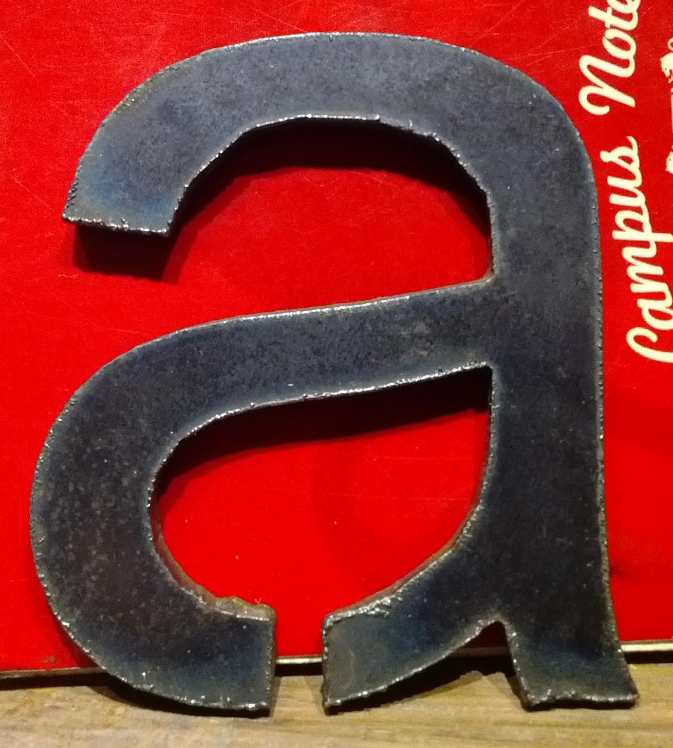

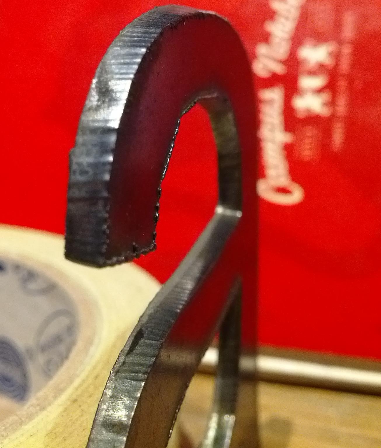

		Plasma arc's look faceted when cut, not sure why?
I'm cutting out the letter 'a' (arial font) in 3mm as test forms with my Thermal Dynamics plasma cutter. Letter size, approx 80mm x 50mm.

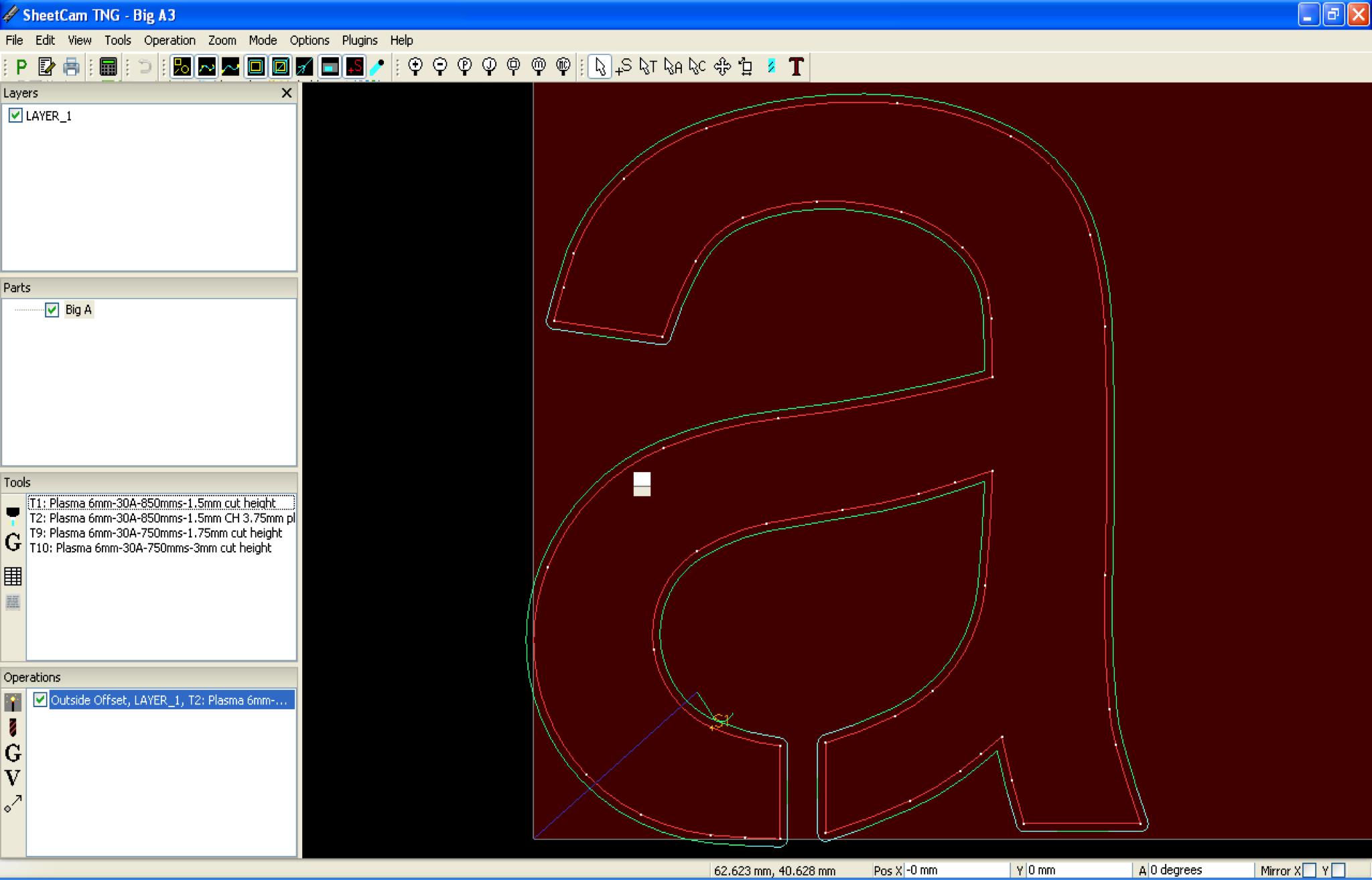

I've exported a dxf from Vectric Aspire using the fit curves to selected vectors (arcs) command. I brought the dfx info Sheetcam and cut using Mach 3.
Something isn't right, with the inner curves, they appear faceted and i'm not sure if its a problem with original vector file, (attached as the exported dxf) or, for example a velocity /acceleration and CV issue in Mach3. I'm currently using a velocity of 17,500 and an acceleration of 1750 in Mach3, perhaps an issue?
In Mach3 I currently have CV feedrate override turned off.  CV is on, exact stop therefore off.
Its a process of elimination and i'm guessing its a vector file issue or Mach 3 feeds and speeds. Attachment 17822Attachment 17823Attachment 17824
I'm all ears for solutions,

		I loaded that into Mach3 and zooming in (not too far either) in the toolpath window on the toolpath tab it looked more like a series of straight lines than curves
 - Nick
Re: Plasma arc's look faceted when cut, not sure why?
		Wow, your right! I rarely open the Mach3 toolpath window and its most definitely reading it as a series of straight lines. The question is why?

		A quick look at the gcode immediately shows that it's a series of line segments - there's a G1 near the beginning, then just a series of coordinates thereafter which will also use the implied G1. Not a G2/G3 in sight.
My guess is that the DXF you are exporting, for some reason, is using straight line approximations and not curves or arcs. I've had that problem exporting from Adobe Illustrator and it turned out to be that I was not using the latest available DXF format. Can you explore that?

		Pleased to report back that after changing the Sheetcam postprocessor from Mach3 plasma with THC and backlash compensation to Mach3 plasma with THC in the Sheetcam options the curve now cuts as a smooth line. Even the 6, 8 10mm holes are better.
Thanks all :)
