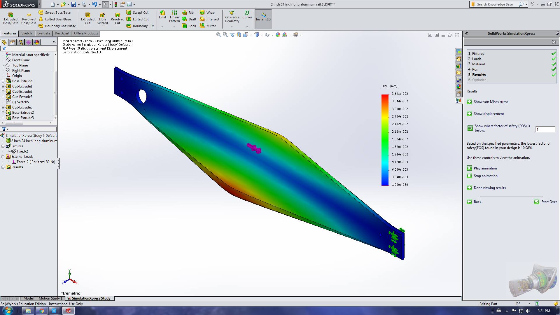

I did do some quick FEA on the rail, and found that it's actually fairly stiff for my purposes. Here's the test if you want to look at it. I'm thinking of using larger rails in the next few iterations that are going make this machine even more ridgid, since the material cost per food is only around 1 or 2 dollars per foot.
Attachment 17949

		Is the F in FEA really an abbreviation of Finite, or does it mean something else here?
Is this Mechanical Under-Engineering at it's finitest?

For info the FEA analysis looks like you clamped each end of the beam then loaded the rail normal to the surface with 30 N.  You got 0.03mm deflection on the rail which is reasonable for that beam on it's own - but remember your beam end conditions are not infinitely rigid, the V-bearings and brackets and gantry will flex, as will the Z axis, and the tool (dremel type I assume?) will along with the cutting bit which will have to be small.  Backlash in the threaded rod will allow the tool to vibrate as so on.  Push the Z axis with a set of scales and measure the deflection with a DTI.  This will give you the true machine stiffness and it will be quite low.  This is where the challenge lies to come up with something simple and cheap that still works.
