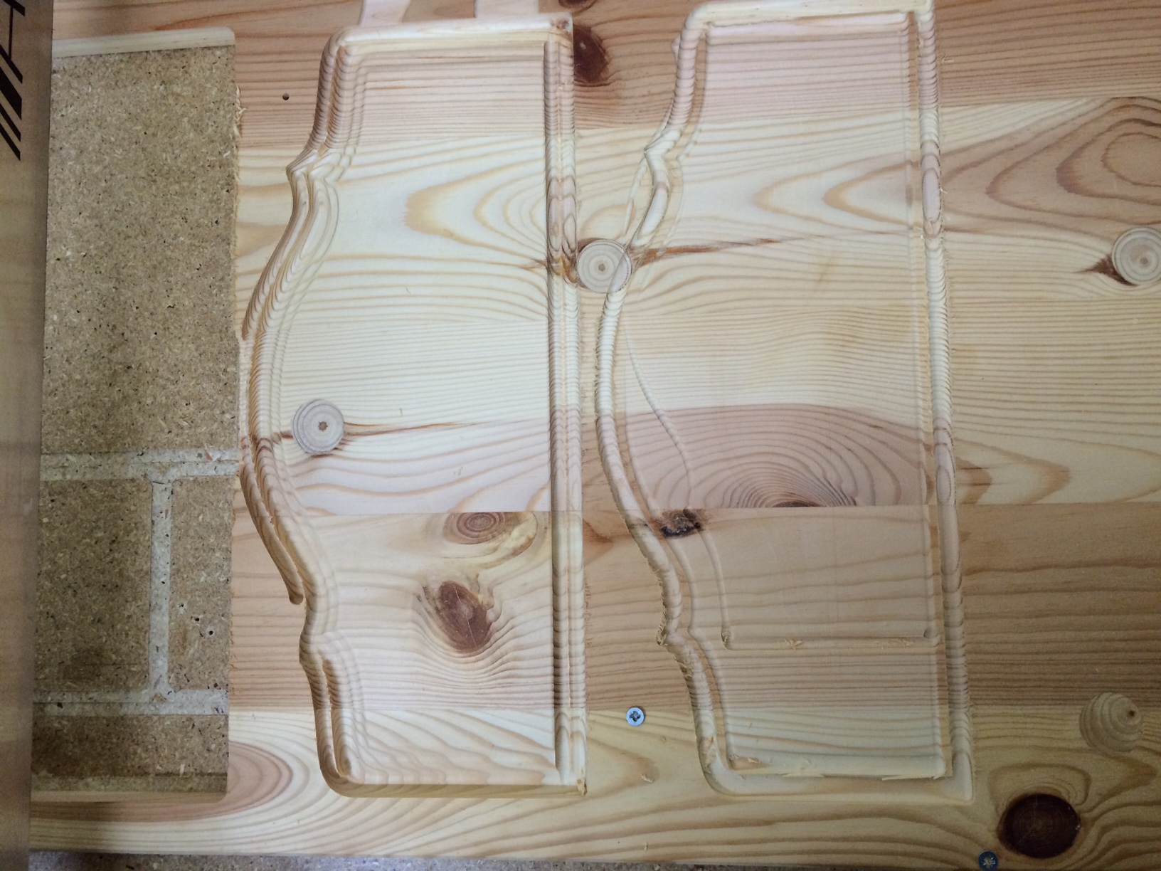

Running a 720-Z for 8 months now slowly learning about it and using vectric vcarve pro.
The other week after running a small shield in 3d finish it got to 99% and suddenly did a large L and at a 6mm depth straight through the work.
Yesterday it ruined another piece when after about 1.5 hrs running it suddenly overrun the x axis by 20mm and carried on as tho nowt happened.
Today i started all a fresh and again 99% 40 mins in and it suddenly plunged lower and finished the last run too deep and offset by 5mm and ruined the Pine wood.
Running it at 44mm/sec .25 ball nose in pine.
The only common denominator seems to be 3dfinsh but its all simple work nothing out of the box.
Where could i start to track this fault (but i cant read g code) as i cant waste any more wood as its all for charity and it costs me.

Hi Bernie,
Ok well you need to start by checking the machine from head to toe for any mechanical issues. Mostly likely cause would be binding or failing bearings etc.
Any of these and the motors will struggle and start losing position or worse case stall completely.
It's actually quite common for things like this to happen on long jobs that run at higher feeds where torque is starting to drop off. The combination of heat which causes binding and steppers working in speed range that can be affected by resonance can also be a factor.
If you can't find any mechanical issues and the G-code is correct then it's strong possibilty you are being affected by Mid band resonance. This happens like the name suggests when the motors are working around there mid rpm level which at 2500mtr/min then you could be approaching(depending on screw pitch).
If you are being affected by this then you have limited options. Changing the feedrate to lower or higher speed is an easy test to see if you can move the motors out the frequency range where resonance affects drives/motors. If it is resonance then you'll likely struggle to go higher before motors stall.
Next option and the one which is most likely to work is changing the micro stepping settings on the drives(If they have any). This can shift the resonance to different frequency which the drives can handle better.
Replacing the drives with better drives is the last option and one that will most likley cure the issue if resonance is your problem.
Checking all the wiring both on the machine and in control for lose connections is second thing to try after checking mechanical.
If you post the G-code by zipping it up or in txt file (don't post all lines on here) then I'll take look to see can bad code.

Have you checked for any axes binding. This is mostly likely cause.
After checking this I suggest you try running the same G-code at different feedrates to test if resonance is the cause. If it runs fine at lower feed rates and at higher feedrates then it's most likely Mid band resonance.

Ran at 80%, motors got to 32.5c (did not seem too hot to touch) and i thought when it finished it had cracked it, What i thought this time that looked like a failure was a cutout which turns out to be a knot problem, so it may have worked, will try different wood but now i hope to adjust the speed at source

I thought i would post my results in the off chance it may help another new person if they have a similar issue as me with the high-z s model.
It turns out it was me, i was driving it too hard at 45mm/sec and as Jazzcnc thought the bushes were getting too hot and were binding, i have now run at both 20 and 30mm with total success, just it ran longer obviously, the model above mine the t series does not have the same bushes so i imagine the problem may not occur so easily.
Thanks to Jazzcnc and Philip at Protools who walked me through the reasoning.

Bernie I don't believe the bushes getting too hot is the cause. 45mm/sec (2700mm/min) isn't overly fast and certainly won't or shouldn't be getting any bushes remotely hot unless they are wornout and knackerd.
Don't know what reasoning phillip at Proto may have tried to parm off on you but any machine at the price they charge for those things should easily be capable of cutting at 2700mm/min. If not then send it back because it's unfit for purpose.? By that I mean they sell it for cutting woods and plastics which both need cutting at those kinds of speeds and higher.!
Now provided the machine is mechanicly sound, which it should be with such low millage and that Mid band resonance isn't the cause(Which it very well could be!) Then there are only a few reasons that you would struggle to get speeds you need and none of them very good or what Philip would be keen to admit.!!
Low ballscrew pitch less than 5mm or very poor quality low effieciency lead screws.
Under sized motors or poor spec motors.
Drives running motors with Low voltage. ie 24Vdc
Drives running motors with wrong current settings.
Very poor or low frequency pulse engine.
Now I'd guess the screw pitch is at least 5mm so I'll count that out and even Low spec 5mm pitch lead screw should give 2700mm.
Next and prime suspect is Low voltage driving the motors. Steppers get there speed and to some degree torque from Voltage. So if the drives are being run on low voltage of less than 36vdc then they struggle with torque when the rpm rise. Also if the motors are wound or wired series type then torque drops away very quickly when rpm rise.
Too low voltage and motors using series wired or low spec motors with very high inductance are common cause of low performance.
So why would manufacturer use Low voltage.? Because it means they can use cheaper drives and less chance of problems because they don't run the voltage near the drives Max capabiltys.
Correct Motors using decent drives driven with good supply of Voltage 44vdc or more and connected to 5mm pitch ballscrew should easily achive 2700mm/min cutting speeds on machine this size. Even if using less efficient Acme lead screws should still be no problem.
So what I'm saying is you either have another issue like Mid band resonance, which is what I would like to hope it is. Or the Spec of the machine is very poor and IMO unfit for purpose considering they advertise it for cutting woods plastics etc which it should do at correct feeds n speeds.
