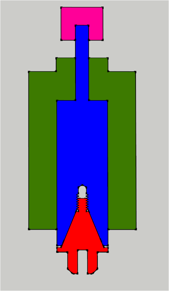

It's not a good idea. 20deg should be self releasing, but it'll also tighten as the machine runs, which is likely to give issues getting tool holders back out.
I'd look at getting the quickchange system repaired, or drilling out the spindle so a proper drawbar can be fitted.
Re: Advice on toolholders
Thank you, that's helpful. if the toolholder getting stuck is the biggest worry then I might try it once or twice to see how hard it is to remove them after they've been tightened up by some heavy cuts. I don't have to modify anything to test that. If you are right, as I suspect you will be, I'll look into boring out the spindle.

Personally, I wouldn't even test it. If the taper does lock, then short of drilling the threaded stud off, you won't be screwing the tool holder back out.

OK thanks, I'll look into boring it out. Out of interest though, and please excuse my ignorance, why would it be worse than a screw on lathe chuck for getting stuck?

Big lathes, the tapers never turn against each other. They're secured using either bolts, or a retaining nut.
The only small lathes I've seen with screw on chucks, use locating registers, not tapers.
Once a taper locks, you need to physically force them apart. They generally will not spin against each other, especially if you still have pressure holding them together.
By all means try it, however I wouldn't be surprised if they seize together, and you have to machine the holder back out.

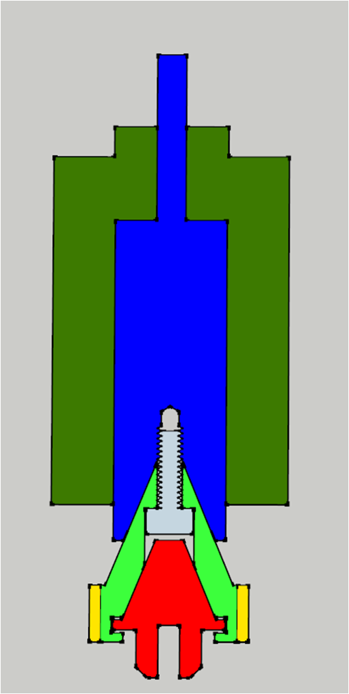

Questions,
In Fig 2 what is the diameter to the thing spindle part, the bit that holds the pulley.
What is the biggest tool you would be satisfied using ? Be reasonable here.
Any pictures as opposed to blocky diagrams.

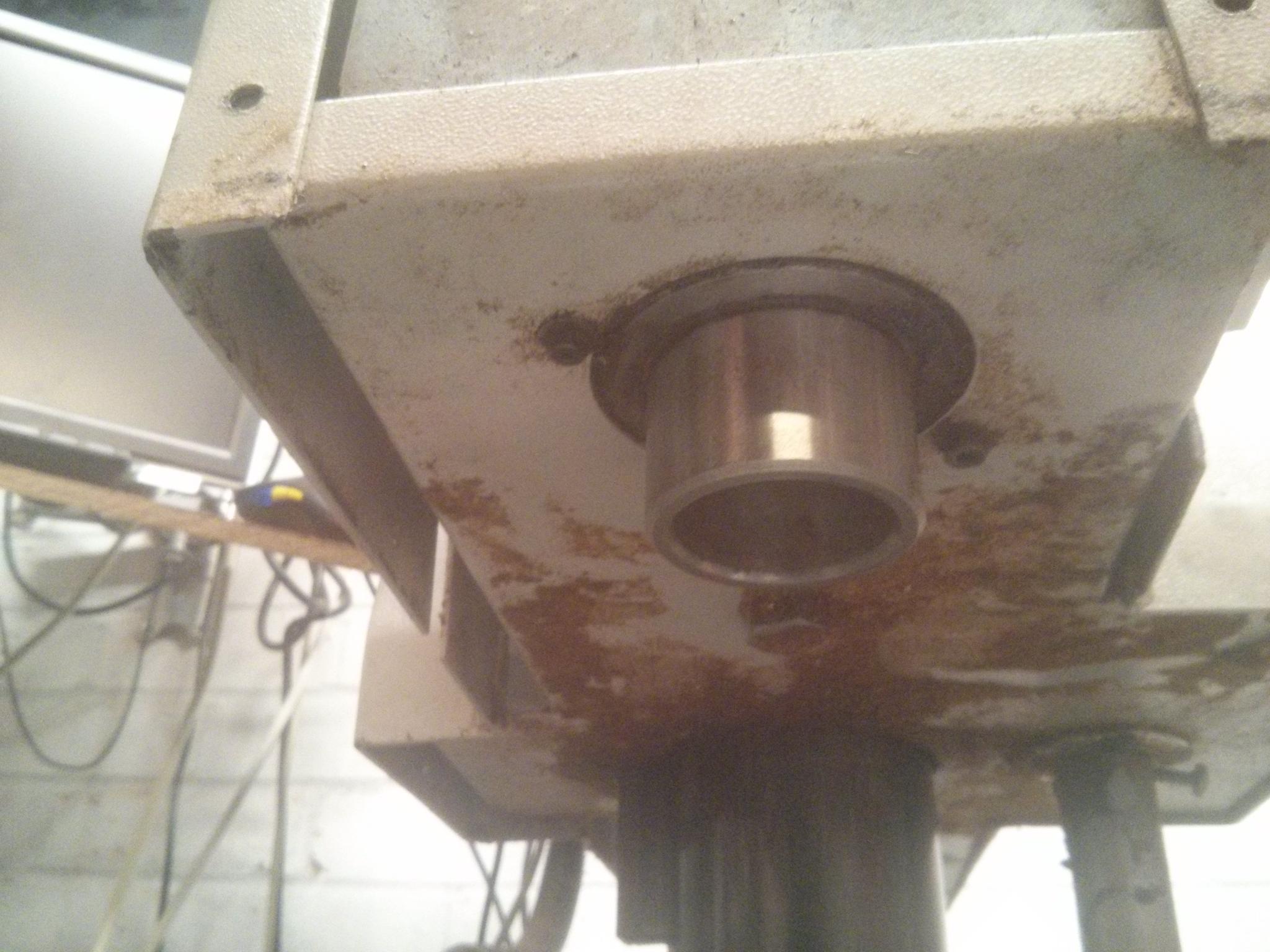

Here you go. The spindle block is enclosed, with all bearings and pulleys concealed. At the top there is only an 18mm diameter shaft protruding. Ignore the bit of aluminium extrusion, it's just a temporary mount for a spindle speed sensor.
Attachment 18022Attachment 18023
At the nose the spindle is 40mm in diameter

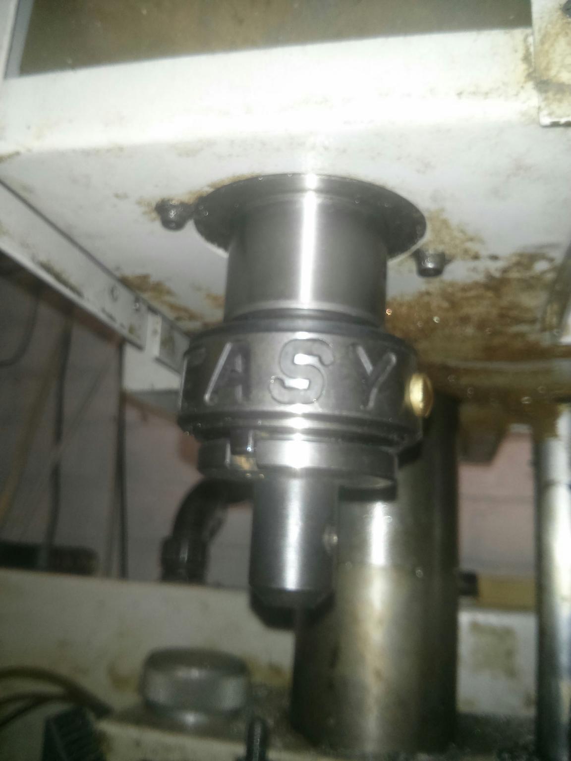

Here is the easychange chuck. To secure it you push a bolt from below, through the hole in the narrow end of the chuck and into a thread on the spindle. (see original post)

It's the Coventry Easy Change system, I have the same on my bench top CNC mill, it locks up nice and tight and works very well, check all the internal and external tapers for damage.

Is it just the light/reflections, or is the taper on that toolholder look like somebody's sanded/filed it?
I've got the easy change system on bench top mill, and my holders all lock in that tight, I usually have to use a screwdriver to break them away from the taper to get them out.
Could it be the ratchet mechanisms not working correctly?
I'd perhaps give Coventry a phone, and see what they say. It could be as simple as the spindle adapter needing stripped and cleaned, although I have no idea how they separate.

OK, thanks guys. I'll give it all a good clean and check over before doing anything drastic. Maybe the locking mechanism just has some swarf in in.
If you mean the toolholder with the threaded stud at the top. It looks rough because I've just rough turned it to check the principle. I was intending to grind and harden the taper before using it in anger.
So, it turns out that the looseness wasn't actually in the easychange chuck or the toolholders but in the spindle itself. Thanks for your help everyone. I'll start a new thread with a question on what to do next.
