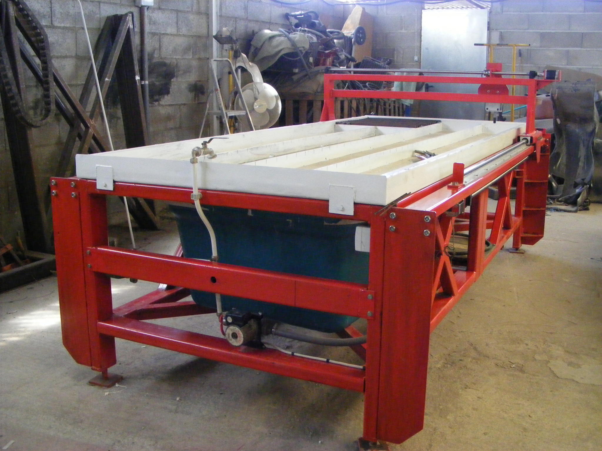

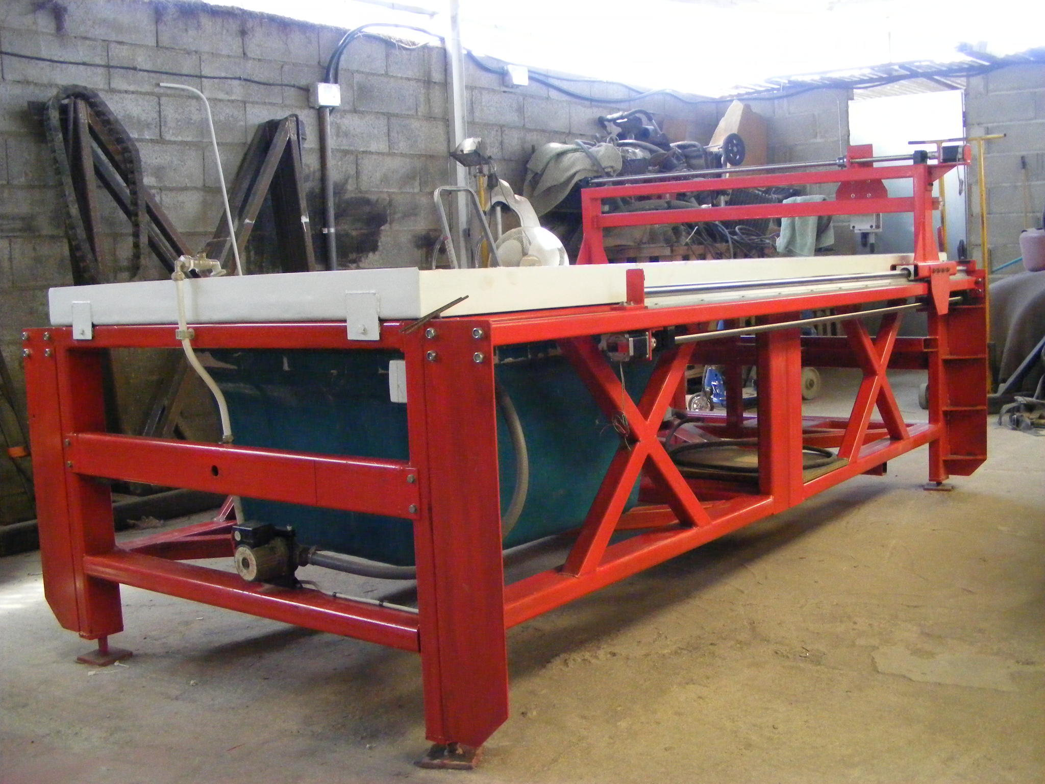

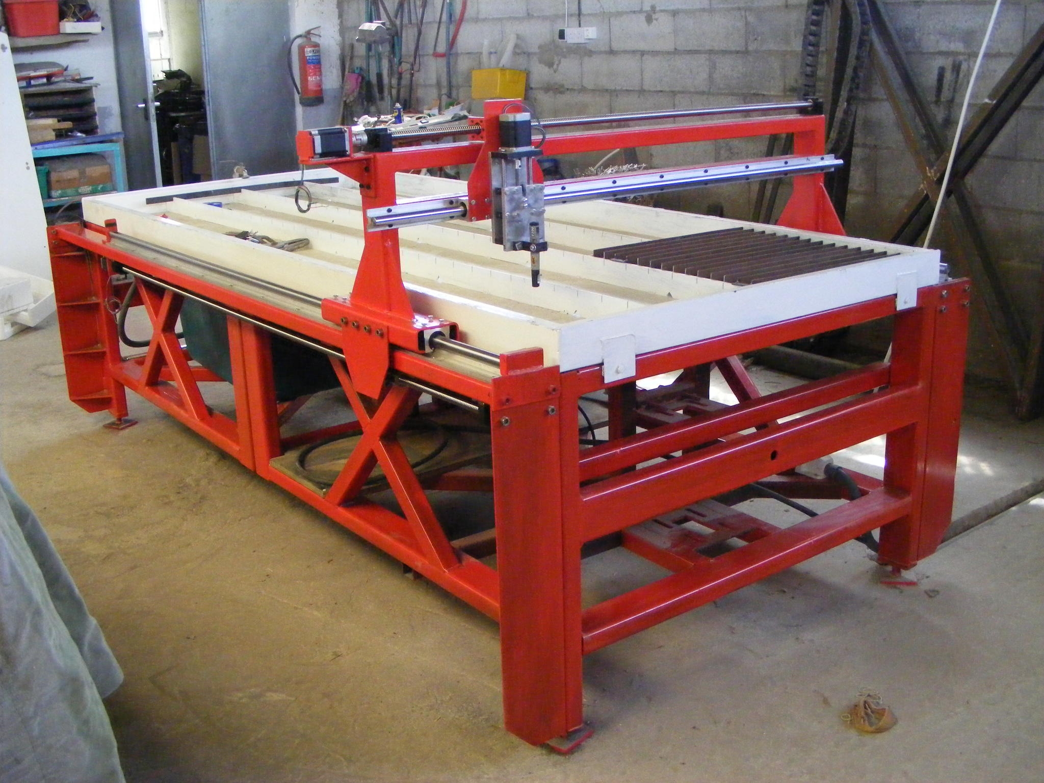

Ok - so here goes.

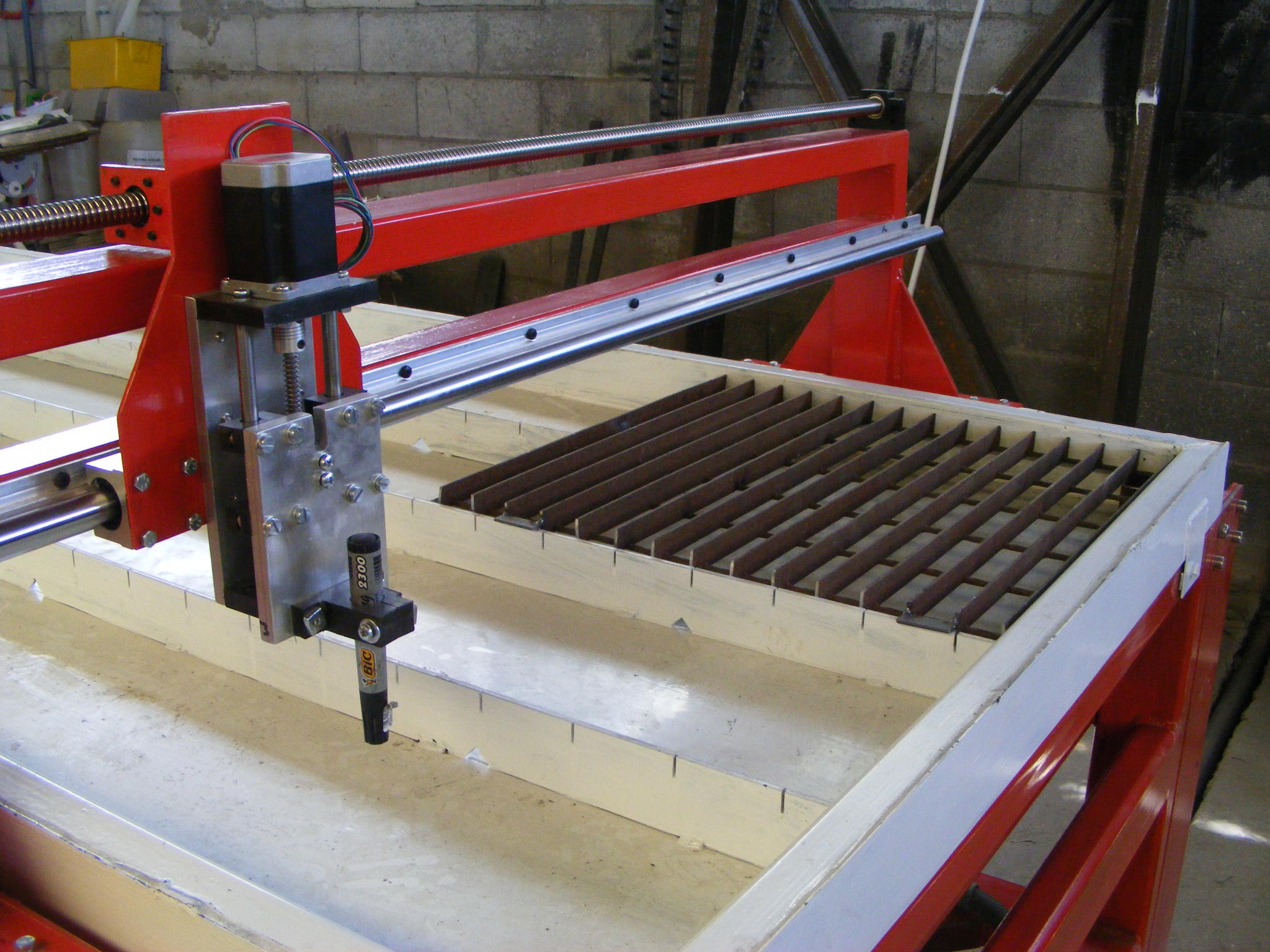

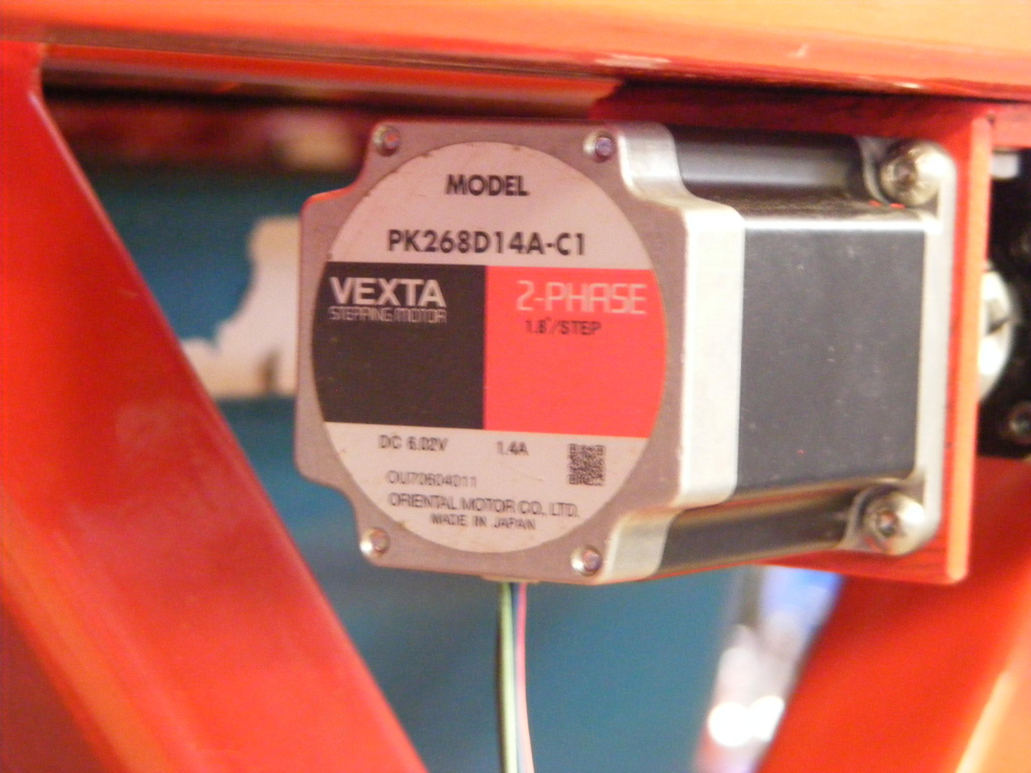

I've made an attempt at building a 8' x 4' water table. Ballscrew x, y, z axis (z axis with 150mm travel was purchased complete off ebay) Currently awaiting delivery of a Hypertherm 45 with machine head. Photo's to follow - please note: constructive criticism greatly appreciated as i've got to learn. Have 3 x nema23 motors (Japanese - forgotten make but will update) all currently direct mounted but the whole thing bolts together. Don't know if these are up to the job. Water table has a drain to catch tank and a pump for refill. 3 phase electrics to the machine plus a neutral for the single phase stuff.
Forgive the brain splurge but its easier to think that way.
Now - i'm out of my depth. When it comes to the drivers plus breakout etc was thinking of trying to get a plug and play system with proximity switches plus emergency stop included. Think MarchantDice do something along these lines. Biggest concern is cooling. Temperatures can easily hit 50 degrees C in my workshop in summer and don't want them frying. Was planning on running Mach3 as seems to be pretty simple - I like simple!
Well there's a start made. :yahoo:
Any and all advice greatly appreciated.

Temperatures are not a problem with good quality electronics. I also live in Spain and summer could be 50C in my garage and 75-80C in the electronic box. No problem so far.
Biggest concern should be ATHC/torch height control/ and at what speeds you will cut what material, cause for very thin material you could need faster speeds than stepper will provide. Depends how you move all of course, what type of bearings and how heavy.

Boyan It can't do the electronics any good to run a those temperatures. Leadshine state ambient temperature should be 0 - 50C and MAX operating temp. <80C so you are right on the limit.
So cooling should be a concern in my opinion.
Yes your Concern is valid despite what boyan says. Electronics of any kind don't like working in heat and while they may work ok @50c it 100% will shorten there life.
The fact your working with Hot metal won't help either so it would be good idea to put some form of cooling or air condtioning thru the control box.

Do you know the inductance of the motors? You might run into problems with the ball screws that long without rotating ball nuts.
For Plasma you WILL need some good electronics and they will have to be able to slave the second screw with homing switches. cslabs make some good controllers. Dean (Jazzcnc) is the go to person for advise on them here as he has fitted lots of them.
