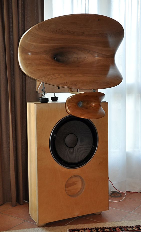

A specific job I have for the cnc router will be to machine audio horns – see attached picture. Attachment 18230 I will profile layers and glue them together. The maximum size I will be making is around 700 mm x 500 mm. I don’t expect to 3D machine them but to 2 ½ D machine them with 1-2mm steps, which will be sanded post assembly.

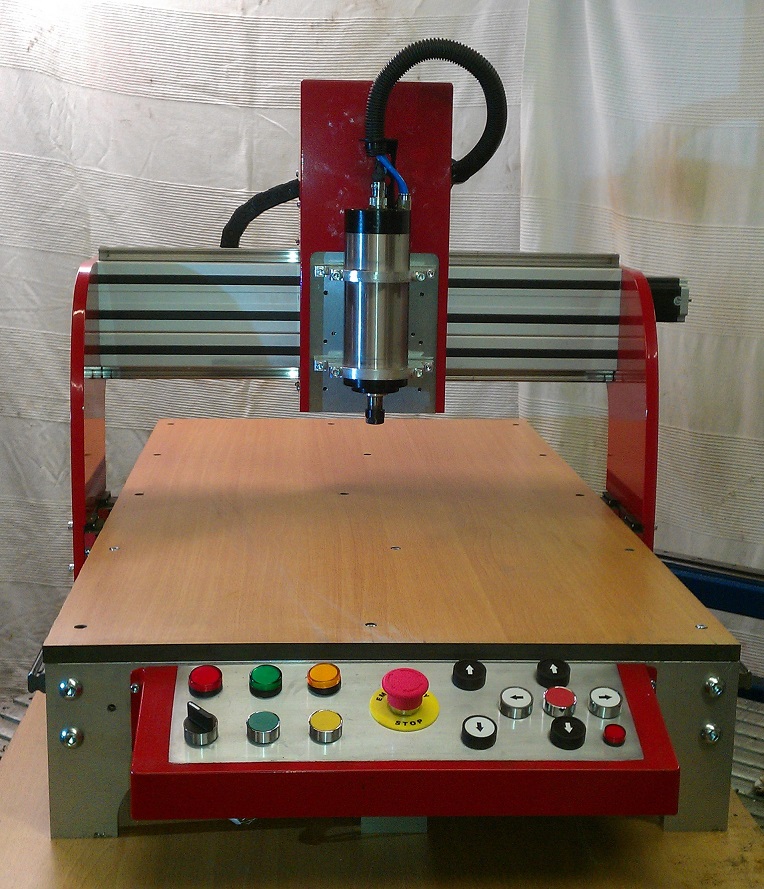

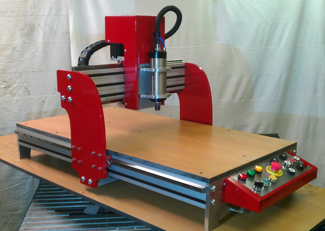

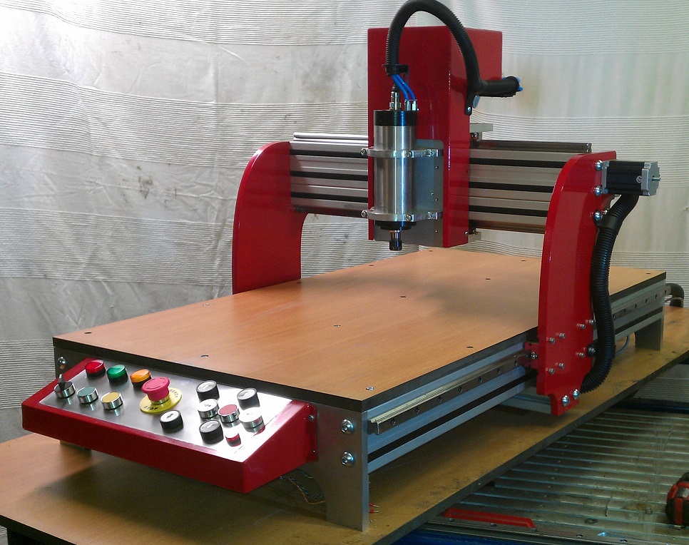

Can somebody give me a link/picture to some examples of the build quality of these "bespoke" machines, to give me an idea of what my potential diy effort will be up against.
Re: Greetings from Nottinghamshire
I like this one
/threads/9694-Hello-from-Slovenia-first-time-CNC-builder
Dean(JAZZCNC) had input on this one so can't go wrong if you follow his lead.
Mike
3 Attachment(s)
Stressedwoodman
Here you go one designed just for cutting wood and light aluminium work.
Attachment 18254Attachment 18255Attachment 18256

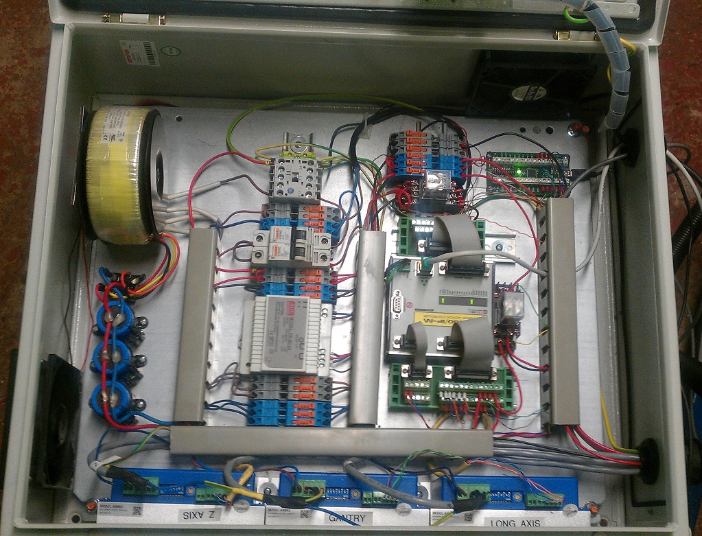

Nice paint job how about a pic. of the control box:star:
2 Attachment(s)
Clive S
Here you Go.!
Attachment 18267Attachment 18268
