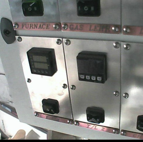

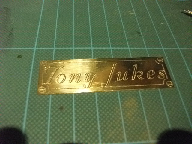

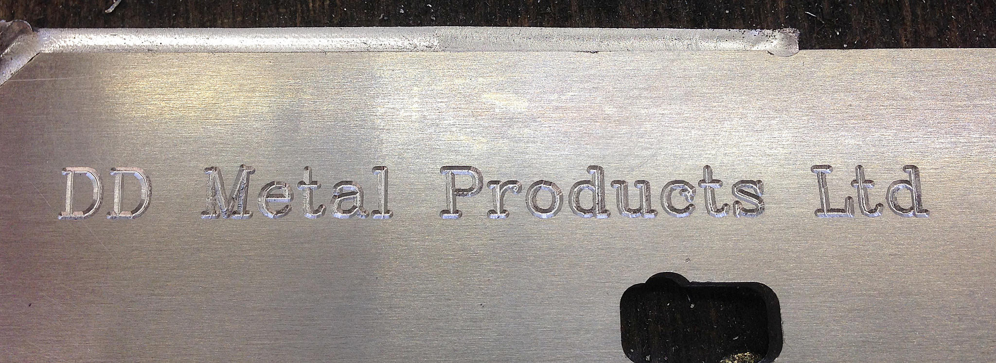

I find the problem is usually getting the material flat enough to the X-Y plane to get an even DOC. Taping down to a sacrificial MDF surface which I have skimmed generally works. I use chisel engraving bits with a 0.2 mm flat on the end.
Attachment 18235Attachment 18236
Here's a couple of examples, both are low res photos. The first was done with the chisel point engraver, it is 60x20 on .5mm brass with .1 DoC. The second is done on fibreglass PCB  using a 1mm two flute cutter to cut through the copper. It looks good with backlighting but the furnace is never switched off long enough to put that in ! I got the picture by capturing a webcam image, so that too is low res.

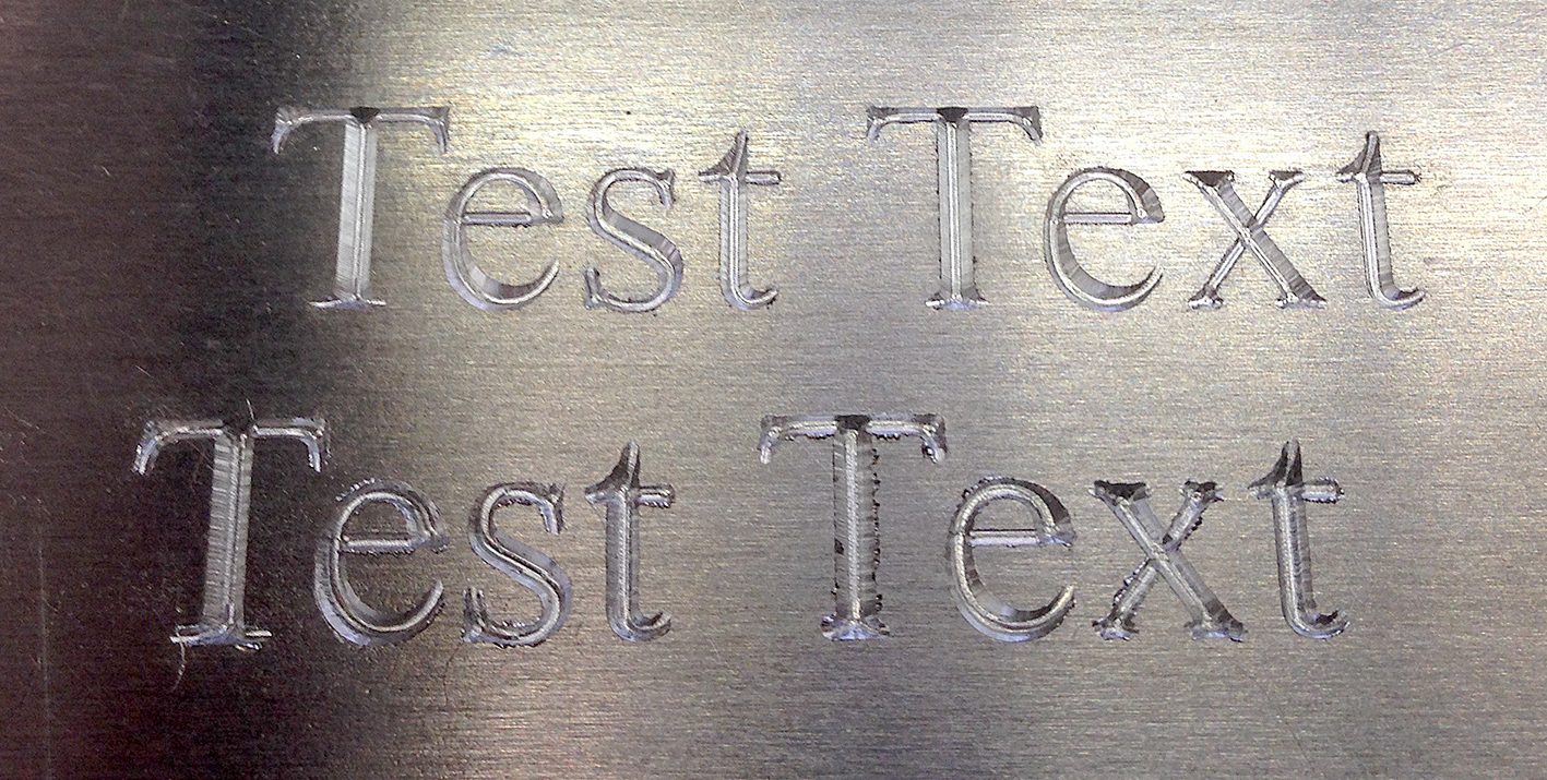

		Dave,
I think also you have backlash issues with the machine.
In the close up you have backlash marks at the top of the o and c and bottom of the d, u and s
I would worry more over this than speeds and feeds.
		Re: First engraving test :)
		I'm not convinced, it looks more like poor path generation - the letters are made up of lots of short straight lines and not arcs, I'm not sure the built-in SheetCam fonts are much good for this type of work.
If it is backlash then it is what it is and not much can be done about that - it's all new and I'm not about  to refit it :). It does not affect normal milling work so i'm not 100% concerned about it TBH, these letters are pretty small.
Will need to try text generated in another package before condemning it I think;)
		Just had a look at the code and it is indeed made up of thousands of lines of straight cuts.
I did a quick file in Illustrator then imported that into sheet-cam and with the same tool it now creates I/J arcs so in theory at least that file should cut a whole lot smoother I think.
		Yes, many times this is the reason, the line thing instead of curves. I always magnify  before generating path, to make sure all is smooth .
I would say also for fine engraving to have the Z0 using  probing with the V bit itself is the best method. That, and knowing the exact tip size.
		Yes, i always probe with the actual tool.
I tried cutting the Illustrator file tonight, yes it cut far smoother but it was generated as two paths which gave me a letter with an inverted V in the middle ;)
A settings issue, wrong font, wrong code generator, other problem?
Lots to learn here...

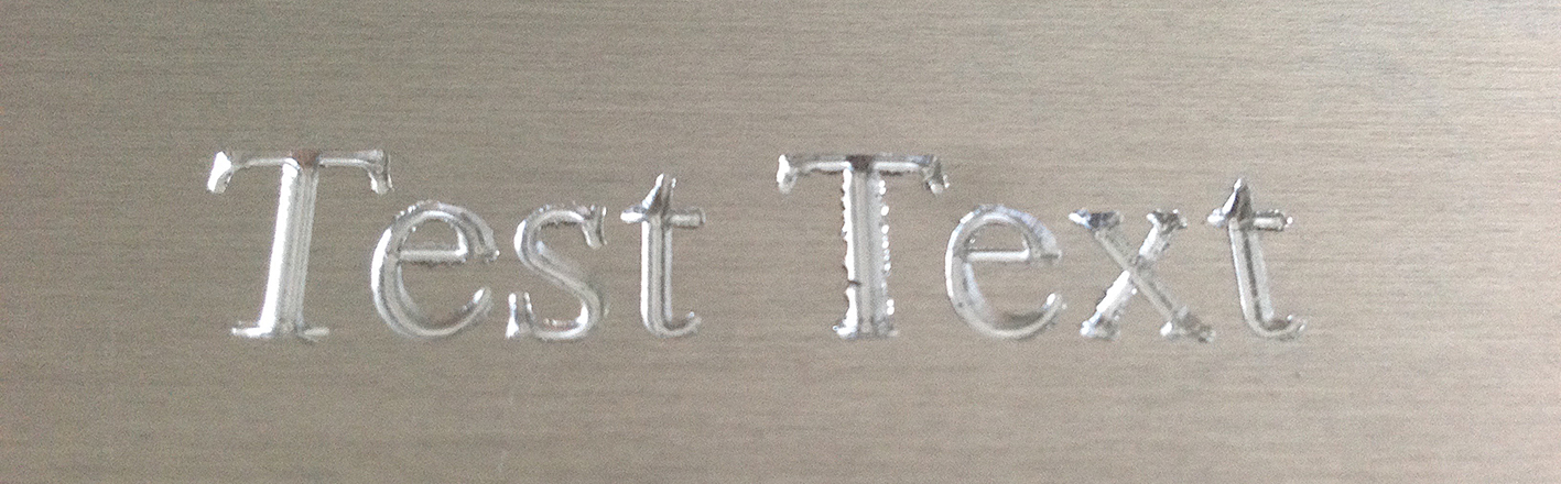

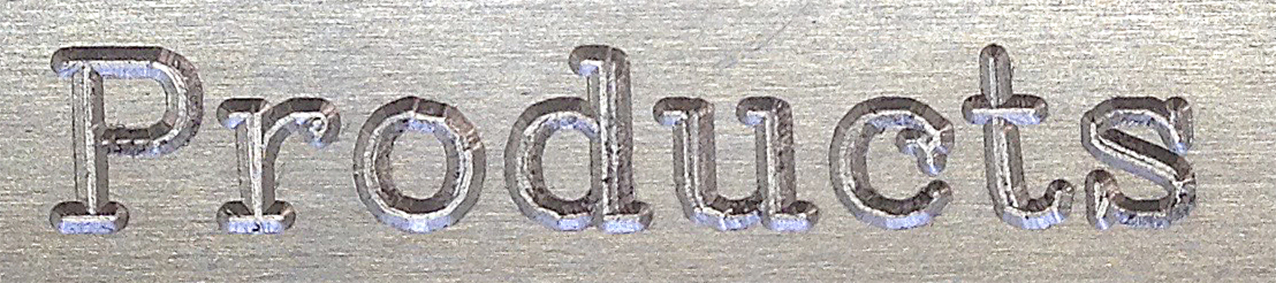

		2 Attachment(s)
		Following assistance from John S (thanks John) I have done some more engraving, this time using code generated in V-Carve and using my 3mm 30deg 0.2mm carbide cutters, the results were mind-blowing - razor sharp lettering, no burrs on the edges, could not be better and proves the machine is totally capable of detail work...
Attachment 18278
It was not without issue though as I am 99% certain that the first plunge took the ridiculously fine tip off the tool as the first pass at Z-0.25 was air-cutting, pretty certain i could see the tip come off as i was watching pretty closely. The cuts above were done after this though so the results didn't suffer, maybe too fast a plunge rate?
So, in the last few days I now have a working setup of Vectric, nice software it seems, still reading the manual ;) It is intuitive though and have got a test text file I was messing with, setup some tools, hopefully using the same settings extracted from Johns' file but this time using a 3mm 60deg carbide bit as this angle seems the most common?
The results were nowhere near as good and I was bit disappointed with them - there are burrs on the edges and the cuts are generally crap under a magnifying glass looking like they were hacked out with a machete ;)
Attachment 18279
So, obviously lots to learn here, any pointers???
Davek0974
Attachment 18278
Great!
Its a common problem- about the tip i mean. I am extremely conservative with the plunge rate of V cutters, even in wood.

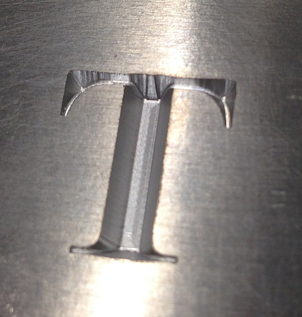

		2 Attachment(s)
		Bit better today, dropped the feedrate to 500 and plunge to 150, this was the same file - new one on top, yesterdays' one below - a much better result but still a tiny burr on a couple of the verticals.
Attachment 18280
15mm high 'T' this time with a flat-plane limit set of 2mm so it bottoms out. Came out very nicely i think, picture does not do it justice, iPhones suck at macro work ;)
Attachment 18281
