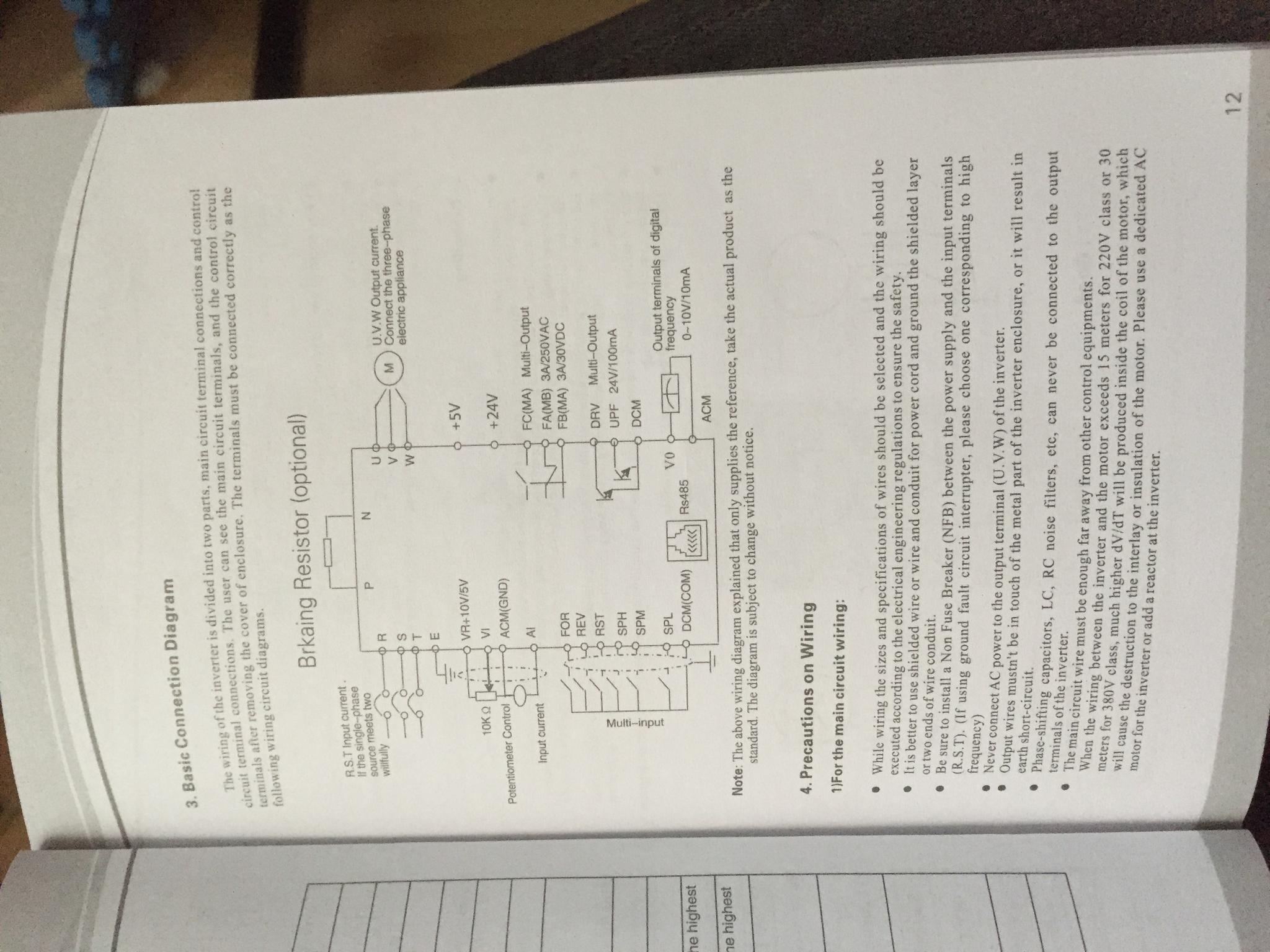

Thanks ive got that, I've got the spindle running however I can't seem to work out how to control the RPM
Thanks Clive, yeah I've tried that don't suppose anyone has a diagram do they? I asked Bert but he says that it's best to look in the Hanyan VFD manual
I have HY 2,2 book here what are you after what model is yours according to book PD160 needs to be set to 1 to enable 1-10v control
page belowAttachment 18306
I need to know what I need to connect to in order to ramp up the speed and decrease
2 mins will get pages up for youAttachment 18310Attachment 18308Attachment 18311Attachment 18307Attachment 18309
Thanks fella I will have a look through
Don't forget the jumper J1
