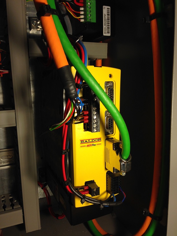

Second post in the thread has the Pro diagrams - the Pro uses a Baldor Microflex servo control for the spindle drive
Baldor Drive Microflex Installation Manual
http://www.denfordata.com/bb/viewtop...ilit=microflex
this servo control is a real beauty, I've no idea what they cost

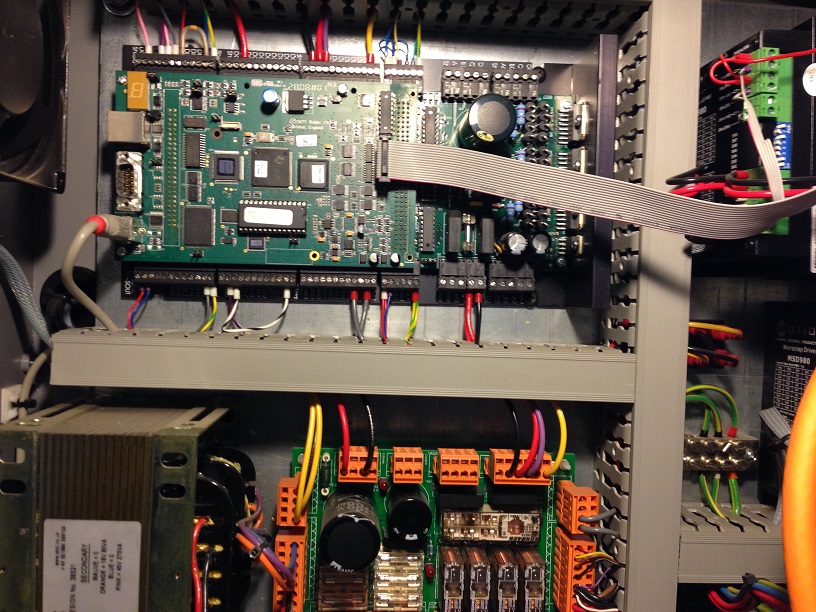

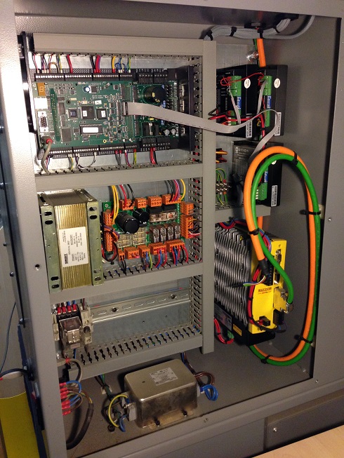

fyi, here is the inside of the VMC 1300 Pro
Attachment 18463
Re: Anyone converted a Denford VMC 1300 Pro to Mach or LinuxCNC?
That's quite a bit different!

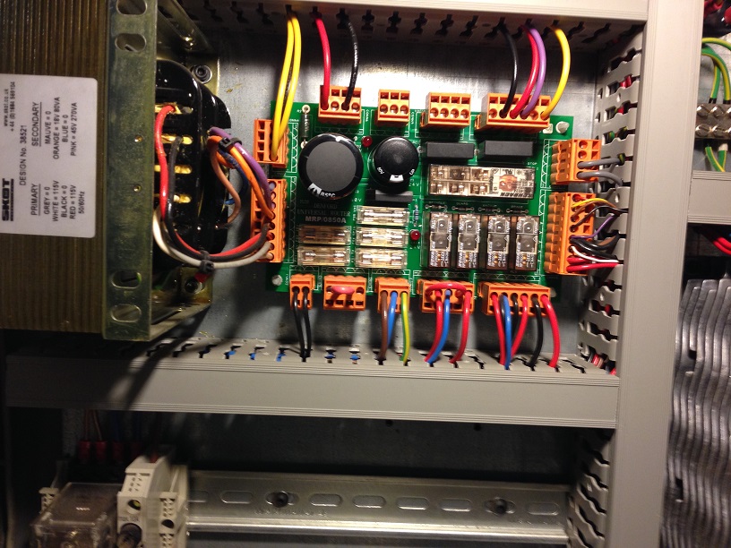

They're not using the onboard stepper drivers, so there's not really any point in keeping any of the existing motion controller boards. You just need to find a manual for the three stepper drivers that are fitted.
The biggest thing you'll need to work out is the wiring for the relay board in the centre.
Is the existing controller using USB? If so, does it still work, or do you not have the required software?

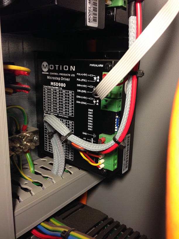

m_c - the existing controller interfaces via USB to the Denford software and all works fine. It's great for students, but the machine is so capable that the project is to do the conversion, both to learn about control and to get to more "standard" software.
The steppers are MSD980 Microstepping Drive http://www.motioncontrolproducts.com...ing-driver.pdf
The cabinet is nice and open so it's easy to see where each wire runs. A few other pics...
Attachment 18471Attachment 18472Attachment 18473Attachment 18474
Looks like that middle board also handles the stepper power supply, going by the transformer connections and capacitors. Have you found a wiring diagram for the machine, as it'll make working out exactly what that board does, and what signals it needs to work, far easier. If there's not already one over on the Denford forums, try asking as they're usually pretty helpful.
