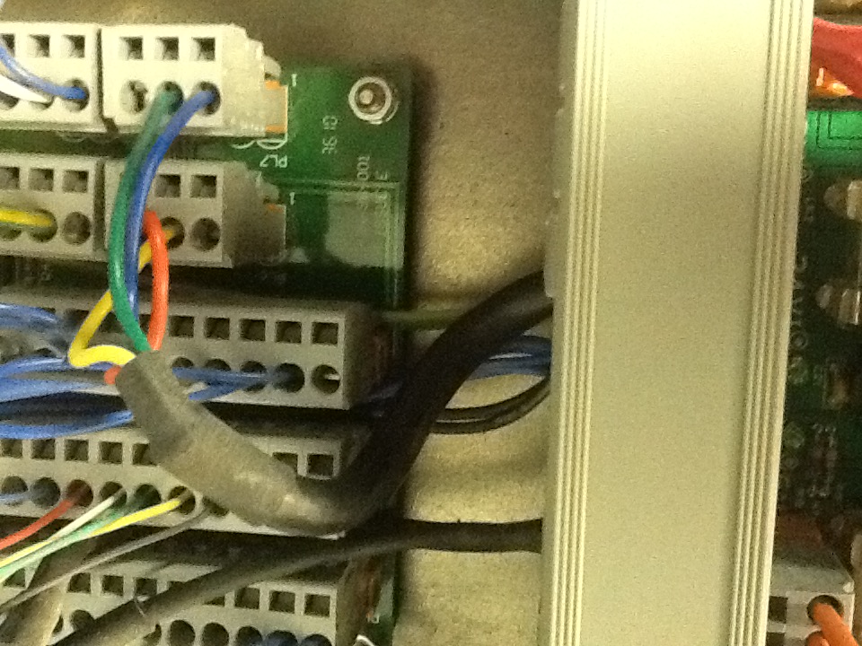

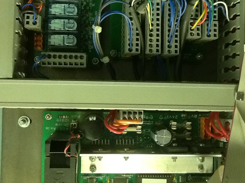

Which is why I said to physically trace the wires inside the control box. The stepper driver wires should all connect in the same area, possibly to an individual driver, which means you know exactly what wires power the stepper motor.
Then it just leaves the other individual wires, which by tracing, will hopefully connect to a terminal with some form of name to work out what they do.
I would very much doubt that all 8 wires are solely for powering a stepper motor, given Boxford typically only use 4 wire drivers.[/QUOTE
Sound advice, been into it today, 8 wires in the socket
2 red singles 2 orange singles.
1 multicore red blue green yellow.
traced back to 2 boards
Attachment 18516Attachment 18517
Ok up til there . . . . I can meter out one of the other steppers to work out the wiring, but I haven't a clue what the red and orange ones do - they are a bigger section (18swg) than the multicores. Could they be for power ? Galloping ahead, I have never seen one of the Boxford 4th axis' in the flesh, does anyone know if they are direct drive or reduction ?
