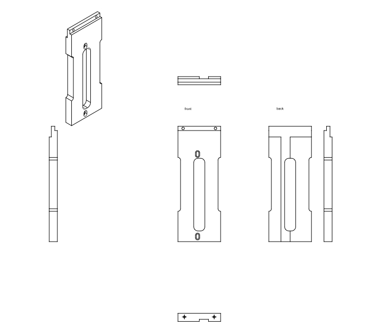

My CNC experience is related to plasma cutting and more recently my mini-mill which so far has only been used to cut profiles from flat sheet and put holes etc in them as needed. I use Aspire or SheetCam for the CAM.
I am now converting my Bridgeport to CNC to expand my possibilities, all 3 axes will be controlled.
I need to make some parts for the Z axis drive and these can be done on my mini-mill which is handy as the Bridgeport is in 1000 pieces at present ;)
However, with my limited 2D knowledge so far, it was not until started modifying the drawings which were kindly sent to me by a previous converter that i realised how little I know about making the file for a 3D part :ambivalence:
Attachment 18537
The picture shows various views of it, it has features on front and back, holes, a large slot etc.
I know pocketing, contouring etc but what is the missing link here?
My guess was to machine all the front details, holes and the outside first from a larger lump of plate, this would give me a part with the edges to size and one side finished.
Then, flip over, pick up my X & Y datum from whatever corner I use, and machine the back face - this is where I hit the knowledge gap - do I remove the outline (it's finished) and convert the features needed (a T-shaped slot) into full outlines on their own or something else??
I have never seen any other CAD source and my 2D stuff seems very simple compared so???

I am as new as you at this but in fusion I would create front as required and then copy that whole object flip 180 deg and add back detail to second copy.
Then use blocks fixed on bed to ensure accurate placement when flipping before starting to machine the reverse after contour cut before removing piece adding blocks for placement.
2 single 2d operations on one part if that makes sense.

Yes, but the paths for the reverse - do these have to be just the T-shape pocket required
i.e. the front would be the whole object and the back would look just like a large T shape with no outline at all?

Yes only cut the slot and contour once then flip to machine only what could not be machined from front, so back would just be a T shaped pocket to required depth. I would start from same corner point on second setup but on other side of material obviously. Although placement may be easier to cut slot and T Pocket and holes first and then flip to cut remaining front using holes and pockets to fix back down.

The slot is pretty wide so i would position the material to place the eventual slot over a run of bed holes, machine the slot plus the two small ovals, then fit clamps into the slot and finish the rest of the front.
As you said, then place blocks on bed touching the finished edge, flip over, clamp around the edge and machine the pocket T.
Seems to make sense now, will finish the drawings and do a simulation or two :)

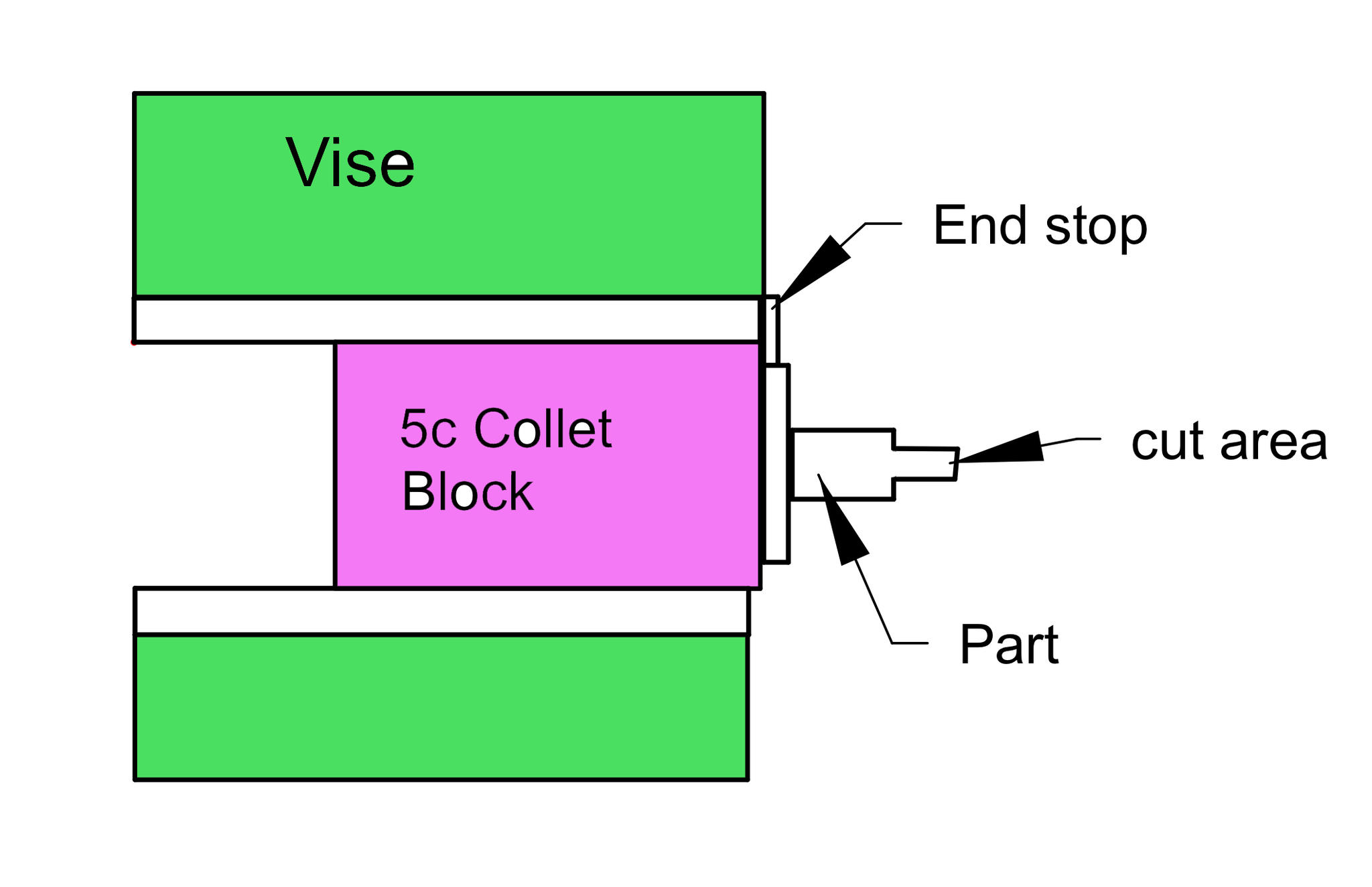

Looking for suggestions on how to do the CAM for a part i make batches of manually at present, it's a round shaft with a square peg on the end. I have the vise mounted usually in one place for long periods so a G5x offset seems good, I can ref off the fixed jaw front and end.
It's not shown in my sketch but the radius of the tool is used to create a radius at the point where the square peg meets the body - just run the tool in from the end.
The part is held in a square 5C collet block at a fixed depth, the vice is fitted with an end-stop so pretty much all settings are repeatable and fixed.
I am looking to machine two sides and the end, rotate the block 90deg and re-run.

Just looking for ideas :)

In all honesty, I wouldn't bother with CAM.
I'd probably hand code using work offsets. Use a reference point (i.e. touch of end of material, then touch of the side) to zero the work piece coordinates, then hand code based of that.
At most I'd use the Mach wizards to generate the code for each side, if multiple passes on each side is needed.

Hmm, thats a leap forward, not hand-coded anything yet ;)
Once the refs are made - end for X and centre of rod for Y, i can see saving them as offsets - they will not change unless the vise is moved which does not happen too often. So i just need to figure the path out i guess.
The manual ones i cut in one pass, its a little heavy on the tool but works ok, with automation i would likely use two passes as the steel is harder than plain mild.

Why not do them vertically then you wouldn't have to move them.
If you want the radius use a round nose cutter.

Thats an interesting thought, thanks.
Cutting forces would be harder to resist but not impossible, I have a 5C collet holder with vertical/horizontal bolt-down base, could use that if it grips well enough.
Will need to test this when i get her running :)

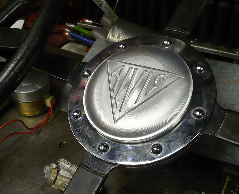

Aspire can do some 3D work.
This was done in Aspire
http://www.stevenson-engineers.co.uk...vis_wheel2.jpg but for parts with curves, think a mobile phone mold etc you need 3D / fusion 360
For most part they are just built up from 2 1/2D parts that Sheetcam can handle fine.
Carry on as you are and jump later if needed. the time for the learning curve is far better spend doing what you can do.
