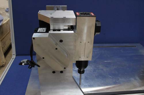

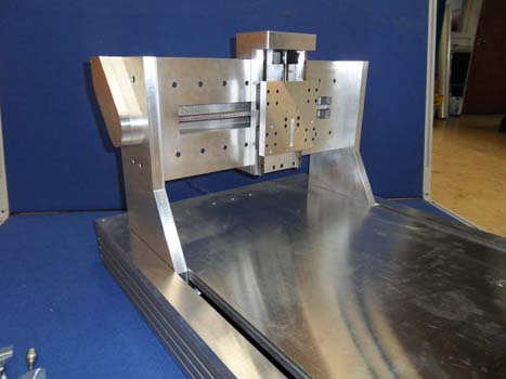

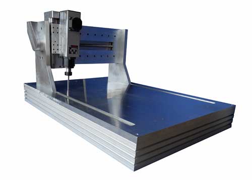

Zapp Automation and our new range of CNC Mill / Router machine and Kits
As you know we have not sold machines or machine kits, because we felt what was available on the market was not to a standard that we could offer to our customers and because of this we have decided to make our own machines here in Poole, using the parts we sell and a lot of you are familiar with.
We have started with one machine, but made it quite modular so to let us expand the range as an when we can and this machine should site in a size bracket that should appeal to most people looking for what we woudl call a desktop sized machine.
The first machine we have called the 10060, i know its not a catchy name, but to be honest with you the name was not our biggest concern and may change when something more catchy comes to mind.
I have seen a number of companies put details of there machines up on this forum and watched as they were ripped to shreds by some of the more knowledgeable people on here, so if you have any suggestion, please feel free to post them and i will consider them.
This is an image of the machine as we are offering it at the moment, but this is the bare-bones option with a lot of other options available, like axis covers, hood, mist, cold-air cooling, flood, atc and so on.
Attachment 18719Attachment 18720Attachment 18721
What is different to other companies is we will be offering a number of option, so if you want you can buy the complete kit or just an axis, and wen you can afford another axis you can buy that. or you can buy all of the parts individually.
Initially you will only see the mechanical parts available (Plus the motors and limit/home sensors), but as we progress we will also offer the electrical control cabinets as well.
We have been using the first prototype for a few months now finding all the issues and fixing them and we now use the latest version to make most of the parts.
Ok, so this is the specification.

I know a lot of people like a long Z axis but we have decided to go for something that gives you about 115mm to keep the rigidity to the best we can, and i would also point out that over the months that we have used it, we have never needed anything more.
The X axis has two ballscrews (R1610) and 20mm profiled rails, the Y axis has a single ballscrew and 15mm profiled rails and the Z axis has R1404 ballscrew and 15mm profiled rails.
all of the ballscrews are C5 and the profiled rails are precision class. We also have concertina bellow covers for the Y and Z axis and are working on a cover system for X axis, but this axis is already quite protected because all of the linear motion parts are under the machine.
To make way for us manufacturing these here, we are going to need to remove some products that we currently sell from our range and you will see these on our website on sale at the moment with up to 50% discount.
One of the products that we are removing that may effect people here is our C7 range of ballscrews and in the future will only be stocking C5 or C3 ground up to 25mm diameter.
I have a lot of other images, so if you want to know anything i can post images for people to rip the shit out of it (Only Joking, be nice Jazz)

Don't know what you mean.! :whistle: . . . Need to see more before passing comment but looks ok so far. BUT then we need to know the all important £££££.:greedy_dollars:

£4.5k for the full kit, I don't dabble in this market so I've no idea of pricing?

Well it's seems lot of money for self assembly KIT that still requires belts, motors, drives etc but got say it's very well spec'd and on first inspection looks capable machine. I see things that wouldn't consider ideal but nothing too serious. For first attempt then Gary and lads look to have done a good job. .:applause:

I knew price would be the first thing that same up, but with all things they can be refined. The issue is setting the price right when there is not a lot on the market to the same specifications. We have not skimped on anything and all the linear motion parts are high end to get the specifications we wanted to achieve.
Re: Zapp Automation and our new range of CNC Mill / Router machine and Kits
Jazz, if you see something that is not ideal point it out.
I want to know so if it is possible we can change things.
