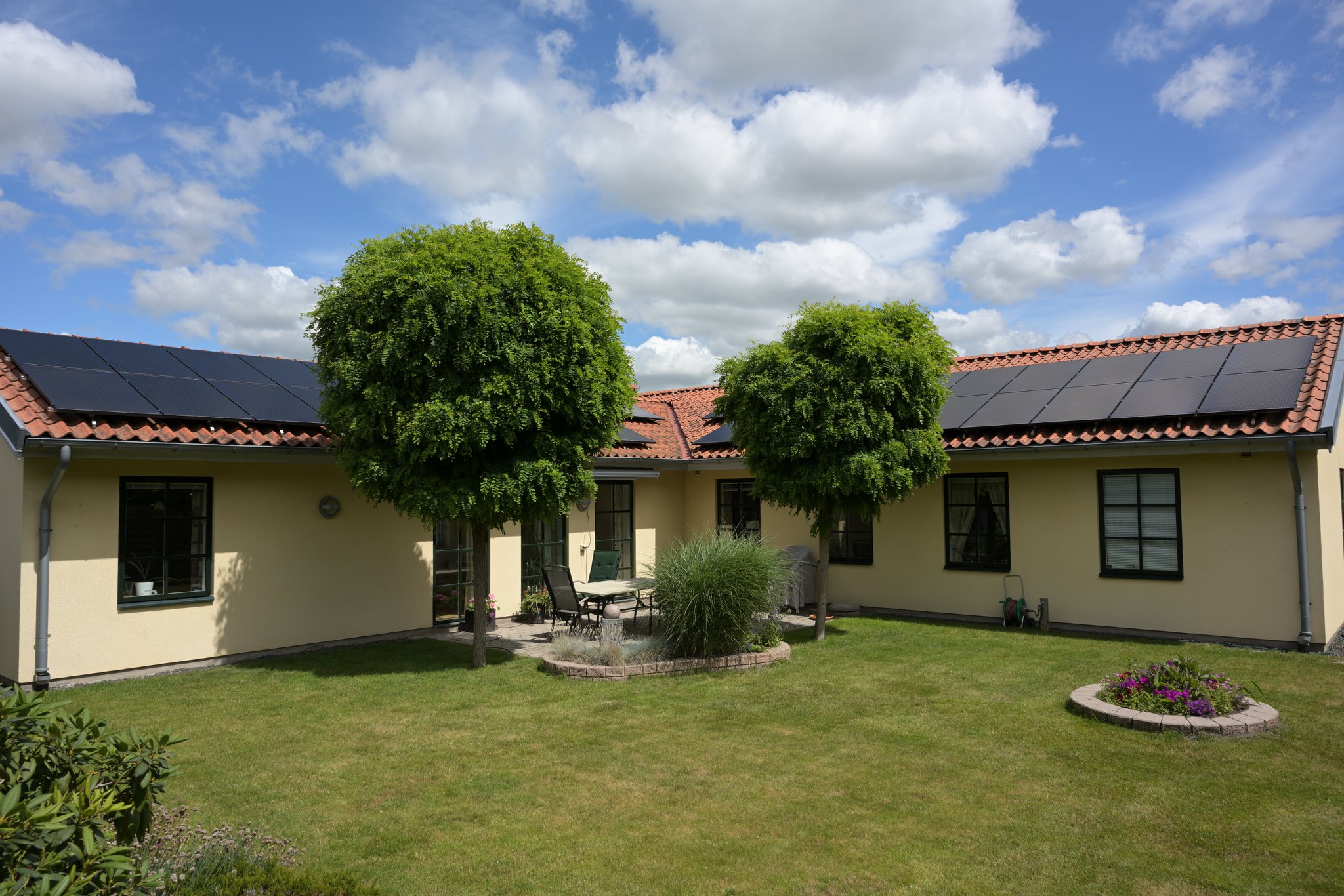

Had this since over 3 years.
Attachment 31787
It's a Solaredge system, producing about 11 MWh each year which is about half of our need. We didn't invest in battery packs because it was not worth the price. Looked at battery packs again just two weeks ago and is still too expensive. We sell back what we don't use. One of the best investments we ever made, especially since we use electricity to heat our home and also charging our cars. One EV and one PHEV, both will be upgraded later on this year with two new EVs, which we ordered last year.
Good luck. You won't regret it.

Thanks I remember you talking about your system a while ago, very impressive. From my research it looks like everyone is different as their needs and use pattern is different so hopefully this will work for us. Selling back in the UK is not great and I think it is about 5p / kWh whereas they sell it for ~40p / kWh at the peak rate. So a battery pack was OK for us to charge in the day and use in the evening and overnight. We have gas central heating and electric storage heaters are very expensive so we will stay with that for now, so that lowers our requirement. We would also have to go up massively in spec to charge a car so we are going with overnight cheap rates on something like one of the Octopus tariffs. Let’s see how this goes.
