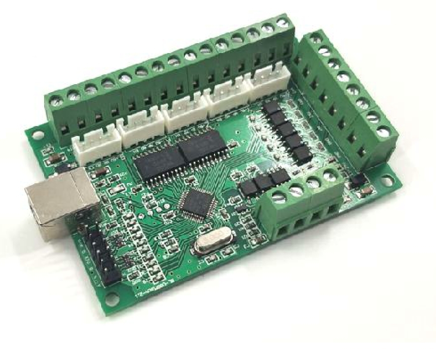

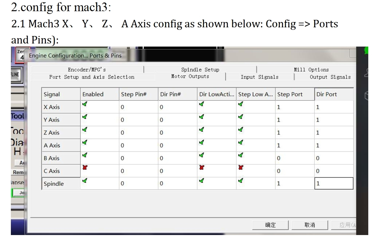

My Mach3 5 axis controller board came today and although there was a lot of documentation supplied with it, there was not enough to setup the board properly.
All the stepper motor settings are shown as 0 for all the steps pins and all the dir pins. I know that is not right, but how do I determine which are the correct settings? Can anyone help me with this?
Attachment 30197
Attachment 30198
Board name is JDSW51B

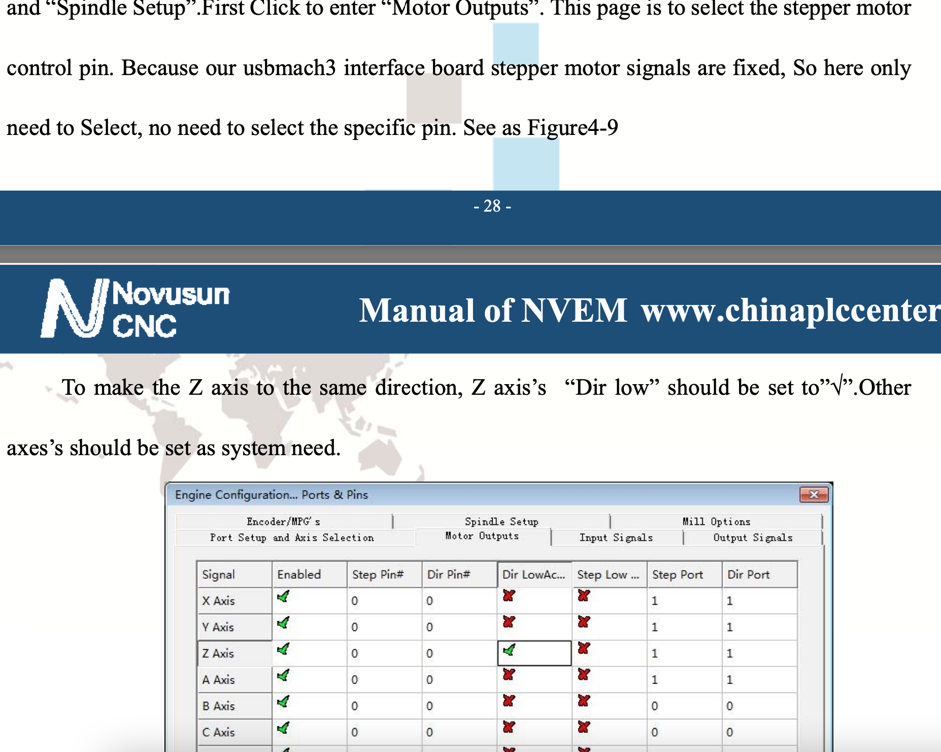

I don't know your board, but a Chinese NVEM controller specifies in the manual that the X/Y/Z/A/B/C ports are hard-coded in the driver and you don't need to specify them in Mach3 (defaults to port/pin 1/0). Try it and see.
Attachment 30199
Re: Missing information for Mach3 settings
First google hit I found on that board number confirms the above.
Doddy, where are you getting that he's using an NVEM controller from.? That picture is of a standard BOB.!
Regpye, this link is a better manual and may help, if you don't understand it just say so, and will talk you throw it.
https://www.steppermotorcanada.ca/bl5breakoutboard.pdf
Thanks jazz, read page 5 of the link you provided, same as the link I provided from the Russian site to back off the analogy i first posted. My first post clearly started the info from the different card and was what I had to hand at the time.
My recommendation remains, try it as is, the provided driver software hard codes the output mapping

Mach3 knows nothing about USB, so definitely the board is an motion controller.
On the picture:
http://www.mycncuk.com/attachment.ph...811440&thumb=1
is clearly visible a micro controller (no matter which type but looks as some STM32Fxxxx).
So, motion controller with BOB :)

I wired up the motors and tested mach3.
Some things changed in the pins settings, the motors for X Y and Z all got populated with pulse and dir pins, but not A.
I tried running the motors and they all worked fine, except I have not been able to get the A motor to turn.
I swapped the wiring over between X and A and the motor and driver is fine, so the settings for A are not there in the configuration.
I tried putting in some settings from another setup that has 5 axis, and it didn't work, so now I don't know what to try next as far as getting A to work with Y as a slave. (or even separately just to test it)
