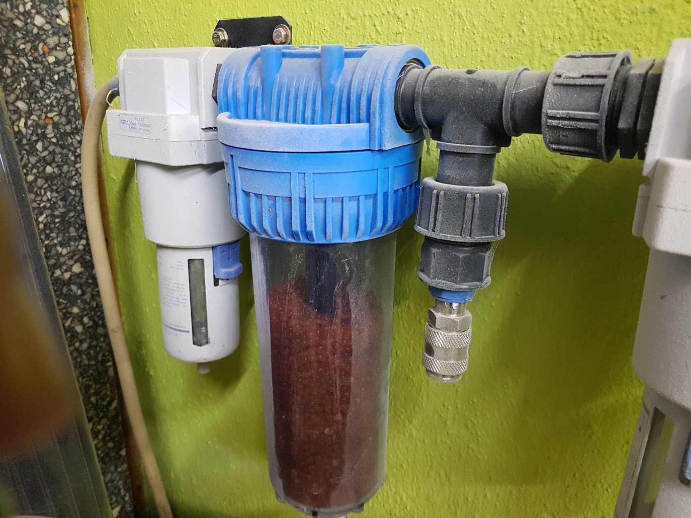

    PS. Without air drier =Mission Impossible. DIY one from water filter vase filled with reusable silica
Name:	air drier.jpg
    PS2. Even if you are tempted to use cans, dont do it. You will never even get close to the desired result, whatever sb would advise you. There is no free lunch.
