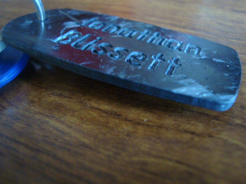

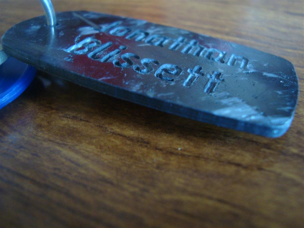

    I've tended to use diamond burrs, the type you find in rotary tool sets, for cutting carbon. Even less than 55p each! Here's a recent example:

    And a not so recent (T-5 years) example (probably already posted somewhere on this site):

    I'm still using that keyring - amazed that I've not lost it yet. I'll splash out on the cutters suggested here for the next part and compare...

    Deffo splash out Jonathan that carbon looks really chewed up :(
    This ones not been deburred or anything yet, but as said just a quick rub round the edge with wet and dry and it's burr free :)
    It's just the edges, which as you've noted, clean up well with sanding. I agree it's not ideal.
