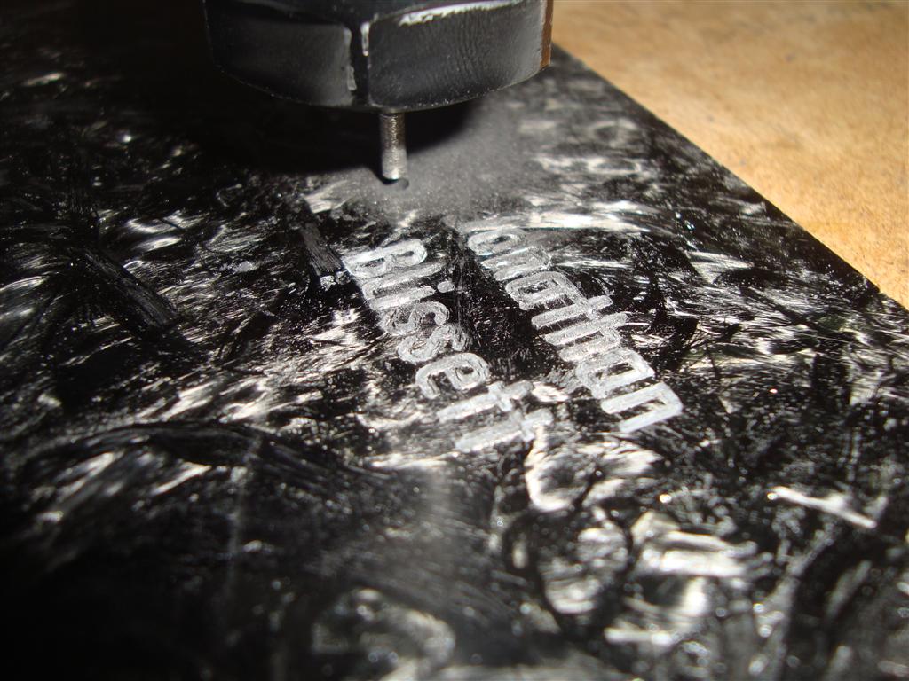

    I've tended to use diamond burrs, the type you find in rotary tool sets, for cutting carbon. Even less than 55p each! Here's a recent example:
Name:	2016-05-25 22.34.57.jpg

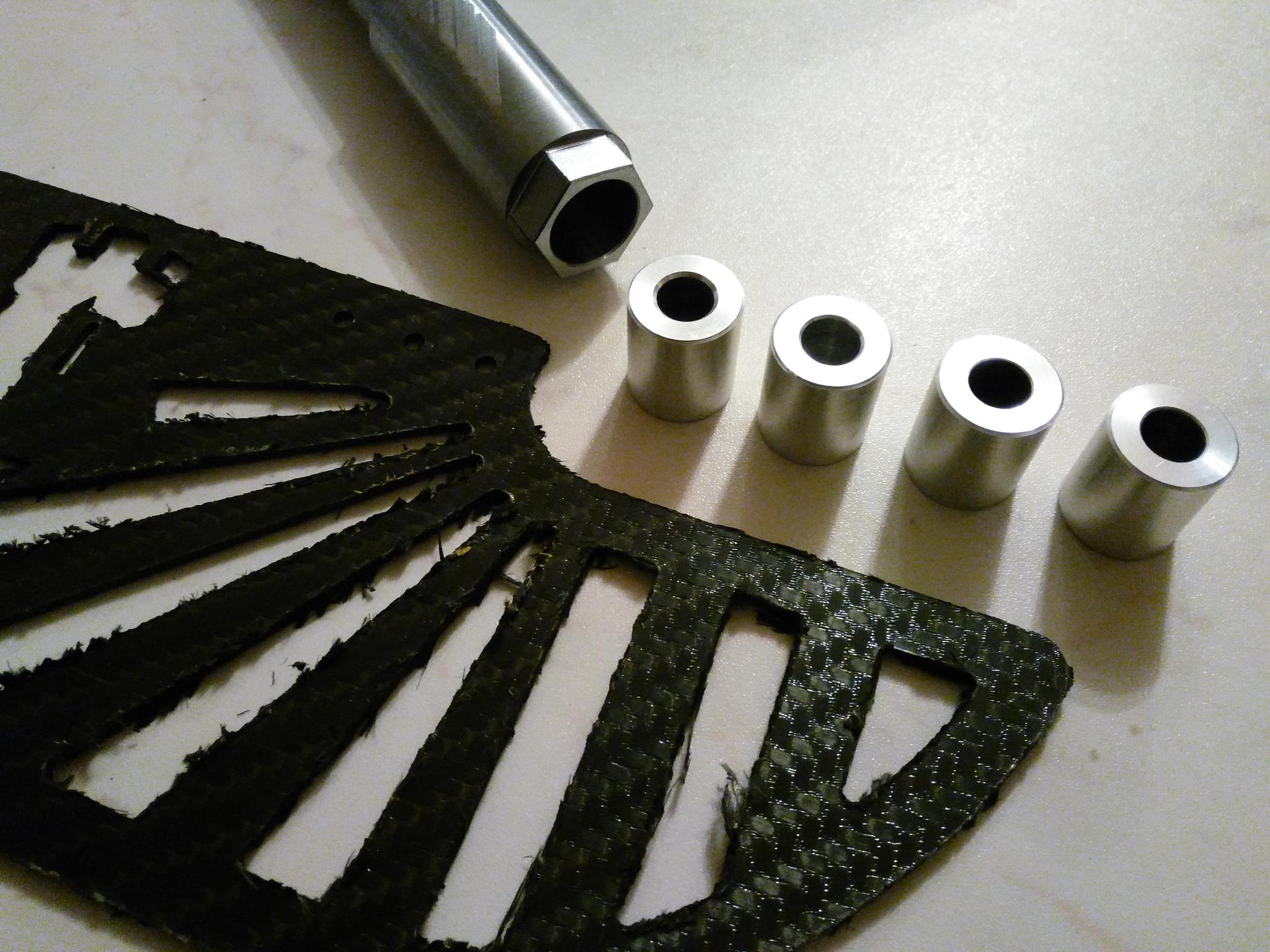

    And a not so recent (T-5 years) example (probably already posted somewhere on this site):
Name:	DSC07006 (Medium).JPG
ID:	19057Click image for larger version.
Name:	DSC06996 (Medium).JPG
    I'm still using that keyring - amazed that I've not lost it yet. I'll splash out on the cutters suggested here for the next part and compare...
