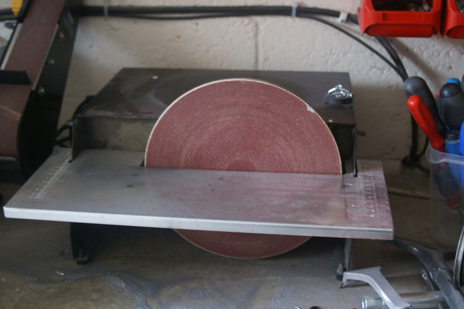

    Here you go and note that is an 8" sanding disc for size. I cut the top in two and spot welded a piece of angle iron for support, modded the angle adjustment by welding some nuts lower down to accommodate the thumb screws. Forgot to mention the motor is just an angle grinder inside, running like this is very quiet. The cheapest i saw at the time was a pro bit of kit which was £140 at the time
