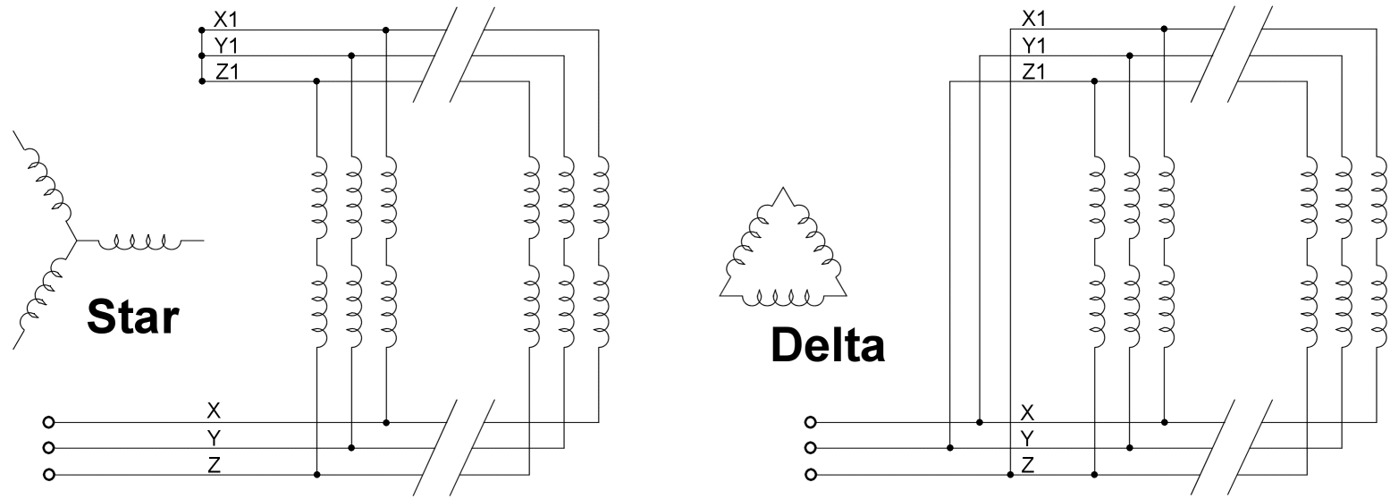

    I have found a diagram depicting the star and delta wiring methods and will study it although do you think that the new spindle needs a new kind of wiring as we thought is generally the same as the old one.

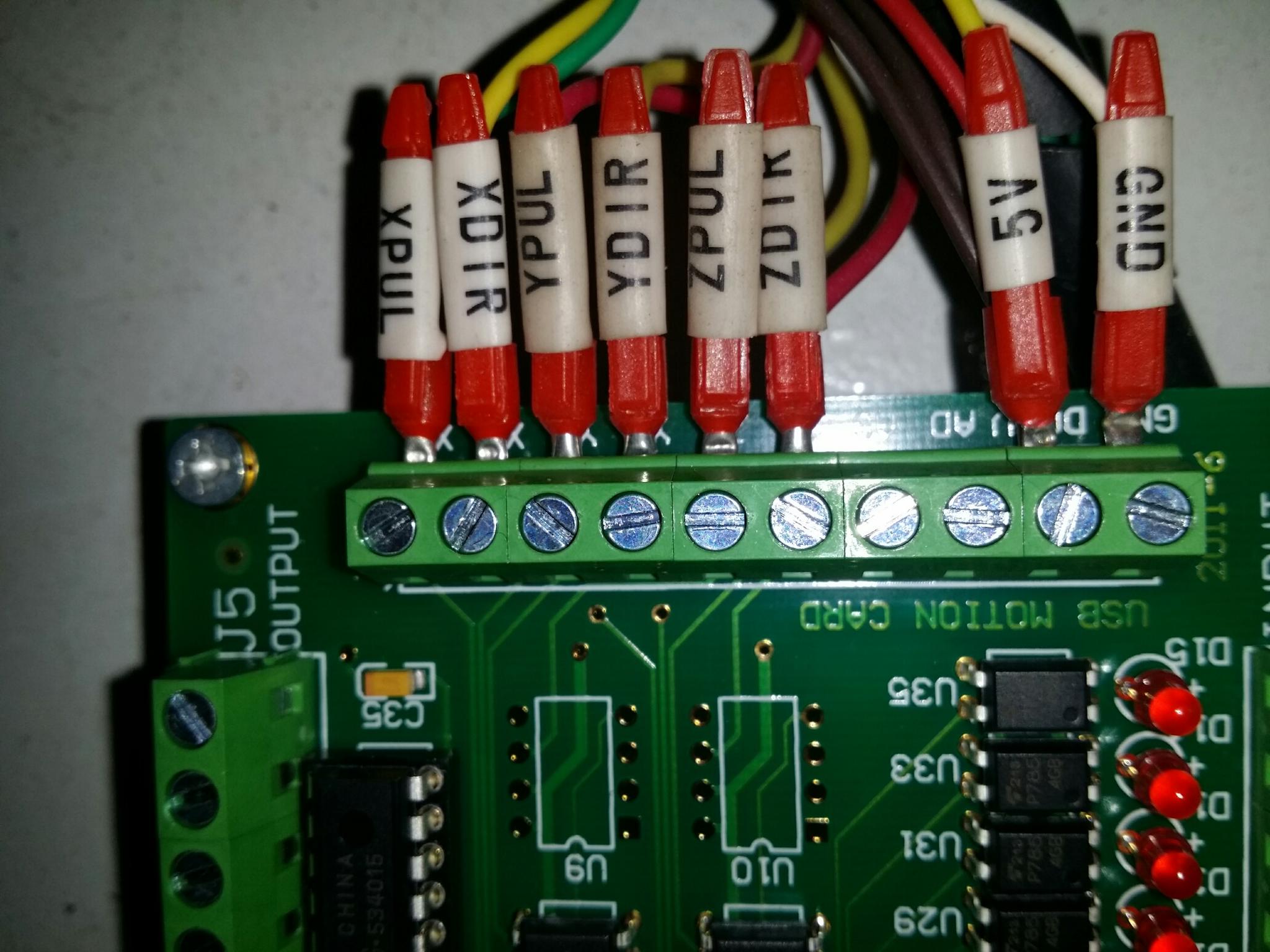

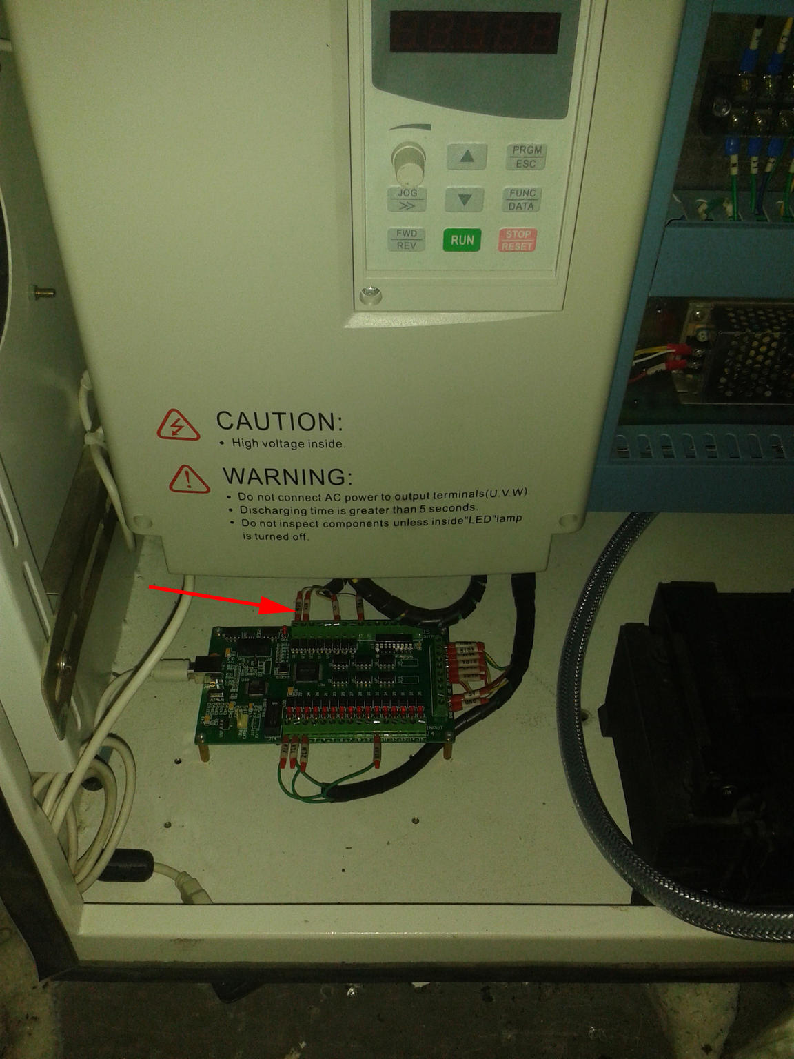

    Also when you say measure the speed control voltage do you mean it on the wires My red arrow is pointing to in the attached image?

    The spindle is dual voltage so can be run 220v or 380V. This is determined by how you connect the wire terminals on the spindle NOT the VFD.
    So if your Spindle was lasted used on 380v Three phase supply then it will be wired in Star config. If used on 220V single or three phase supply it will wired Delta.
    If your Supply is 220V Single phase then you need spindle config to be Delta.
    Regards the wires then I cannot tell you from that picture. On the VFD they will be marked so thing like ACM & V1 or Gnd & V1 or Gnd & A1 depending on type of speed controller.
    If your not sure what doing then suggest you don't go poking around because some speed controllers can be at Mains potential and very dangerous.
    Sorry I'm too far away to help.
    If you send better pics of spindle inside the cover I can probably tell you if Star or Delta. Like wise if send better pics of VFD or The board I can tell you which wires to measure from but if your not confident with electrickery then still suggest you seek advise or help from someone who is.

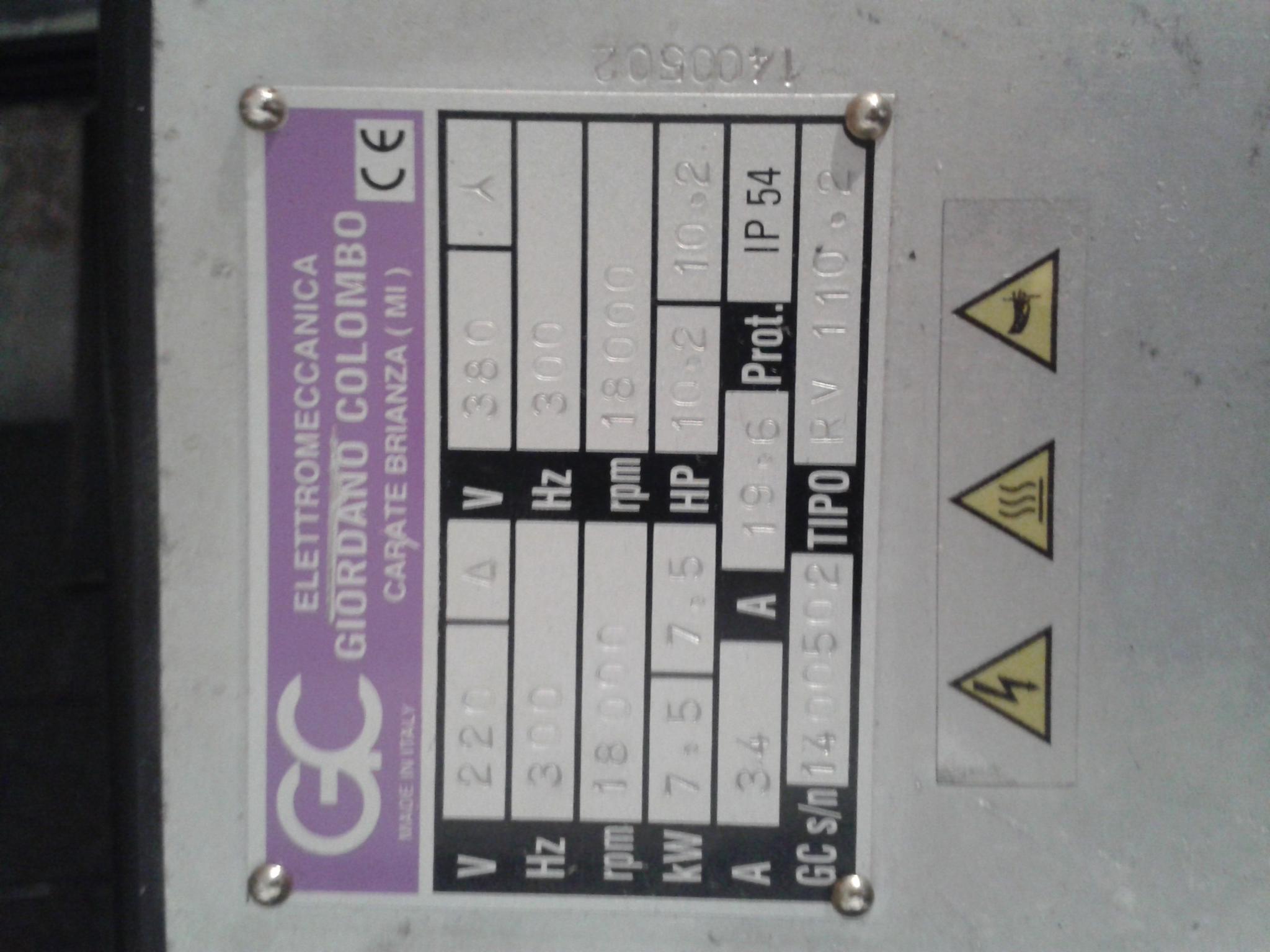

    Ok well first need to know if your using Single phase 220V supply.?
    If so then I'm quite confident that your problem is the new replacement spindle is designed ONLY for 380v.
    The VFD while converts Single phase to Three phase it does not convert 220v to 380v.
    The columbo Spindle was dual voltage, hence Delta or Star wiring options but the New replacement spindle, looking at the pic you posted doesn't and only works with 380v.
    Confirm this and if using 380V then I'll continue and tell you which wires to check.

    IME if Spindles or motors can be wired both 220/380v the plate will state it. ie like the Coloumbo does. In this case can only go off what the plate says.
