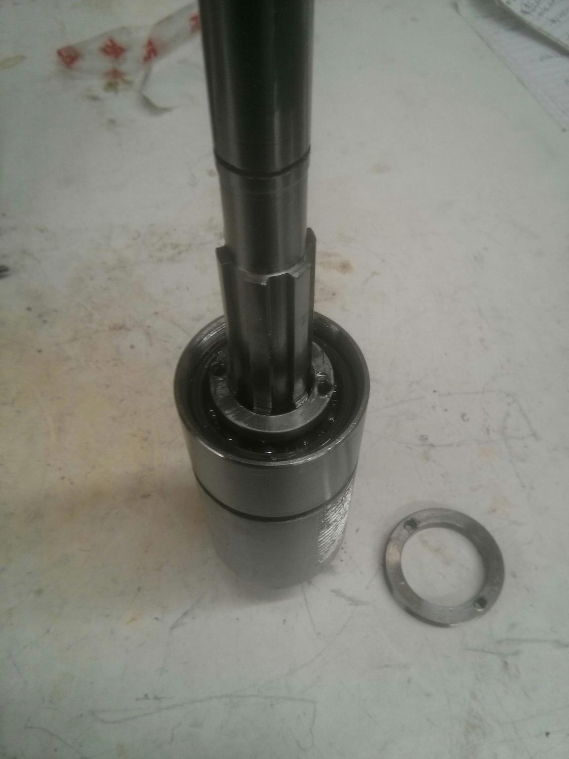

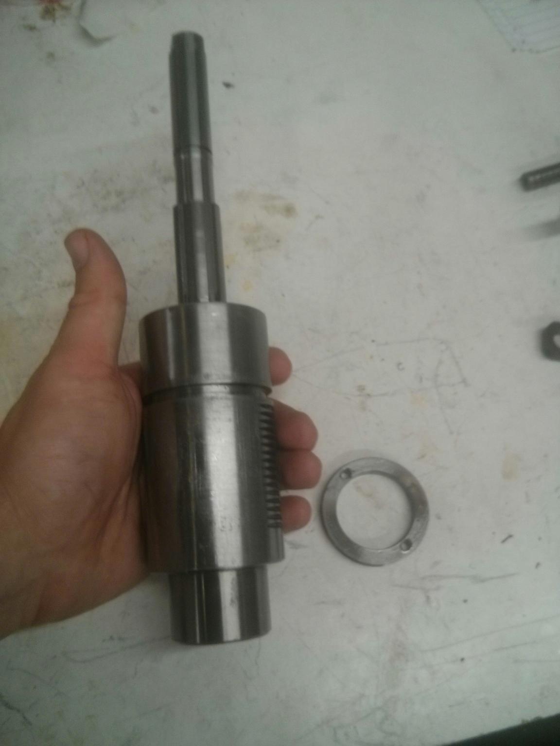

    I have a 1980s vintage benchtop CNC milling machine (Conect Contour Major) that I picked up very cheaply. The axes are in good condition but the spindle is shot. There is noticeable play between the spindle nose and the quill housing which results in ~0.3mm of play at the end of a typical length tool.
    I'd like advice on what to do with the spindle.
    This is a benchmill similar in size to a Grizzly G0704 or a Sieg X3. At ~200kg it's not tiny, but nothing like a full size mill.
    I want the machine to be capable of accurately machining fairly small parts (<100mm in any dimension) in plastics, aluminium and occasionally unhardened steel. I have no current need to machine stainless or any hardened steels. I don't need it to be fast. I don't need it to last forever and I don't mind if I don't get optimum cutter life. I generally do 1-off modifications to relatively expensive prototypes where the value of the work makes fast machining or replacement cutters a non-issue. I'm rarely using the machine for more than and hour or two a week - so please take that into account when answering. This is not a production machine. I often want to use small diameter tools (<1mm). In an ideal world I would like to be able to use a 10mm diameter endmill and a 30mm facemill but having a spindle suitable for the smaller tools is more important to me than the larger end of the range.
    I don't need ATC.
    I could repair the existing spindle. The motor is in good condition but the spindle itself would need new bearings and quite extensive rework. This would probably be the cheapest option but I'm not keen for a few reasons. 1) The spindle taper is the coventry easychange system, which is uncommon and expensive. 2) The speed is limited to about 3000rpm and I want to be able to use small cutters in aluminium (although I would be happy to use a secondary spindle for this if necessary). 3) I'm not particularly confident that I could dissassemble and reassemble the spindle with new bearings to achieve a low runout.

    Hi Nick,
    Thanks for replying. Have you got the same machine? I suspect that we must have slightly different setups. If I did as you do with tool->ER collet chuck with straight shank->easychange holder-> easychange chuck-> spindle the tool would be so far out that I wouldn't have much z travel left, not to mention losing a load of stiffness.
    I like the idea of reusing the spindle but I'm really not sure that either it or I am up to it. In addition to the slop in the bearings there is also a load of runout (~0.1mm). I suspect that it was badly crashed at some point and then 'repaired'. The holes for the face pin spanner look like they've been badly abused. I have managed to get it apart but it was a complete pain so I'll need to machine a new one. I don't have any certainty that the spindle itself isn't damaged as well as the bearings.
    I don't have an internal bearing pullers or a press to reassemble the spindle with new ones. I also don't have a huge amount of time to invest in the project and need the machine working fairly soon so I am looking for a more 'off the shelf' solution.

    Are the original bearings noisy?
    If they're not noisy, I'd try adjusting them up, and then test it again. Even if you just tighten the one ring to remove play, it'll give you a far better idea of what condition the spindle is in.
    As for potential replacements, it'll depend on the space available. Do you have any photos of the existing head?
