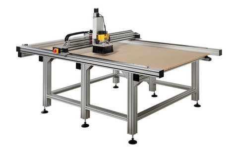

    hi everyone ,,,im interested in building a 3 axis router for the machining of sheet material " 8 foot * 4 foot " capacity,, i have a workshop for staircase and joinery manufacturing , and would like to branch off into something lighter...i would like to build something for machining of mdf and ply,,,also hardwood...im new to all this so a lot of reading will be needed i have seen a machine online that i liked the style of and maybe be similar to what i want i have included a picture ,,advice on products and supplires would be much appreciated,,,,

  2. Best thing to do is start reading build logs on here... And start drawing. I wouldn't buy a thing until you have a decent design. What cad software will you be using? I would get a 3d model up and then you will get some feedback.

    The machine in your picture has a very low gantry. If you could make yours even lower that would improve it by leaps and bounds.
    Do not let pictures of machines with huge Z axis clearance persuade your to make it any higher.
    Your machine is for sheet so design it for sheet. No silly overhangs, keep it tight

    Hopefully I'll get a drawing done shortly as I've been busy with work lately,,,been looking at some products....would 80*80 extrusion be sturdy enough for the frame ,,,also 20mm linear rails and hiwin guide blocks for the x,y axis.....also rack and pinion on the x,y axis,,,driven by nema 34 steppers,,,the extrusion I viewed on k,j,n. aluminum profiles...
    Yes.
    Yes and Yes.
    34's would be ott and a world of expenses, plus more. The "go to" nema 23's in the 3Nm flavour would do you proud.
