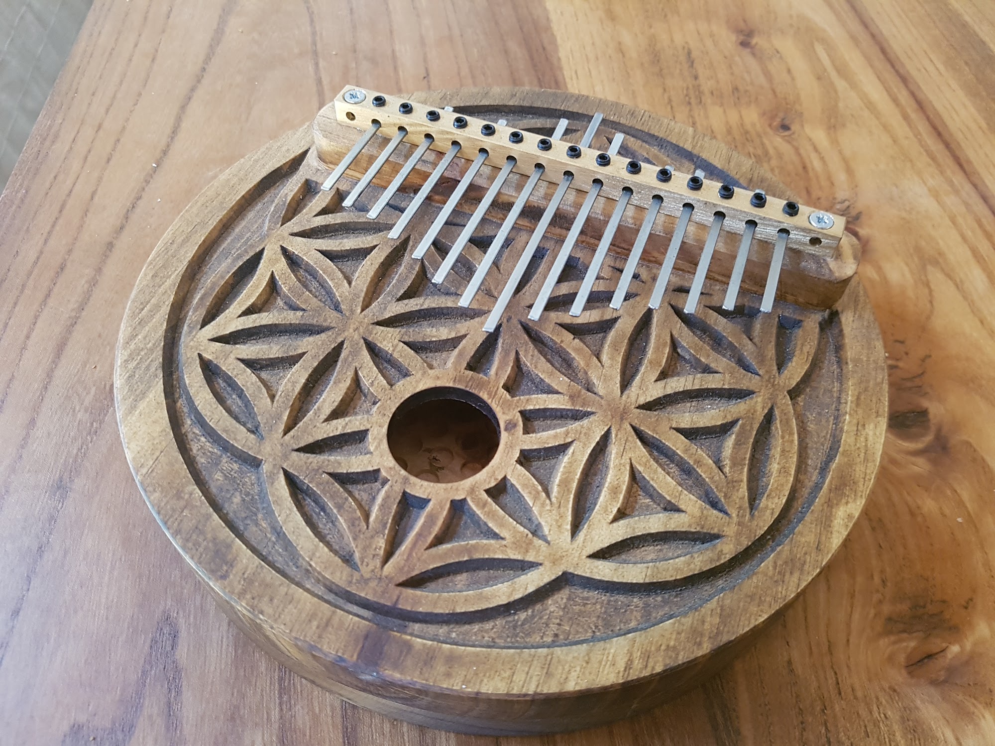

    have to drill a lot of holes in brass, on the CNC i mean. 3mm as i thread them later to M4. Something similar to grounding bars , where each piece has 15 M4+15 3mm pass trough holes.
    Till now i was drilling them using 3mm mill and 16000rpm feed rate like 15ipm and some pech tool path for the sticky chips to go out, which is leftover from the time when i did not use brass bar but very gummy aluminum bars. But now i have 500x30=15000 holes to make so have to speed up quite a bit.
    Any ideas? if i remove the peck drilling path things will be speeded, but is it needed for brass ? 8mm square brass bar. Normally i use 2 flute spiral 30 degree fishtail 3mm bit. Problem is i am busy with other work so no time for experiments.

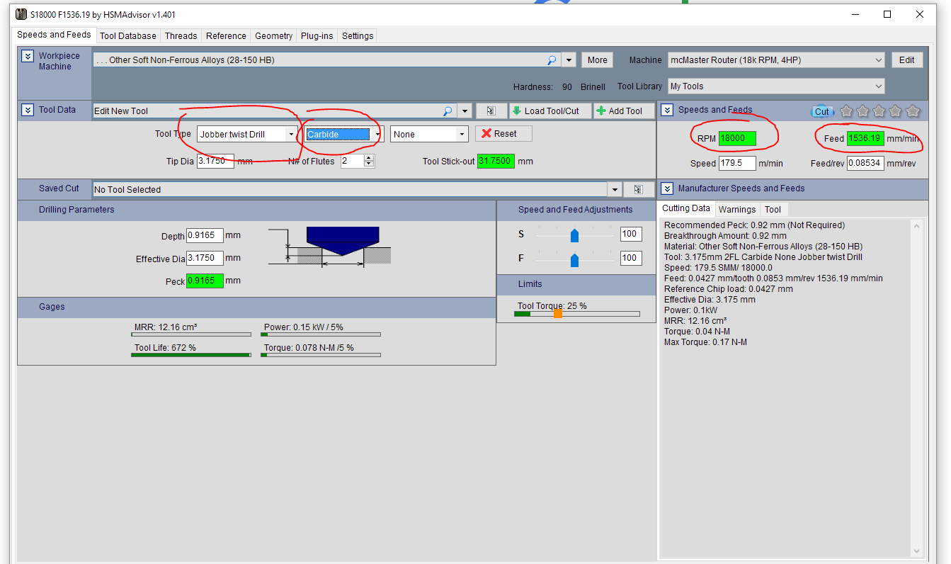

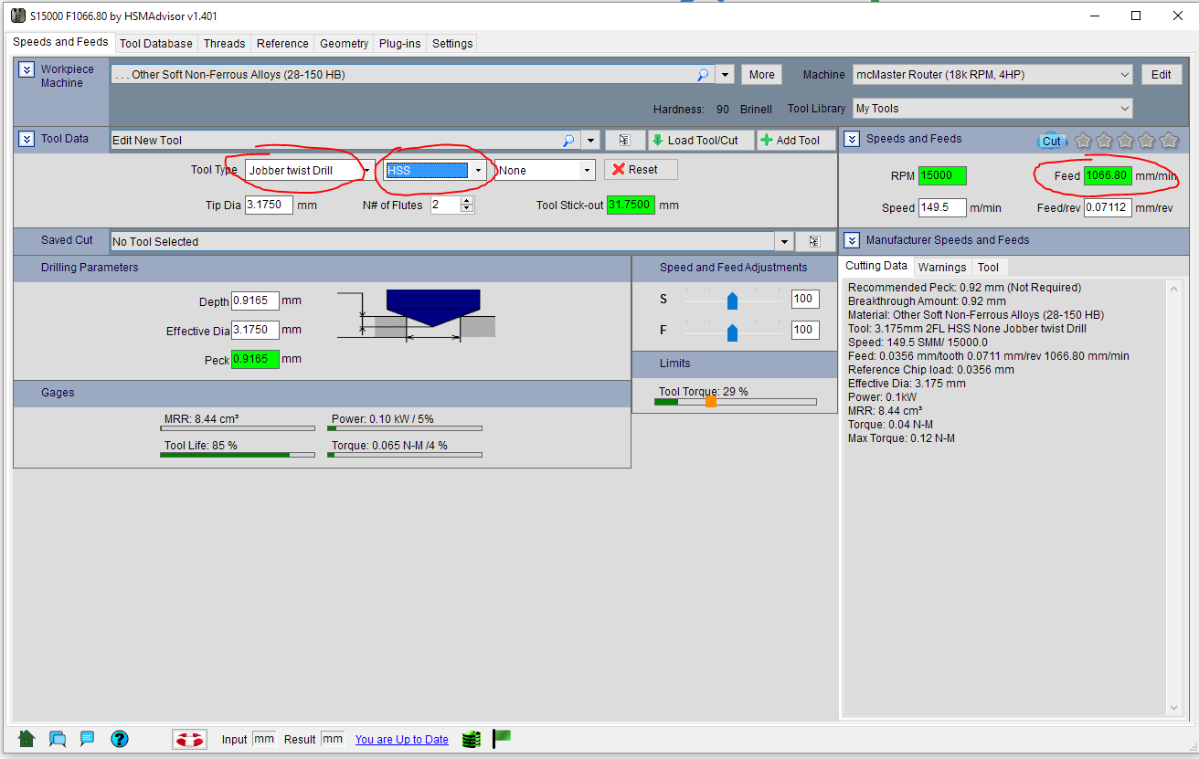

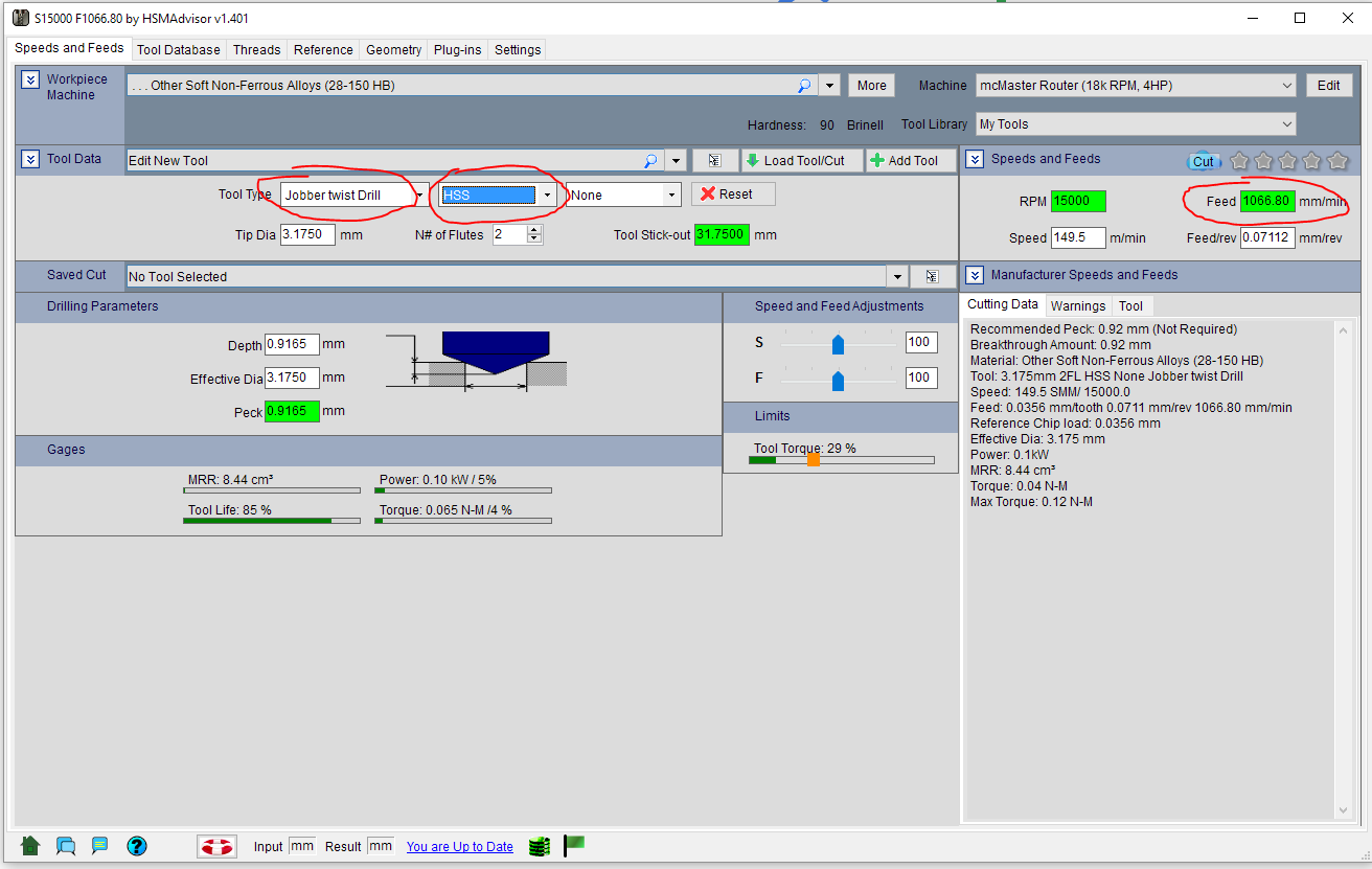

    I had a talk with the HSMadvisor maker, so it seems i had that functionality but did not know how to find it.
    So according to the calculator it seems drill / HSS/ or mill/carbide/ is almost the same feed rate. But if drill is cobalt or carbide then 1.5x faster. 1000mm/min and 1500mm /min respectively.
    I use the general option " Other non ferrous alloys" in stead of "low lead brass " or similar as the latest give me too slow feed , slower than aluminum. So it seems my brass is different, as i know for a fact that it machines and drills much faster than aluminum.
    Will experiment tomorrow to see how fast it could go in real life and report back.
Name:	drill cobalt or carbide brass.PNG
ID:	18907Click image for larger version.
Name:	drill hss brass.PNG
ID:	18908Click image for larger version.
Name:	mill carbide brass.PNG
