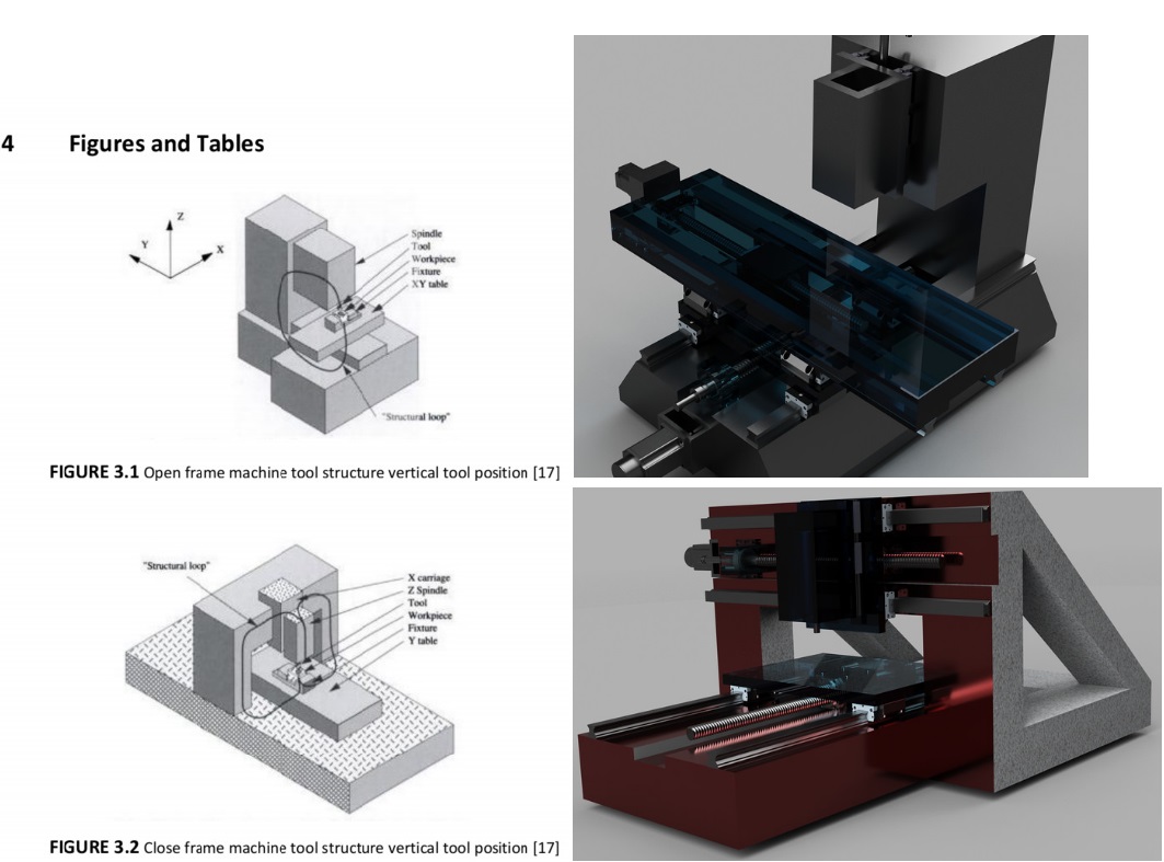

    I'm going to make CNC machine prototype - I need it to be closed frame because that will be easier in the control design because I'm going to use servo motors instead of stepper motors
    So I need closed frame design that i can build and apply the control I will design on it
    Any help is welcome, I mainly need small mechanical closed frame design
    Thanks everybody

    What do you mean by closed frame ? Is it like a commercial machining centre with an enclosure
    Also steppers are very capable - do you need servos?

    I need servo cause i want to test control theories - it is graduation project
    I need design ready and tried cause my major is not mechanical engineering and i need this task (mechanical body) to be easy
    And finally closed frame word is not my own description
    I got it from book >> this is the chapter described that part https://drive.google.com/open?id=0B1El2XHLhbSCU1hYX1hTbUZfeVE
    Any clarification will be helpful
    I really thank you for your reply
    OK. So a 'closed frame' is a 'fixed gantry' and an 'open frame' is like a conventional milling machine.

    Sorry I'm confused here, But i think the gantry is moving in the picture provided in the link! isn't it?
  8. #6
    The gantry is the large fixed frame connected to the bed, in the shape of an arch. It does not move.
    The X axis carriage moves the Z spindle plate left to right on this fixed gantry.
    The Z axis spindle plate moves the spindle up and down
    On the bed the Y axis plate moves the workpiece left to right.
    Hope that helps.

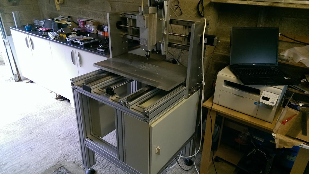

    The way i see it your best bet is to make a simple fixed gantry machine from aluminium extrusions like the one at the picture bellow

    My advice is thought to use at least round supported rails /SBR, TBR..20 size/ , even better, Hiwin 20 / much more expensive and better/ and 0.8kw water cooled spindle. Use also 3nm nema 23 motors and Am 822 drives, PSU for motors non regulated at 70VDC
    I mean when you will be spending money make a real machine that will later have some value. Otherwise go ultra cheap all in one board with drives, 24v motors, PC ATC power supply , nema 17 motors. A micro CNC, similar to 3d printers. The middle way between what i am suggesting, is to spend your money for nothing.

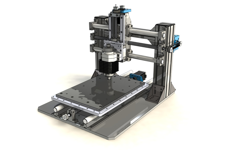

    Thank you very much .. can I find CAD file for design like you posted?
  14. #10
    Quote Originally Posted by ammaratef45 View Post
    GRABCAD is an excellent place to search for something.
