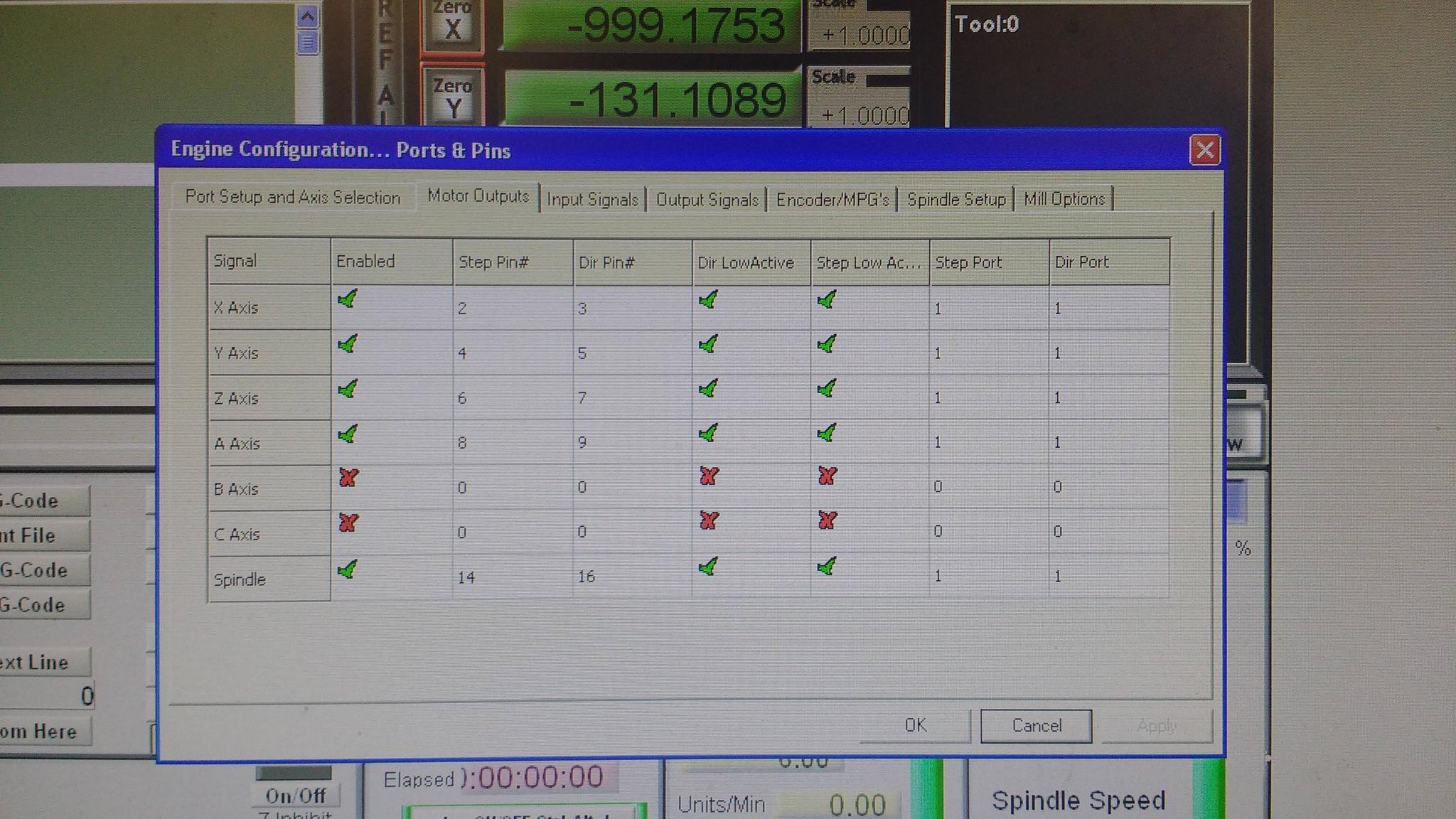

    Hi all!
    Struggling to get my KX1 running. A profile did not come with my machine so I have loaded a KX3 profile that I found online into mach 3. In the diagnostics tab of mach3 everything seems to be correct, when I press down limit switches they correspond correctly and estop works. However the motors do not run when I jog the device. Any thoughts?
    The image shows how I have my ports and pins configured in mach3.Click image for larger version.

    Where did you buy it?
    Arceurotrade state that Mach3 demo and custom configuration files are included with the machine.
    - Nick
    Bought it from eBay, used. Did not come with a profile r any software :(
    Have you sorted this.I have a x1.my port and pin settings are not the same as yours.michael
    Sorry for not responding, it's been a while but I didn't have time to work on this. The problem still isn't resolved. Could you show me the settings you are using? Or the .xml file for the profile you use? Thanks
