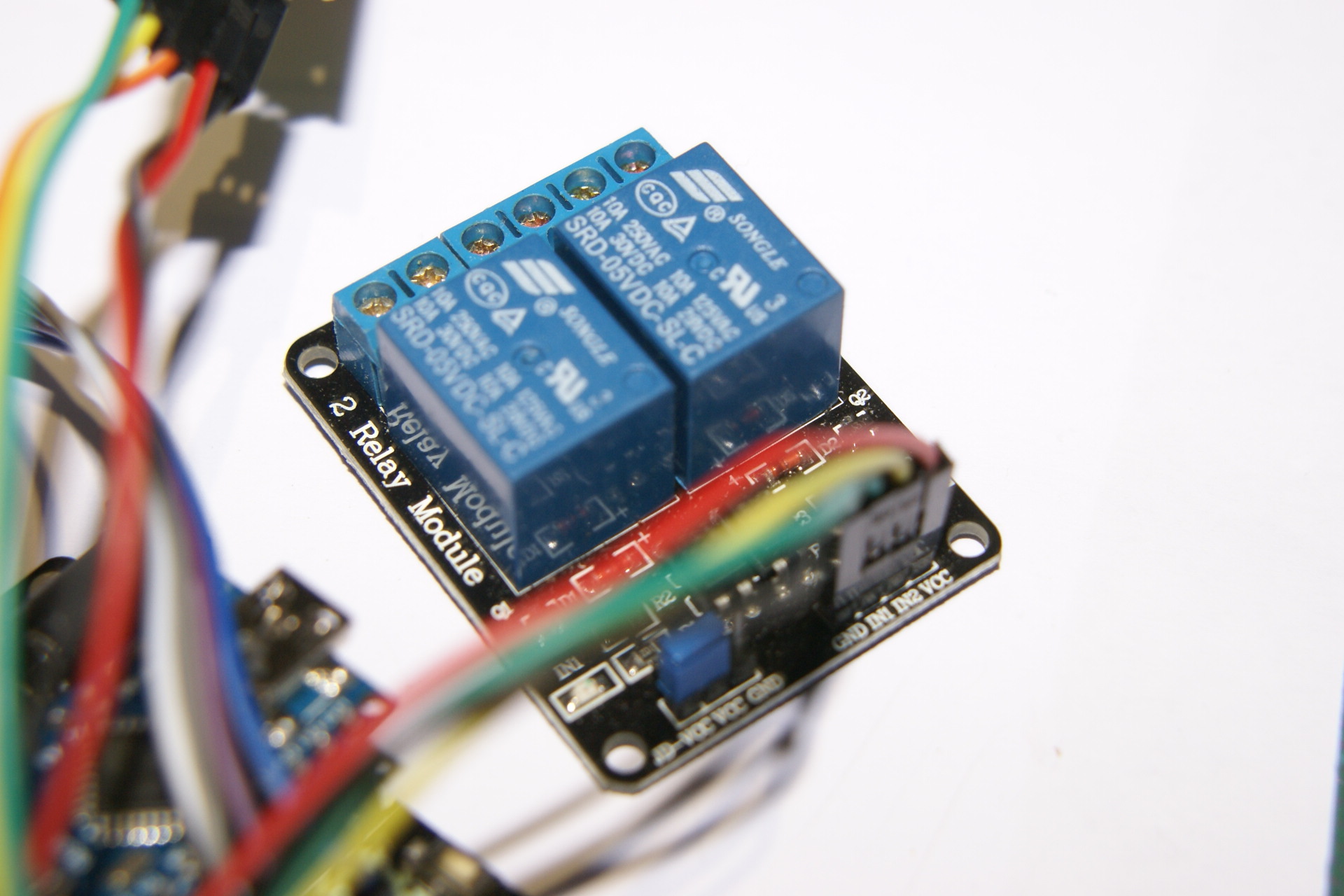

    It's basically the same one in the link. Yay, at least now I can see some wiring options.
    The easy way is to use one of these relay modules triggered by a spare output A or B (Pulse or Direction). You can get the relays in singles or multiples at least up to 8 on one board.
    Oh, thanks. Didnt know this was possible. Do you have a link or similar to one of these please?
  4. #63
    They are all over eBay, just search for 'relay module 5v' and limit to UK if you want it fast.
    Here's one example of a supplier - http://www.ebay.co.uk/itm/1-2-4-8-16...f5lyx157fF9xGQ

    That should work well. Does it take much messing about with Mach3 to get this to work?

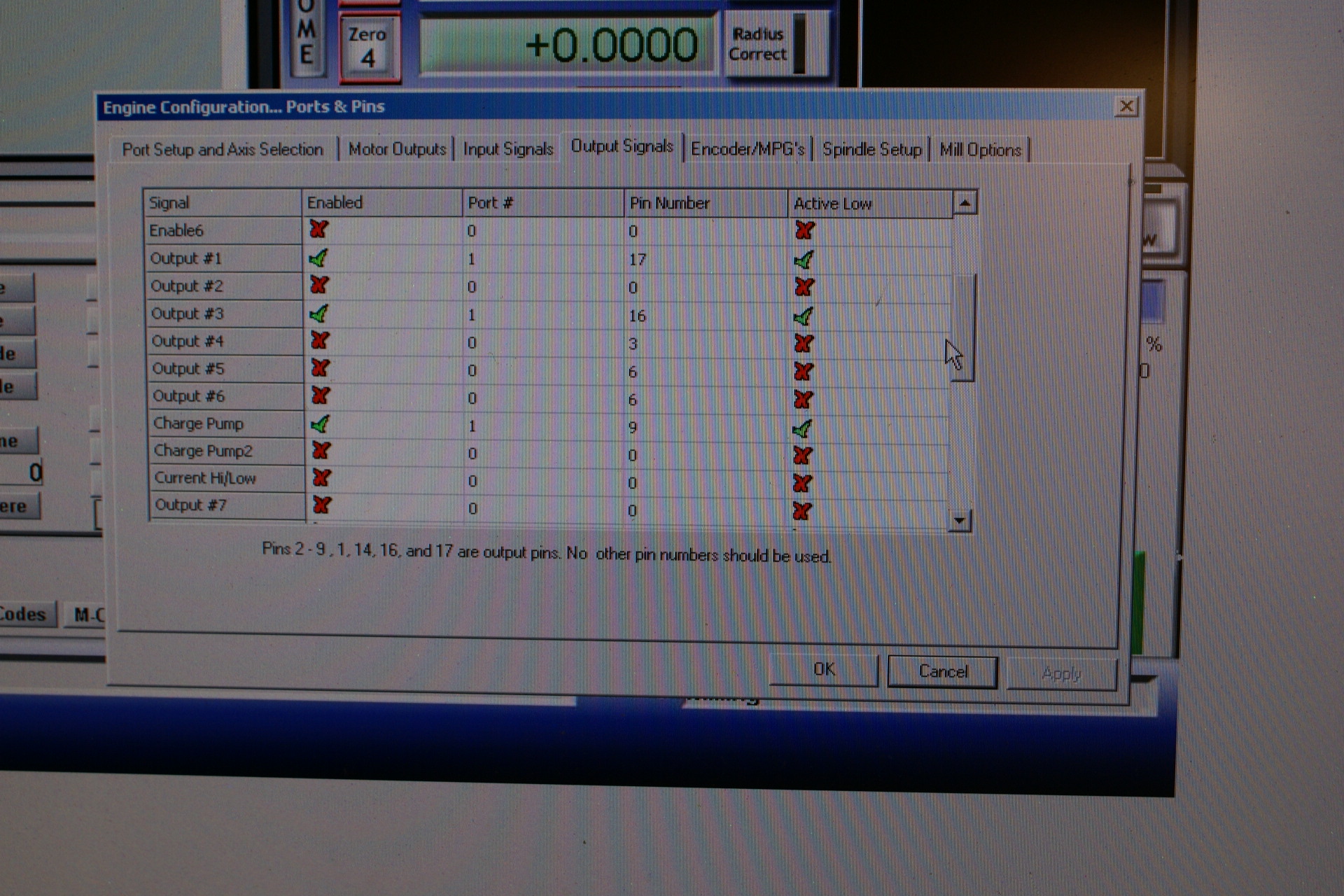

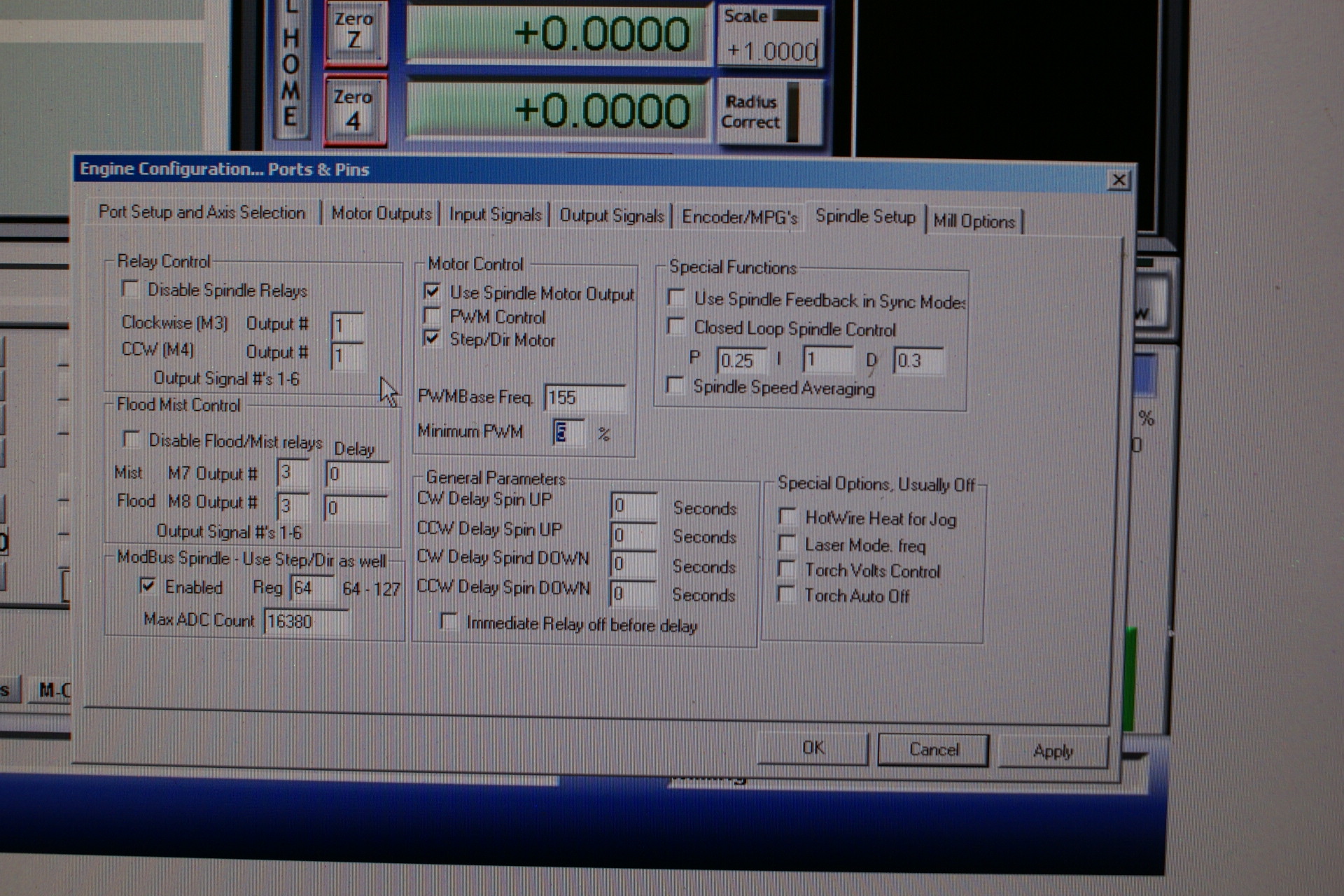

ID:	19677 I use P16 for coolant (just an air blower really) and P17 to turn the spindle on (Kress, not a three phase one with speed control)
    You may like to play with active high / low and whether you connect to NO or NC on the relay as there can be some activity on the pins before Mach3 takes control.
