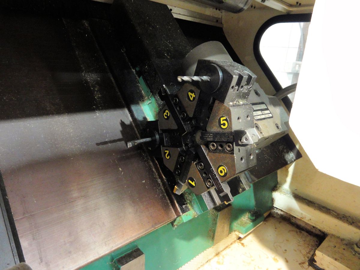

    Hi, does your lathe have a Baruffaldi TOE80 turret like on a denford cyclone?
    http://www.1stmachinery.com/Resource.../1008_6790.JPG
    Is so I have a few spare blocks and boring bar sleeves that i made up and also some spare ER25 and ER16 Holders that I bought and modified to suit the 25mm tool holder if you are interested

    Nope, similar but not as 'angular' as that. Ill take some pics.
