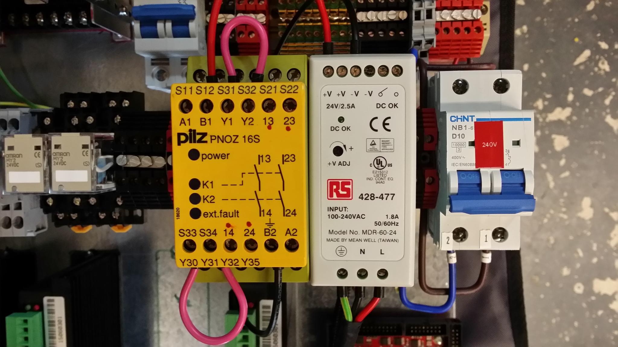

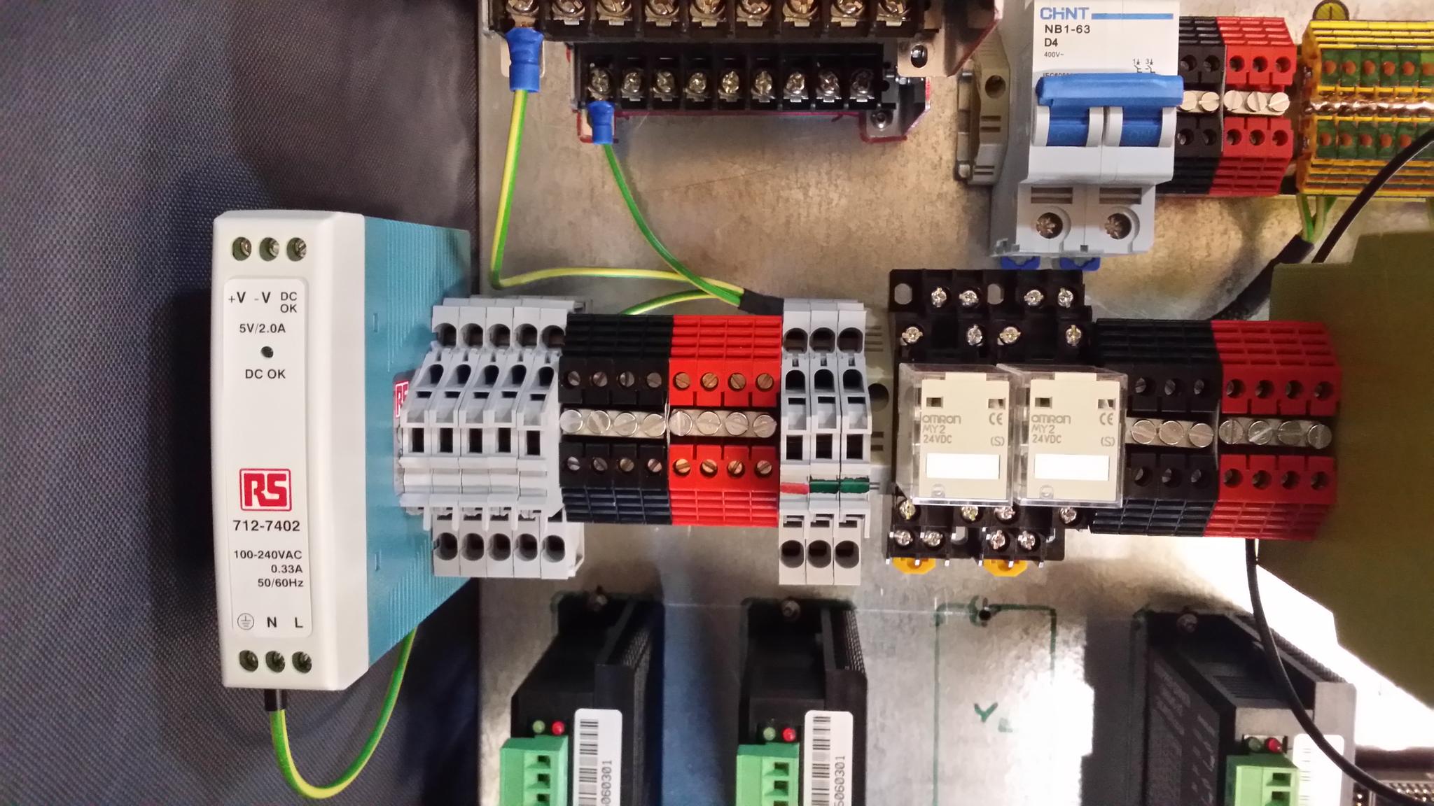

    Progress photos of the cabinet build for your viewing;
ID:	19145Click image for larger version.
ID:	19146Click image for larger version.
ID:	19147Click image for larger version.
Name:	Panel 04 - closeup.jpg
ID:	19148Click image for larger version.
Name:	Panel 05 - 240V.jpg
ID:	19149Click image for larger version.
Name:	Panel 06 - 24V DC & Pilz.jpg
ID:	19150Click image for larger version.
Name:	Panel 07 - 5V DC & relays.jpg
    Due to the size limitations, I have raised the main DIN rail so that I can cable between devices. You can see the braid cable sleeves with heat shrink to keep things tidy.
    More photos to follow I hope.
    Life is best lived @ G0......
