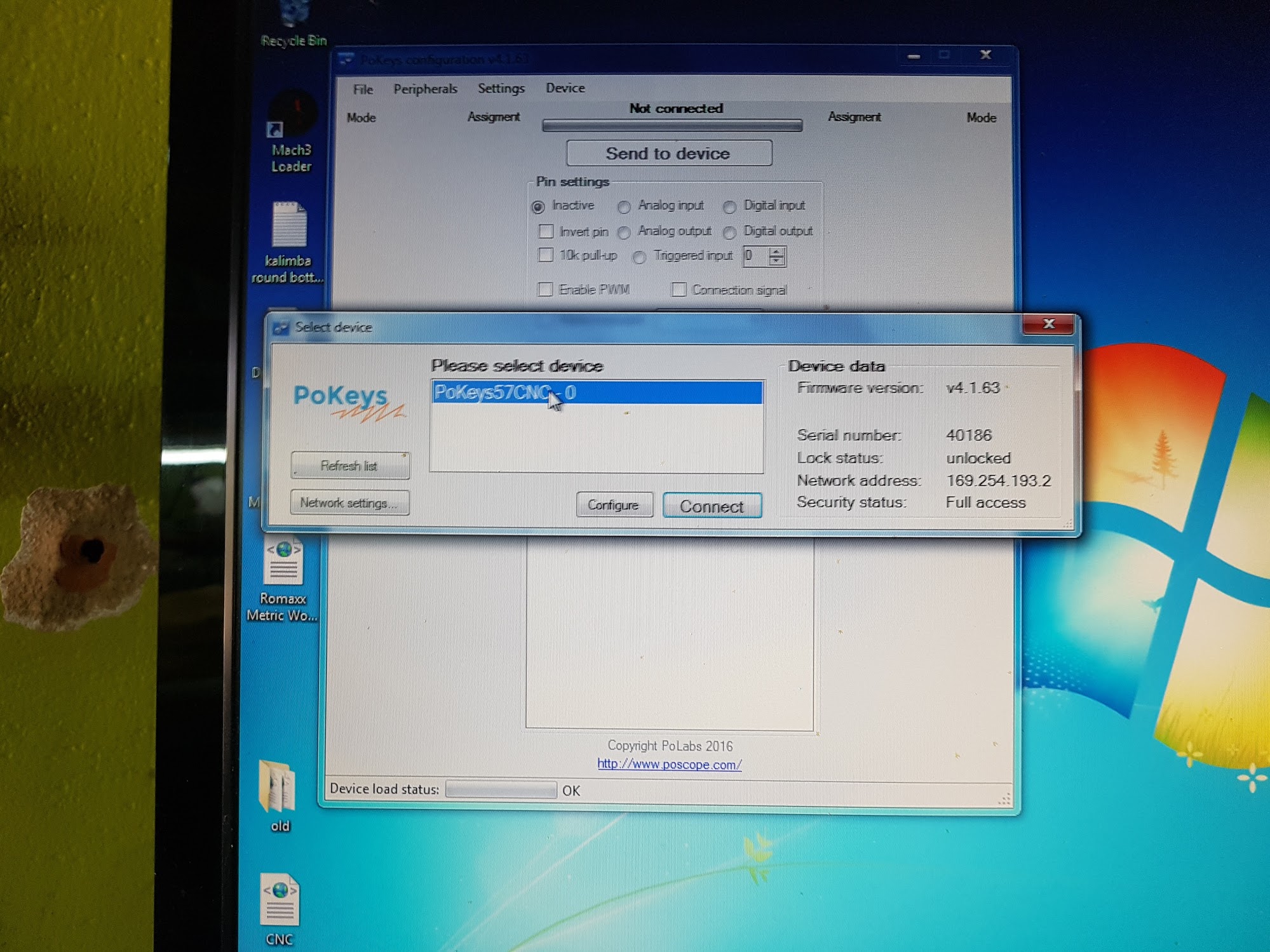

    I am extensively testing the Pokeys57CNC with the hope that price wise it will control all my future creations. As its USB, Ethernet, made in EU and good price, i had high hopes for it.
    So far i have only basically wired it to the machine. No sensors, homing and so. Till now i had a couple of minor problems with it:
    -Something unclear in the manual about the pullup resistors, tried help in the mach3 support forum, received it after at least more than a week . Still not clear what value resistor to use. Hello, i am not an electronic engineer . Ok i figured from other forums 10Kohm
    -Had some other positioning problem, at the end it turned i had not adjusted well the servos. Tried support on their web, opening ticket. Received an answer, which did not help me much . No answer on my follow up question or when i left feedback what the problem was .
    So far so good. Started drilling 500 pieces , each piece 2x15 holes. Just opened a ticket, will see what happens. Bellow is the problem described. I am not saying its not again some mistake of mine somewhere. But i checked the code line by line its correct.

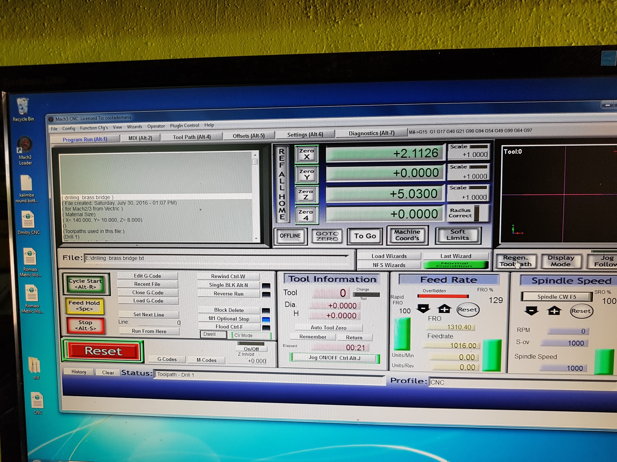

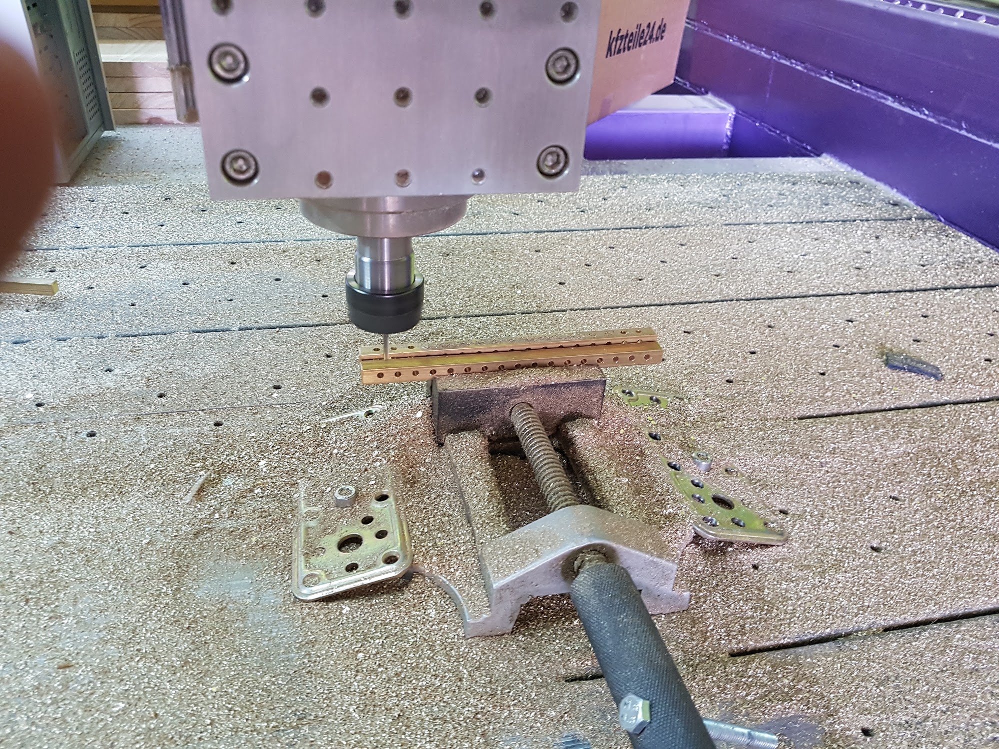

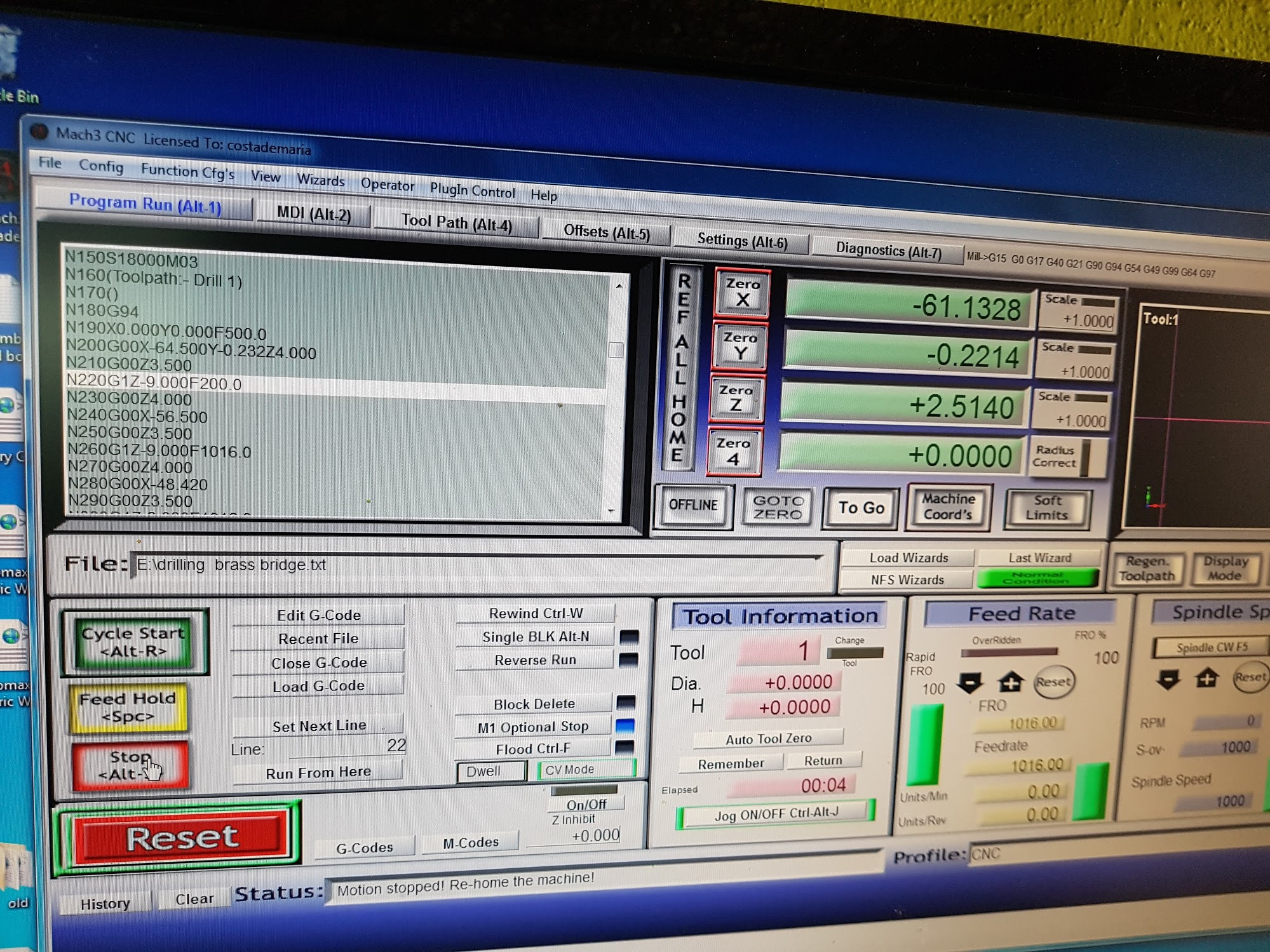

    ​Pokeys 57CNC+mach3. All fresh install, latest all before a couple of months. Nothing else on PC. Second network card disabled from windows.
    The problem is very simple. Its loosing X axis position somehow. Program is drilling a horizontal row of 15 holes. I change workpiece and then again repeat. 10 times it does it right. Every now and then instead returning to 0 it returns to ~ X-2, X-3 or X-4mm. I dont see that, push start program button and it screws the holes placement with -2, 3 or 4mm respectively. I rewind, recalculate and start again. Even if i start from X-4, when i recalculate it drills holes right. Until it fucks again the workpiece after 10-15 pieces making exactly the same mistake.
    ​Problem is all happens very fast and i have no time to react to stop process, and even if i do, i am wasting time, which i dont have.
    So it seems mach3 knows exactly where the spindle is at all times, just sometimes it does not move it till the right position X0, Y0, and from there on the error happens. So that means its not motor related, its Pokeys Mach3 thing.
    ​I dont know about Y, as i drill in a straigh line and dont have time to make experimens in the Y direction, though looking at the numbers it does not do that mistake, as Y is always Y0 or some fraction like Y0.0033
    ​On the photos below clearly could be seen what i am talking about. Instead of x-64 what the program says to mach 3, its -x62, When program finishes it is x-2 instead of X0.

    Well this tiny board seems to continue to raise higher on my SHIT list, though i am still trying to remain positive. I feel tempted to review it more in detail, but as i am still getting to know it, will take a bit more time to see if its a winner or looser.
    So for the moment that's where i am:
    -support was ok as communication, but did not resolve my issues. Clean installed my PC, read manuals, continued conversations with support, blah, blah. Problem still persisted. Every 1-2 from 10 times it will not go to X0 at end of program and mess a piece.
    So i installed Mach4 trial. I have too many money invested in Mach3 to change programs. Plus i have screens, screens for plasma THC..., so No for the moment. But it worked without problem there. Then back to Mach3. from Pokeys support i previously was urged to install the latest beta plugin that has in their words " same as mach4 communication library" . Still it gave me bigger problems messing with recognising at all the IPs and so.
    At the end yesterday i reread the communication between me and support and at the end figured the problem. Problem was their manual says " add the Pokeys IP manualy and restart" . Seems their plugin automatically finds after restart the IP. And me doing it manually messed up things. Is there somewhere abbreviation for " Update the F"""ng Manual?
