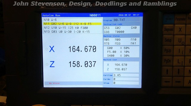

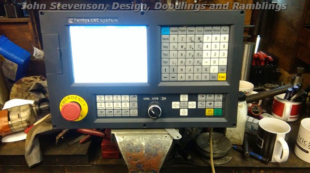

    However times move on and last week this landed on my doorstep.
    Not the best shot with reflected light.
    A two axis complete CNC system, can control 2 axis to industry standard, spindle, pendant and also a tool changer.
    Just add drivers and stepper to complete and stir.
    Also available in up to 5 axis on a sliding price scale.
    This one landed, all duties declared and paid at £387.00
    No contest, we live in interesting times

    It was bought as a 2 axis just for a lathe as it can thread properly.
    I have a lot to do with the Chinese as i was heavily involved with them to build the KX1 and KX3 turnkey milling machines.
    The website is here for the different controllers.
    http://www.newkye.com/h-pd-111.html
    We landed two into the UK last week, mine is on a bench, no machine as yet whilst we sort out parameter settings.
    Steve Blackmore has the other controller temporally fitted to an Orac lathe and he has it jogging and homing already but still has the spindle, toolchanger and encoder to sort out but it's looking good.
    There are some very simple cheaper controllers that can do 4 axis and spindle but not threading or rigid tapping, no encoder feedback.
    http://www.aliexpress.com/store/prod...260668115.html
    Again these are just a stand alone controller, no computer or break out boards needed and just require power supply, drivers and steppers.
    These sell for about £140 to £180 depending on what deal they are doing and shipping.
    I feel that these new controllers are going to be a game changer.
