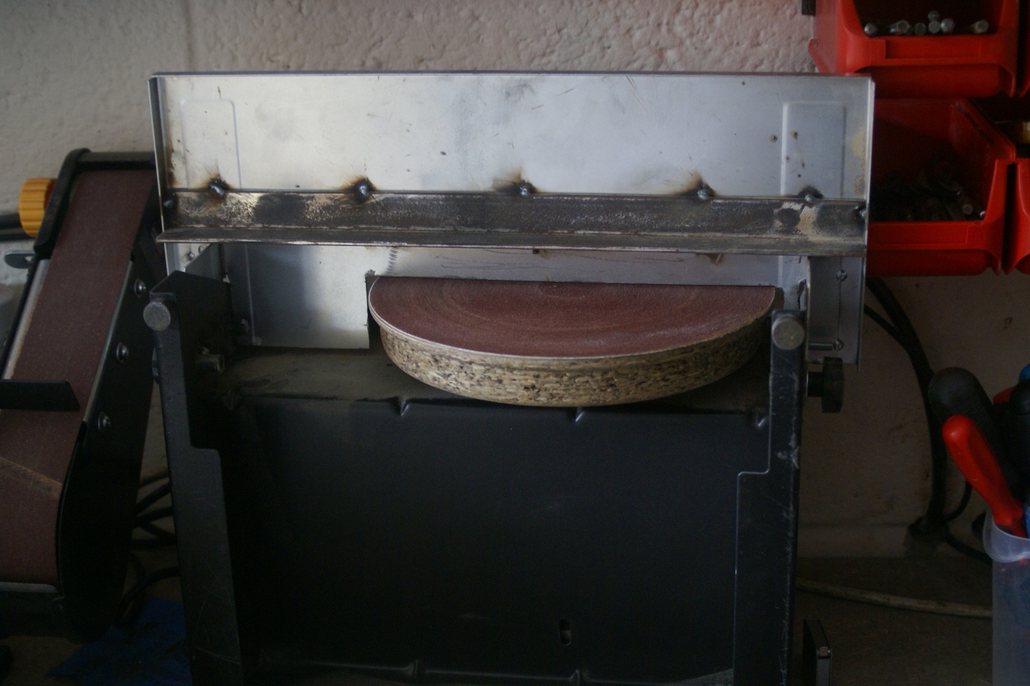

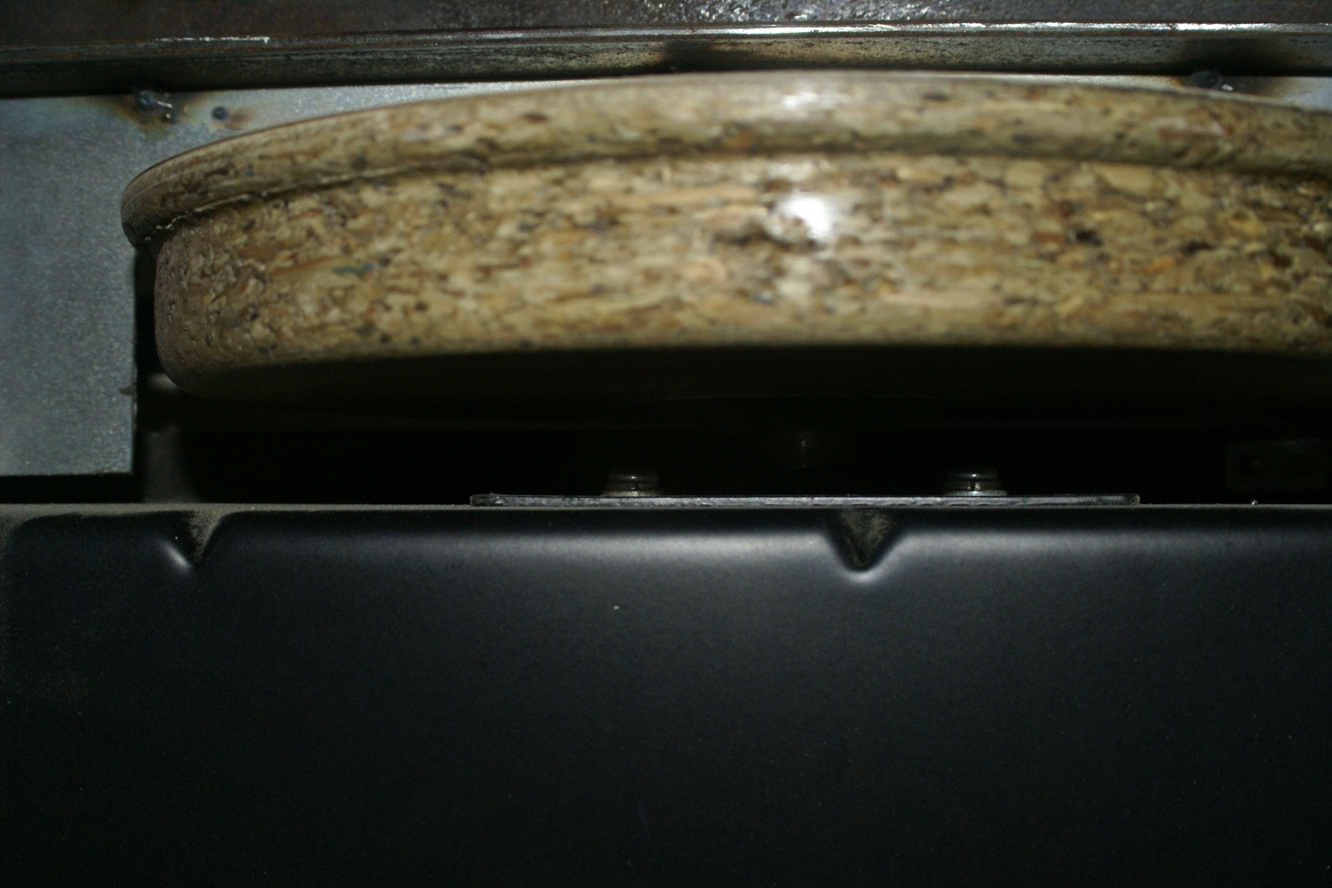

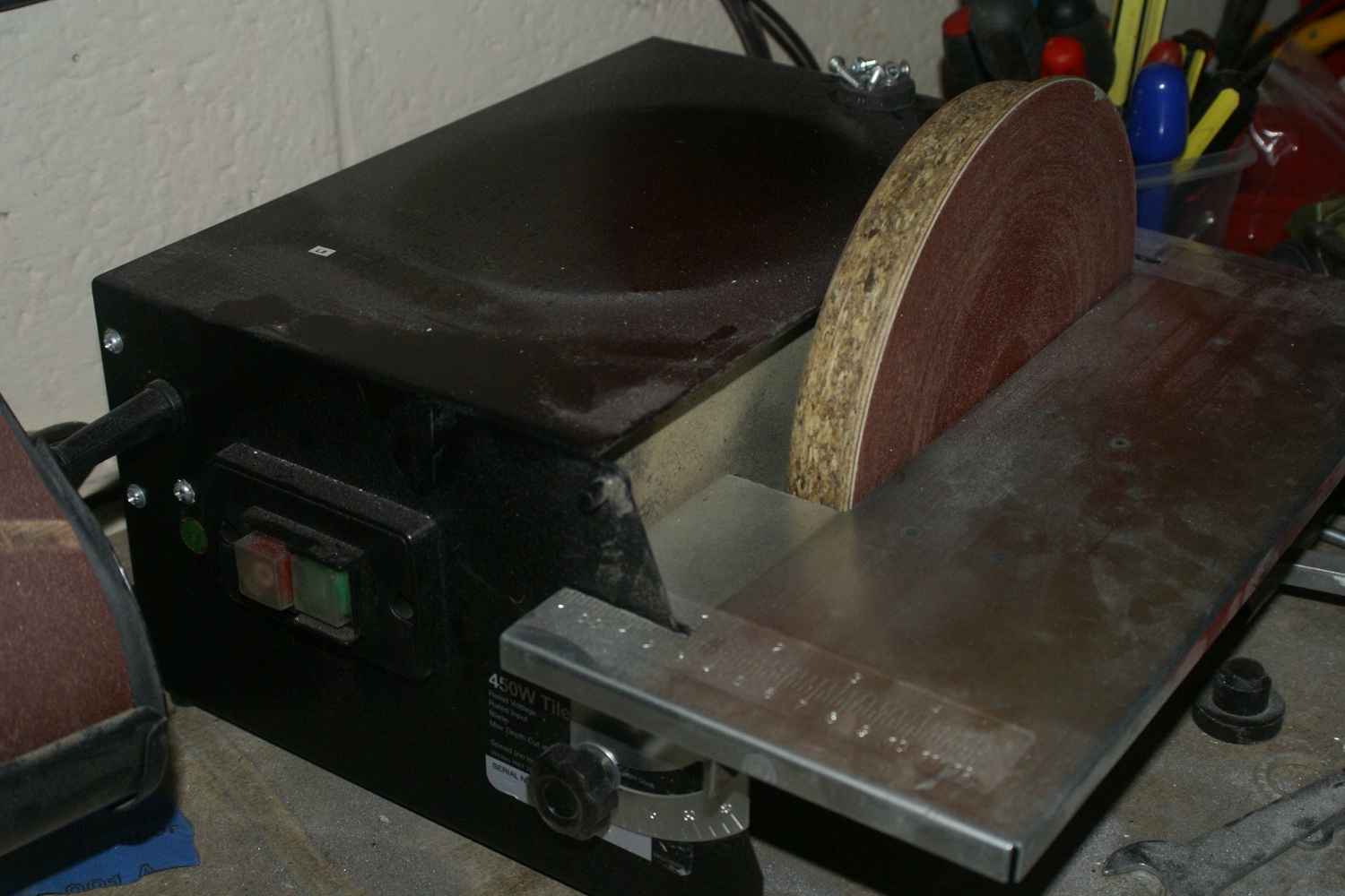

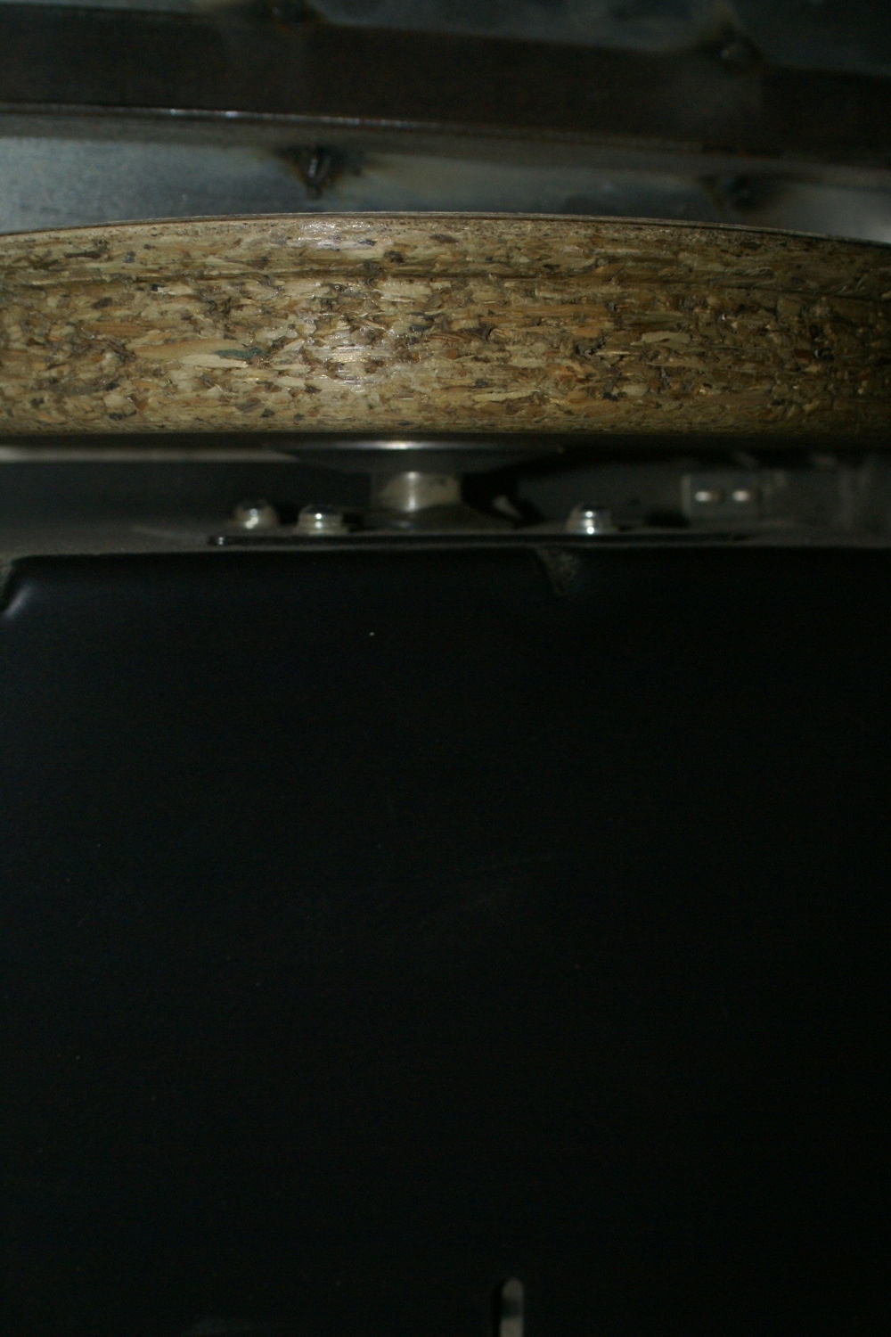

    Hank you are on to something here as i bought a tile cutter for £20 from Wickes, modified the top plate and mounted a piece of worktop as a face plate. i use it as a bench sander with 8" self adhesive backed sanding discs stuck to the Formica side. I did think about buying another just for the same purpose as you are thinking. The motor in these are just a converted grinder in the one i had.

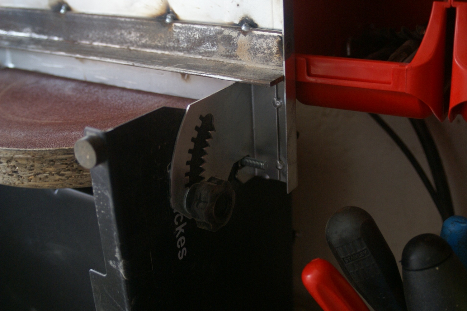

    Here you go and note that is an 8" sanding disc for size. I cut the top in two and spot welded a piece of angle iron for support, modded the angle adjustment by welding some nuts lower down to accommodate the thumb screws. Forgot to mention the motor is just an angle grinder inside, running like this is very quiet. The cheapest i saw at the time was a pro bit of kit which was £140 at the time

    I will grab some picks of mine and you make your own minds up about what you can can't do with it. At the time Wickes had mine on offer and at £20 it could remain a tile cutter if it was no good.
