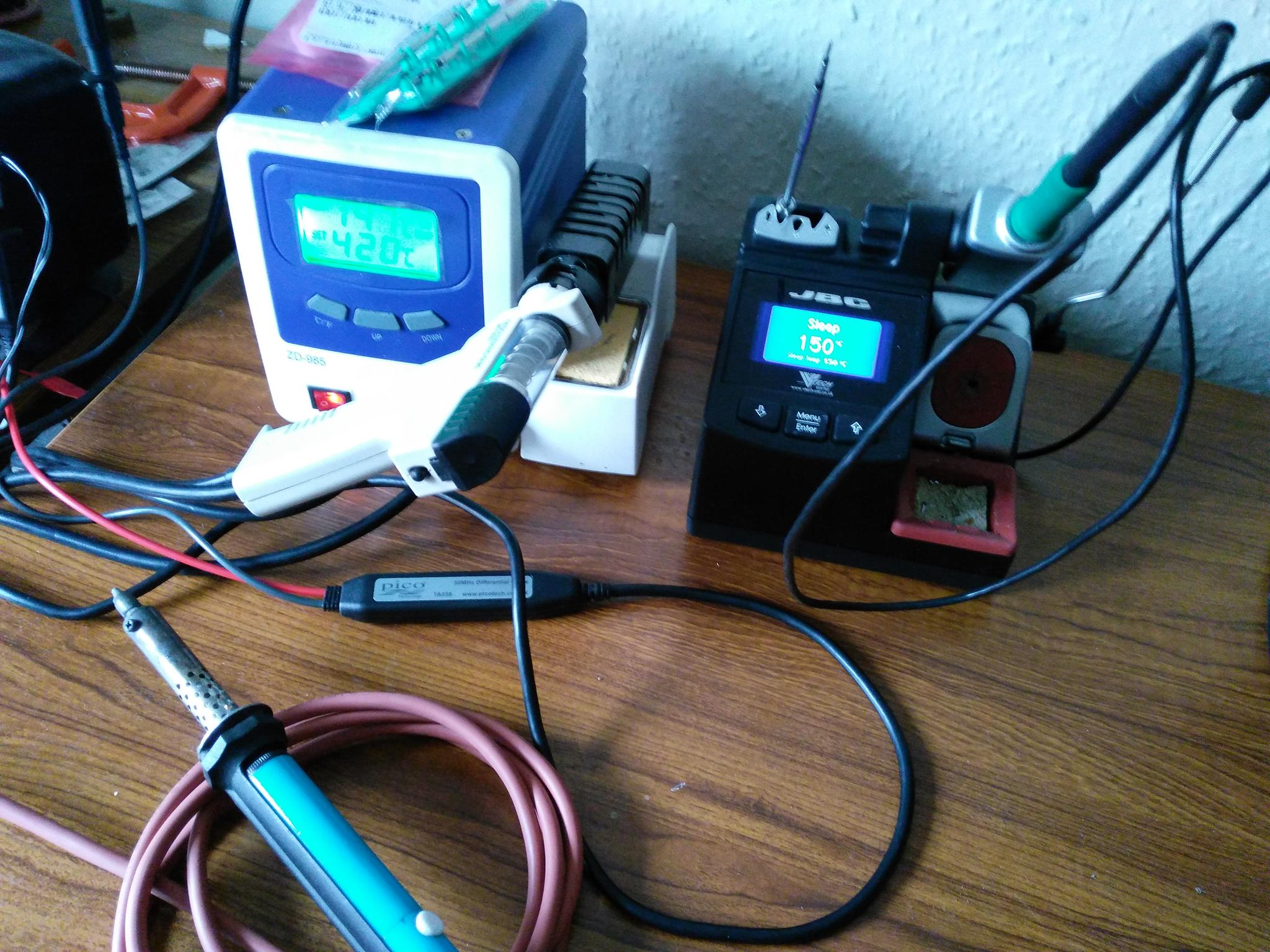

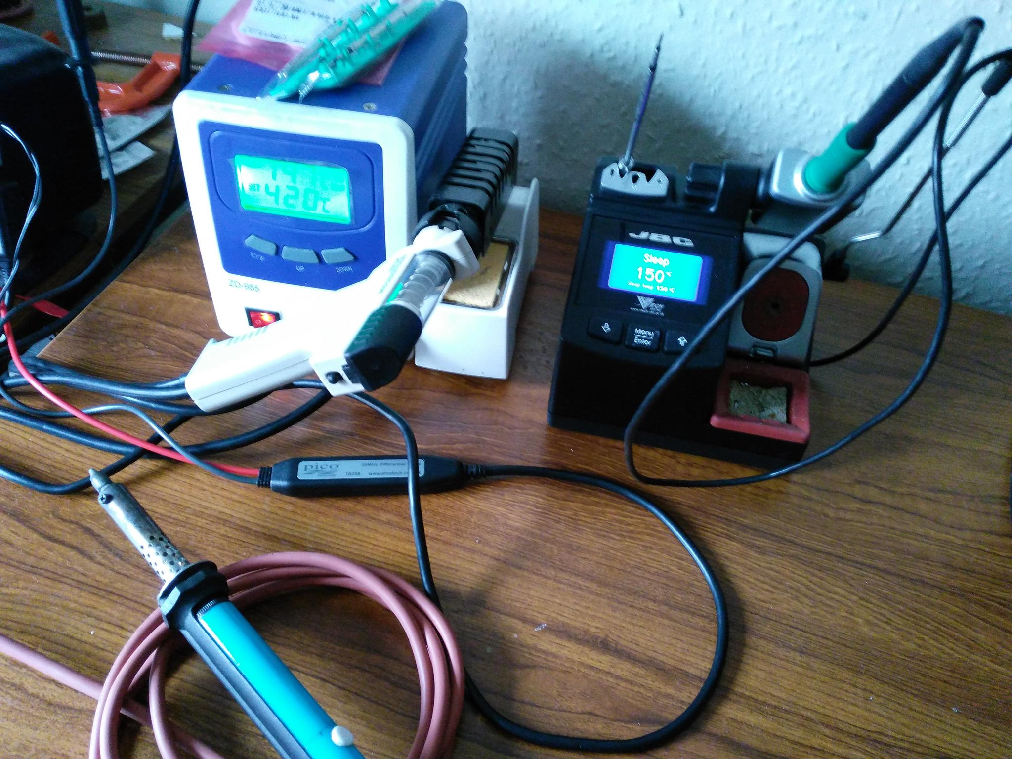

    These are my most recent choices:

    I got the JBC soldering iron after using some in the lab. I've been doing a LOT of soldering recently. They are so nice to use I couldn't resist. It heats up faster than you can pick the iron from the stand and move it to the PCB on your desk. I can't fault it at all, but even now I've had it for a few months I'm not sure if I should have got it - just so expensive, even via eBay as this one was.
    Also pictured are two desoldering options - the ZD-985 is a relatively low cost one with a vacuum pump, which is good but the guns are a bit delicate. I mainly got it because I soldered about 100 fake transistors on to something. Otherwise, for most thing's you're good with a conventional pump, but heated. You can get those for £6 here - well worth it.

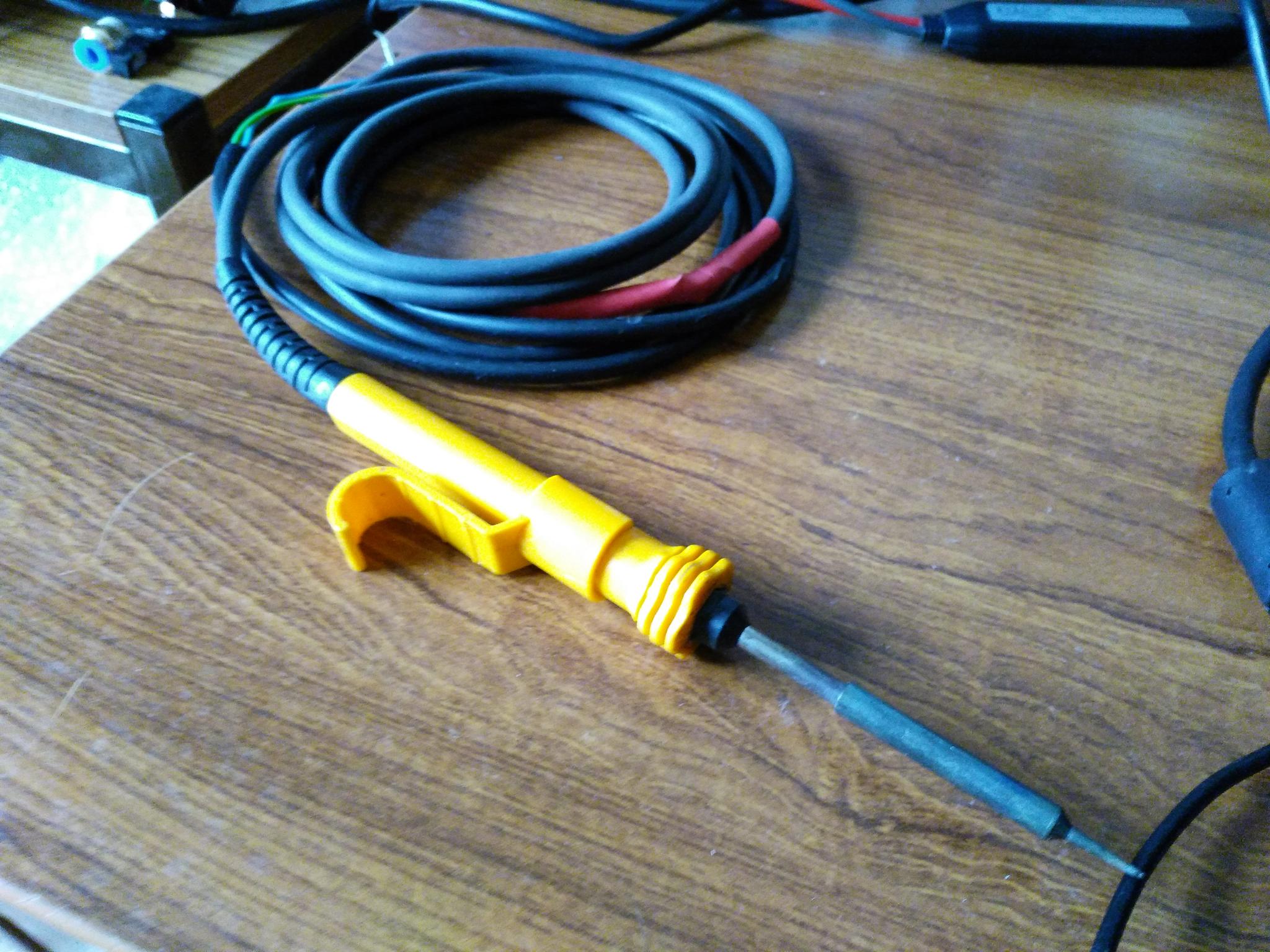

    I do have an antex iron aswell - had it practically since I was in nappies. Several new tips and a new element, but it's still the same iron ;)

    Regarding flexible cables - you can buy the cable separately:
    https://www.rapidonline.com/Antex-W0...rSearchScope=1

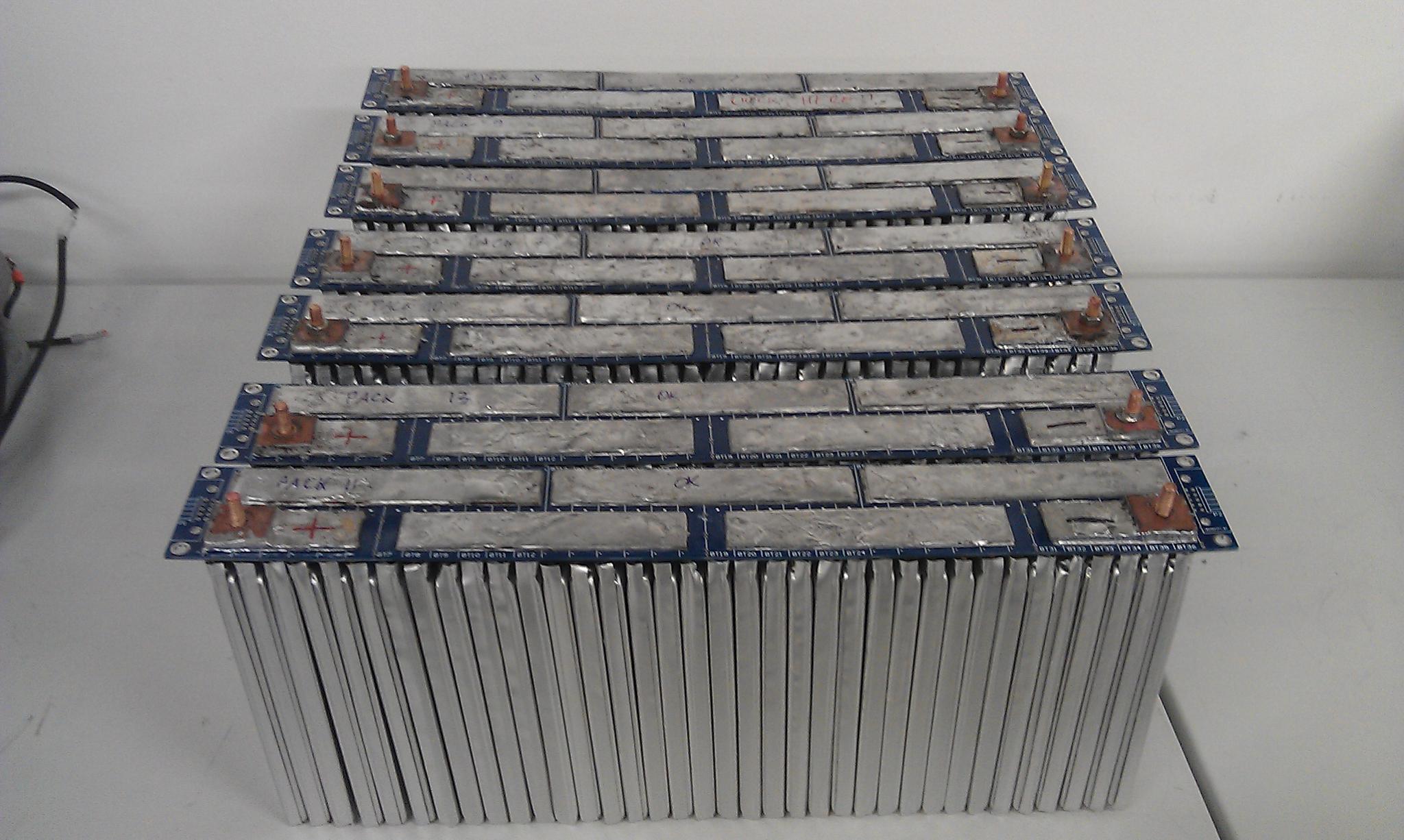

    For bigger stuff I use this:
    http://cpc.farnell.com/weller/sp80nu...-uk/dp/SD01900
    Buy a few and you can solder very big stuff:
