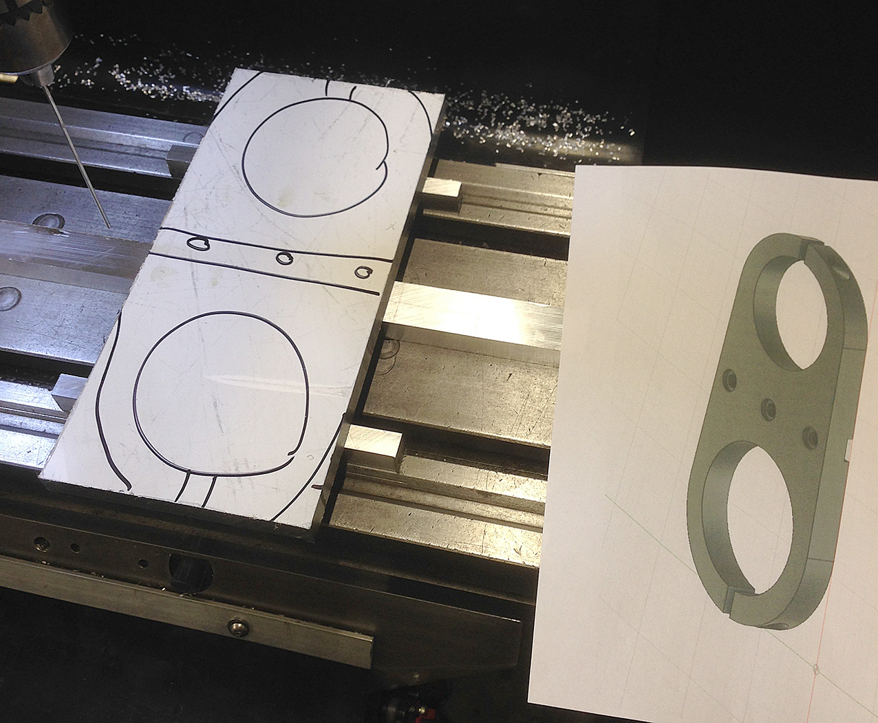

    Ok, back to this task, nearly ready to get cutting now :)
    My thoughts are to fix the waste strips down to table,
    set plate square to axes,
    clamp plate on top,
    mill the slot
    drill the three holes tapping size through
    drill the part holes to clearance size
    tap the holes in the scrap and bolt part down
    remove clamps
    mill the two large holes
    chamfer
    mill the outer profile
    flip over and bolt down
    mill slots
    clamp part again
    remove bolts and counterbore three holes.
    I think that maintains accuracy between the slot/holes and the two big holes??
    I could maybe add two extra holes between the three bolts for 6mm dowels if needed?
    The bottom plate will be easier as i only have to drill the three bolt holes and maybe dowel holes and then clamp down using the same offsets for the part.
    I think you're over-thinking it ;-)
    Square your stock and drill & tap the clamp holes manually.
    Stick it in a vice on parallels with thin sheet sacrificial spacers on top and machine all the internal features, including slot.
    Hang it out of the vice to profile and slot one end outer curve, flip and repeat.

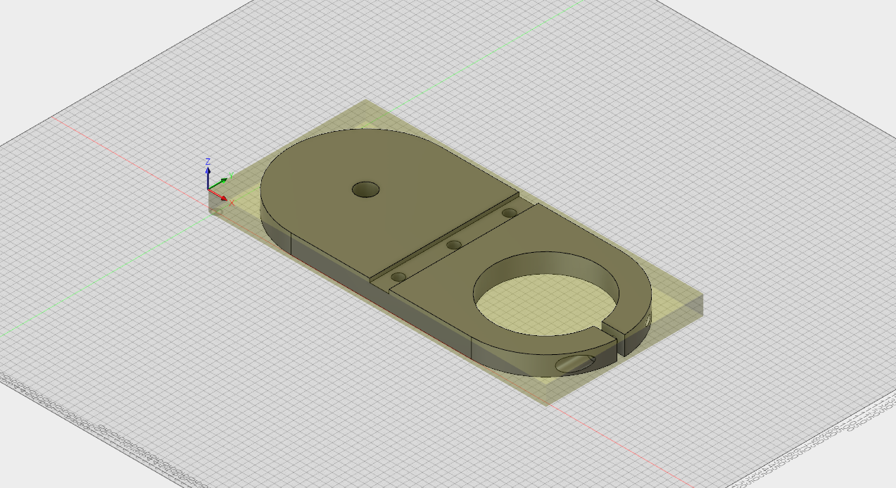

    Ok, work holding issues aside, say i have machined the inside features etc and want to create the outer contour...
Name:	Bottom Plate v14.png
    F360 knows the exact size of the raw stock but I'm buggered if i can figure out how to create a path to machine the junk away??
    Do you need to draw a box/path around the stock - if so whats the point of putting the stock size in?
    You cant select the stock in a process so i cant see its point?
