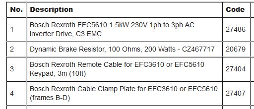

    I agree about the panel, but if the ability to detach the panel is important then if you decide to go with the Bosch you should also buy the cable so you could easily detach it. I bought a 3m long cable with it and yes, it is nice to be able to detach it but I am missing a simple feature or two from the panel. One is that there is no cable fix at the back of the panel or in the VFD where you remove the panel from, so this is something to be solved by the user. The other is that if you remove the panel it becomes a tiny plastic box without any screw holes or screw ears, so it can't easily be moved to a control box somewhere away from the VFD without a modification or special fix. None of those two points are a deal breaker, but it is a bit annoying to have to come up with your own solution. I will eventually make a cover panel which allows seeing the LEDs indicating the status even when the panel is detached and which also will hold the cable at the VFD end. I will move the panel to my controller box for better accessibility since my VFD is not going to be where it is easily seen.
    Anyway, if you decide to go for the Bosch you should also consider buying some other items, so have a look around before placing the order. My order looked like this, and I think this is the minimum you will need.
Name:	My order.JPG
    If you decide to order a Bosch 2.2kW and consider buying a brake resistor and the cable clamp you must check that those fits even the 2.2kW version. I am pretty sure that the panel cable is the same.
    They have even other interesting items which I would have bought if I not already had those, so have a look around. Anyway, it is a good company to deal with, my experience is positive even with the after sale support. I had a few questions and received all the help I needed.
