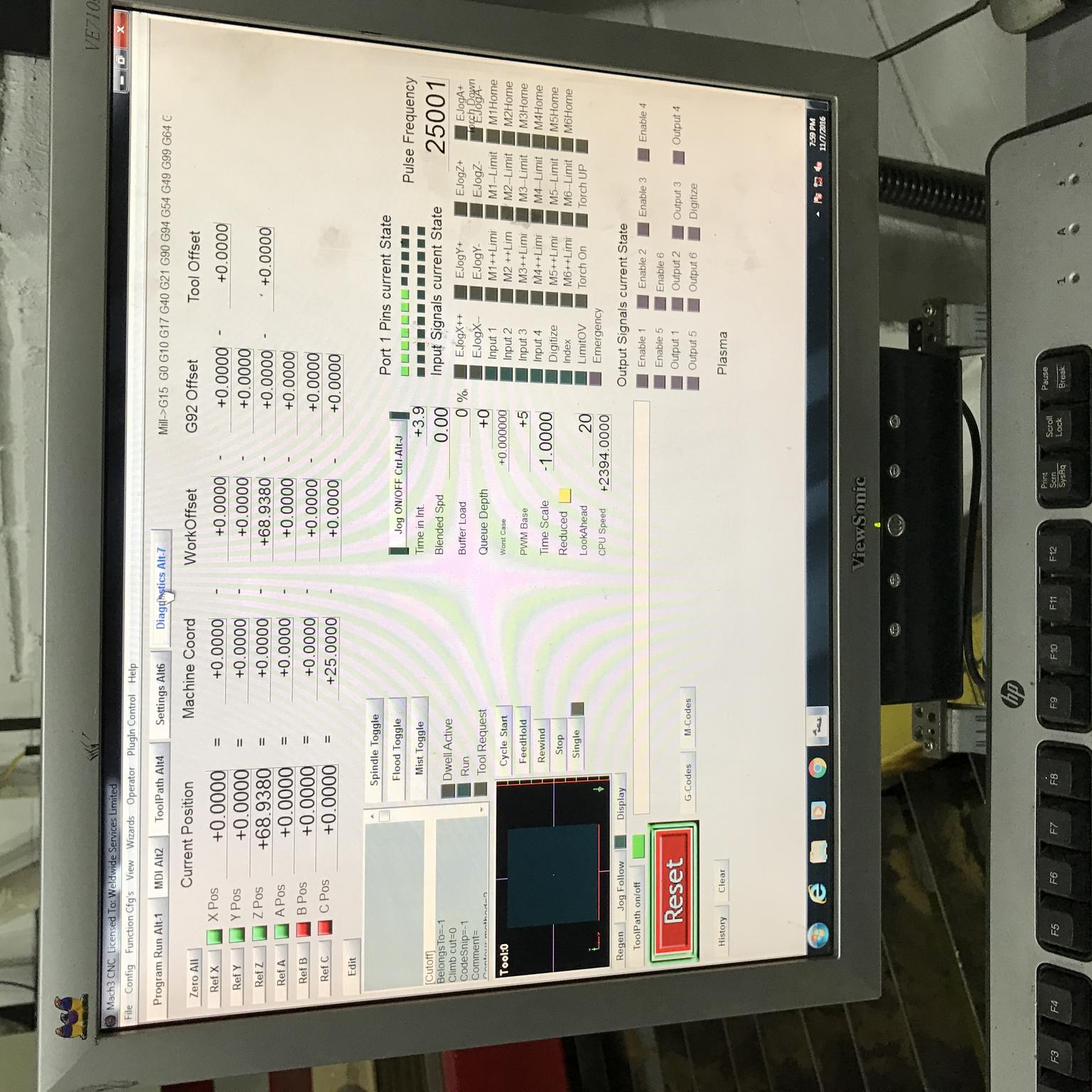

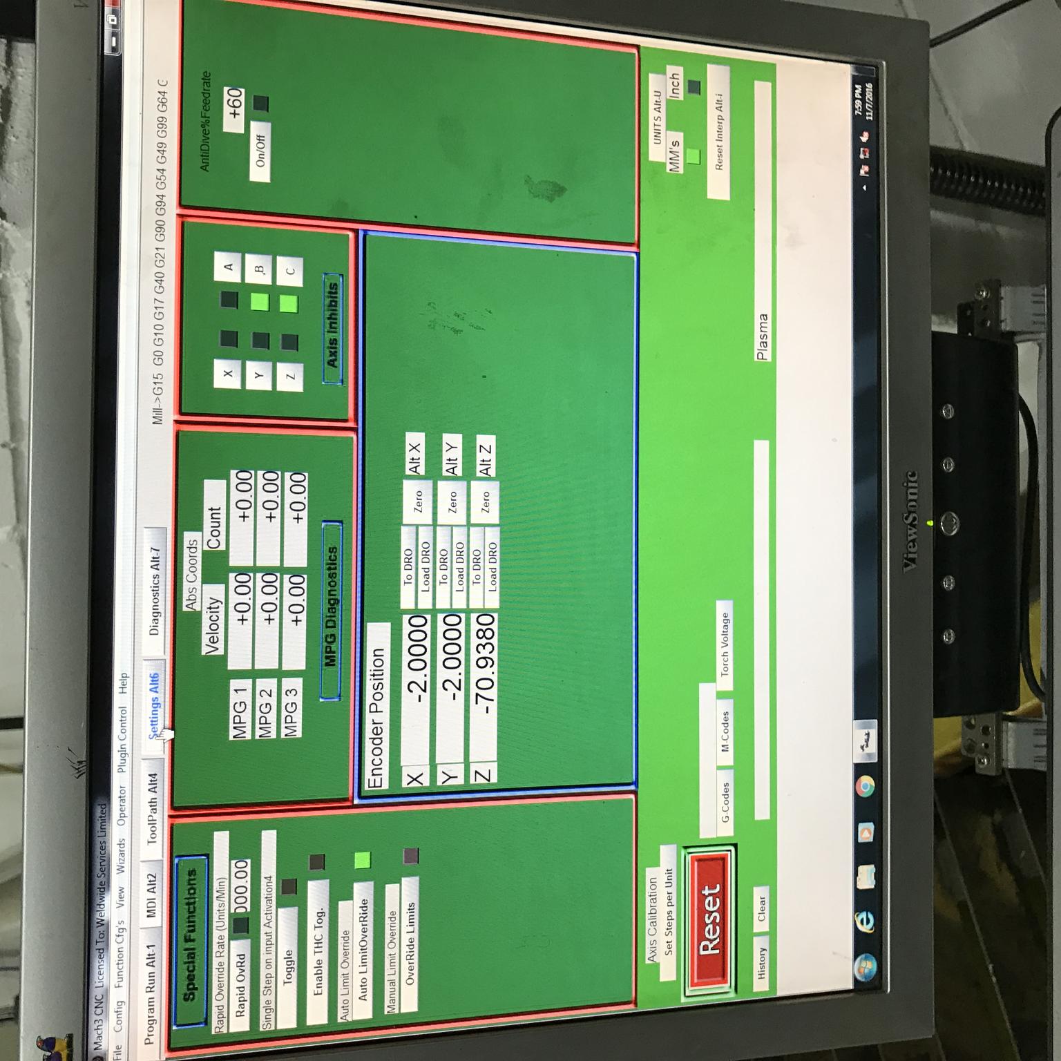

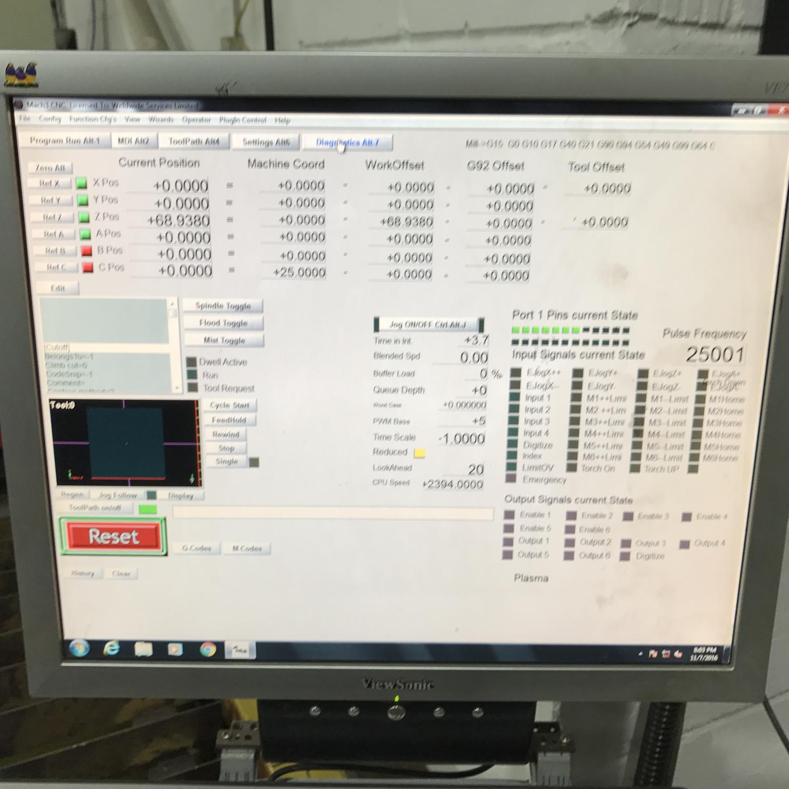

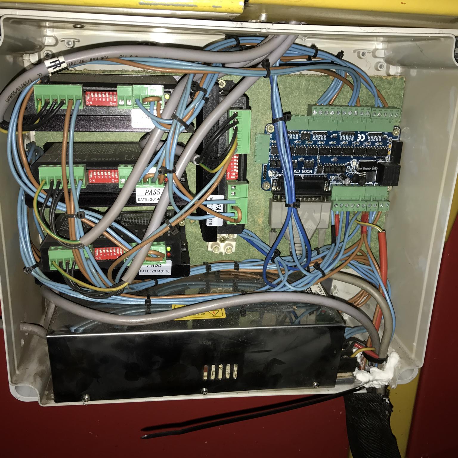

    Hello Jazz/M_C,
    Please find below two images as requested, is there supposed to be any illuminated lights of the HG08 board?
    When the old PC went bang I took it to a local PC repair shop and they recovered everything and reinstalled it onto the new PC, it all loaded OK but would run.. It may be the case that that the configuration information is already saved as a file on the PC, but I simply don`t know what I looking for which makes it somewhat difficult.

    Martin go into the Mach3 folder you'll find it on C: drive. There's folder called xmlbackup. In there will be files with extension something like MachMill.xb1 or what ever the profile was you loaded before went wrong. Rename and replace the .xb1 with xml. ie: Machmill.xml.
    Then copy it into the Main Mach3 folder. Now goto the Mach3 loader and it should be there ready to load.
    The correct Xml file may still be in there. Just rename and load whats in there one at time and check if machine comes to life. Restart Mach each time.
    If not there then we will have to reconfig your settings but first we have work out what you have. There will be more questions you'll have to answer and check for us.

    Can you take better picture of the HG08 board. Mainly of the wires next to printer cable. If you could work out where each wire goes this would help when comes to reconfig time.
    Yes will do, I have ordered an ethernet cable so that I can get it connected online/Teamviewer. This will take a few days and will revert soon.
