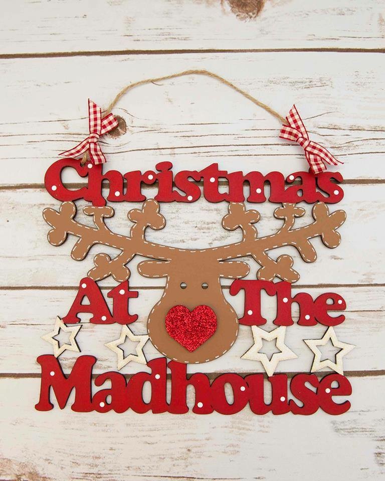

    Id like to develop my knowledge and skills and learn how to cut/make MDF crafts but don't have a clue where to start when it comes to purchasing the machinery. Can anyone suggest a good machine for beginners ??
    Ive tried attaching a image of what I'd like to be able to cut/make.

    I would guess that almost any machine can cut similar objects, assuming the X, Y Z movement is covering the area. But the "best" CNC is the one you have, not necessarily THE best. Generally, I think any of them are good enough to learn, but it is best to aim at one which you can run "plug and play" unless you are willing to spend time and some extra money on fixing/upgrading the CNC before use. Ready made CNC which is "plug and play" can be more expensive than cheap ones which might need some fixing. MDF can be cut with almost any CNC, as long as the spindle motor can handle the bits and the working area is large enough. Remember that MDF generates a LOT of very unhealthy fine dust, so you have to consider dust extraction as well. I know many people don't bother, but it is really not recommended, not even on small jobs, to run without dust extraction.
    So, start by describing your expectations, budget and skills. The learning curve is steeper if you have no machinist, electronic or electrical skills, and you are not a DIY or professional in those fields or any other engineering areas. What do you have in mind? Have you googled for any ideas?
    If it is letters and 2D stuff only, you would be better served with a cheap laser cutter. CNC has a steeper learning curve and can be messier.
    have a look at the thread by "TheCEO" or something. Also go onto facebook and look up the group on laser engraving and cutting.
    I see this said all the time and it really annoys me to honest. It's wrong to say any machine can cut MDF because while they can physicly cut the material that doesn't mean they do it correctly or very well.!!! . . . . I could make Sawing machine nibble away MDF but it will give shite results.
    I see all the time these cheap Slow machines being advertised for cutting MDF and the truth is they can't even reach the half the feed rates needed for cutting MDF correclty.
    MDF is very abrasive. Cutting with wrong feedrates wears tools out very quickly and leaves poor or burnt finish. The whole point of CNC is to give superior result in shorter time than manual methods. Having to spend hours cleaning up after machine defeats the whole point.!!
    Crafty: I can not answer your question correctly without knowing your budget and size requirements so won't try untill you can give this info.

    Yes, you are right, but it also depends on the aim. If the aim is learning then almost any machine can be used, as long as the spindle can handle it. Speed may not be high and tool wear may be larger than you wish for, but the job will be done and the user will learn. But sure, some cheap machines may be far too weak for any decent job.
