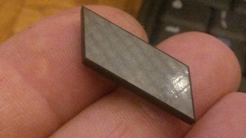

    Cut with a 1/8" end-mill using a profile cutting feature.
    I was very conservative with depth of cut in the hope that I'd avoid and delamination or tearing and get a neat finish on the edges and that seemed to work.
    I added a small chamfer manually with a diamond honing block.

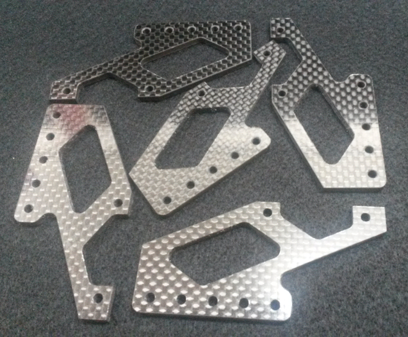

    Here's the bits in which the test cut produces the internal aperture, I don't know what I'll do with the cut outs but they're so cute I can't put them in the bin just yet ;-)
