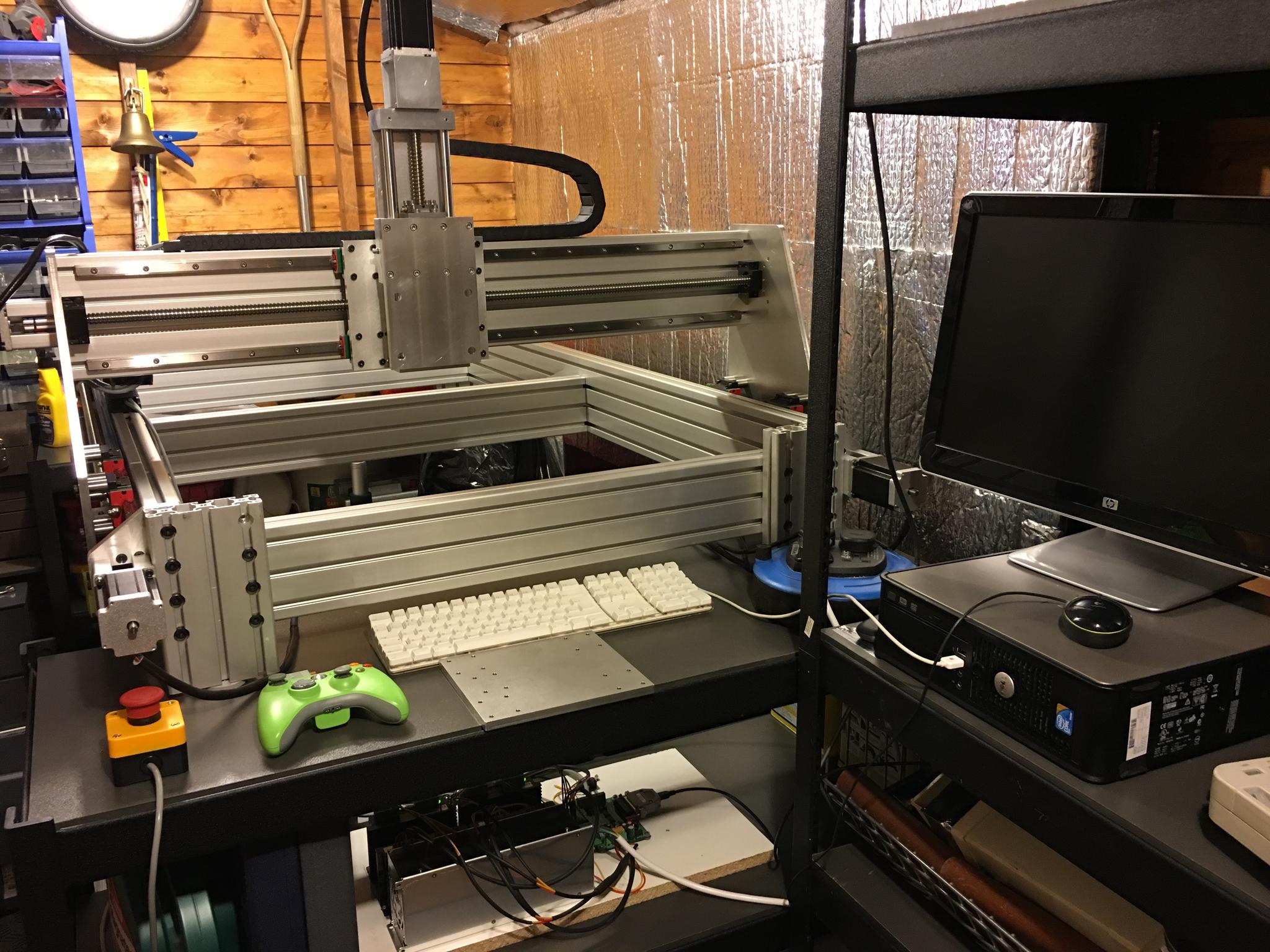

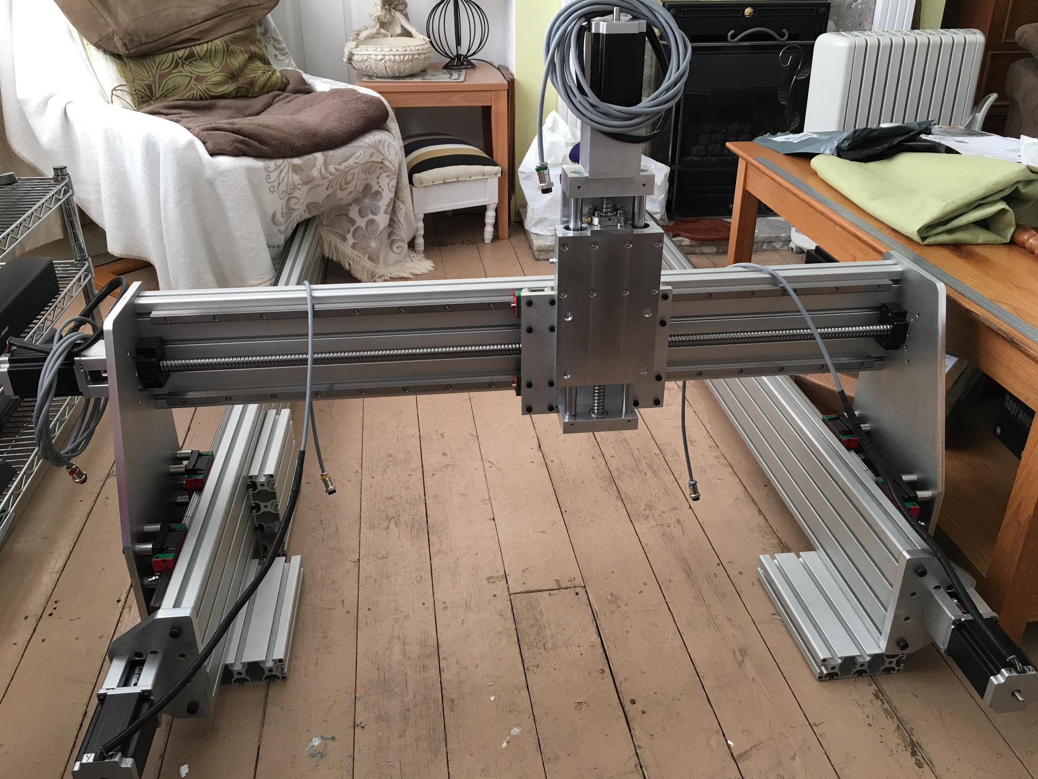

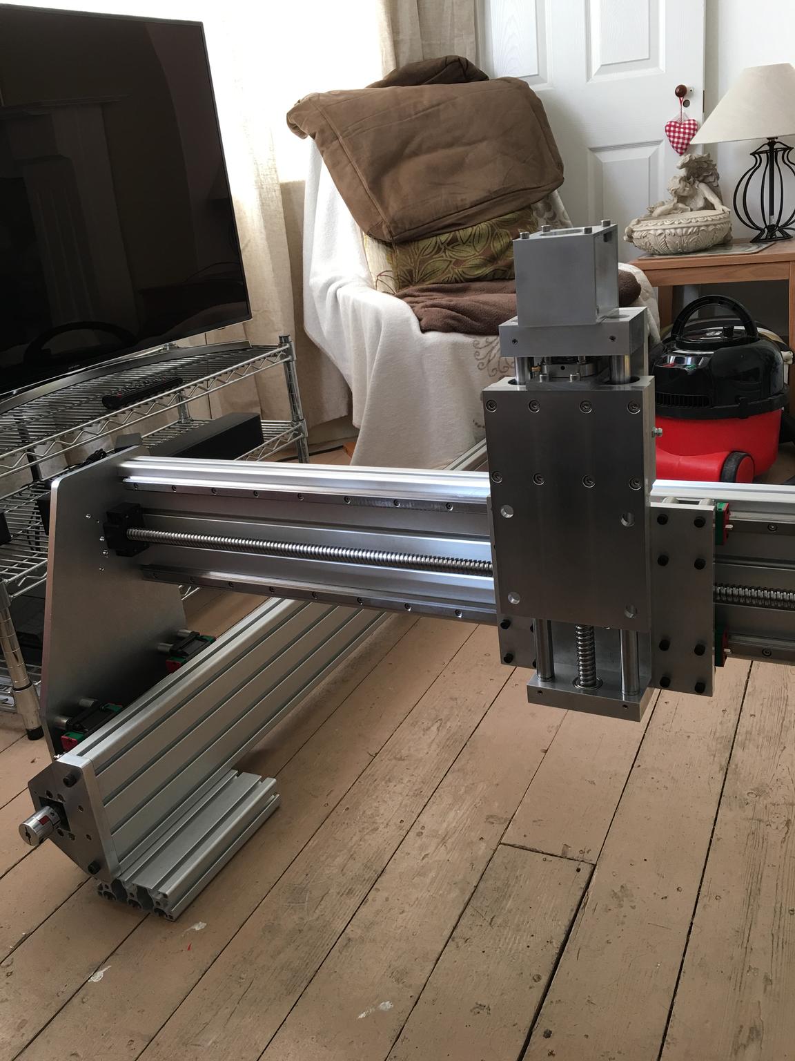

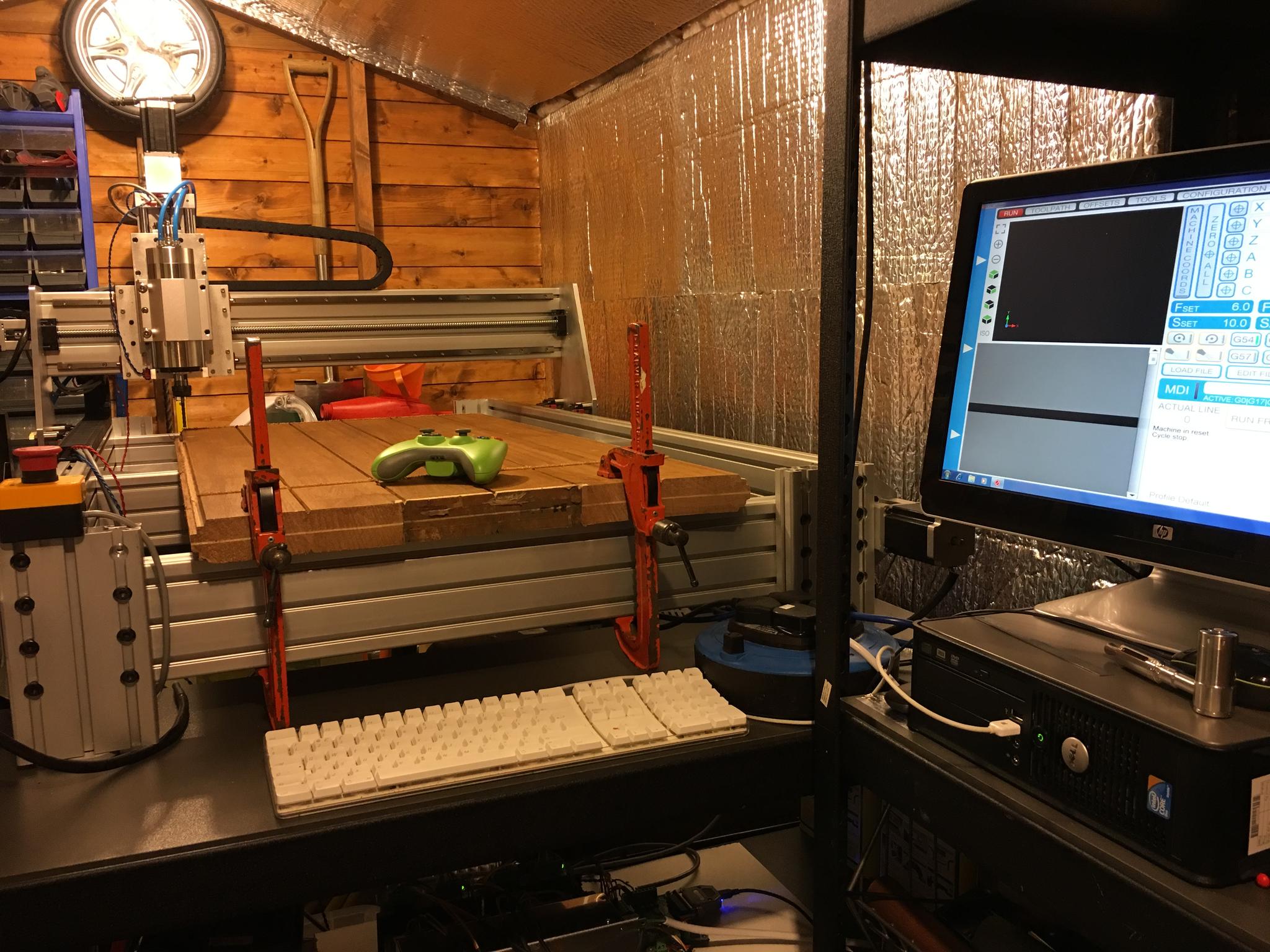

    Hi to all thought I would start by showing some pics of where I am in my build so far.
    Before anyone asks yes this is our lounge and my good lady is ok with it being there as long as its only assembly work
    I have inherited my dad's "overkill gene" with the Y axis and X axis having 160 x 40 Aluminium Profile apparently lightweight !
    1.5 metre 20mm Twin ballscrew Y axis with 4 Hiwin carriages per side on 20mm square rail.
    1 metre 16mm Ballscew X axis 4 Hiwin carriages on 16mm square rail.
    The Z axis was a pre made assembly 250mm travel.
    Gantry plates 10mm and bearing mounts 15mm and Z axis 10mm mount machining to hand drawn drawings in aluminium cant get to grips with CAD just yet
    Nema 23 4NM motors now fitted
    Will add more pics as I go.

    You could significantly increase stiffness by adding some 90 degree braces on the outside of those vertical plates but depending on what you intend to cut that might not be necessary,
    Regards,
    Nick

    Will look into whether it requires reinforcing on the gantry plates see how she goes firstly but thanks for the observation comment taken on board.
    For an idea of its size ballscrew's on Y are 1.5 metre's and X 1 metre

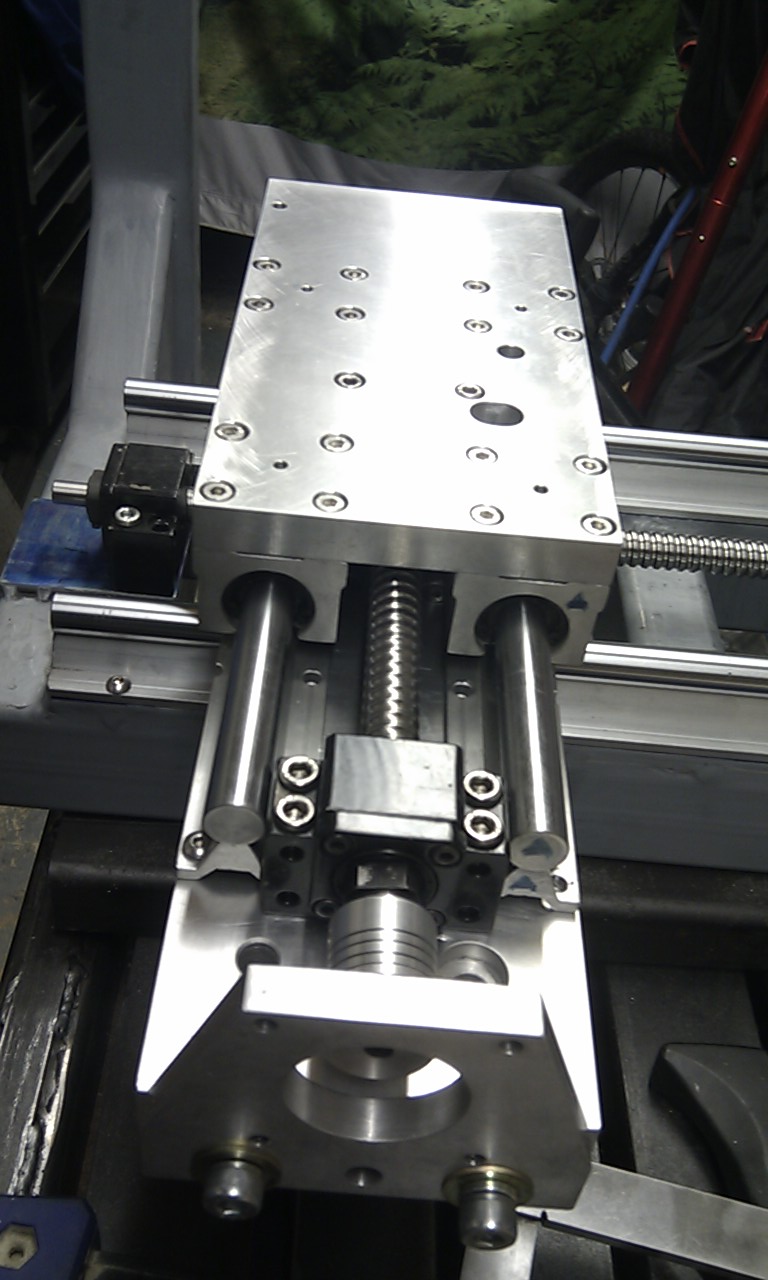

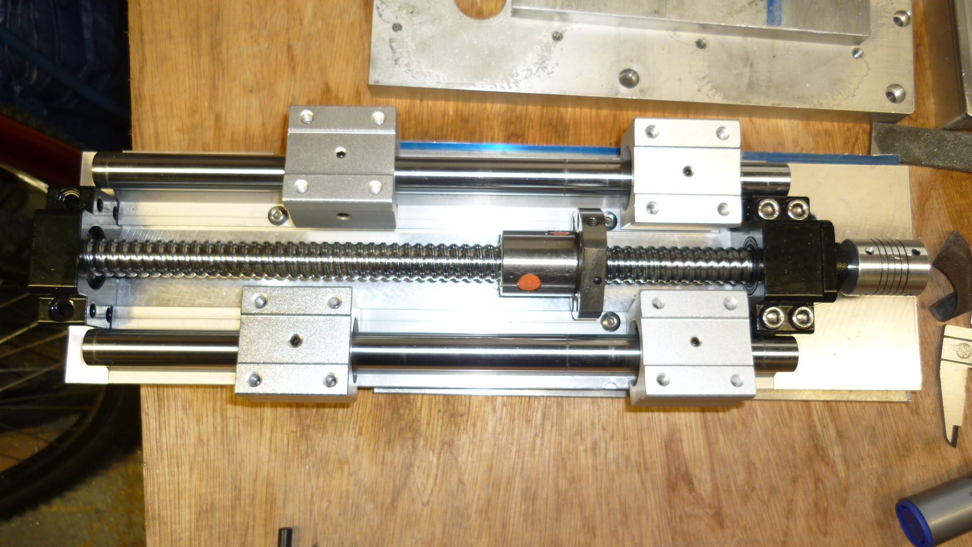

    Hi
    Why Z slides are so close? There is room on X-plate could've been wider apart.
    Unsupported rails are not stiff enough
    I made mine narrow too but X plate was the same width
    Otherwise is nice and clean

    Hi Tom
    If I was to build another I would change a few things
    Not sure what the unsupported rails is in reference to ?
    regards Steve

    Hi Steve
    You have nice Hivin rail on X and Y axis and round rails on Z which are supported at each end. Those rails can be supported like in the my picture or free like in your case.
    Yes its true, every time you build new machine is better and better, question is where is the end?
    Just spend one day revising my latest project because somebody point me on overhanging issue of my spindle in relation to the gantry. I managed save only ~50mm of that distance but with price of complicating design.
    It was wright approach as I probably would regret if I kept like was.
    Your work is good - clean and nice, wish you happy new year
