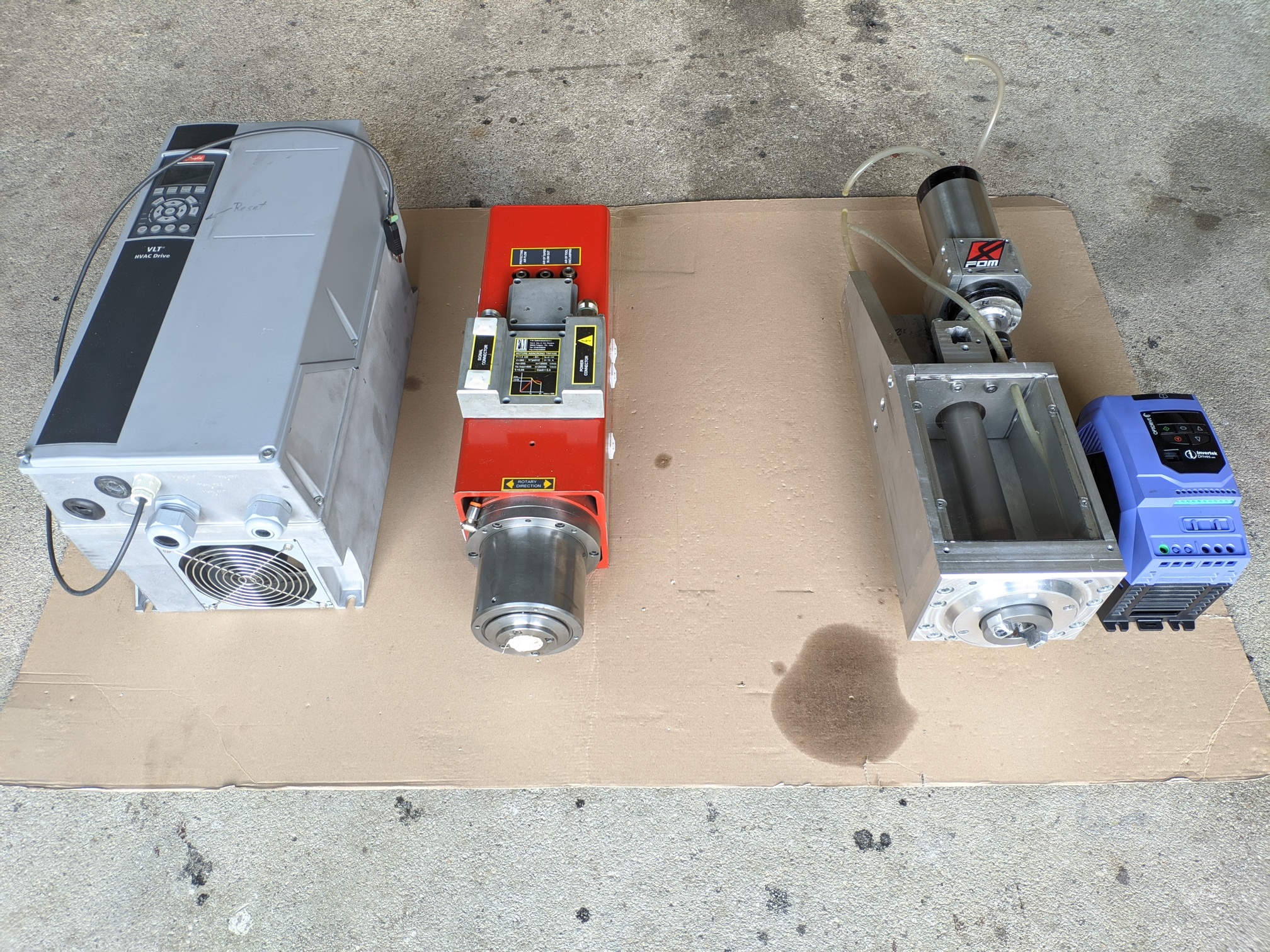

  9. My new spindle up and running.
  10. #9
    You cut anything with it yet Mat.?
    Email: [email protected]
    Web site: www.jazzcnc.co.uk
  11. Had some issues with pneumatic valve so i made only test cuts so far. But what it does it is next level.
