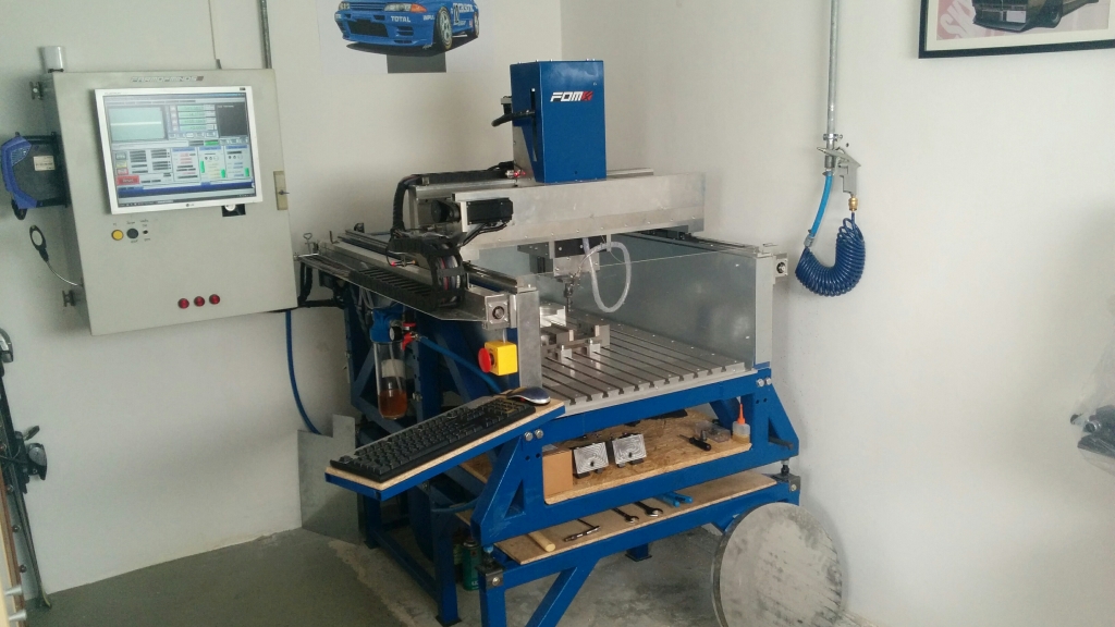

    I have already introduced myself and my project in "new member" forum so i'll cut to the chase. This is my first ever diy machine which is finished now. Again, thank you JAZZCNC for all the help you offered. I have no idea how i would connect all the electronic otherwise! I am very satisfied with the result but there are still some problems to solve before i could say it's perfect build (for me at least). I made a short video to capture the whole procedure of making the machine. Here it is:
    The parts i used are:
    4x 400W AC servos
    Cs-lab motion controller
    2.2kw W/C spindle (the spindle is unscrewing all the time. Had to disassembled it several times. Next time I will glue the upper screw!)
    Optidrive E2 VFD (blew up Huanyang vfd - thank god, my ears are grateful now)
    Steel frame (60x60x5)
    6082T6 aluminium plates
    All rails and ballscrews are from TBI Motion
    x axis: 20mm rails, 2005 ballscrews, double ball nut
    y axis: 15mm rails, 1605 ballscrew, double ball nut
    z axis: 20mm rails, 1605 ballscrew, single ball nut
    rapid moves: 7500mm/min with 1:2 ratio belt
    Cheapest angular ball bearings for ballscrew supports. (maybe here lies the problem which i'll describe later)
    I imagine the machine won't be done 100% anytime soon since there are always some upgrades. Here is the latest pic:

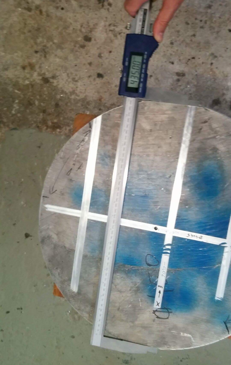

    And the test cut i made for measurements. Not sure if I am lucky or :
    That is X axis, Y axis was not that accurate, need to calibrate it a bit.

    Fantastic build thanks for sharing. Machine looks really capable. Big Metallica fan so enjoyed the sound track too!
    Would like to see a video of it cutting when you are ready.
    What is the idea behind the 2 base frames. Is that so you can also mount it on a bench or is it just for leveling?
    If the angular contact bearings are like mine (and many other forum members) they have axial freeplay which needs to be shimmed out.
    You might want to copy this post into the 'finished machines' hall of fame :
    http://www.mycncuk.com/threads/10066...s-picture-menu
    Well done.

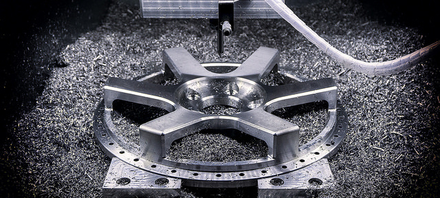

  5. Can someone help me out. I have a working machine for some time now, very happy with my first diy project. Till recently i thought i hit the limit with feeds and speeds but when i saw how much material can cut similar or even less robust machines i am getting frustrated that i cant cut much more (Chris's machine cuts very nicely https://youtu.be/6lyh3ctUCgk ). That would mean 3h job instead of 5-6h. So for example, my parameters for 10mm carbide cutter is 12mm doc, 0.5mm stepover and 4000mm/min at ~10k rpm. I mill aluminium 6082-T6. I have tried tons of combinations (ripper too), but this is the fastest i could cut without any issues. I cut dry with help of air and also with wd40. wd40 gives better results ofc. Whenever i go more stepover (with lover doc ofcourse) i break tool or it will about to. Countless broken tools. All 3 axis have 0.01mm or less free play, machine feels solid. Is there anything i can do or is this all i can get out of it? Could be the servo motors (400W KRS servos) not tuned properly? Or the machine is just not solid enough which i doubt. I plan to fill steel frame and bed with epoxy granite too. Is maybe problem in the spindle in a way. It has a little runout, about 0,01 or 0.02...
    Z axis doesn't have any counterbalance so the servo is holding the z weight. When cutting 3d contour and z axis is moving down, it is not smooth moving but i get steps on the part i mill. I fixed that with PID tuning. I didn't try that on x and y axis yet but i will asap.
    Any suggestions?

    What i cut:
    Hi Matt,
    Looking good now mate.
    Are these adaptive toolpaths your using.? What Cam package.?
    How many flutes.?
    How long Flute lengths.?
    Also does the machine actually sound like that or is the video making it sound worse than it is.? Don't remember it sounding like that when we skyped.!

    I am using adaptive toolpaths with Autodesk Inventor HSM. I have used 2 flute, 3 flute, rippers. The only tool i didn't use was 1 flute. I have tested with tools diameter 10mm, 8mm, 6mm and had similar problems. Because of the nature of the workpiece i was mostly using long flute lengths (10mm x 45mm, 6mm x 35mm, 6mm x 20mm). I have tested with short flutes too ofc (10x26,8x20,6x16) and it's the same issue. The machine sound is so loud because the room is very small and echo is really loud on the camera. It's not that bad IRL but its not quite ether . Here is the last batch of broken tools

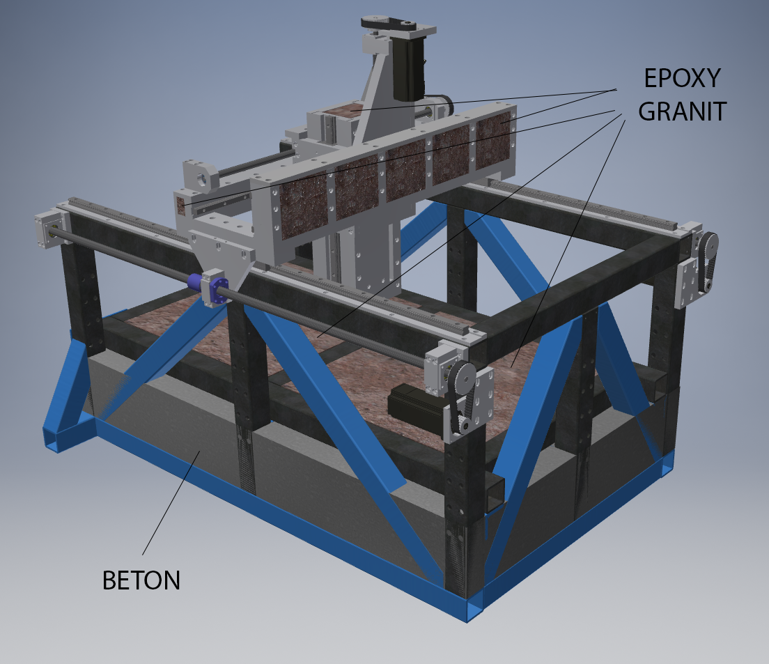

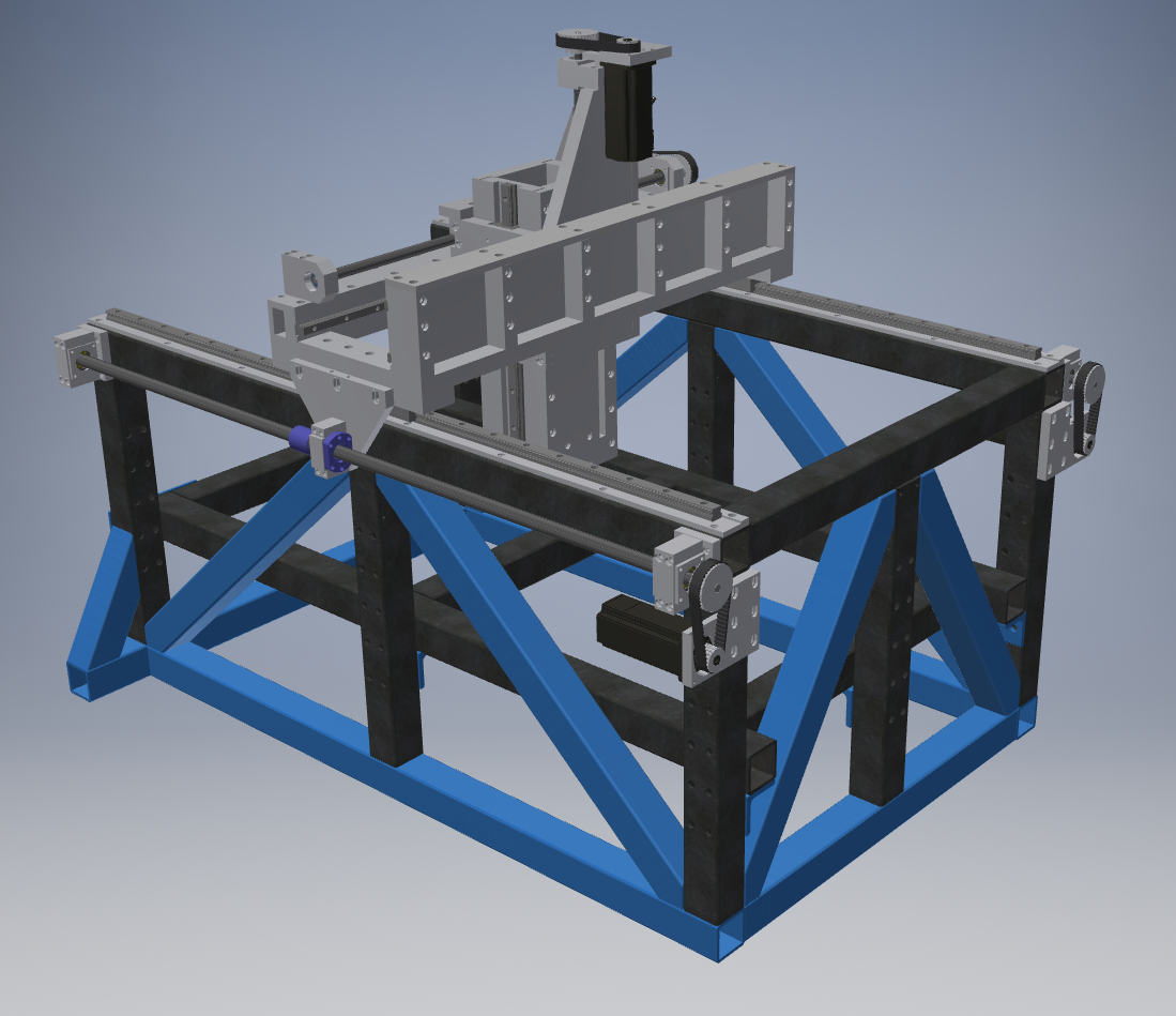

  10. So i am about to upgrade the machine with the combination of epoxy granite and concrete in a hope to eliminate vibrations and damping and hopefully have even better cutting performance. I got high quality epoxy granite Rampf Epument 140/8b, but i have only 100kg of it so to gain more weight of the frame, i will use concrete too. I would like to hear opinions if this would work. On the picture attached you can see how i will do this. Blue color shows where i wont use EG(have only 100kg), dark shows tubes filled with EG and gray is concrete (beton). I will also fill the gaps on gantry with EG and put the EG under the table. Will this work?

    Your machine looks pretty stiff so for cutting aluminium faster I would have a go with mist coolant. Lots of posts on here about how to do it so you don't fog up the workshop. Do you have a compressor ?
    Also it might not effect things greatly but the concrete will shrink a bit when dry so might pull away from the walls. I'd try the mist coolant first though.
