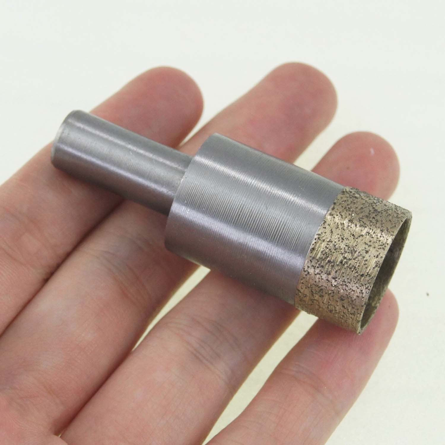

    Theory is fine , but its like trying to fine hens teeth to get rough to polish grades , hence why I'm experimenting with epoxy . But for anything above a 5" sphere I doubt epoxy will be useful.
    Never seen an article on truing the wheels but have seen people say if used correct they can last 10-15 years. At £150 a pop for a big one I'd want them to last a bit to lol :)
    These guys produce the finished brazed cups in all sorts of grades and sizes
    Big scale sphere making.. Highland Park grinding cups
